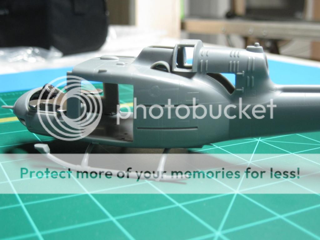

Here's the Hobby Boss hull/fuselage (forgive my lack of helicopter terminology). Everything is molded on: doors, hatches, and screen vents. The kit is a tail sitter, so I threw in a few "weights" to keep her looking smart for the photo shoot :)

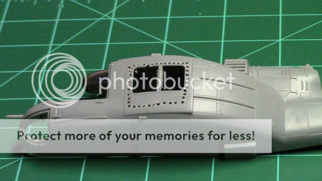

The first thing to go will be the doors. Once cut, I will later reattach the Revell doors in the open position. There's no need to worry about cutting out doors. It's a lot easier than you might think. I always start by locating the four corners of the open space. In this case, I marked them on the inside of the fuselage. I made my holes 1-2mm away from the outside edge. This ensures that my edge will be safe from damage from the Dremel. Using a drill bit, make your holes for each of the corners. Then connect each corner with a series of holes. Be sure to use fresh drill bits, as old ones will melt rather than cut through the plastic.

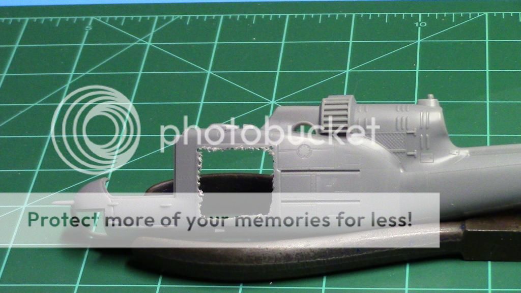

Once all the holes have been made, I just made a quick pass with the Dremel, cutting through all the holes. This will leave quite a jagged and messy appearance.
From this point on, I used my knife to trim away the remaining pieces of the door, making sure to leave just a little behind. The last remnants will be filed off with jewelers files. Because the doors are molded on, there were a few parts of the door that could be neither cut or filed away. I used a grinding bit and sandpaper to reduce the plastic until it was flush with the hull. Here is the final result.
