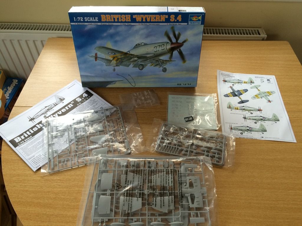

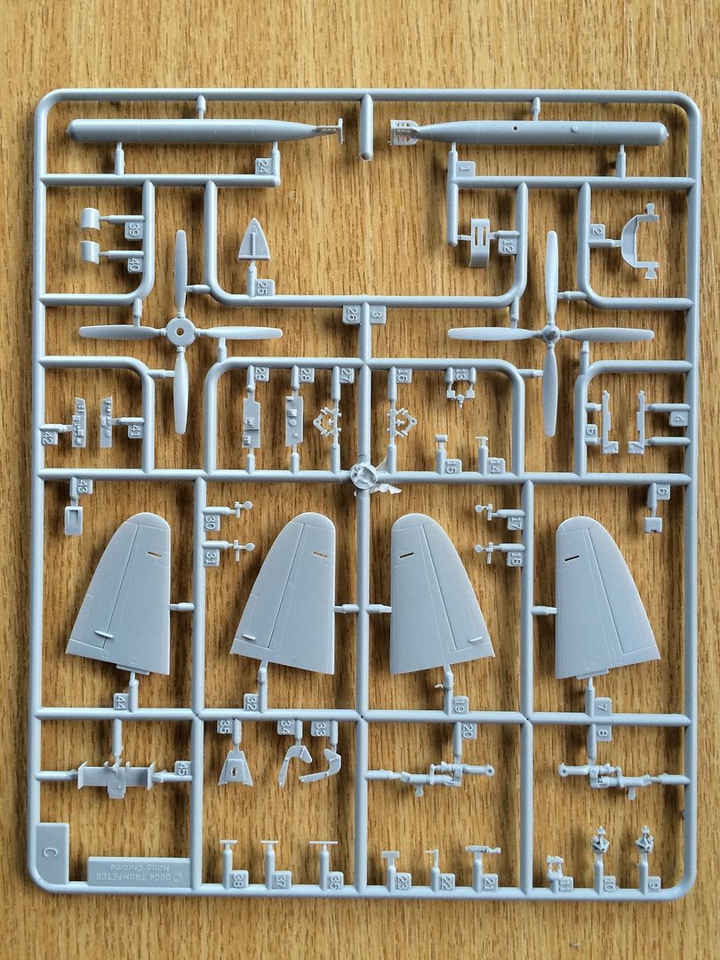

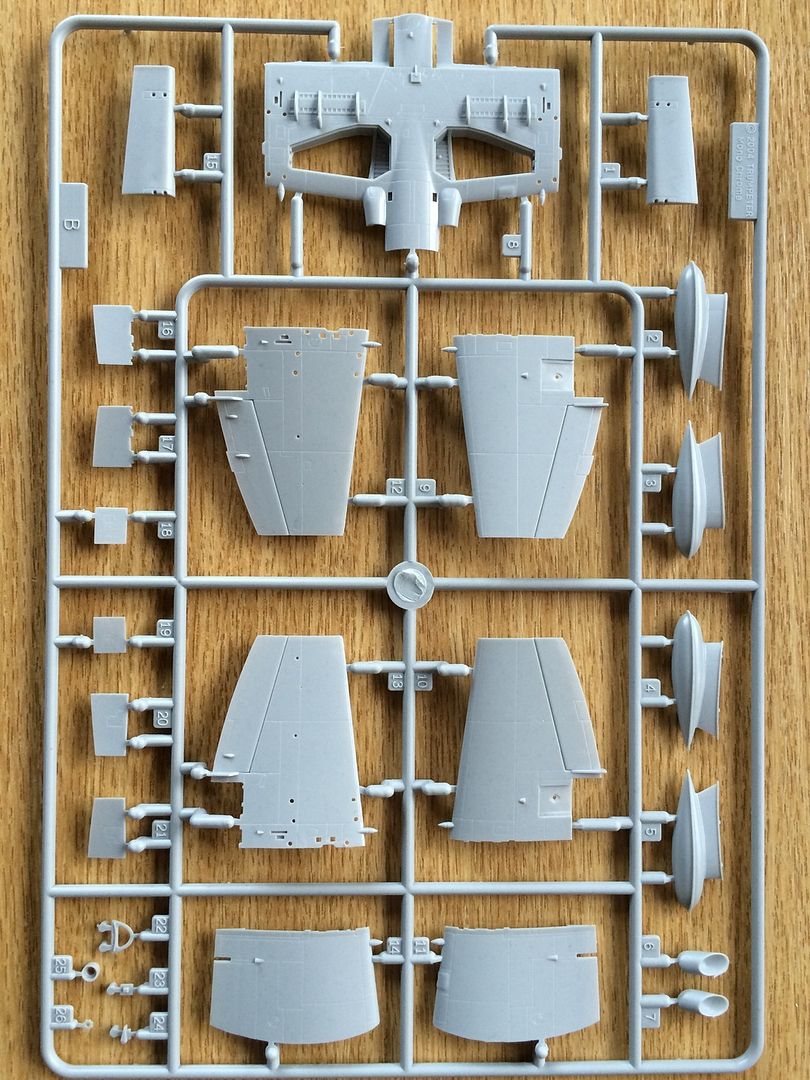

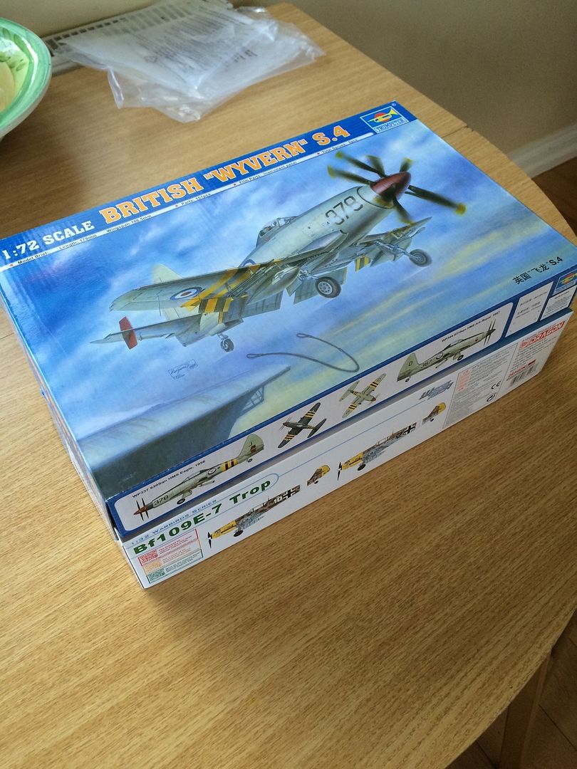

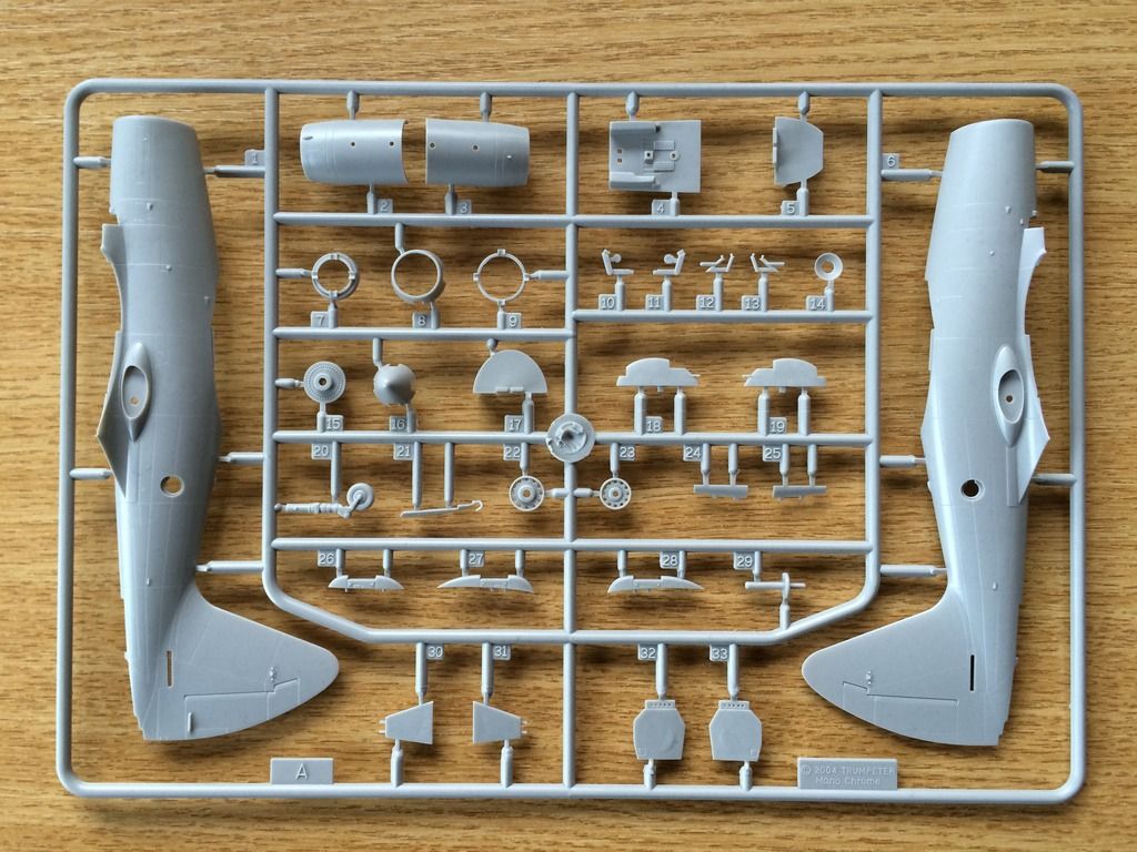

Lets look at some plastic...
Not much in a great big box..

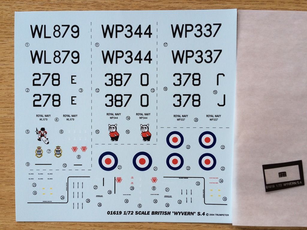

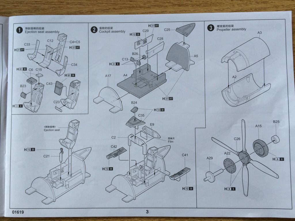

Easy instructions..
Not sure which one to do? Joe wants me too do the top one with the Muskateer strips :bash:
See what I mean about the box..! That's a 1:32 kit in the box underneath....!
Haven't got long, best get a wriggle on :th:

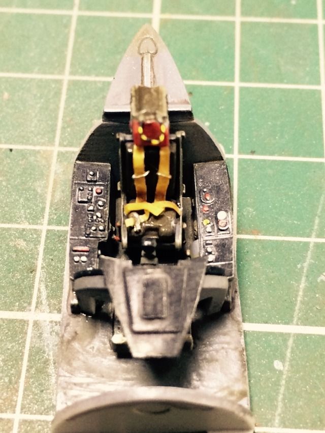

A little bit more..

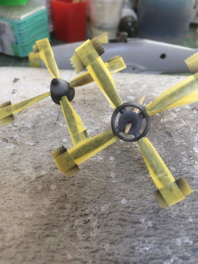

Props and spinners.. Primed, a bit of pre-shading and a white base colour for the yellow tips..
Yellow tips duly sprayed. I'll leave until fully dry before anything else is done..

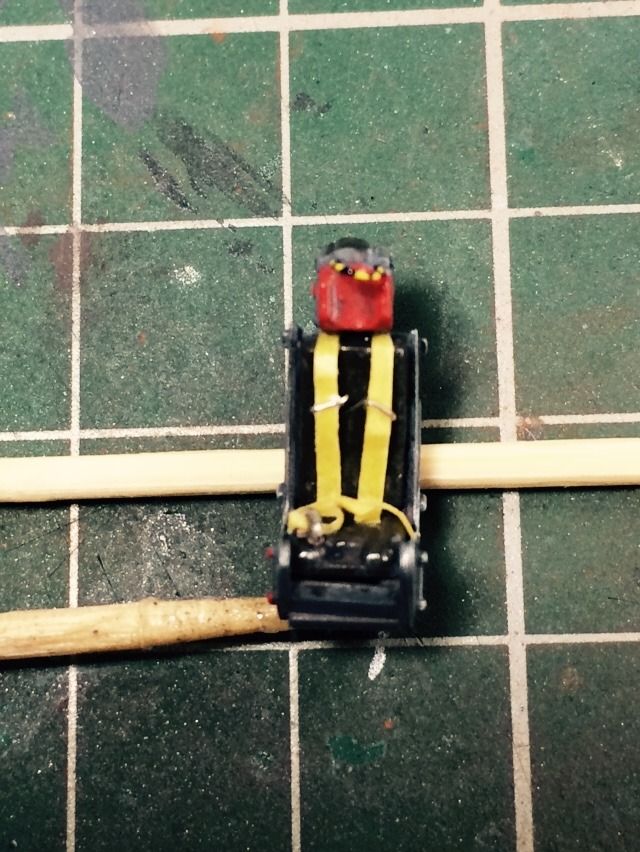

I've had ago at seat belts here, I used Tamiya tape and a little fuse wire, don't think it's makes a difference but you never know..

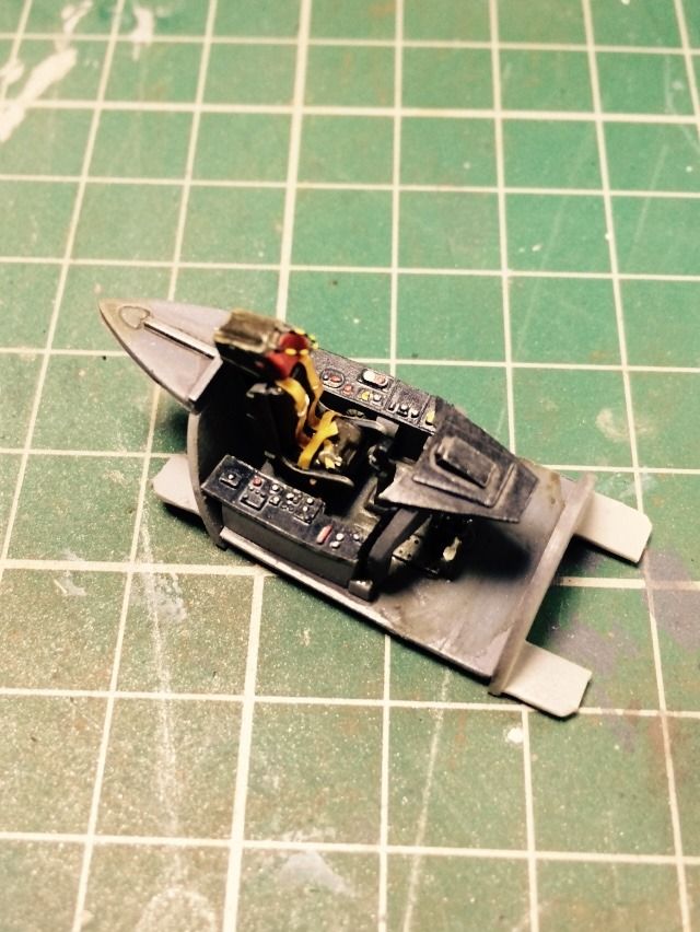

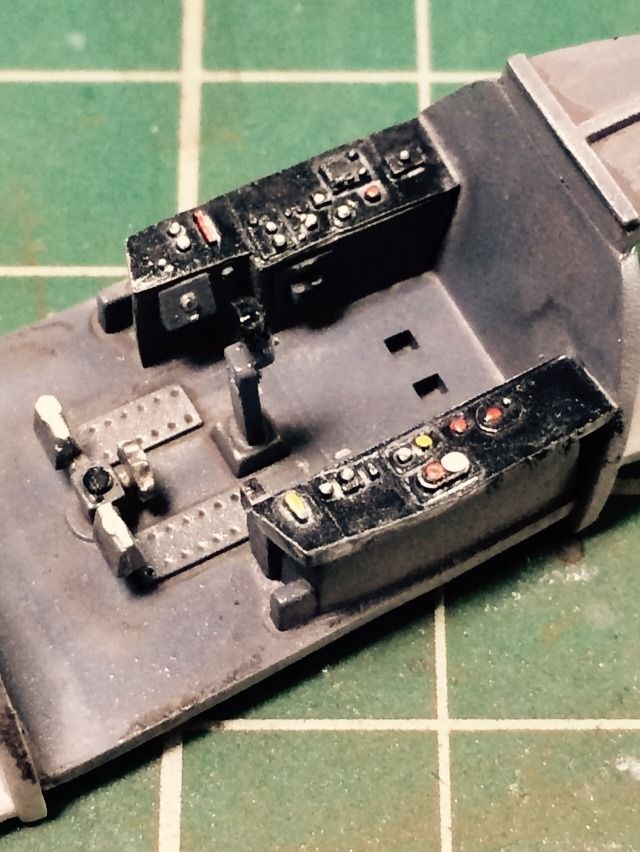

'Pit..
Completed seat, since these pics were taken, I've given it a matt cote..
Hopefully I'll get the fuselage buttoned up soon, until then happy modelling lads..

shortCummins
Posts: 1643
Re: Trumpeter 1:72 Westland Wyvern S.4
Post by shortCummins »
good job on the scratch built bits n pieces :th:

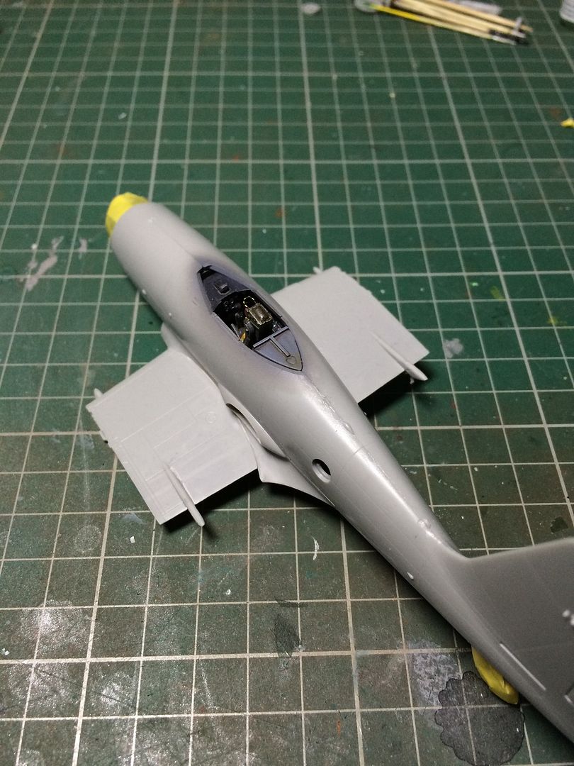

Fuselage together :banana:
That's it!

Thumboy
Posts: 268
Location: Wellington NZ
Post by Thumboy »
Cockpit looks awesome and it's coming together nicely :th: I have been stalking this kit for a while but not taken the plunge yet. Watching with interest :pop:
good luck with the rest of the build :th:
Great work on the cockpit mate she's coming together nicely.

Thanx Andy, its typical Trumpeter I guess mate, it all fits (so far), nice instructions, full colour call out sheet. It's all about the subject really, there's not much choice if you want a Wyvern.....btw I've also got Its bigger brother and that is really nice.

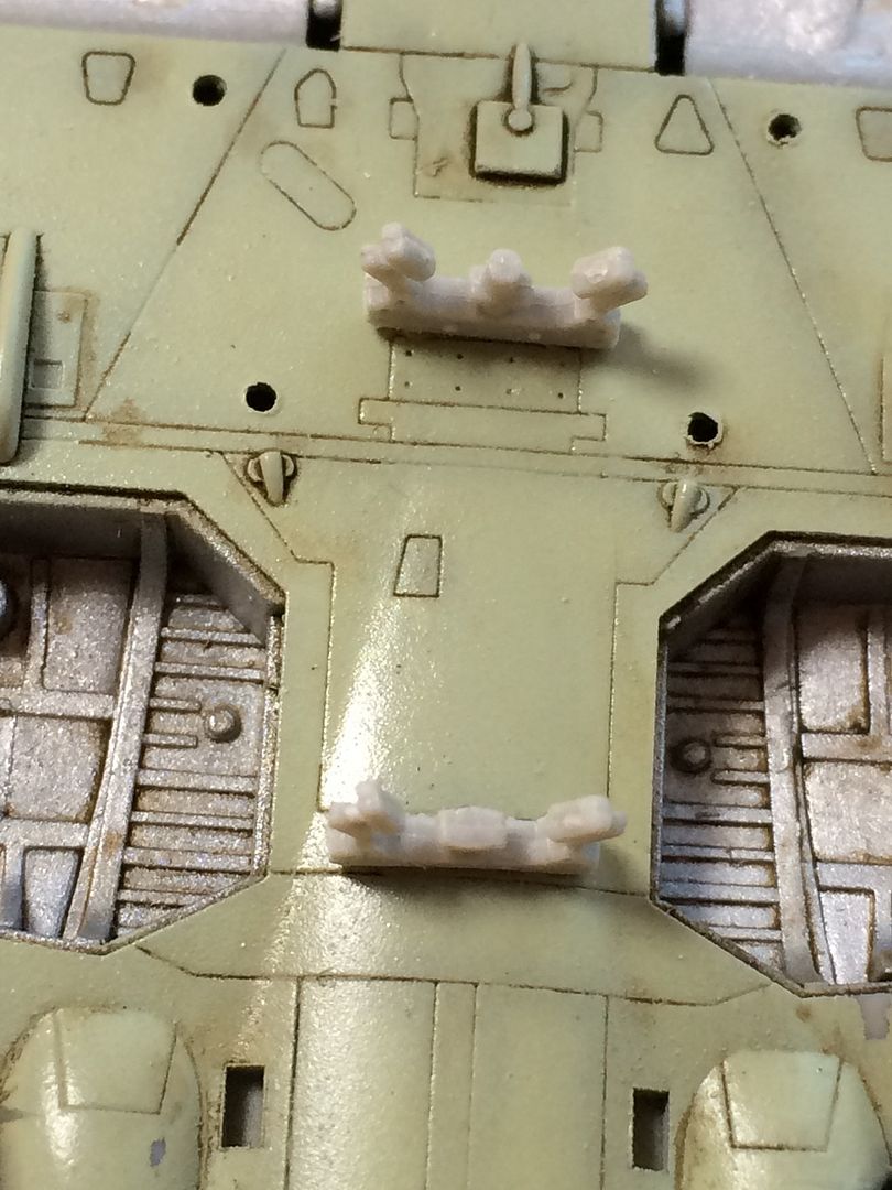

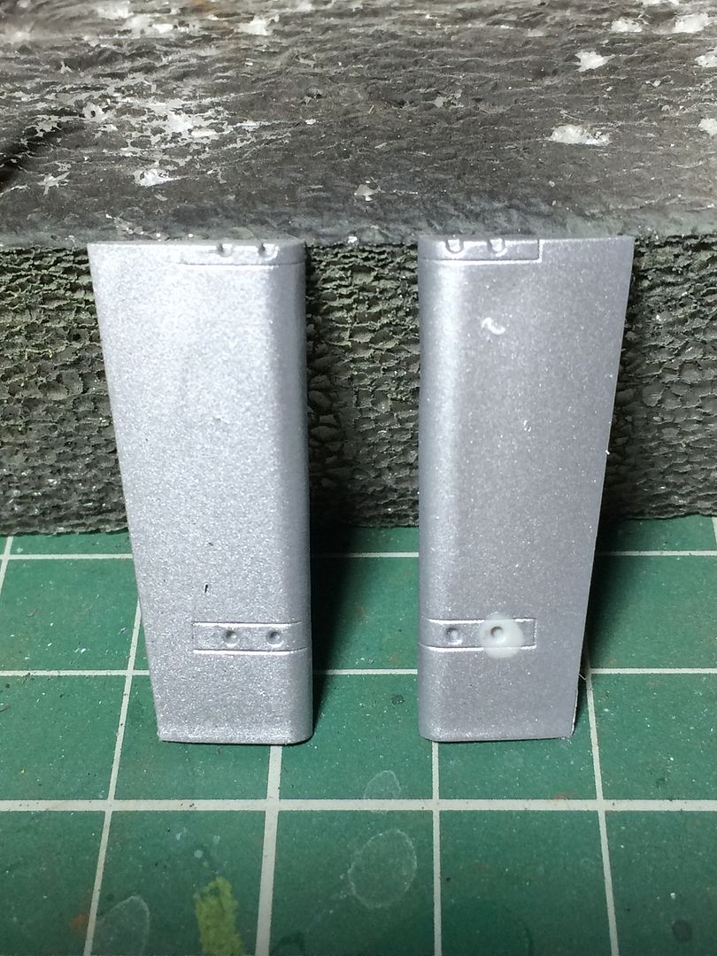

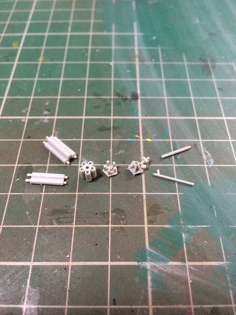

Some work on the RATOG system...
Lets have a look at lovely detail underneath...
Very soon I need to make a decision on wether the wings should be folded or not, I can't make my mind up... :think:
Any thoughts?
Post by m0gb0y74 »
Lovely cockpit :bow::

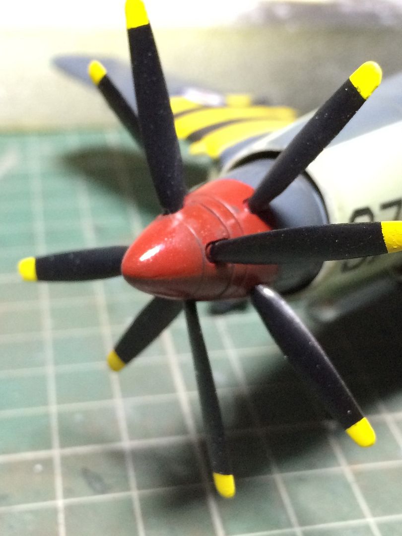

Some work on the prop here....

Nice work Tim. Looking great. Loving the contra-prop.

Willem wrote:Nice work Tim. Looking great. Loving the contra-prop.
Thank you Will, it's certainly different...

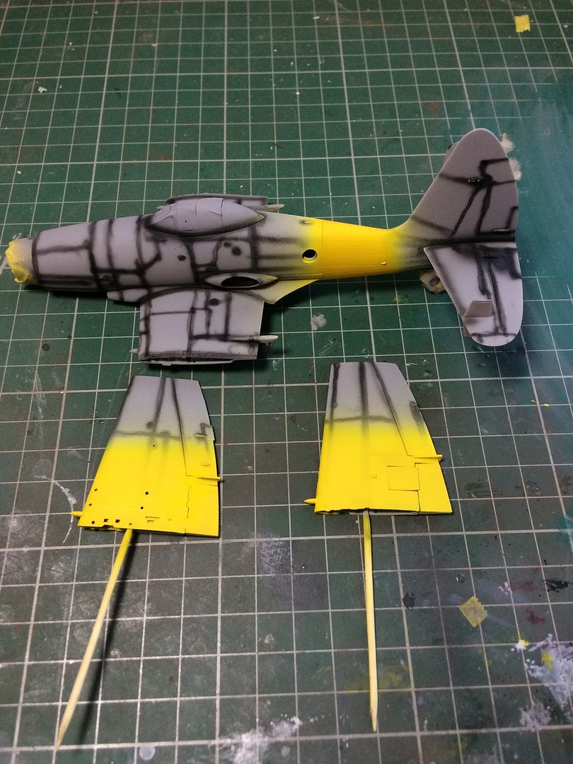

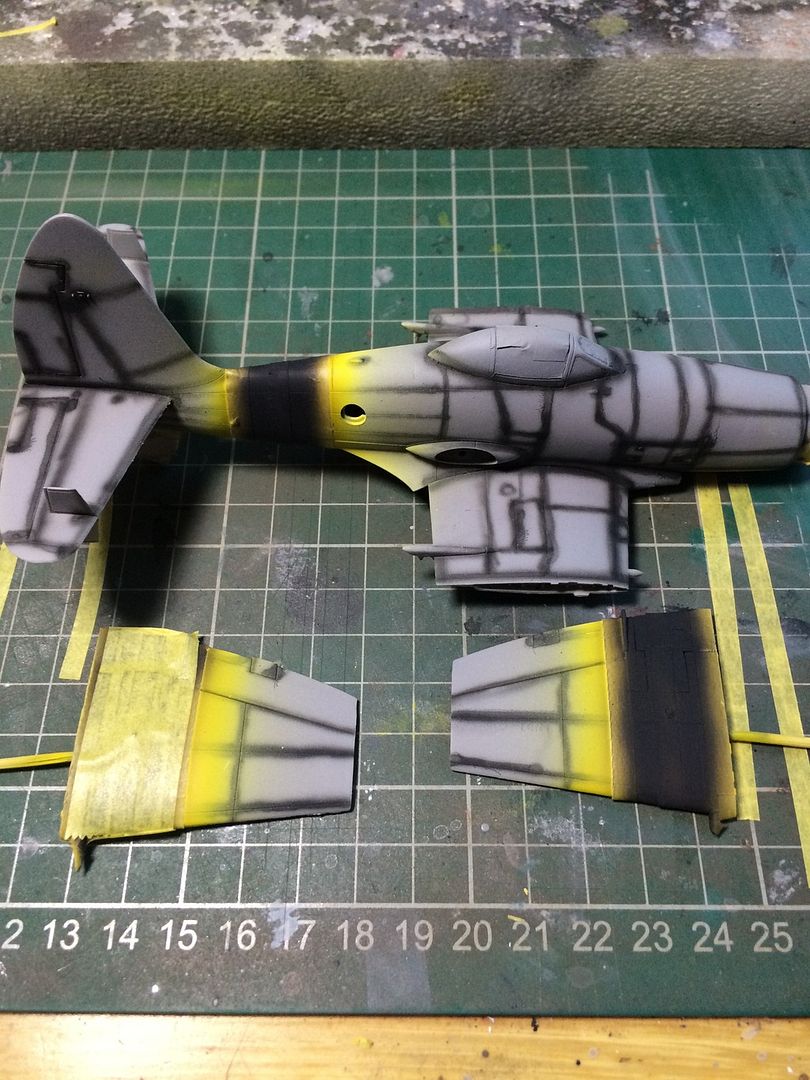

Pre-shading and some white base for the yellow stripes...
Right, I'm a fully paid-up member of the Mr Hobby Aquaous fan club, but Tamiya XF2 is a much better white....in my opinion of course...
Citadel Runefang Steel for the wheel wells as well..

Great work so far mate preshading looks great.

Nige201980 wrote:Great work so far mate preshading looks great.
Thanx Nige, I'm still getting to grips with pre-shading to be honest bud...

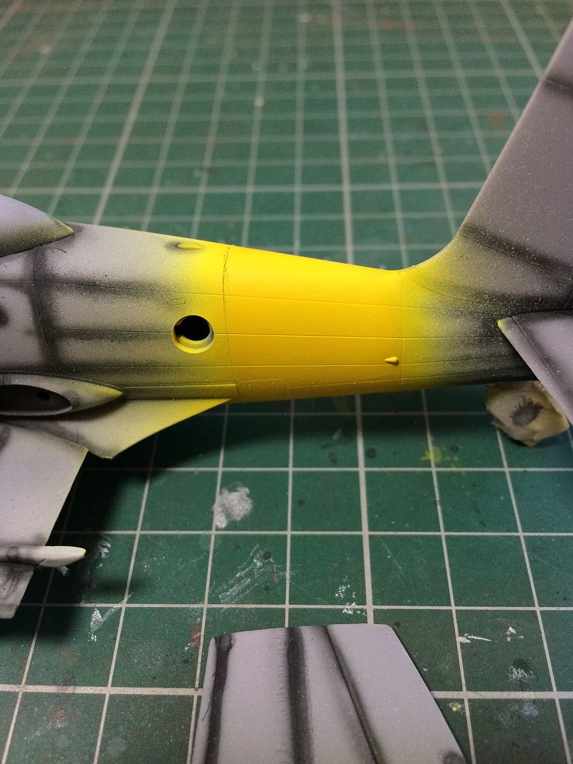

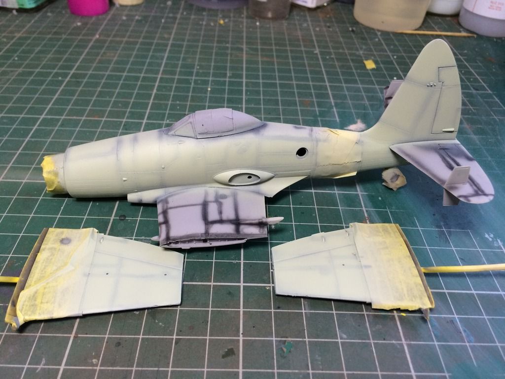

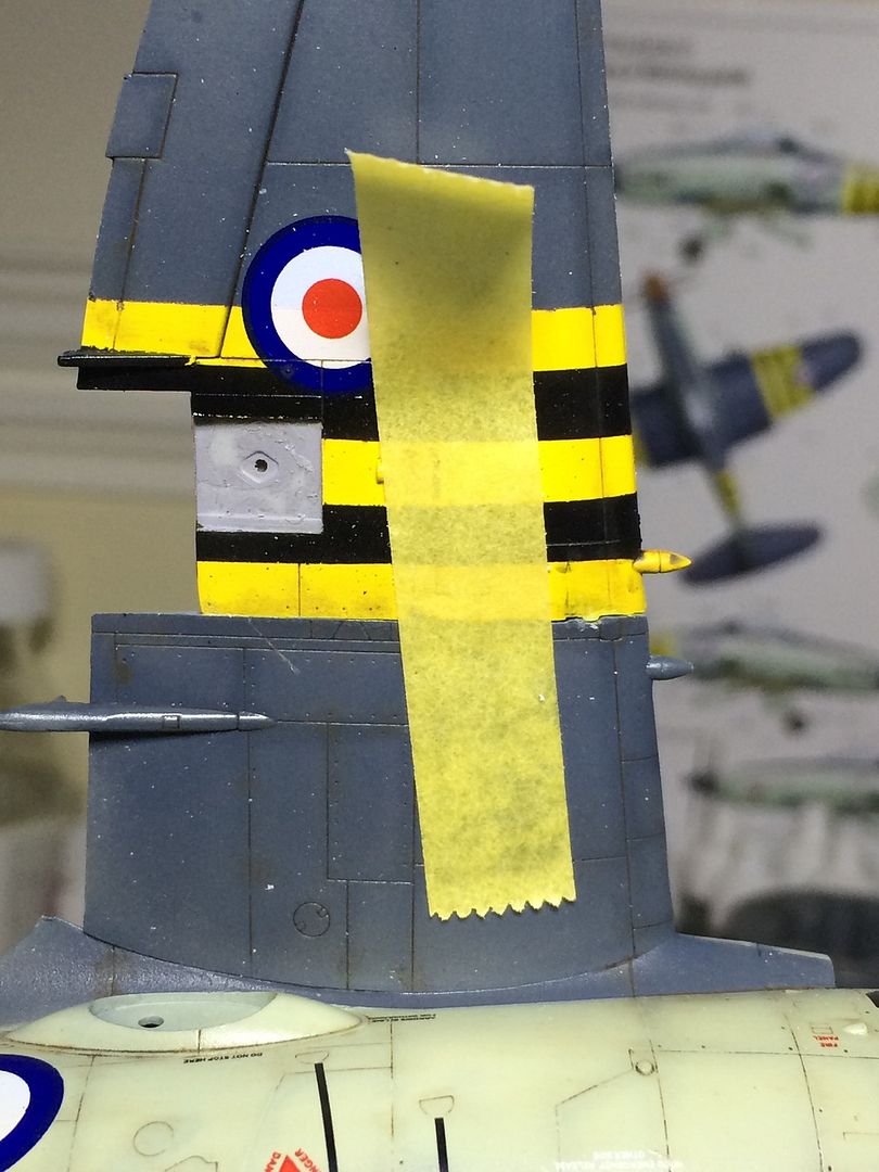

Mr Hobby Aquaous RLM04 has been used to start off the "Musketeer" stripes, I don't if the white "undercoat" has made a difference, but the yellow does seem at bit brighter :think:
Now I'll cut some stripe out of Tamiya tape, I reckon about 4mm. I suppose this is where I ought to keep the full range of tape sizes (Jammy Dog is it?)
Black stripes this time..
The stripe are fully masked over and the over-spray has re-primed and re-pre-shaded (what a terrible sentence!!)
Like I said, I'm never usually lucky but I forgot I had these little Akan pots of joy...
(Not actual size)

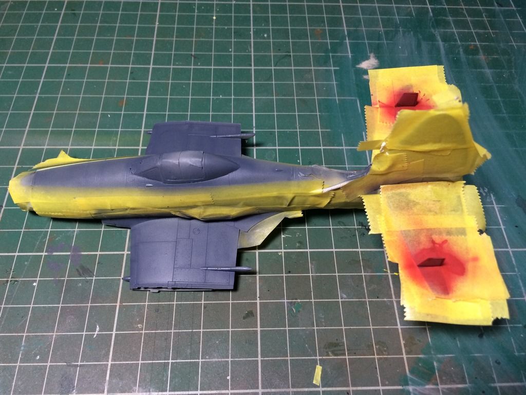

Lets go to work!
Too much pre-shading? Not enough?
Too much masking up? Not enough?
Going DSG crazy..
I can't wait! A sneaky pickie..

Pre shading just about right me thinks mate. Cracking job on the paint work.

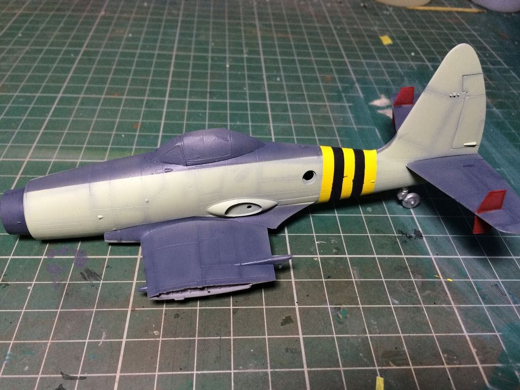

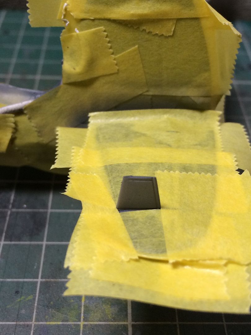

A bit of a landmark moment coming up, but first the worlds most boring photo...
More masking..

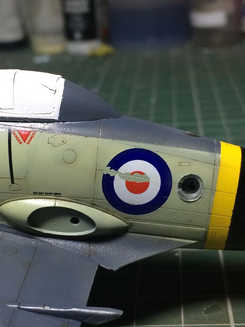

The following is the landmark moment I mentioned earlier :banana:

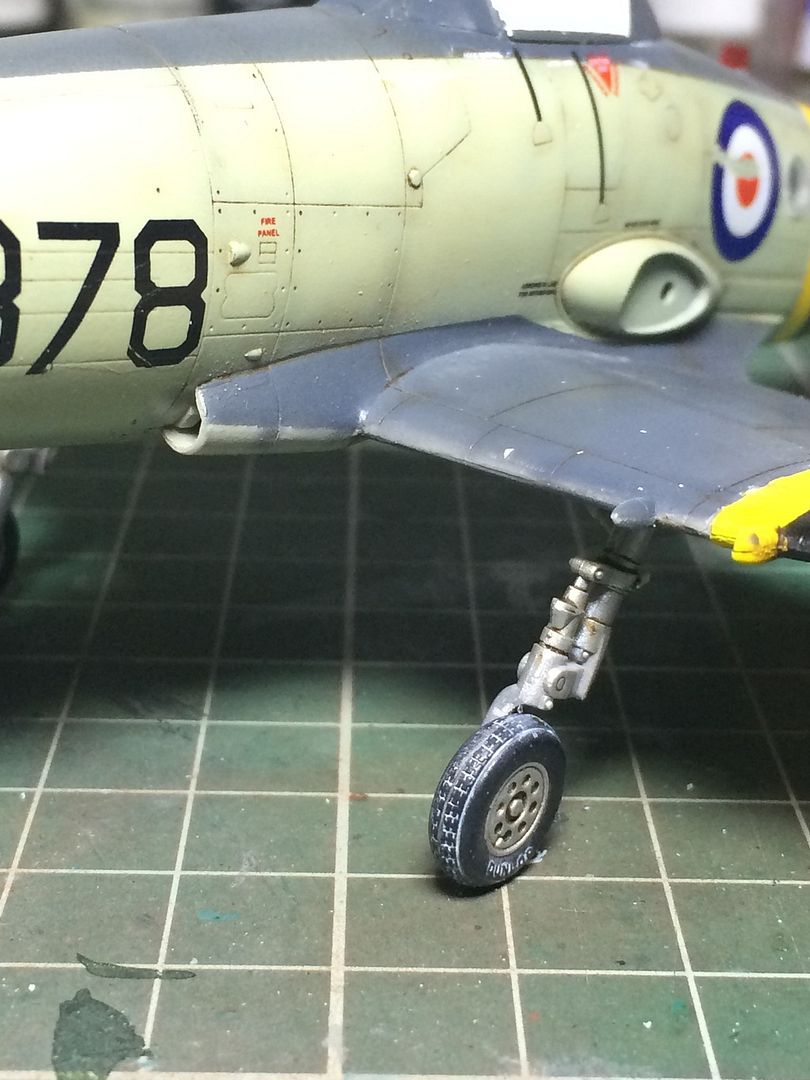

All de-masked..
It does need a bit of a clean up tho....here a there...
So lads, that's I stand up-to now. I best get a clear cote on sharpish :thumb1:

The world's most boring photo? Bet you I can beat you on that front!
Looking veeeery sweet. Meticulous masking pays off.

Thanx Will. It was d u ll dull to say the least, but she's coming together. I can't believe how long it's taking to be honest.

Masking for the white stripe around the canopy... Anyone tell me its purpose?
Oh no! What's this? I had clear coted as well! :pistols:
Not sure what to do to be honest. Do I leave it :( or try a touch-up :?
Standing on her own two feet at last...
A bit more work left me thinks....

Looking beeeaaautiful in her paint and weathering.
That decal tear is a bit of a kick in the nadgers though.
Good luck mate. You'll sort it.

Looking great mate. With the decal do you have another roundal so you can just remove that one and replace. Just a little tip mate if using tape for masking over decal remove the tackiness with the back of your hand and hopefully that shouldn't happen or try post-it notes as the are low tack.

Maybe a little to late, but......... NEVER put masking tape on your decals.
Like Nige says, post-it's or just a piece off paper or something

Yeah Nige I did that back-of-the-hand thing and over a Alclad Aqua Gloss cote :wall:
peppie wrote:Maybe a little to late, but......... NEVER put masking tape on your decals.
I've done it before Peppie, that's the really annoying thing. These decs have been kicking my arse all along :bash:
