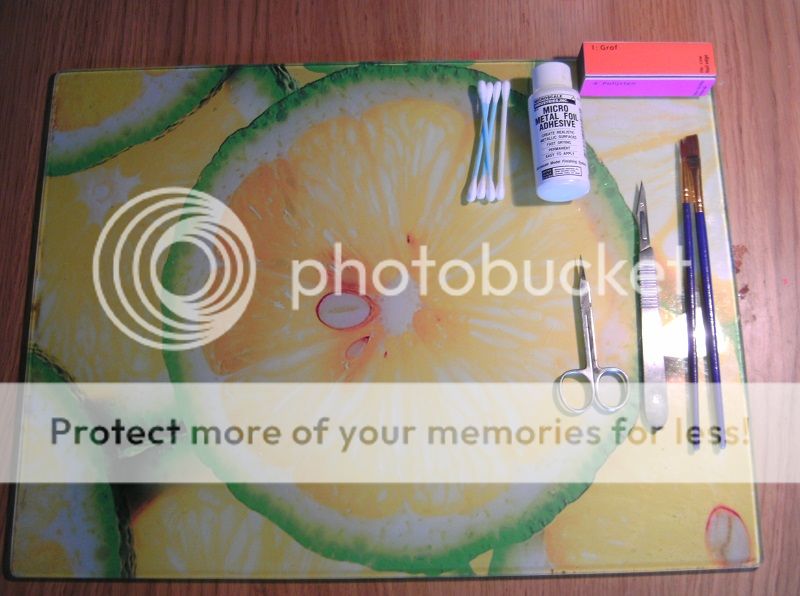

First off all what do we need.
Cotton swabs,a sharp knife,gleu for the foil,foil off course and siccisors.
(the best is that u model isnt painted)

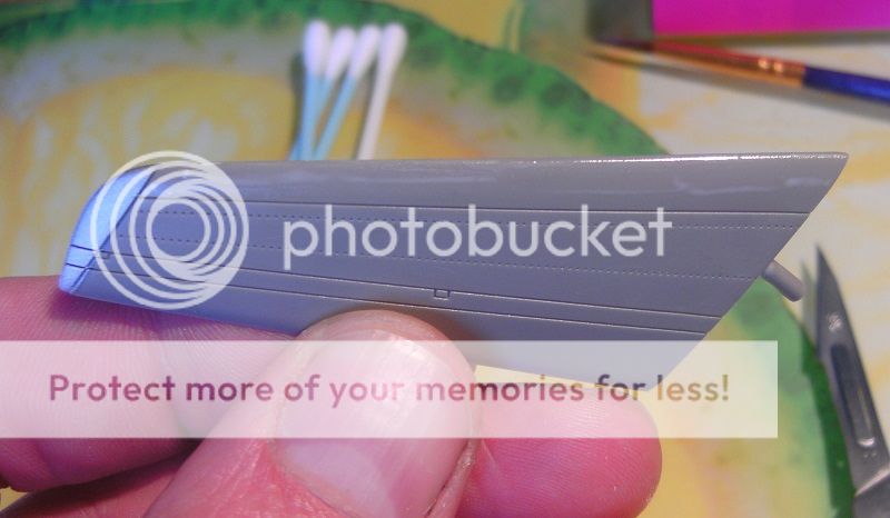

he glass plate is for the foil so u can rub it down without wrinkels.

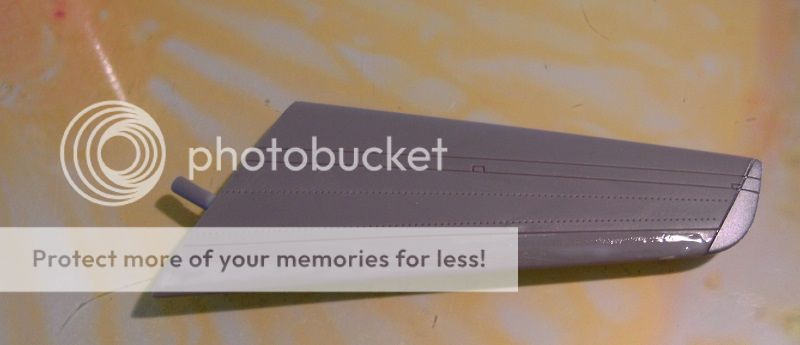

If u put gleu on your model part be shure there is no dust on it(dust is your worst enemey)
U will see that the gleu s a milky aperenc.
U have to wait untill the gleu is dryd before u put the foil on.

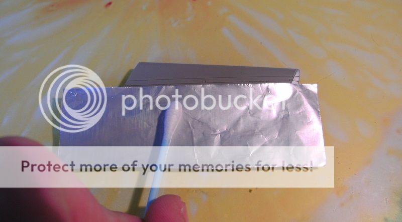

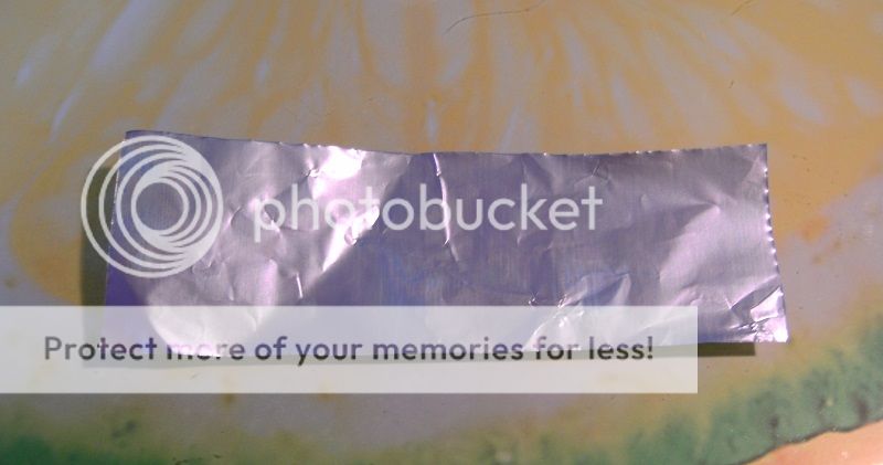

he foil is bigger then the part u whant to foil.

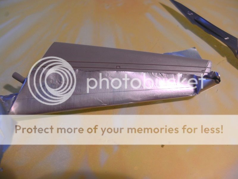

Take a cotton swab en work from the inside to the out side.
Than u have this.

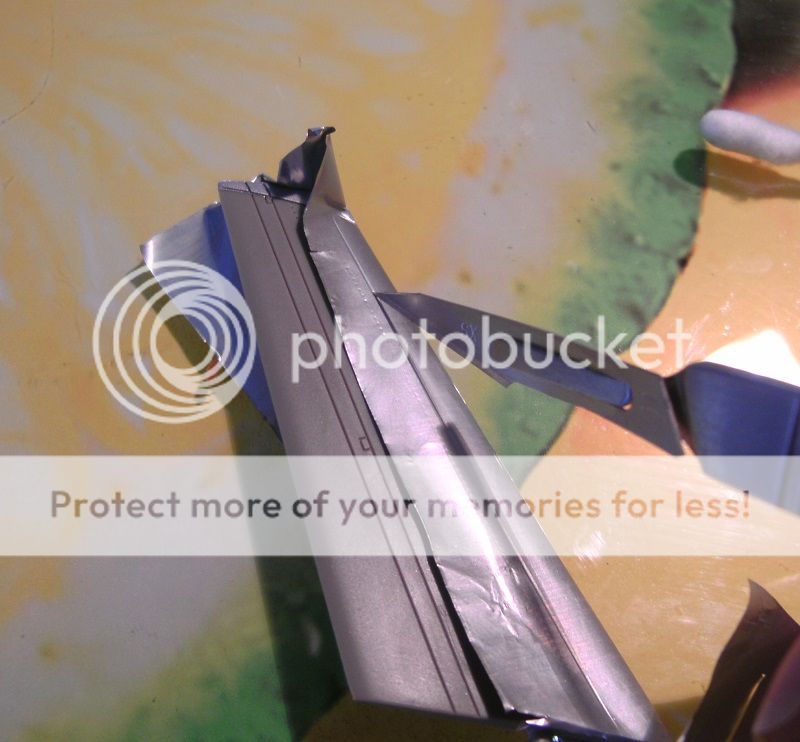

take the sharp knif to cut the foil in the panel line.
Then u can go on for the net panel.

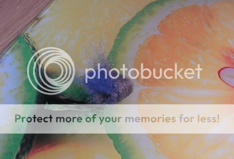

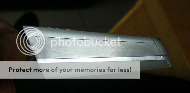

U can use steelwool to get difrent grades.
Be sure u use fine steelwool this is 000.

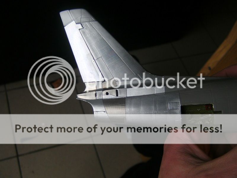

U can use eather side of the foil and dondt forget to turn the foil 90°
(if u look close to the foil u can see some markings on it)
So when u have ried it u can get good results.
