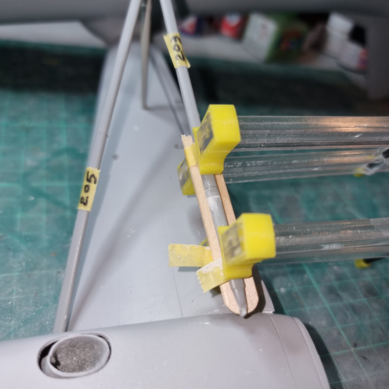

Good decision to keep adding the round rod to the spars. Over all visually it gives more depth at least in my eye's.

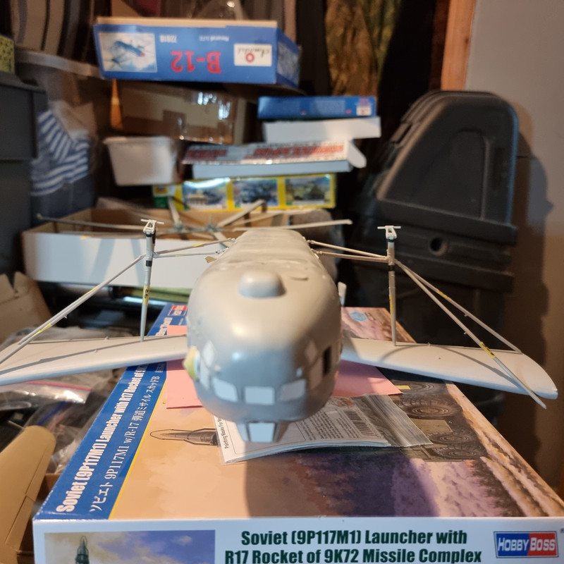

Thanks Digger. Right now I am thinking a dark wash to accentuate the line between rib and skin as well as raised section and rib. But this may change..... :)

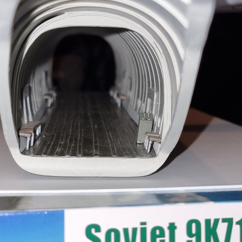

Turned out most of the issue with the seats was when I cut the upright frame from the sprue it looked like a locating leg at each end. As there were no instructions/illustration in the -12's instruction therewas nothing to reference against. However the -6's booklet DOES show them so.I had a guide and it turns out the frames are flat top and bottom. Once they were cut off and the frame base smoothed on a sanding stick they are an acceptable fit. Should have taken a photo - oh well, a job for tomorrow! :)
What do you think about only fitting them where they can be seen??

    That's what I would do. What's the point other wise after all we make these things to look at.

    The door seams came out great! I was going to vote for no rod but, seeing it with the rod makes me change my vote. They add a good dimensionality (?) to the strips

    I agree with digger and Joe, good call on the rod and fixing the clamshell doors. The rod helps tie it in with the ribs in the doors better too. And remember, those seats were bolt in or take out depending on the load configuration (at least they are in production haulers), so it should not be an issue to only add them where they are seen. As far as seated soldiers, do you really think anyone could tell the difference of the uniforms in 1/72 while sitting inside the aircraft? It would reason that you could use figures from another period, paint them in the correct period colors, and nobody would think twice. That's my take on it at least....

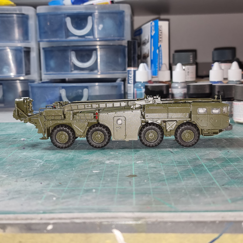

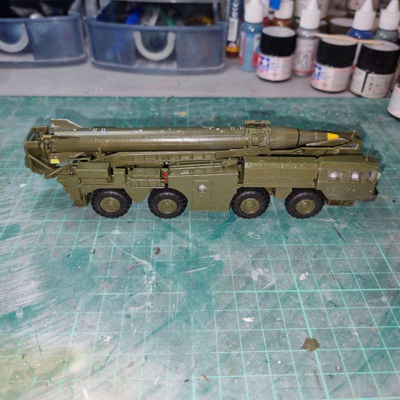

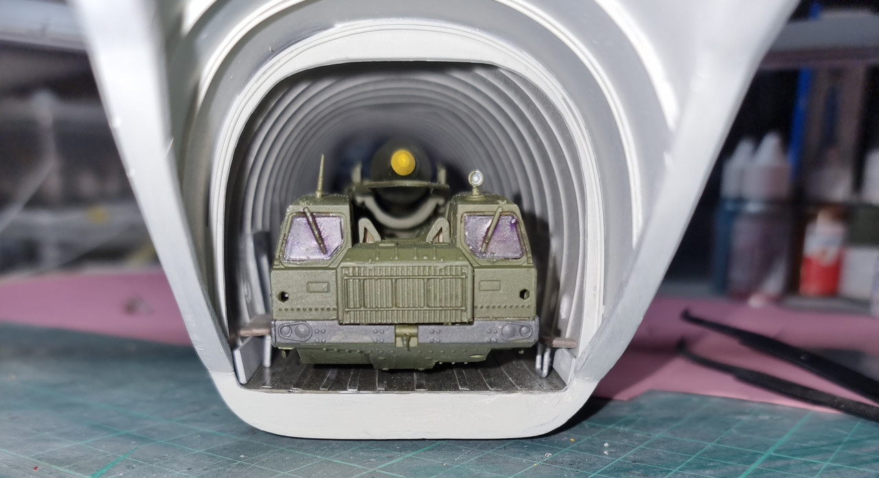

    Well - to prove a point - here is the Scud TEL - with Scud on board sat in the fuselage:
    Now - progress report! The seats are in now, where I think they need to be for visual effect:
    You can see alse see the console for the rear doors is also in place.

    Moving on - the TEL has had a coat of satin varnish which is drying overnight. If I'm happy then the lighting parts can be fitted and the Maskol removed. Mean time a start has been made on the myriad decals on the scud itself.

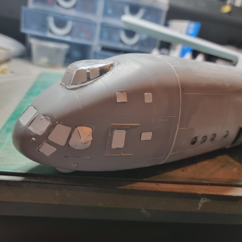

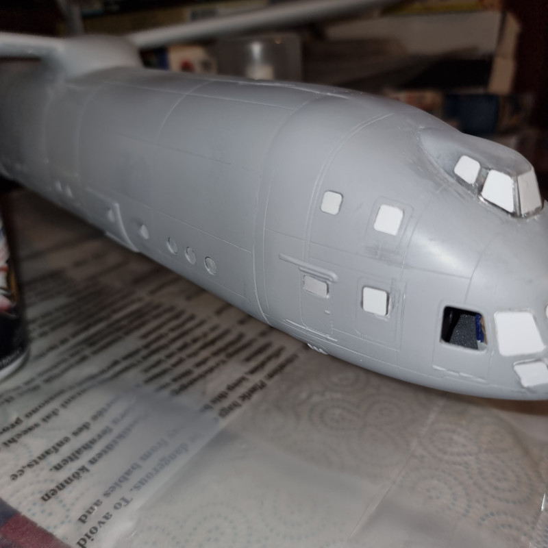

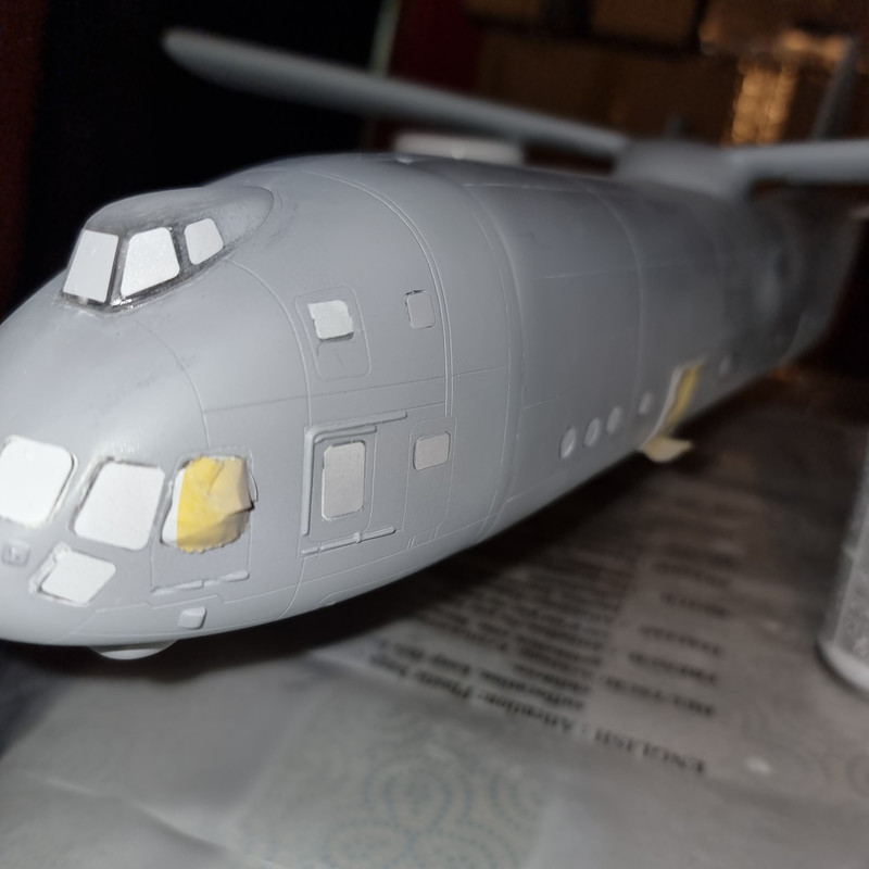

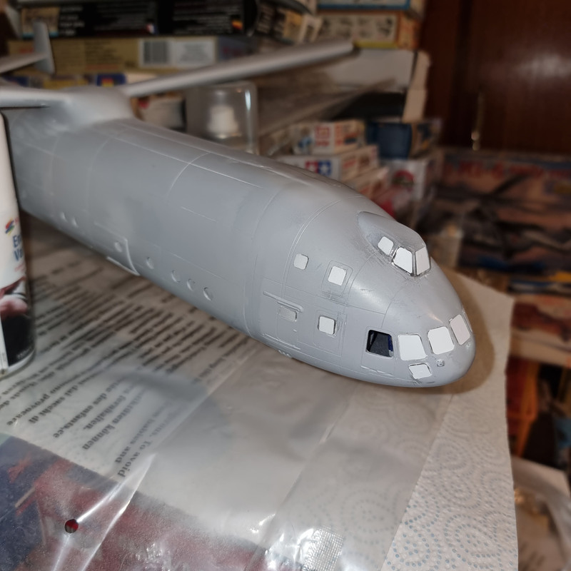

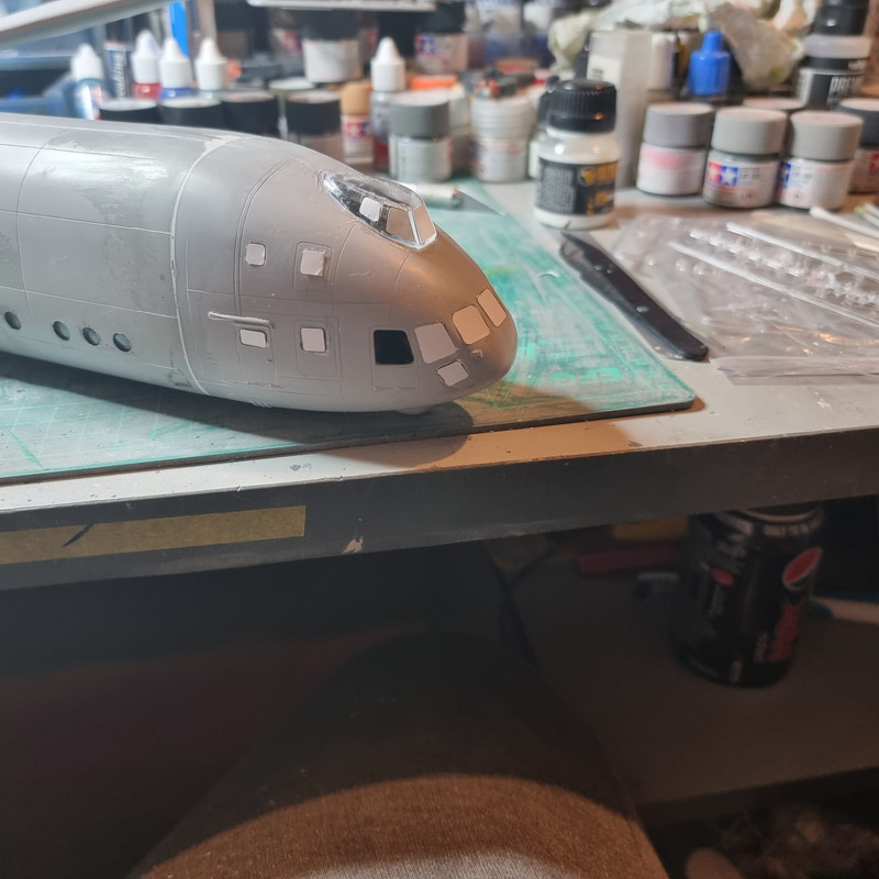

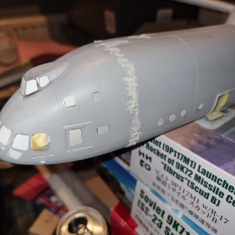

      The next major step has been achieved - the cockpit is now attached to the fuselage!!
      Looks good doesn't it - from a from a distance......
      Up close its a different story:
      And the worst of all - the underside....
      This is going to need a SERIOUS amount of filler all around - and even more so on the undeside trying to blend that package of horrors in...... :( :(
      I used the 5 minute epoxy again so thats being left to set till probably Thursday as I am out tomorrow evening.

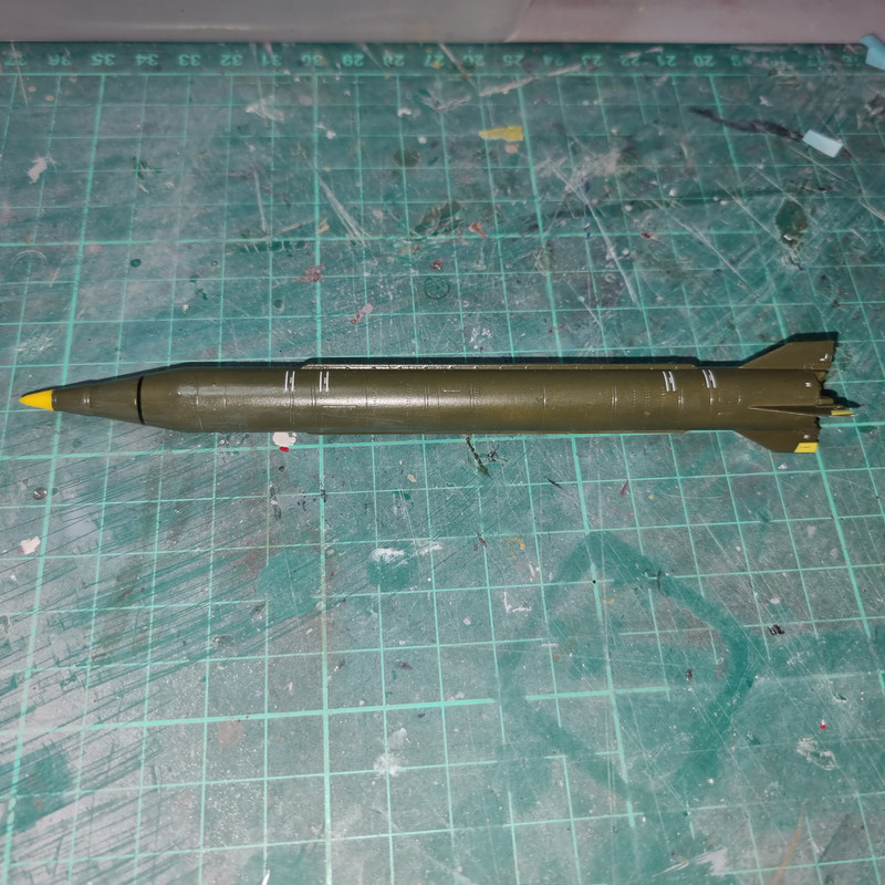

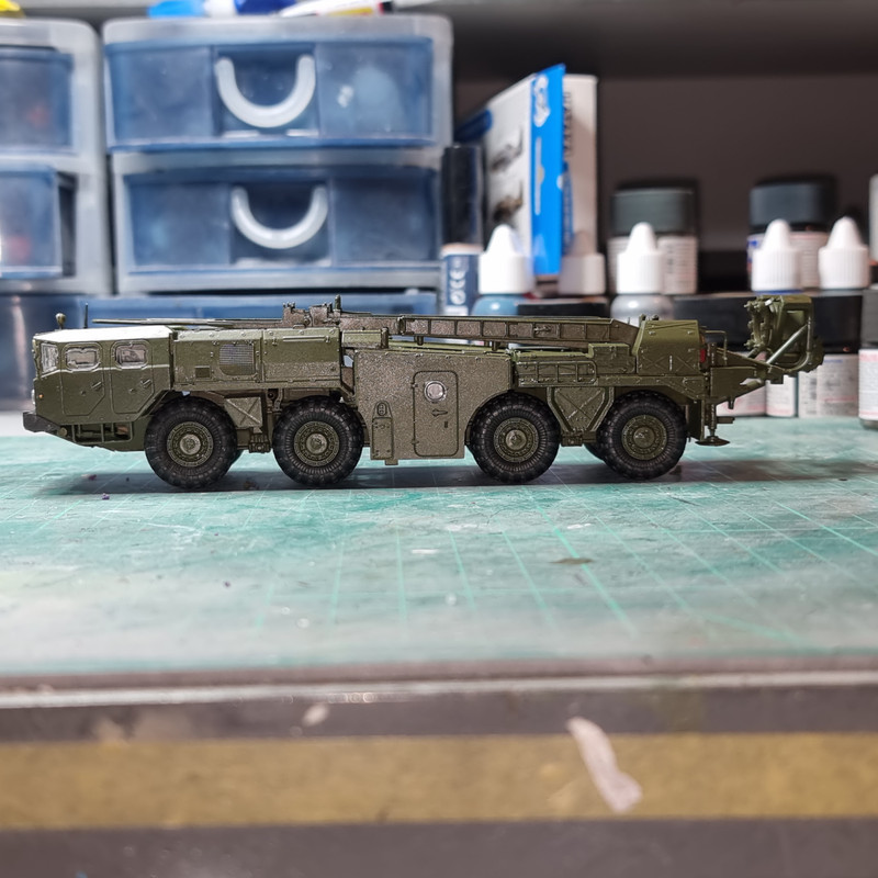

      Good news is the TEL is 99% complete, the Scud is in varnish at the moment and when its dry there are just 2 clamps to add to the carrier.

        Not sure if there is supposed to be a panel line where the cockpit meets the fuselage, but if you get a flat block with sand paper and sand on both surfaces I'm sure at least half that gap would disappear.
        Posts: 4581
        Re: Mil Mi-V-12 - the BIG one!!
        digger303 wrote: Wed Oct 25, 2023 12:01 am There armed forces did under go complete revamps of their wardrobes over 50yrs. To be expected I guess.
        Thats the gap AFTER joining them Digger. And to get that I had to sand the nose of the main fuselage back till the lip was maybe 2mm. Was 5mm.
        Whats making it worse is the cockpit section is a completely different profile to the fuselage - most of what appears to be gaps is actually one side or the other standing proud.

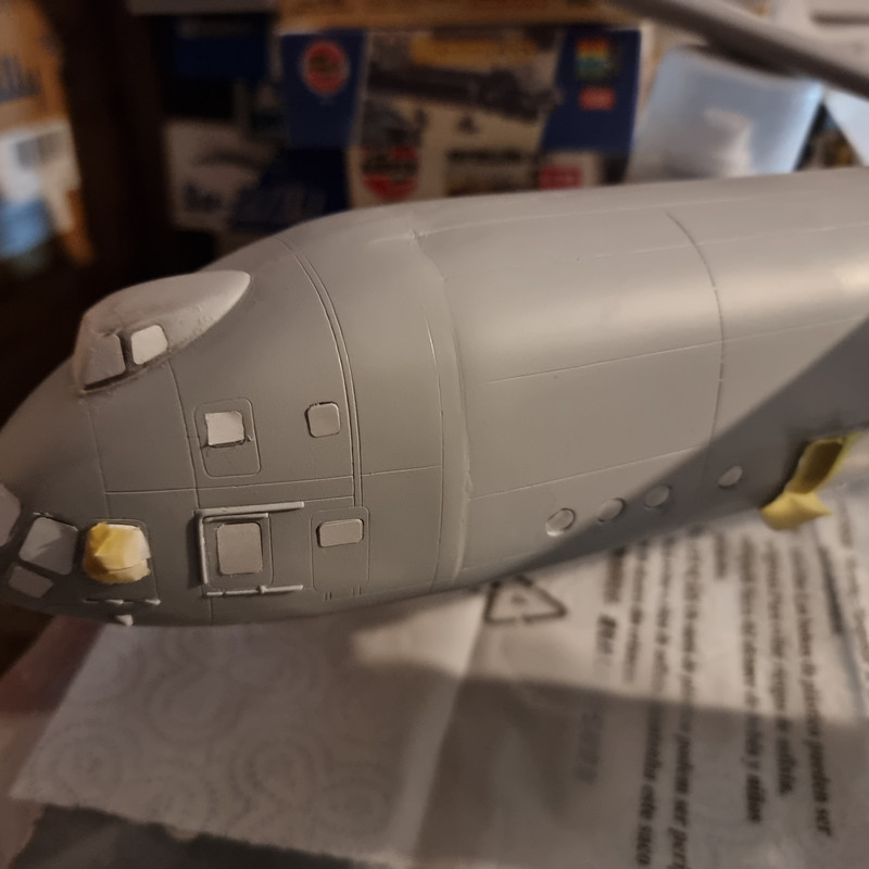

          The voids are now filled and were left to dry overnight. I tried first using scraps of plastic sheet but wasn't happy with the outcome so it was out with the filler. LOTS of filler in truth but I felt more in control of how well the voids were being filled.
          Plan is - so far - to get the actual join smoothed all the way around until I am satisfied with the finish then address the two lower corners and blend them in somehow.
          On the positive news front - payload #2 is completed.

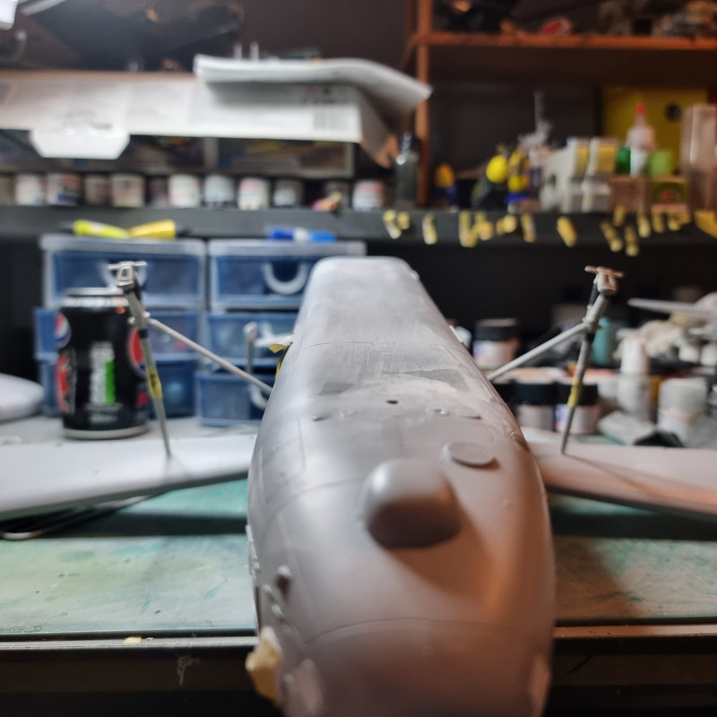

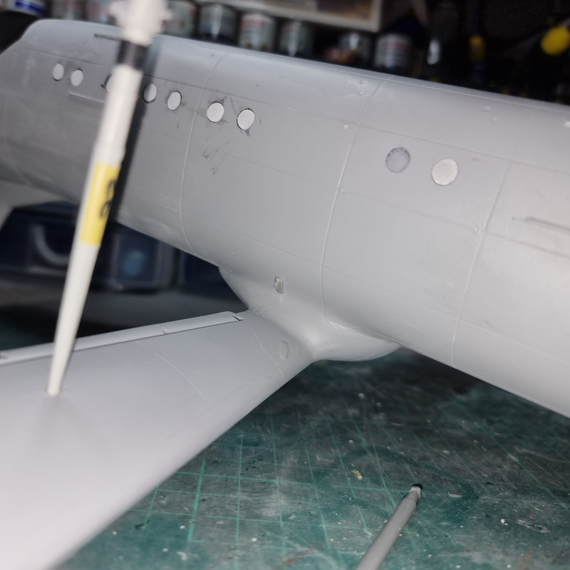

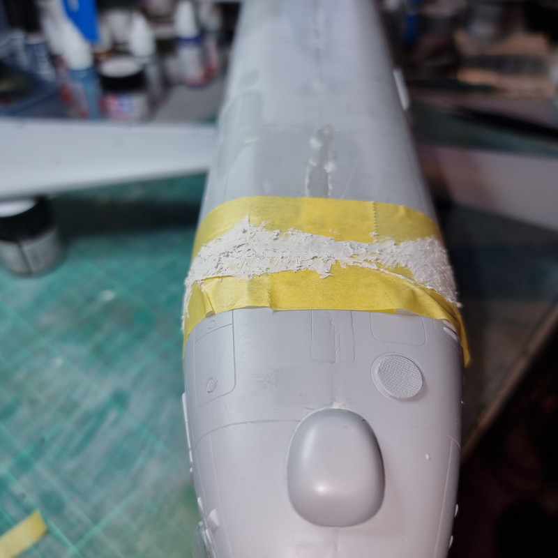

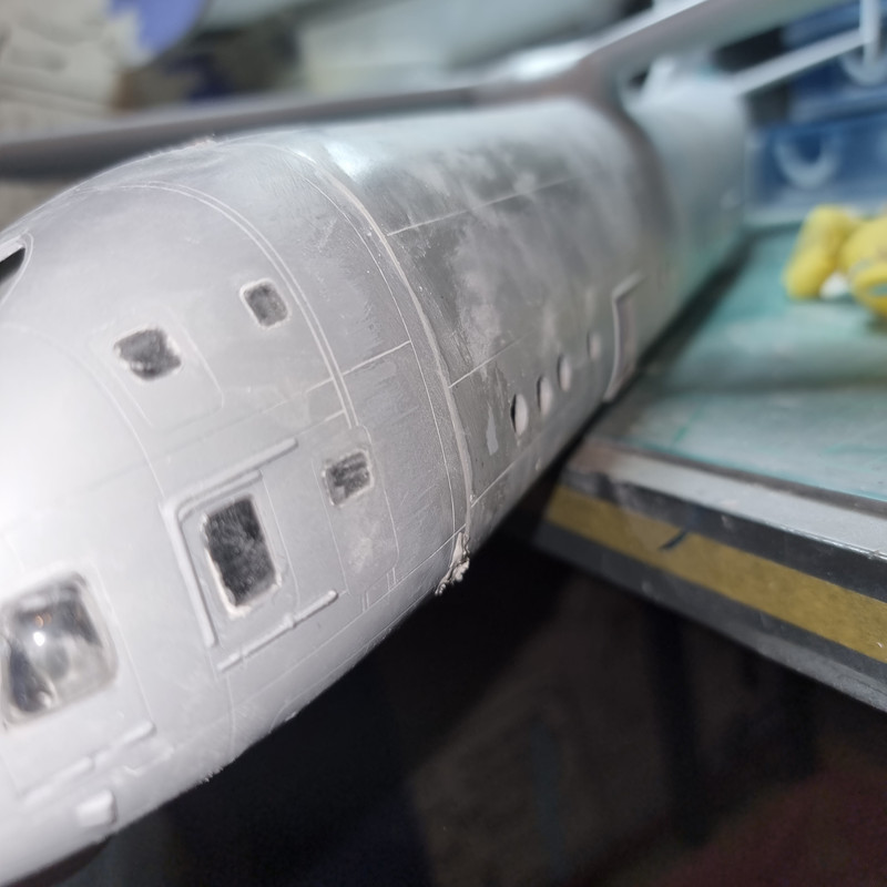

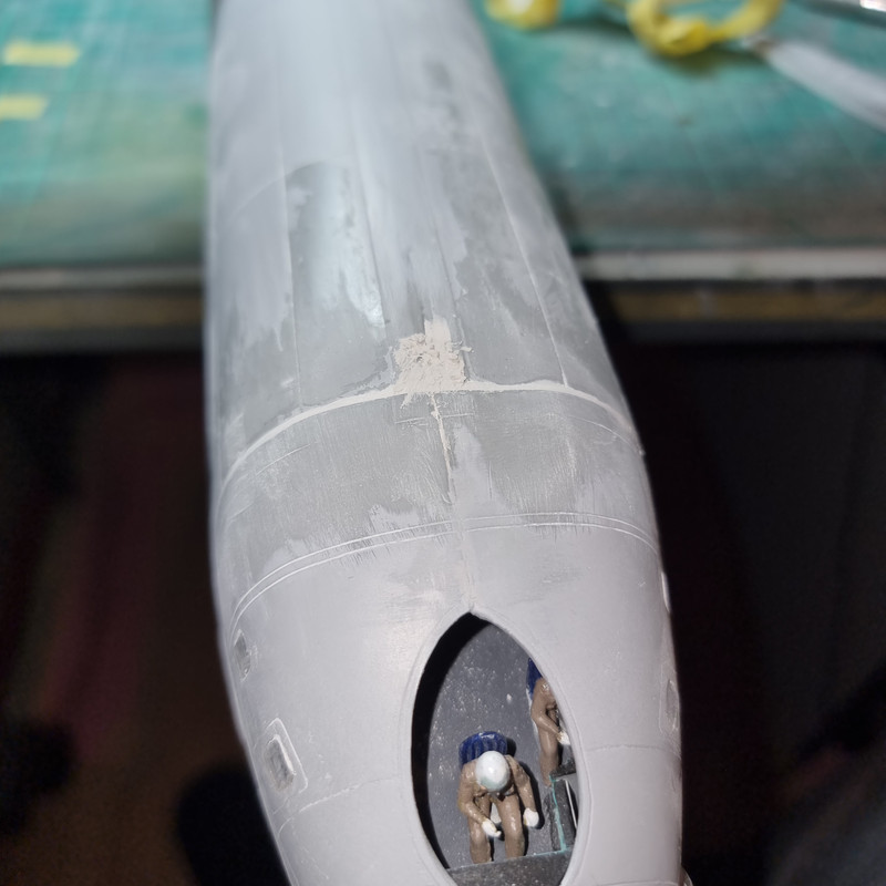

            Which brings us nicely to todays progress. After many hours of sanding - and some work with a file - the first stage of sanding the fuselage/cockpit join is done. The sides, although a large gap, have started levelling nicely.
            The top and bottom are a different story. The top of the fuselage has a 10mm wide spine that should have matched a "peak" on the cockpit roof. I don't think the designers of either part were talking to one another as the entire cockpit is the height of the spine so its a case of filing & sanding the areas either side of the spine to create the "peak" on the cockpit roof. Getting there slowly - VERY slowly.

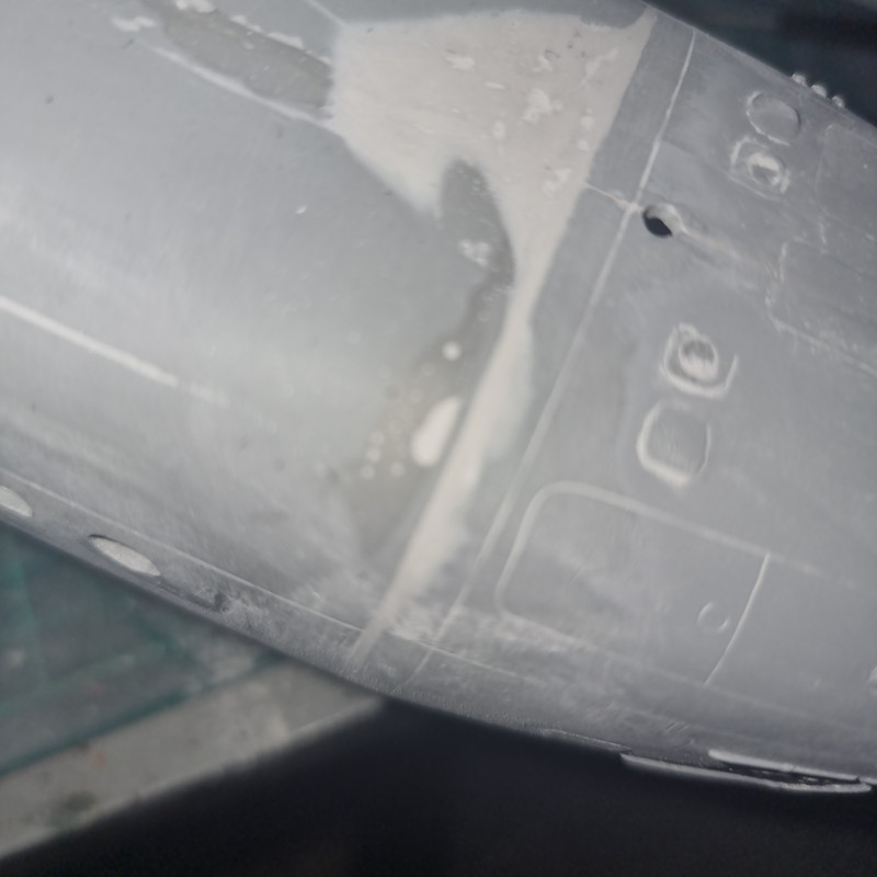

            The bottom - man, is it weird! :( The corners of the fuselage are a lot squarer than that of the cockpit so I either:
            1) Pad the cockpit with filler to blend the corners in. This will lose a lot of panel details that will need to be re-scribed.
            2) Sand the fuselage corners down to match the cockpit. A lot more work with the risk of going through the resin/matting at the extremities.
            3) A combination of (1) and (2).
            The initial plan is to go for number 2 and if the matting becomes exposed adjust to number 3. But to add to the fun the centre of the fuselage has sagged during the moulding process so the corners are higher than the cockpit but the centre is lower.... Figures..... So the centre line has to have a roughly Vee shaped section of filler to bring it up to the level of the cockpit.

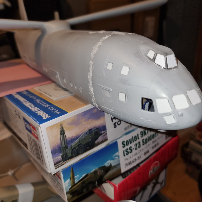

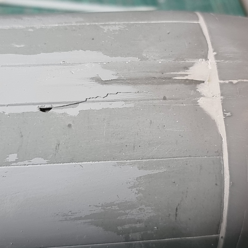

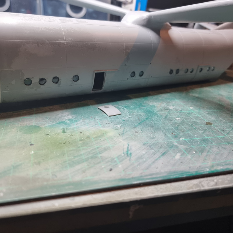

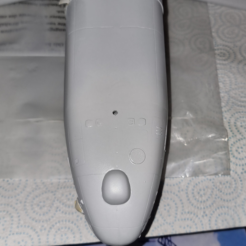

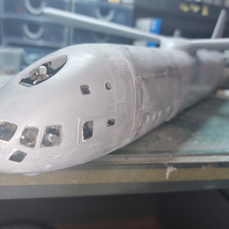

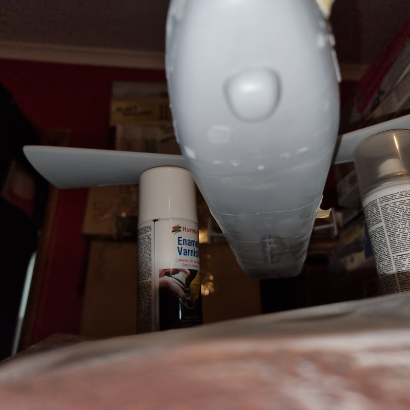

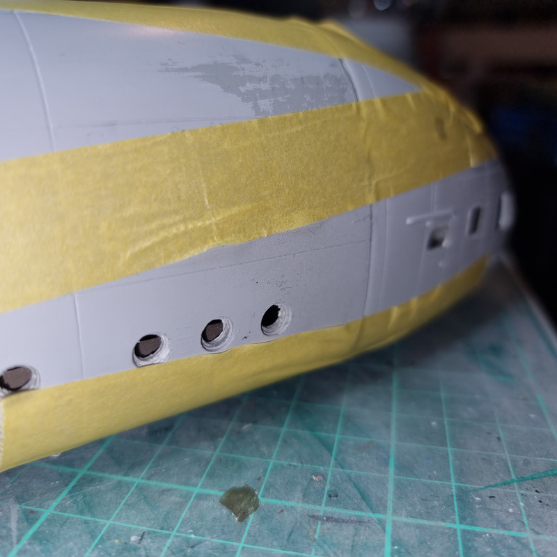

                After something like 6 hours of sanding today we have progress - and a set-back!! Come on - who DIDN'T expect that? :)
                However the set-back didn't ocurr where expected. Working on the top of the fuselage a hole appeared in the resin at one side so that had to be filled. Hopefully just an air bubble but time will tell tomorrow.
                Other than this works progressing not too badly. Apart from that hole the top and sides are about ready to pass the thumb nail test for edges.
                This just leaves the underside. Here again the corners are gradually blending in so maybe tomorrow or the day after they, too, might pass the thumbnail test.
                Once its all done and I'm happy with the look and feel the next step is to lay a coat of primer over it to see what that reveals - i.e. how much more work is needed and where. But before that can be done the fuselage windows need to be fitted and then the masking kit applied to them and the cockpit windows.

                  Looking good. It appear that you were able to keep most the detail and panel lines even after the layers of putty. Lets hope the primer does not reveal too many variances that need attention. Although I've been following along, I kind of remember but not sure if you mentioned, is this going to be the civilian / prototype colored version or will you make is a "what if" military paint scheme (considering the military payload)?

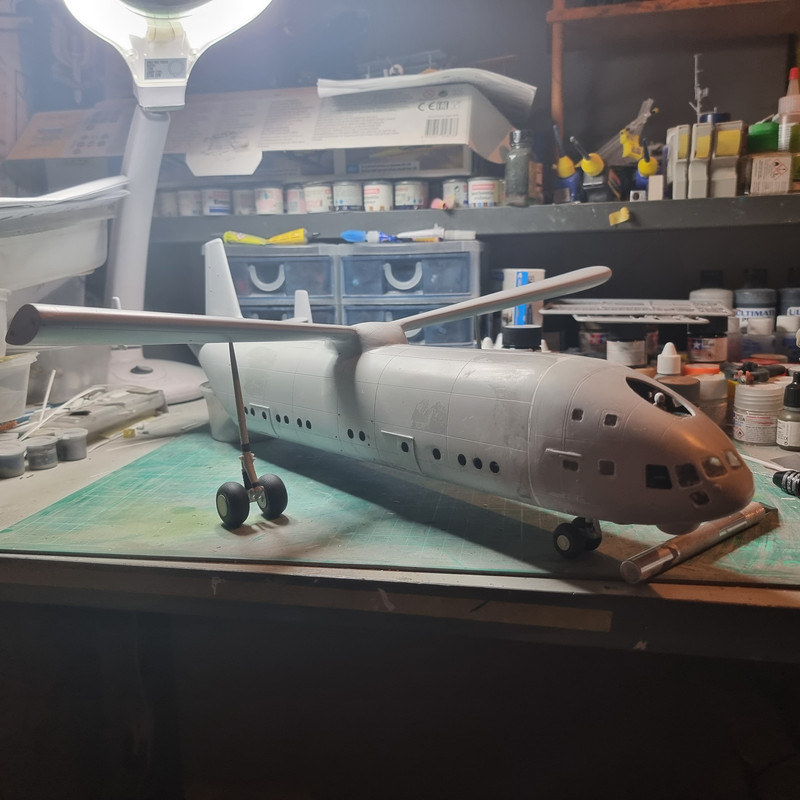

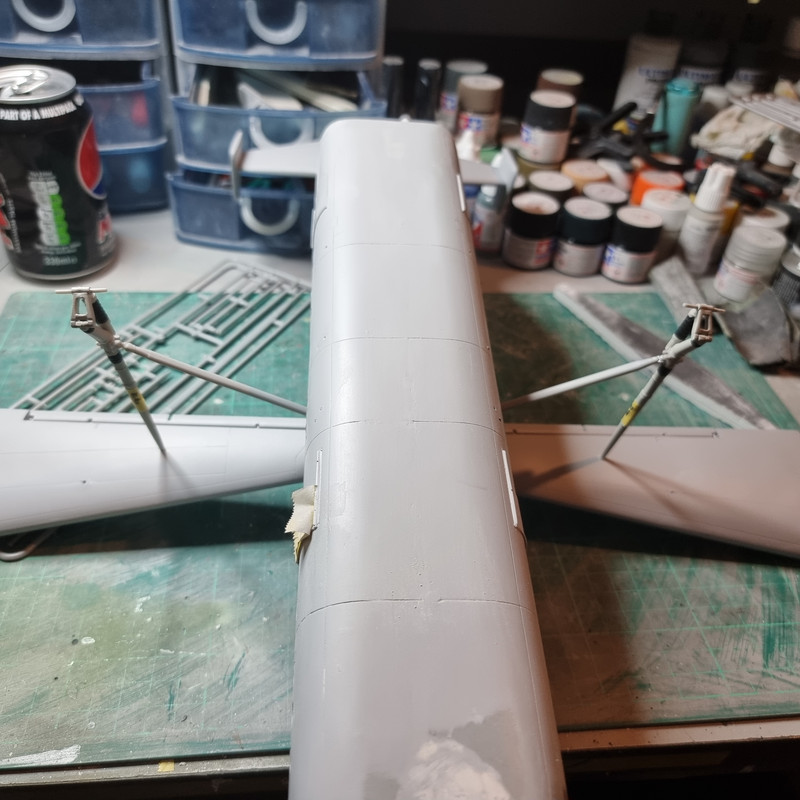

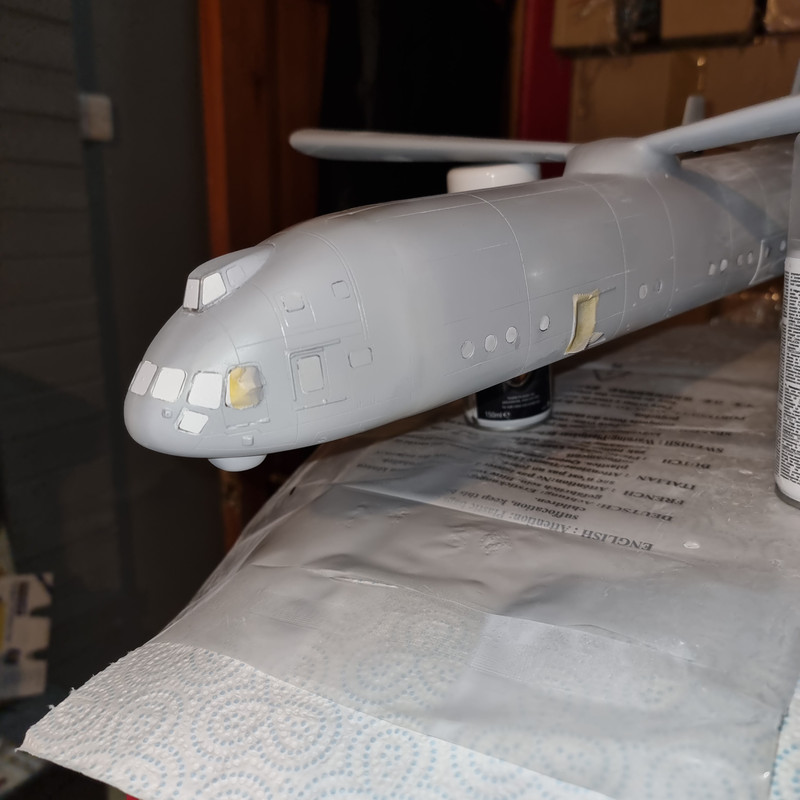

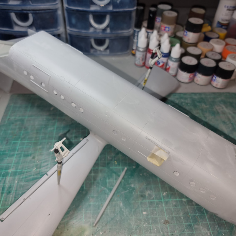

                  Another few hours sanding and its is virtually there. So close that I decided it was time to paint the recesses for the cabin windows prior to fitting and masking them.
                  And, just out of curiosity, the question of "will the undercarriage take the weight" is answered. Here it is standing on the as yet unsupported/unbraced main undercarriage and nose gear:

                    Now it's starting to look like something, ...something big. Nice work on the fuselage joints.

                    Freaking Monster :eeek: :thumb1:
                    I'm thinking the nose wheel looks not so strong and wondering what fit issues might arise when fitting wing tips.
                    If there are any it's going to be tricky not breaking anything while you sand the filler off.
                    Did you buy enough paint ? 2 pots for each colour coat.

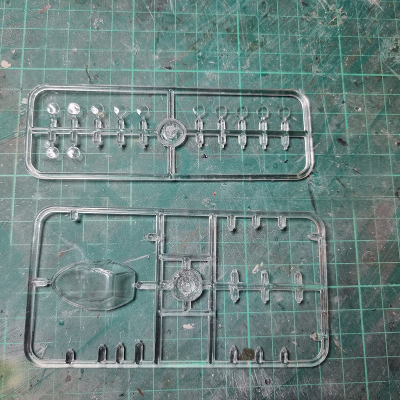

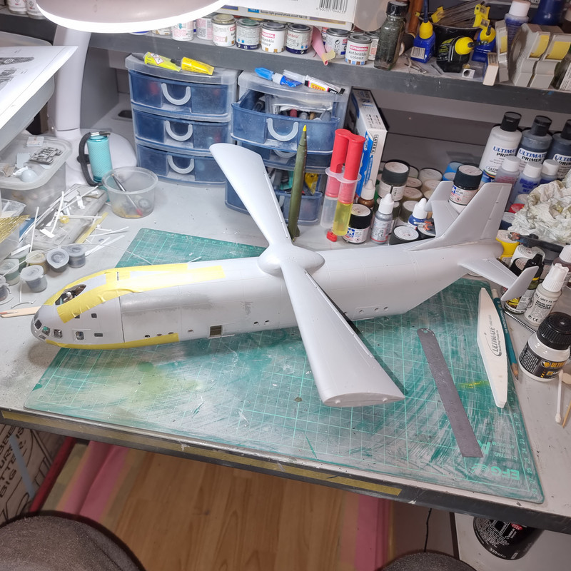

                      Fuselage windows are now in. I used Ammo's Ultra as the adhesive so they arexbeing left to dry overnight. Tomorrow the plan is to make sure all are clear, give a polish to any that have maybe got the adhesive on the surface and then apply the masks. This is where a small issue arises - the masking kit provides 26 circular masks - and there are 28 windows!!! So I'll have to use Maskol on one each side, probably one of the central ones obscured by the landing gear braces.
                      The cockpit windows are all masked ready for primer on the nose to fuselage seam.
                      Amazingly there are quite a few spares for the fuselage.
                      Thats where I stopped for today.

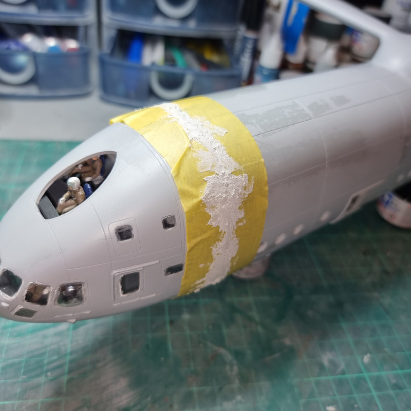

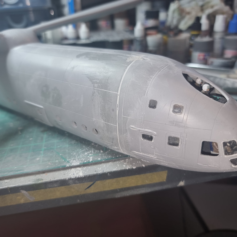

                            First on the bench today, I masked up 26 of the cabin windows using the masking kit - and two using Maskol. One of the things I noticed in daylight once the masks were on is a few windows have gone in at odd angles. Can't do anything about it though, just got to hope they don't stick out like a sore thumb once the paint goes on!

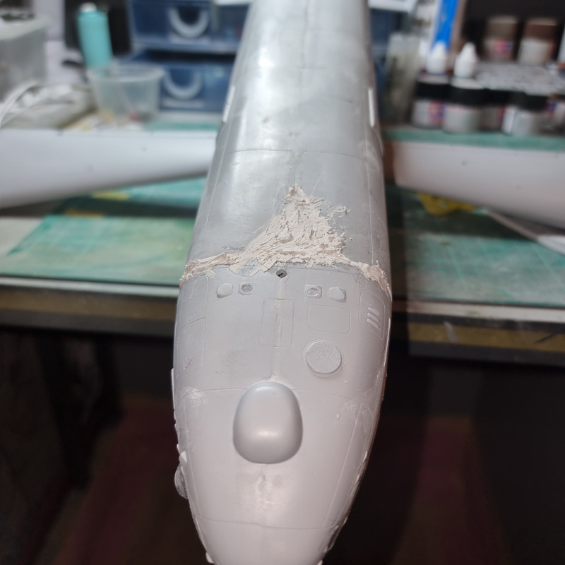

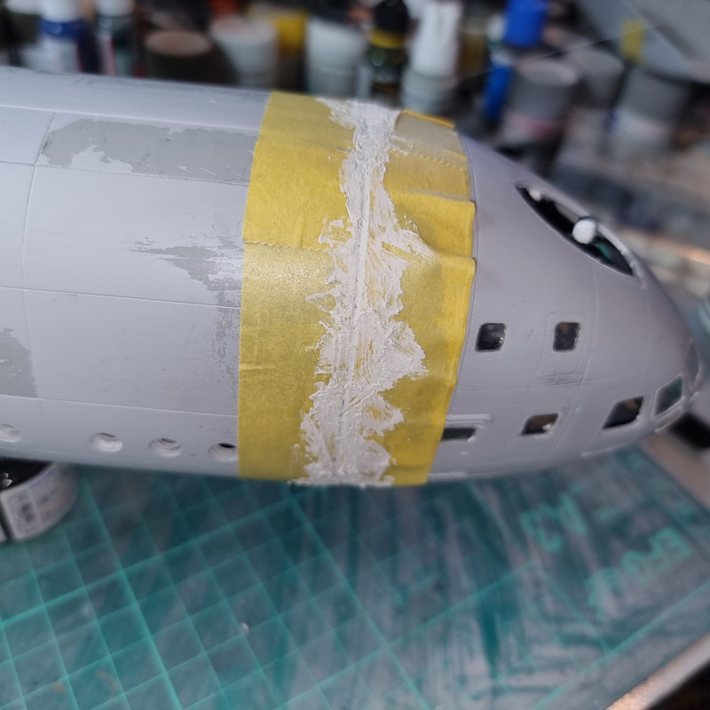

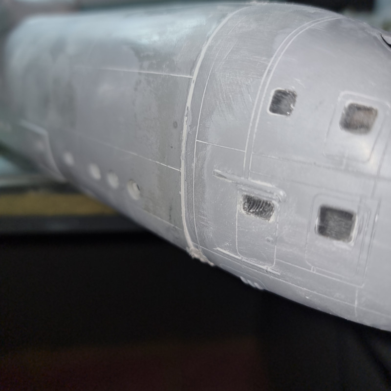

                            That all went well so I turned my attention to finishing the filler. And just to cure any potential complacency the damn thing bit me. Again. There must have been a void in the resin because this happened.... :(
                            So that had to be treated, the hole was filled and I fed CA into the crack with a toothpick then skimmed that with filler. Whilst that was drying I cracked on with the floor problem on the Mi-6.

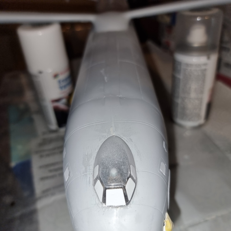

                            Once that batch of filler was dry it was - gently - sanded down and then the primer was applied
                            First sight - didn't loook too bad! But I'll wait till daylight tomorrow before passing judgement. :) I don't think much will be needed though, looks mainly around the top.

                              After a close look at the seam today in daylight its not as good as I hoped but not as bad as I feared so I'll.call that a win situation.:)
                              The filler is being left to dry thoroughly overnight so hopefully tomorrow will see this particular job done and dusted and then I can start tearing my hair out over the undercarriage bracing!!
                                Hobby Boss 1/350 Surcouf
                                Mikro Mir 1/350 HMS M1
                                Posts: 4581

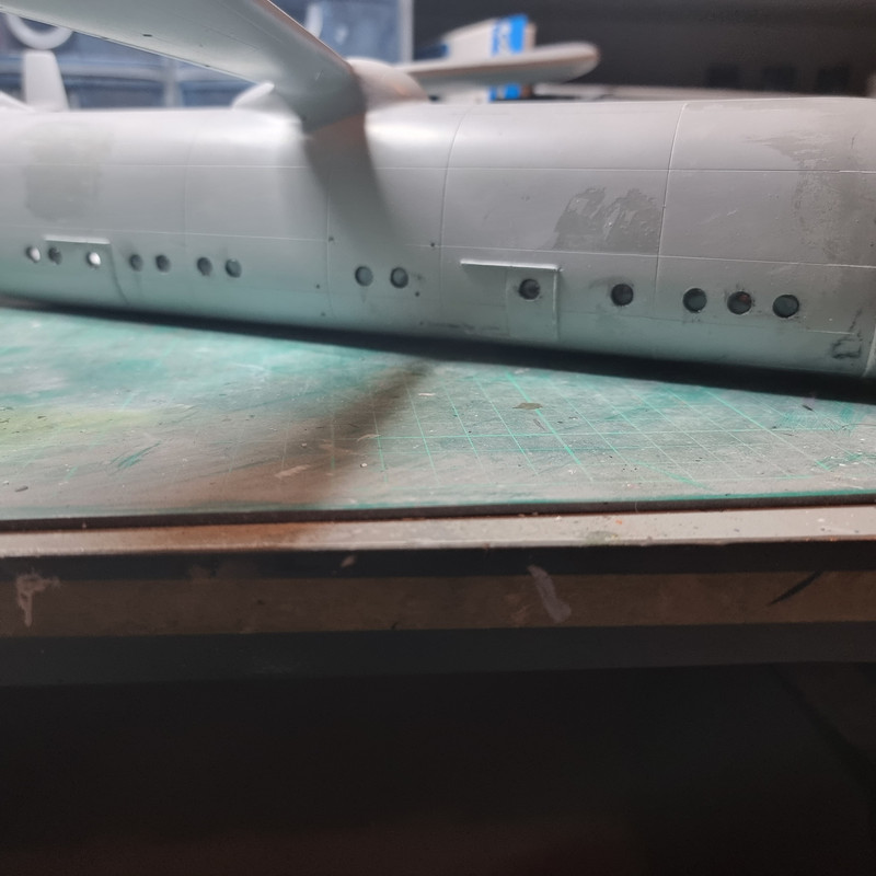

                                OK - I am calling this seam done. I honestly don't think I can get it any better and not lose my sanity in the depths of tubes of filler and sanding sticks.
                                So - just need to rescribe some panel lines and then we move onto the main undercarriage and its myriad bracing struts on both sides.....

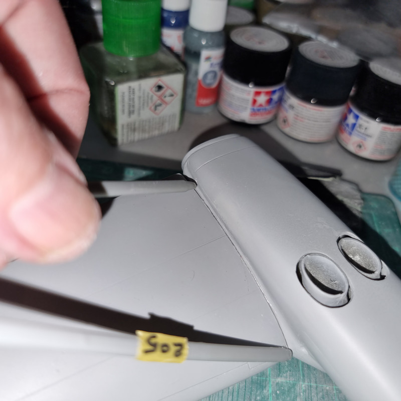

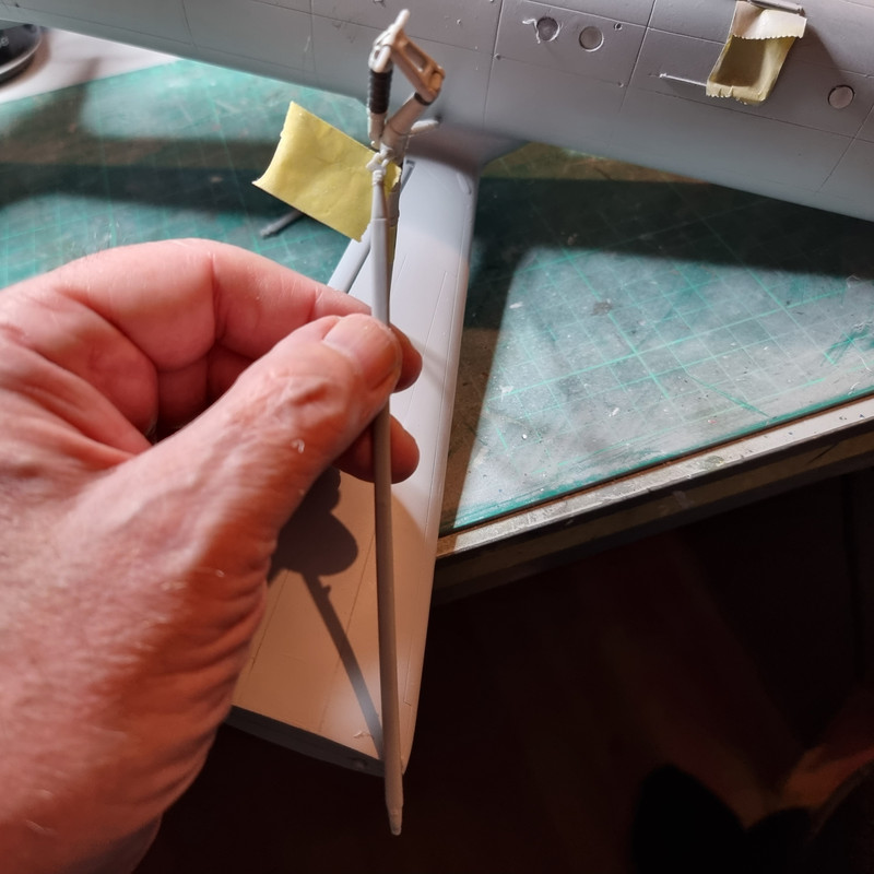

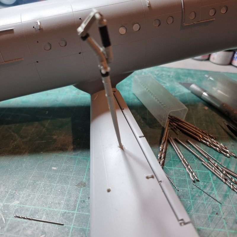

                                  Work resumes at last on the big bird. I took the option , when I bought the CA, of getting the slow setting form and already this has paid off.
                                  The main undercarriage legs are now in the wings - height to axles checked each side (92mm) and the alignment vertically and across the assembly.
                                  And the first of about 40 teeny weeny mounting brackets is on each side.
                                  In case you can't see it......

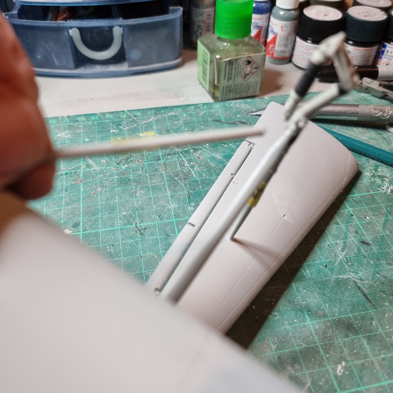

                                    Started back on the bigger Mil tonight. Firstly I found - probably to be expected - that none of the brackets, rod ends and fixing points fitted without a LOT of work in thinning out pads and opening slots. I got the main leg to body braces on and was a bit disturbed to find I had to move the undercarriage legs outward to get that end in. Which then put the axles at odd angles.
                                    I then went to add the Vee shaped lower braces from the fuselage to the undercarriage legs.
                                    Surprise surprise - they are some 10mm short..... :x
                                    I've checked and rechecked to make sure the correct brace has been used - it is. And also that the upper mount is the right position - it is. So I think I need to break out the CA debonder tomorrow and release the top mounts, reposition them and see if I neeed to take a section out of the brace length.
                                    Meantime the outer brace mount points have been fitted so I can try them first because if I am right - these will look to be too long!!
                                    This kit is seriously doing my head in!!!! :cry:

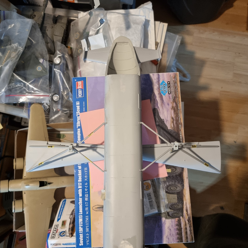

                                      I tried the outboard braces late last night and, as expected, they were too long. So I popped the top mounts off to let the under carriage legs spring back and most every thing else fits - more or less.
                                      I'm leaving those inboard ones loose at the top for now until the others are in place then I can work out how much I need to shorten them.
                                      Typically Amodel - they actually provided location holes for the brace mounts on the resin wings and fuselage - but then half the mounts don't have the corresponding pins on their undersides so positioning them is a case of best guess/trial & error. Getting that slow setting gel CA is really paying off now as I can tweak the positioning to suit.

                                        Yes, panel lines will rescribed once I get to a point where it won't interfere with other work - or vice versa!! Still looking for a suitable set of figures. Saw a set on eBay - Revell cold war Russians if memory serves - but got out bid - by quite a lot!!!
                                        It turned out to be easier to remove those struts as they kept catching on panel lines and such. I'd have needed a 3rd hand to have left them on. :(
                                        You can see here how much its pushed the the outer struts out of place:
                                        With the inner struts removed and the legs back into place the outer brace and the lower inners fitted relatively (this IS Amodel we are talking about!!) well. So I flipped the model around to do the other side, cut the first of the struts off the sprue, reached for the mould line remover - and disaster!! My hand caught the unbraced leg and SNAP!!! What I'd feared since starting this phase happened, the leg snapped off at the wing surface...... :cry: :cry:
                                        After a comprehensive bout of swearing VERY loudly - and barely resisting the urge to open the window and launch the bl@#dy thing I got a grip and looked at the damage. And started swearing again. I was worried a solid leg would be a weak spot - this was hollow!! Inner bore was only 0.5mm but enough to weaken the leg. A quick raid on the wifes dress making supplies yielded a 0.6mm dia pin that was cut to length, pushed into the leg with CA and then into the stub in the wing, again with CA. That got me a leg back in place.
                                        This was then set aside to set hard whilst I had a go at the Mi-6 fuselage, another wonder of Amodel design excellence..... :evil:
                                        After an hour or so I checked the hardness and it was OK to continue so the outer and inner lower braces are now on and drying.
                                        The rearmost outers are unsecured at the outer ends as they locate onto brackets that gomonto the engine pods and those don't go on till the end.

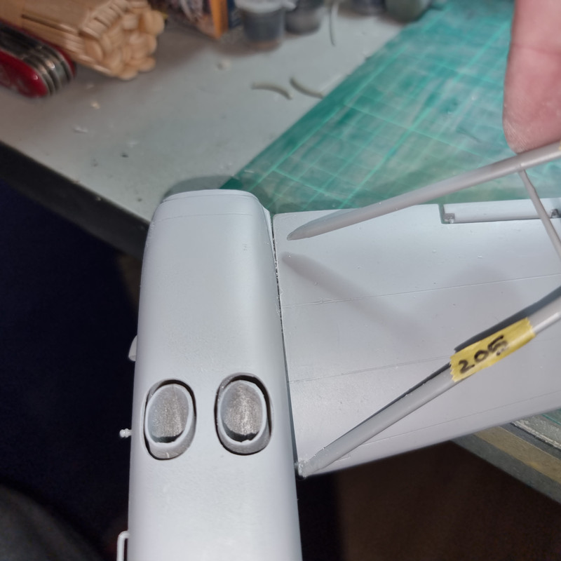

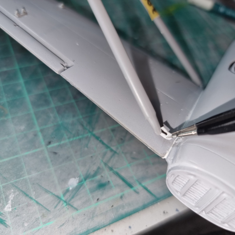

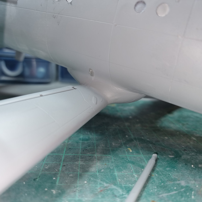

                                          Engine pods went on today, not supposed to go on yet according to the instructions but the rear outer brace goes onto a mount on the side of the pod. I thought they looked a bit short for where they are meant to go and with the pods on it seems I am right :(
                                          On the positive side the basic bracing is completed. Just got to add the 4 intermediate braces and its completed. Taking the weight of the model nicely too.
                                          I had to cut 12mm out of those vertical inner braces to get them to fit. There was a step at each end so I cut the top end off at the step with a razor saw, cut 5mm out of the strut, measured it up - still too long so cut another 2mm. Still too long so I cut another 2mm and it fitted perfectly.

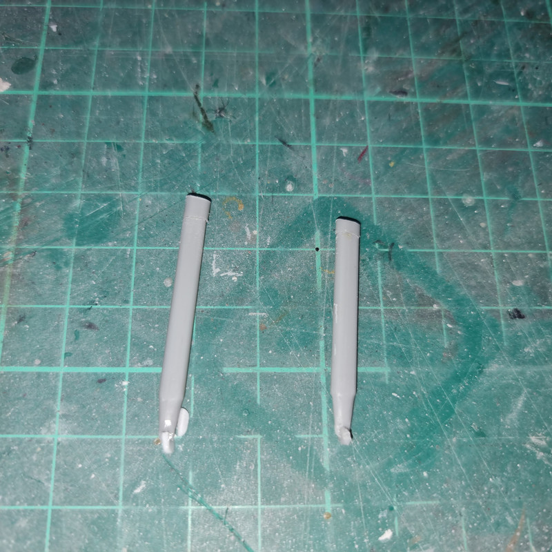

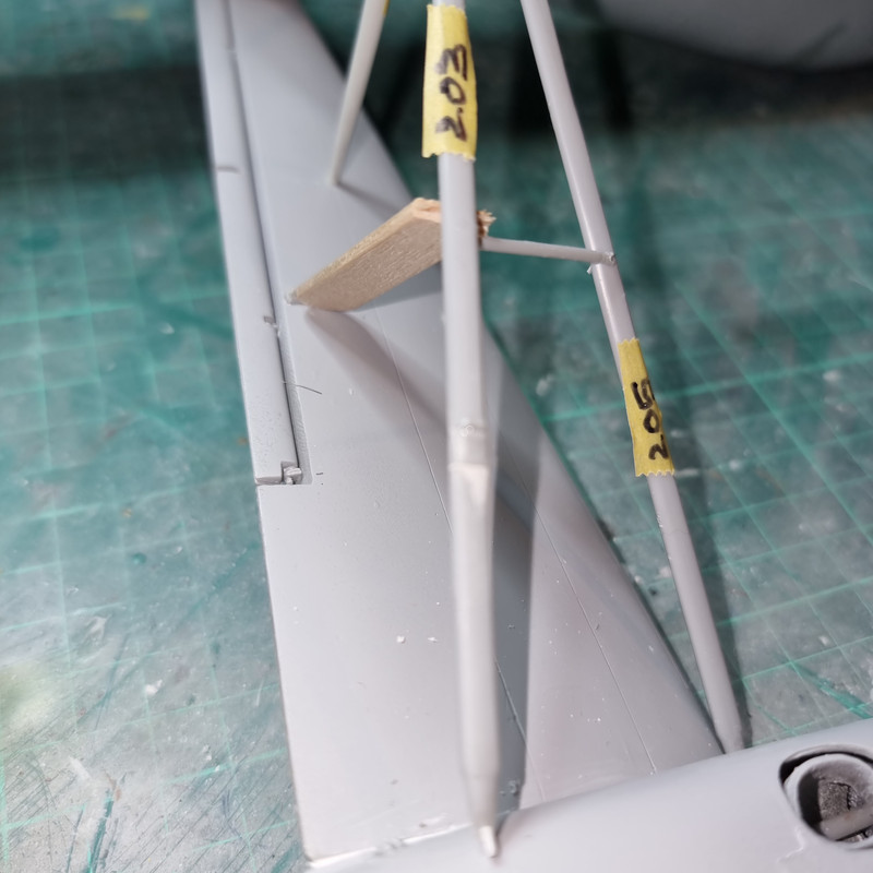

                                            As expected the rear outer struts were too short. But heres the odd thing - not by the same amount! One side was out by about 2.5mm whilst the other side was out was short by about 5mm.
                                            Luckily I kept the sections cut out of the inner vertical struts and they are the same profile. So the struts were cut by saw and then 2 of the cut out sections shaped to fit.
                                            These, again, are being left to set overnight even though CA was used to join them. Tomorrow they get joined to the main body of the strut - and again left for 24 hours to set before filling and sanding.

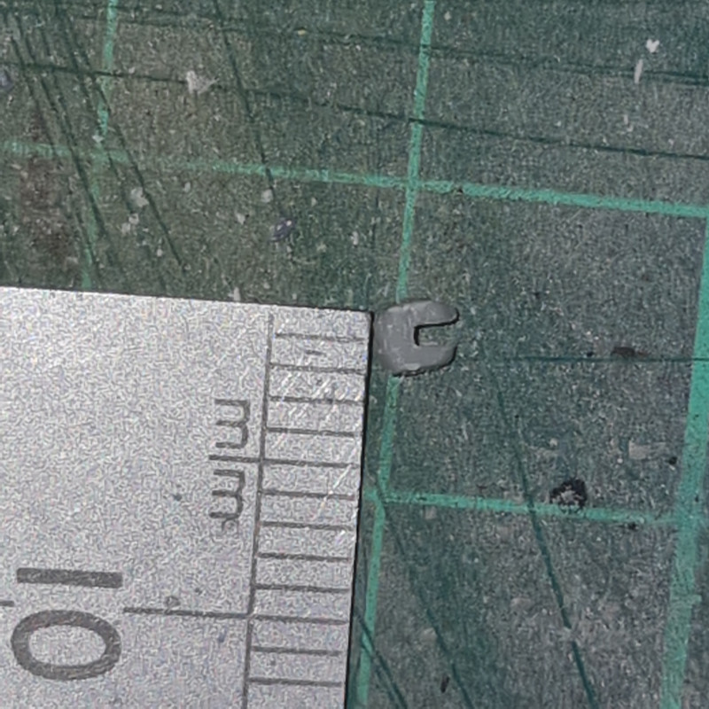

                                            Annoyingly one of the teeny weeny connectors between the strut and the engine pod pinged off into the jaws of the carpet monster so I had to make another from plastic card.

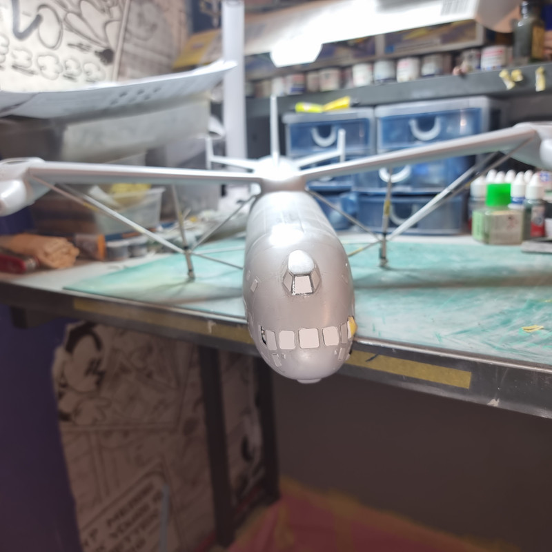

                                              Back to the beast now. After a few hours today one strut is lengthened - but had sagged despite being clamped so its had another dose of CA and is propped letting gravity remove the sag.
                                              The other side is glued and clamped and setting overnight. Hopefully this one won't sag so tomorrow the gaps can be filled and sanded. But I'm not holding my breath........
