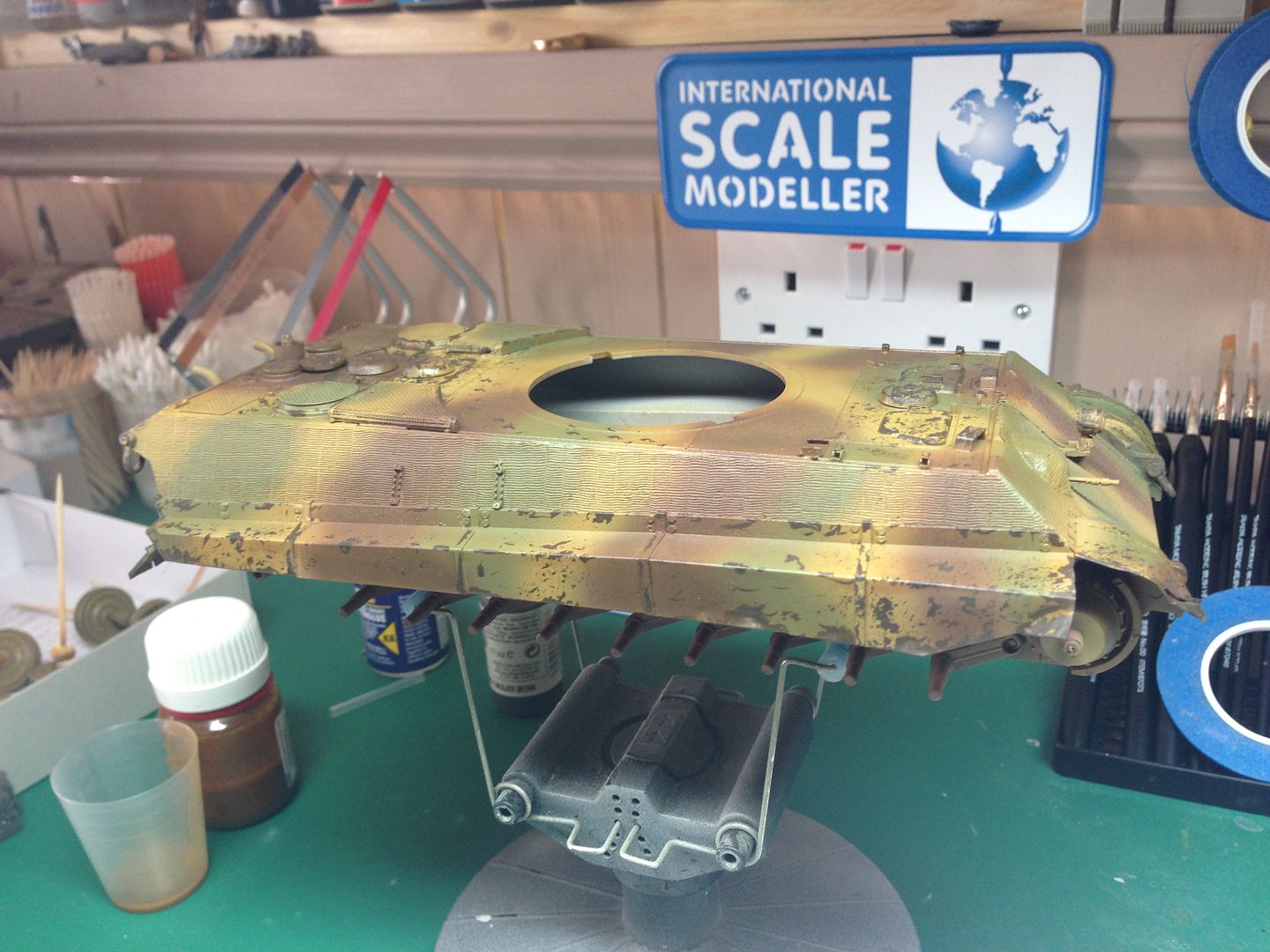

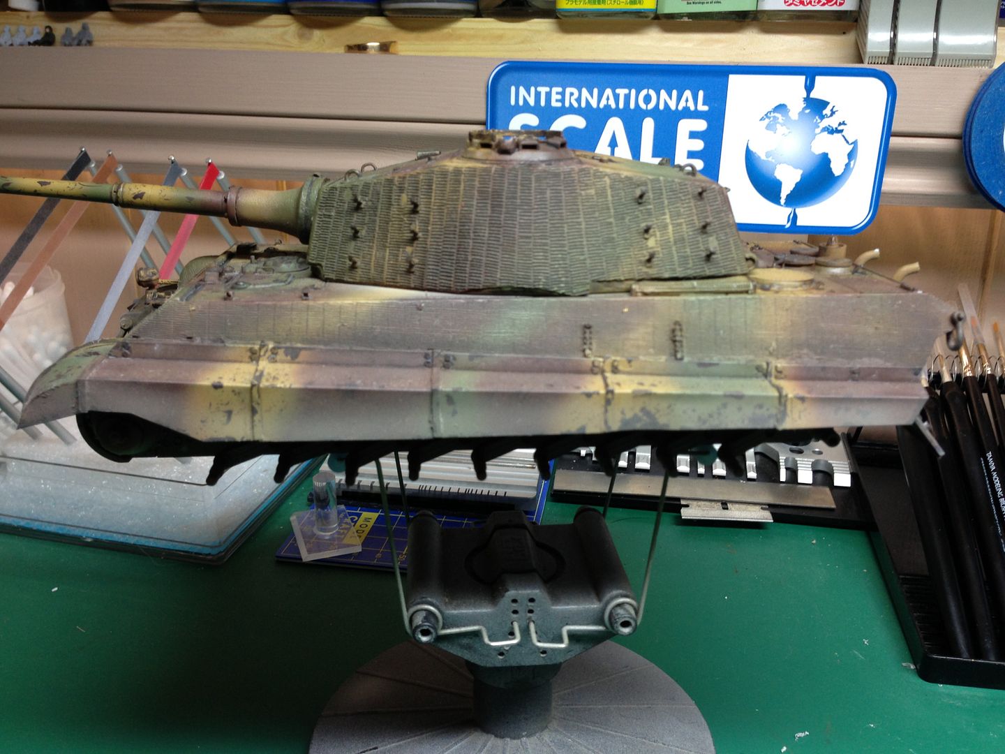

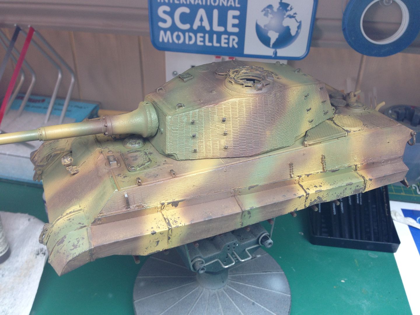

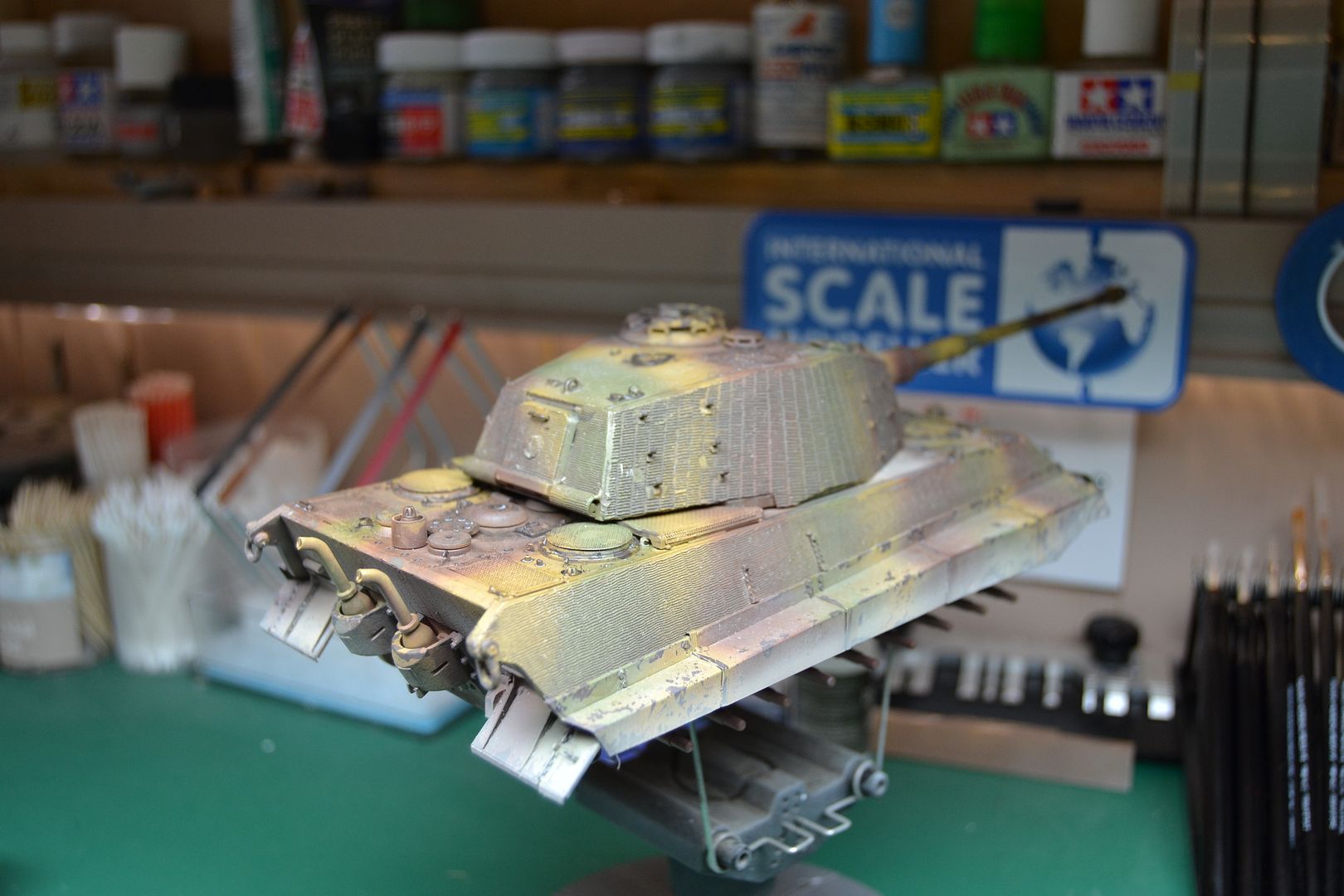

Started the weathering on the KT
My weathering stages using acrylic paints and washes with enamel based filters so they don't react with each other.
Paint (acrylic)
Chipping (acrylic)
Filters (enamel)
Pin wash (acrylic)
Oil rendering (mineral spirit)
Pigments dust effects
Airbrush dust effect
Pigment mud
Stains and streaking

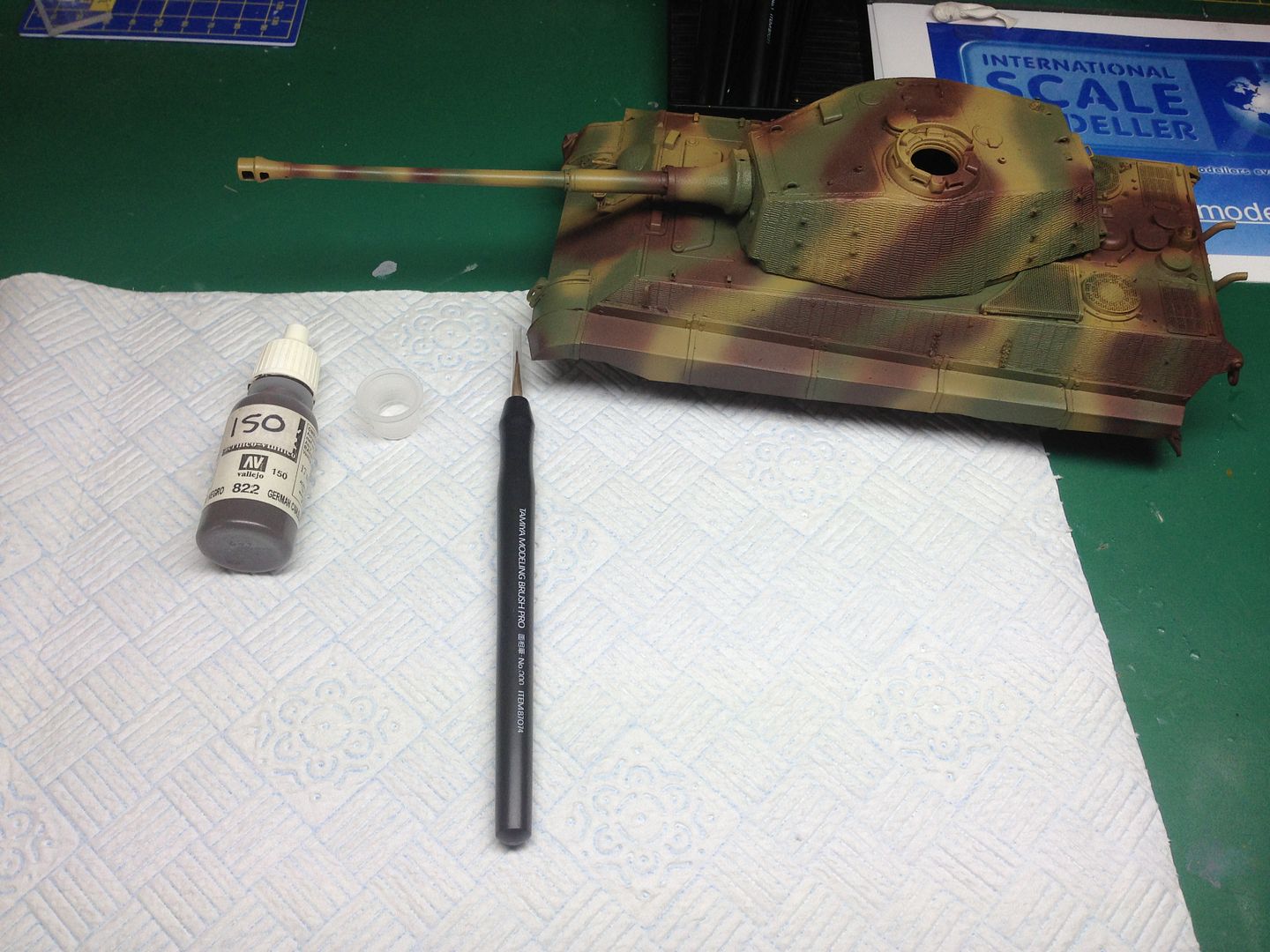

I started using Vallejo model colour German cam black brown as my chipping colour, giving that natural weathered bare metal look. Using a 000 brush applying random shapes a d small pieces of sponge, more so in high wear areas and damaged parts. Once weathered it'll tone it down.

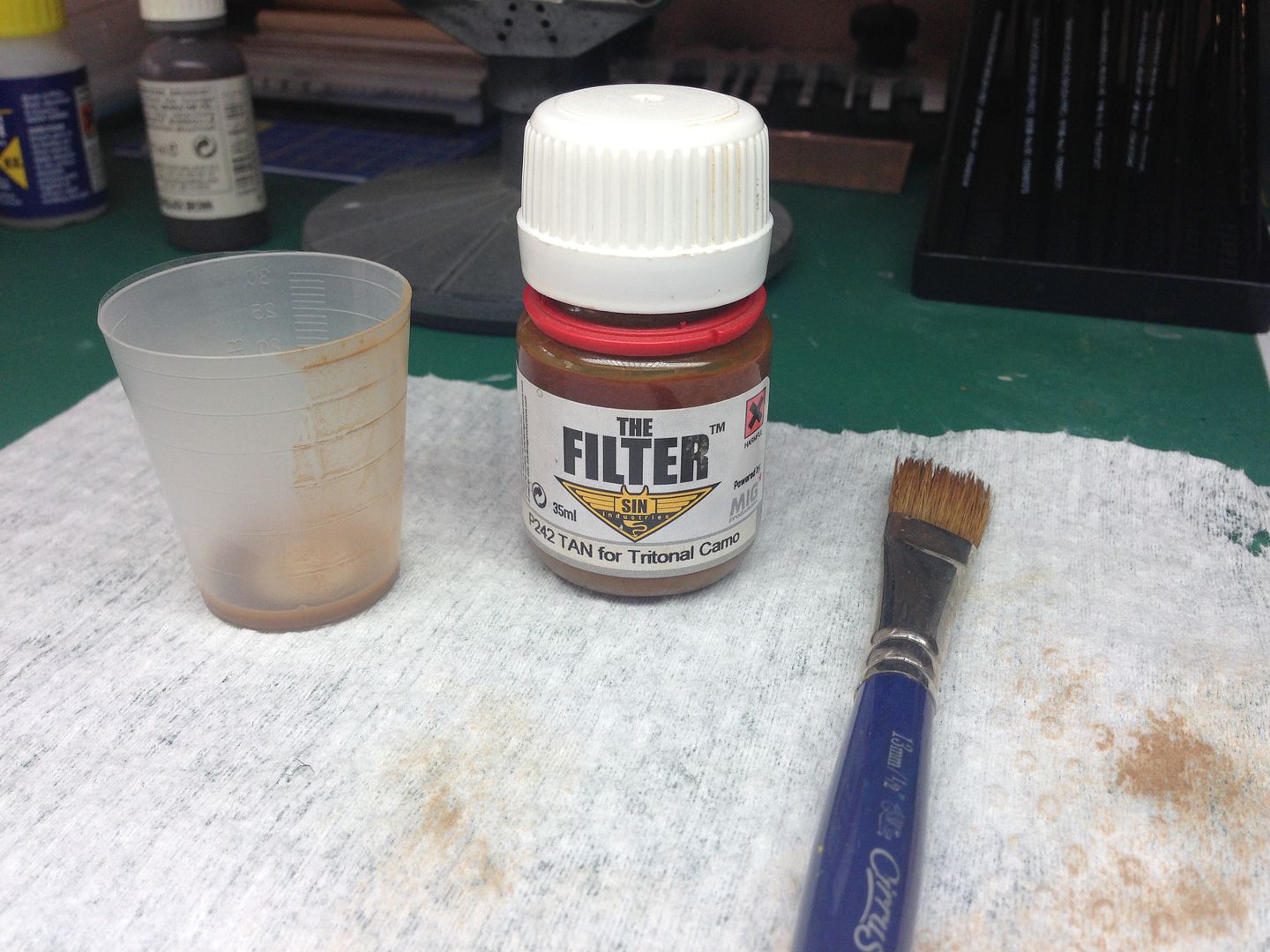

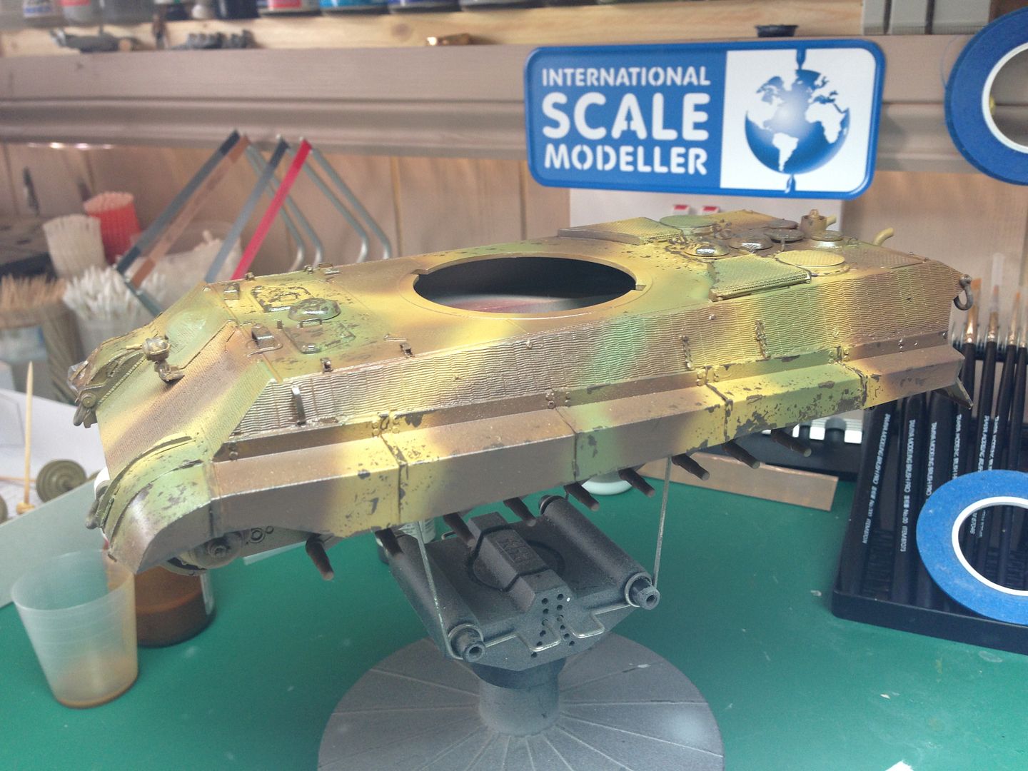

With the chipping done I then applied a couple of coats of sin industries tritone filter.
With the filter wet
And dried giving that faded look, really makes the Camo blend perfectly.

Is your chipping done with a sponge ? Or mini brush
Re: Dragon 1/35 King Tiger & Tamiya Kubelwagen diorama
schweinhund227 wrote:Is your chipping done with a sponge ? Or mini brush
I use both methods, it's looks a little ott but it all fade into each other as soon as the pigments go one.

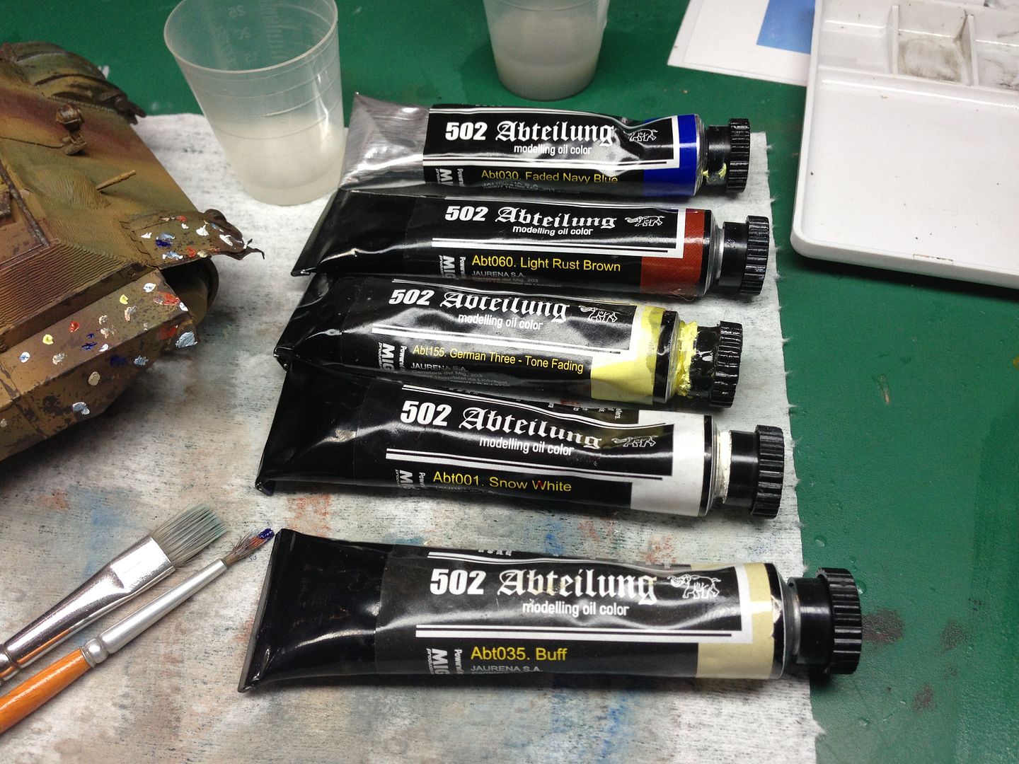

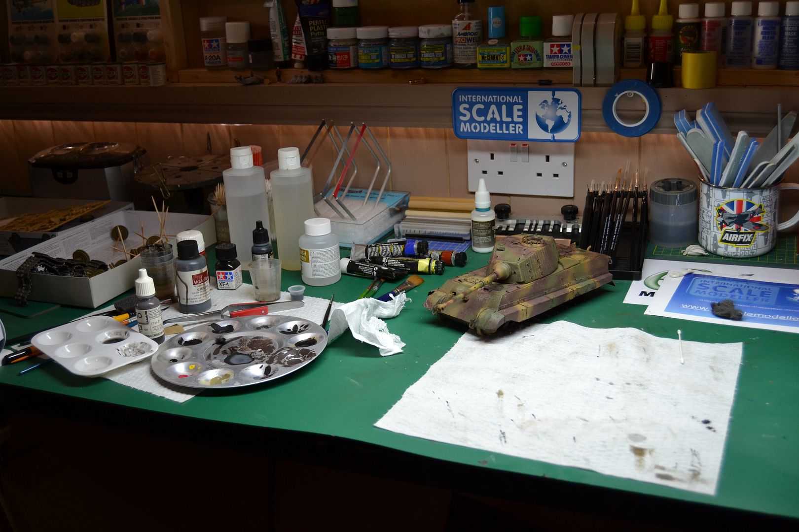

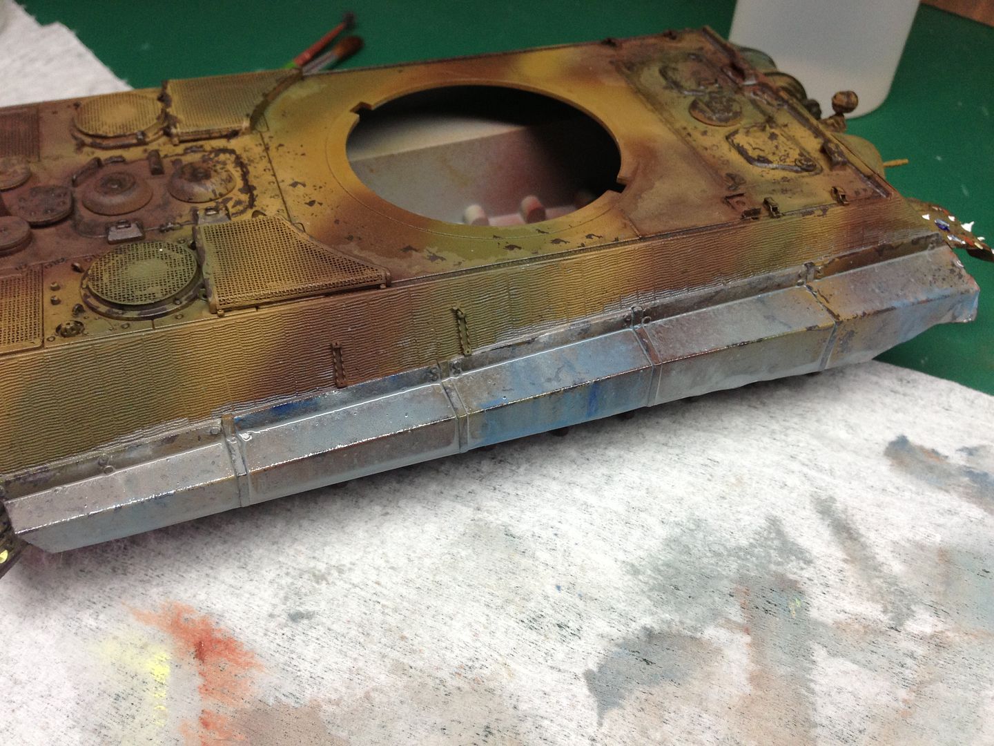

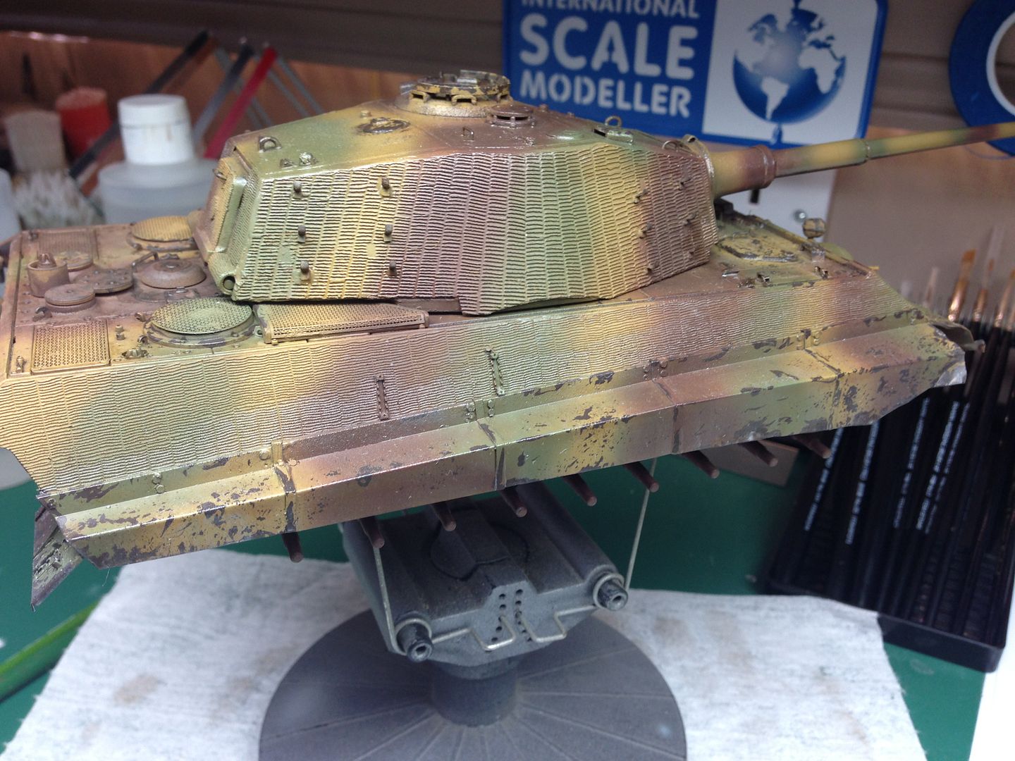

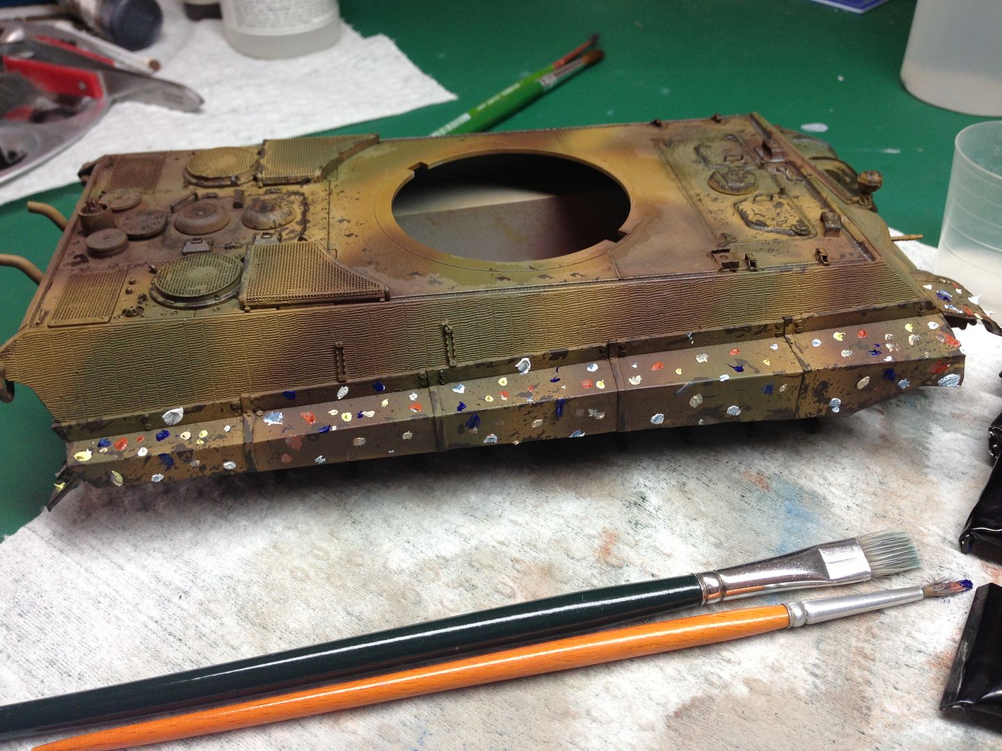

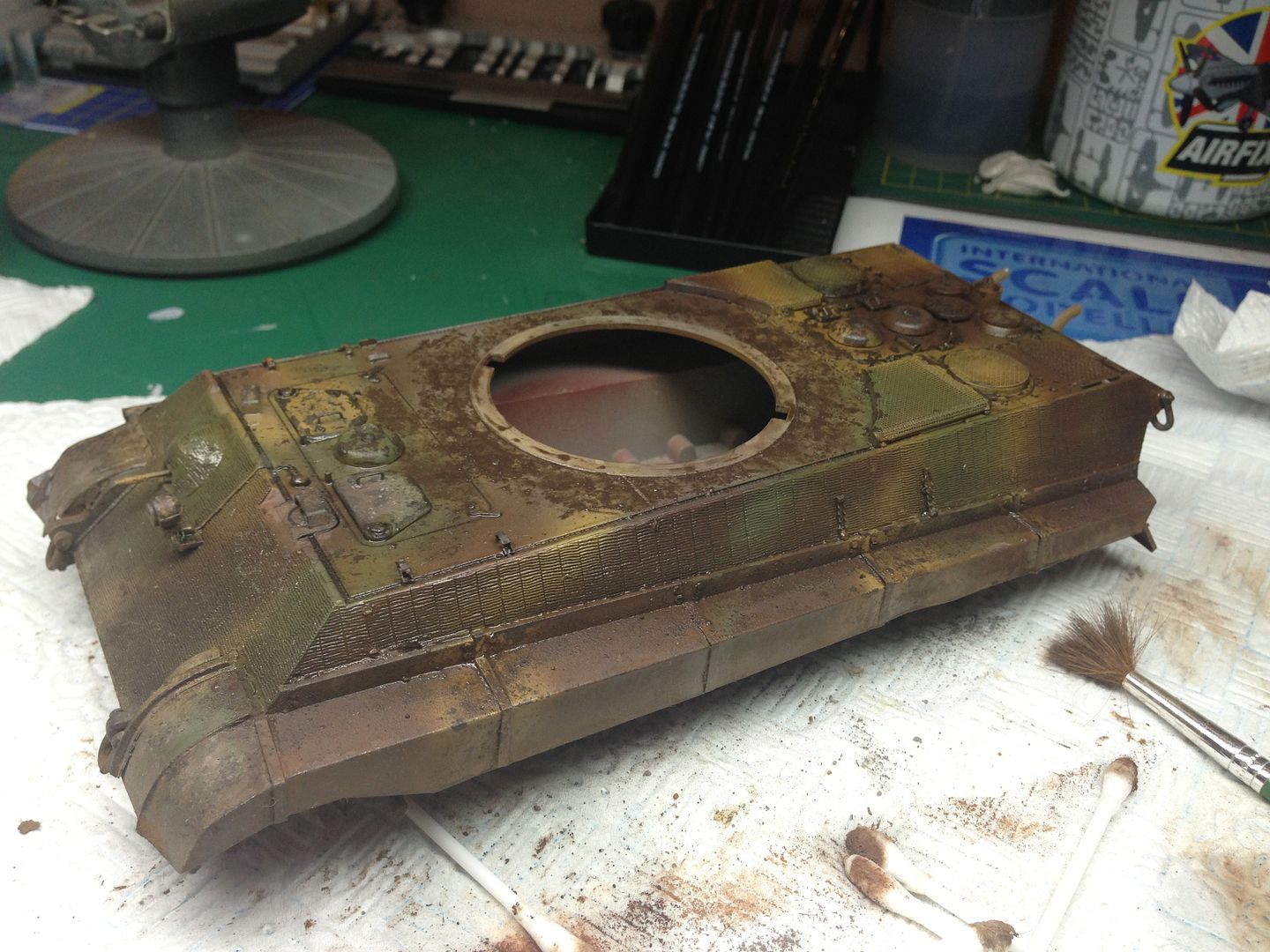

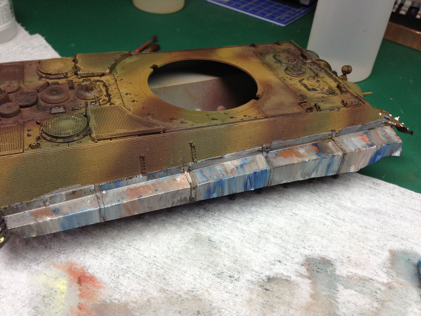

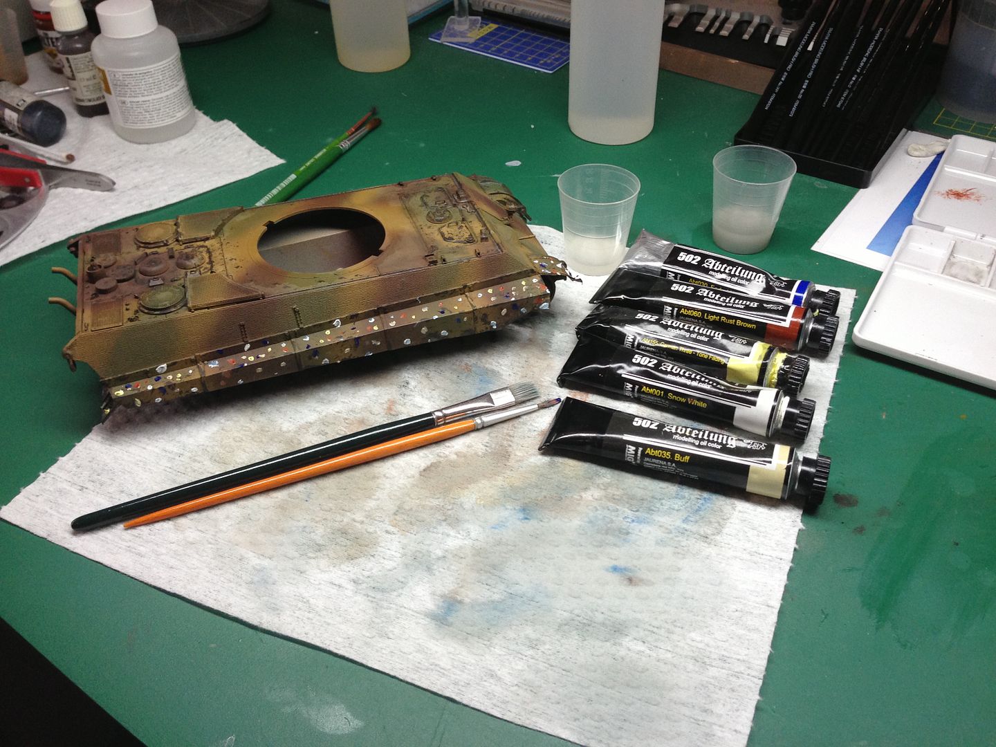

Ok so a bit of oil fading to add to the filter effect.
Using various mig oil paints, dabbed on to the body work, avoiding the zimmerit. This is then stumped back with mineral spirit, leaving a nice faded effect behind. Ive got a few dvds that show this done, i tend to do it a bit heavier as i like really faded armor.
At this point i normally think "what the hell have i done" but patience and more mineral spirit takes it back slowly.
Nearly there
And done, the camera doesnt pick the effect up too well, but it has a hazy look to it
Gotta let this dry then ill add some wash to the zimeritt to give it some depth

This is spectacular Paul. That filter really blows it away.
I may have to give them a try sooner rather than later. That faded glaze is really the business.
It's like an oil filter... with magic in it.
Great job on the chipping too Dude. I do it the same way. Old fashioned.

You gotta try the filters they are awesome, I know people say oil filters work the same, but they don't, they give a different hazy effect, hence why I use both.
Funnily enough me and lee were talking about chipping on the phone today, I much prefer doing it by hand, takes a lot longer but I think it gives a better effect.

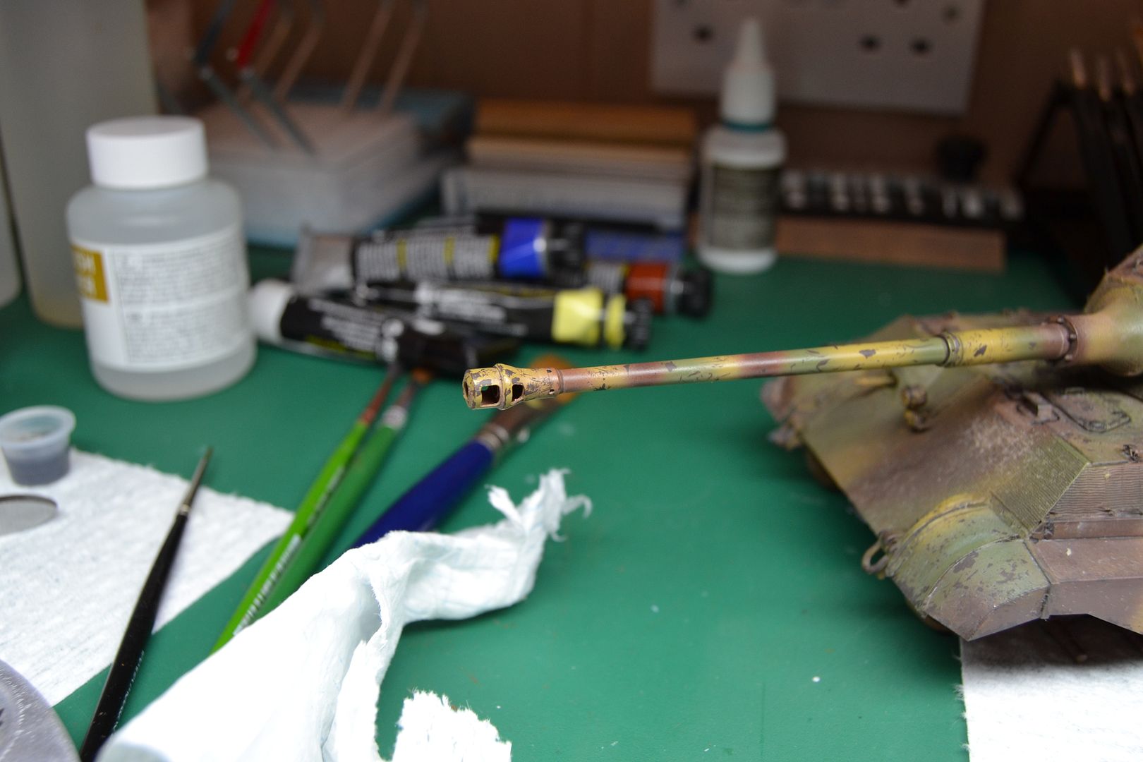

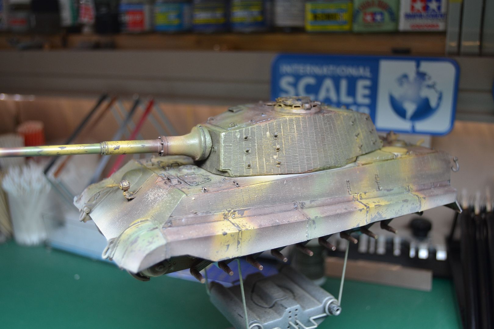

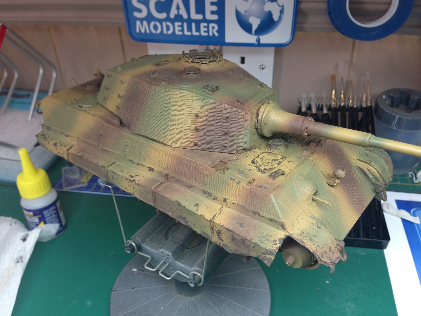

Right so, i added a dark dirt wash to the zimmeritt, which once dry gave the effect i was looking for, i think the theme im going for is FILTHY lol. The verlinden zim is alot better than the eduard, holds alot more detail to my eyes, but hey ho it is what it is
Ive then given it another pin wash with tamiya xf1 enamel thinned with mineral spirit. This brought out more of the detail lost n the oil fading. I also added chipping to the barrel using the same method as on the hull and turret.
I then used tamiya xf57 to start the dust effects, i airbrushed a light coat around the bottom of the hull and around the turret base, i went a little heavy around the turret but i can blend it in with the pigments.
Need to tidy up a bit then later im gonna start applying the dust pigmentsImage

Looking at those pics the dust effect looks really white, in real life its alot more transparent, i was worried for a minute and had to back and look at it again to make sure i hadnt overdone it
You're right about the Verlinden Zim. That's beautiful stuff. That micro damage really sets it off Paul.
Gorgeous. This is a stunning piece.
I think that the "over done" that you're thinking of is the heavy lighting at your bench. That last shot looks much more natural.
Pigments and the running gear will fix up anything that you might think is too opaque or bright.

Lol I cheated and took that pic before I sprayed the dust ;)

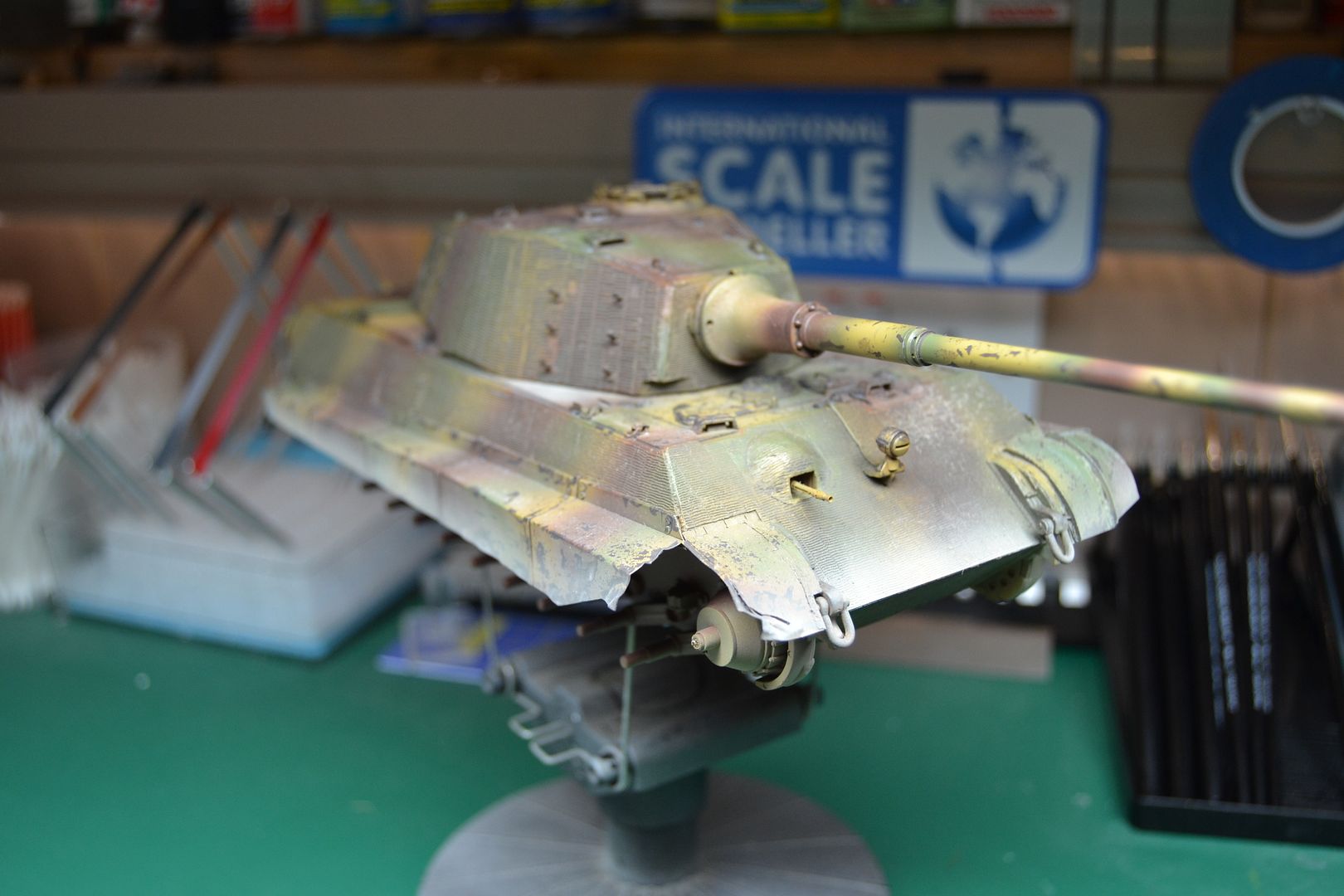

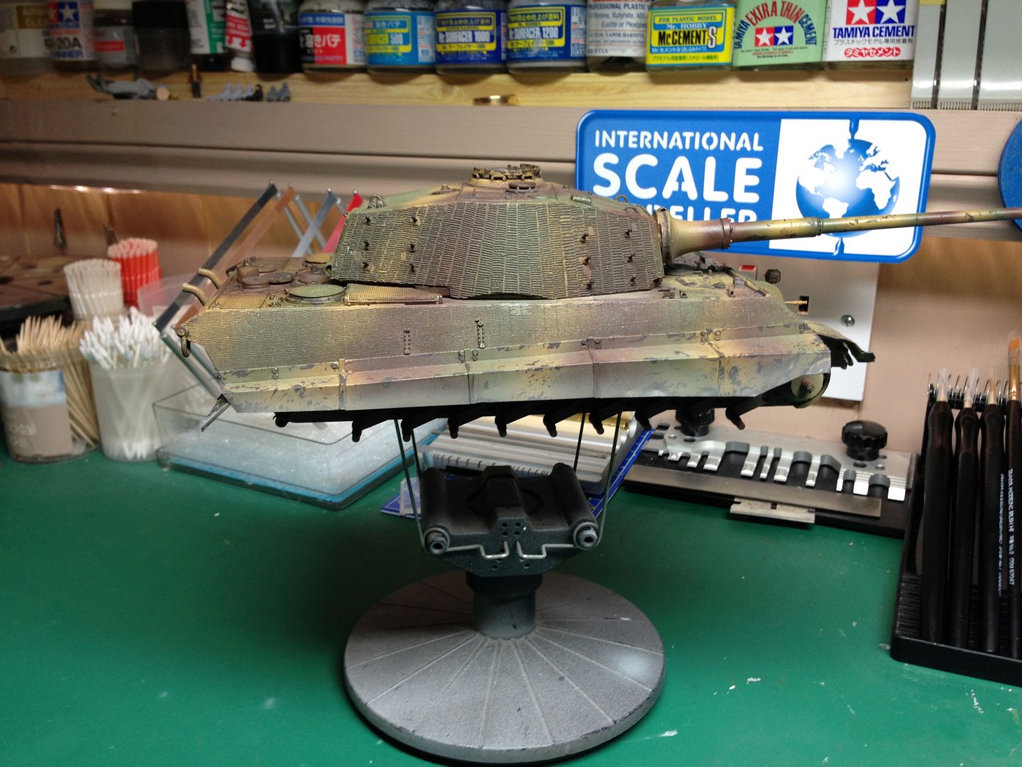

Thought I would get some pics that show the airbrushed dust effect properly as my dslr seems to exaggerate them a lot.
So took a couple with my phone, this is how it looks to the eye, much more subtle.
Btw if anyone has any comments suggestions or criticisms I'm open to hear them, you won't offend me at all :thumb2:

Anyway this is the last pic of the tank itself you will see until the reveal, ive been applying various pigments last night and this morning, these are currently drying awaiting blending, so they may look a bit harsh.
After a few hours drying, once fully dry i can blend them more
So now ill start with the tracks and then on to the tools, figures etc.
Im hoping to get this done with the dio and the kubelwagen, but with just three weeks left, im gonna concentrate on the tiger done for now, as i dont want to rush it.
