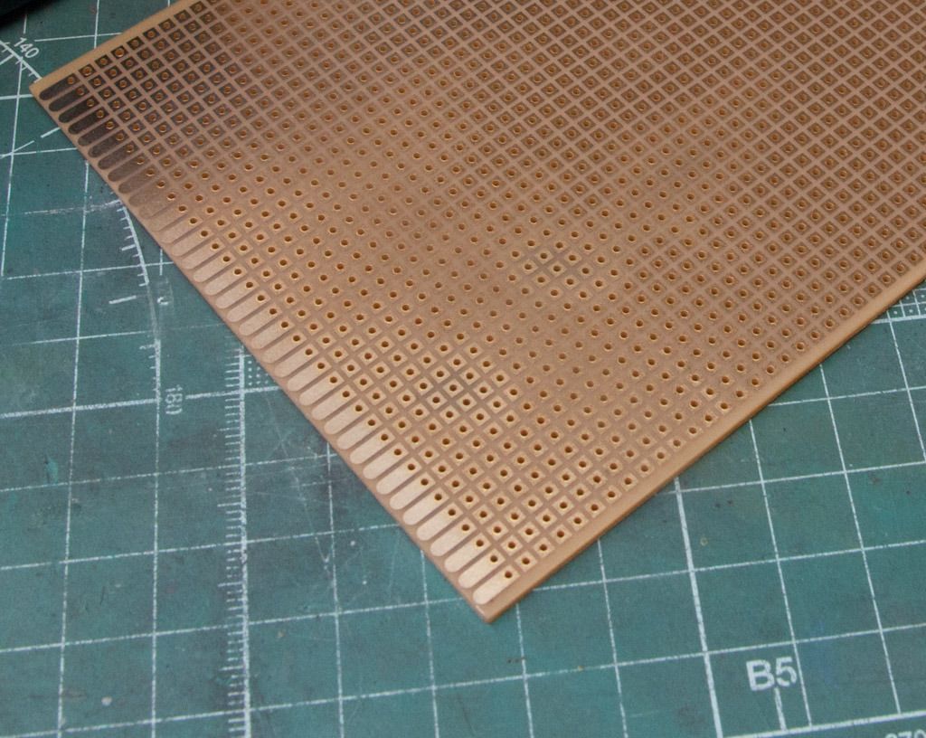

The cost for the parts is less then 10€ and only a drill and a saw is needed. First I went to my local diy electronics store and picked up a small box and a prototype PCB. The PCB has a bunch of small holes on it, in a 2.54 mm grid and a thin layer of copper. There are a few different versions of these with three or more holes connected with the copper or like this one just small squares around each hole. It doesn't matter what type you use as it will not be used as a PCB but rather just a plate with a bunch of holes.

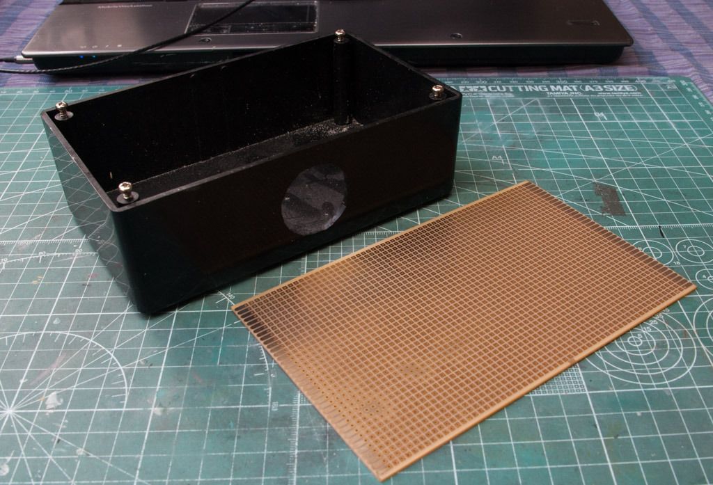

The PCB was cut to fit the open side of the box, I also made a hole in one side of the box ti fit the hose for my vacuum cleaner.
