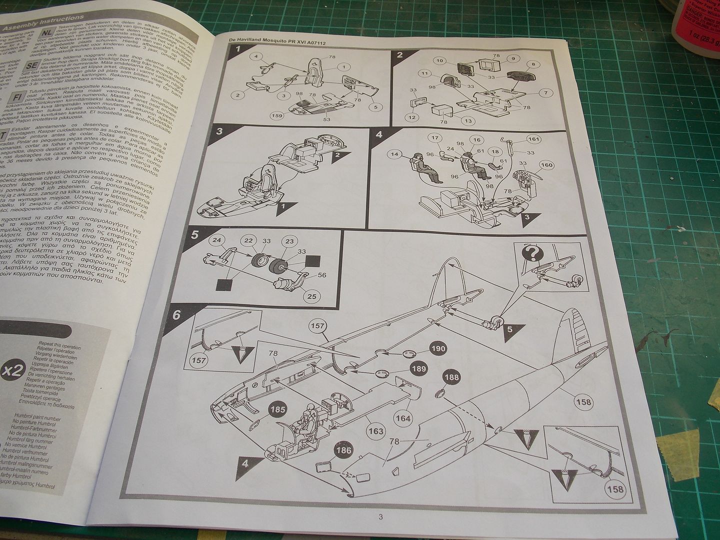

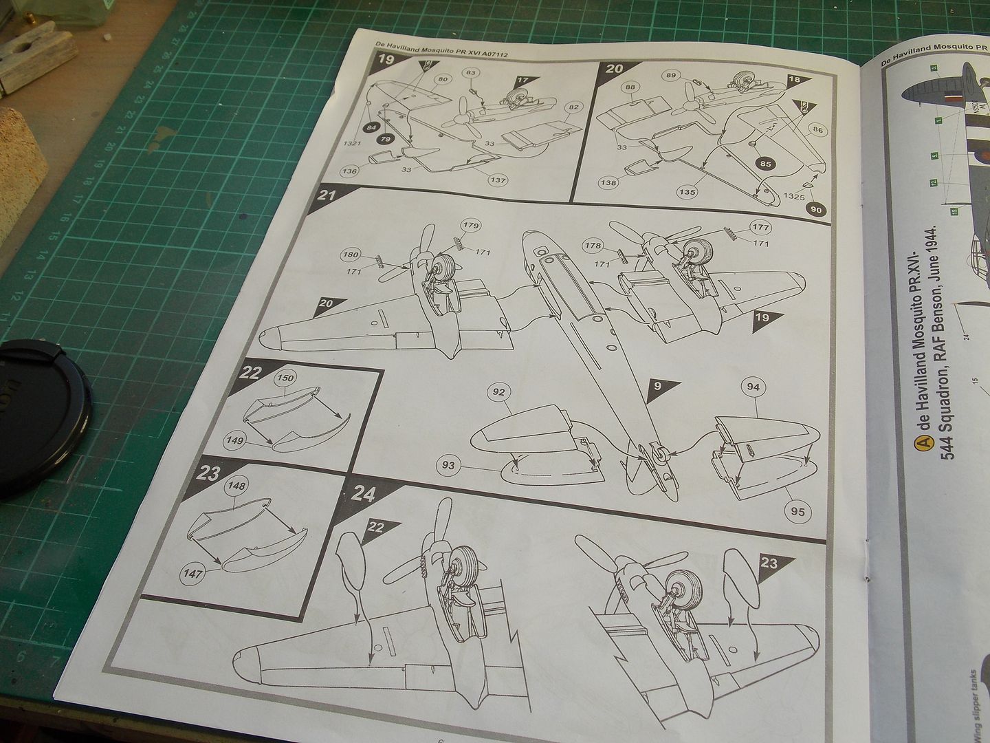

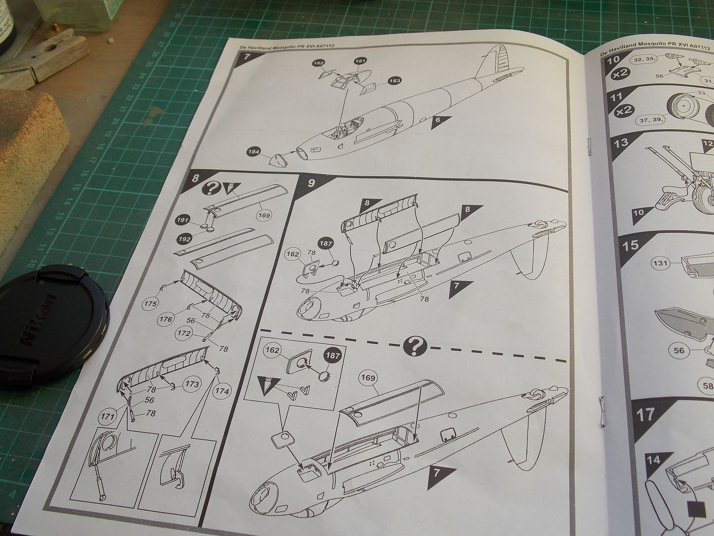

Airfix have recently changed their instructions to modern CAD style. Not in this kit.
And that's it for the build sequence. Reassuringly nostalgic (a bit like KP cheese and onion crisps and wrestling on the telly on a Saturday morning).

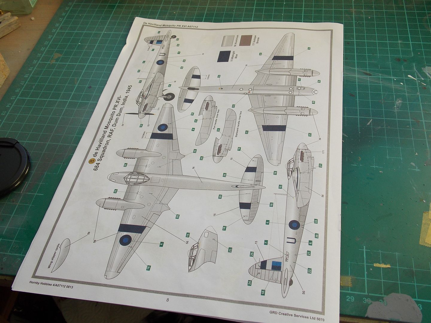

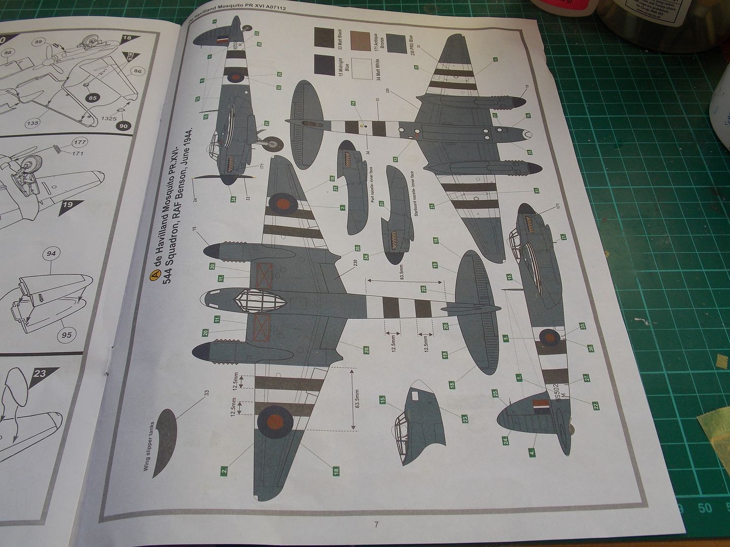

Two nice schemes round these off.

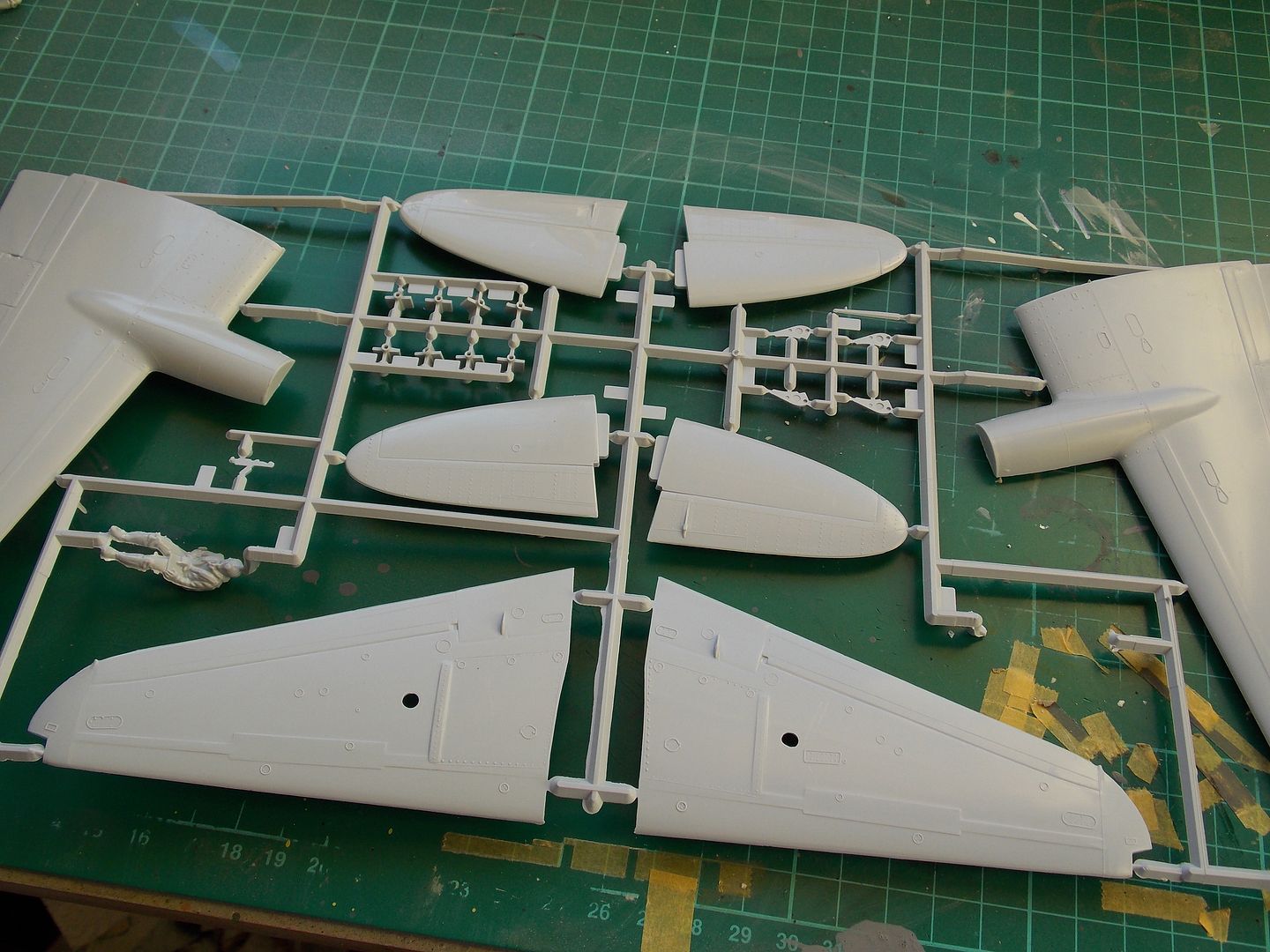

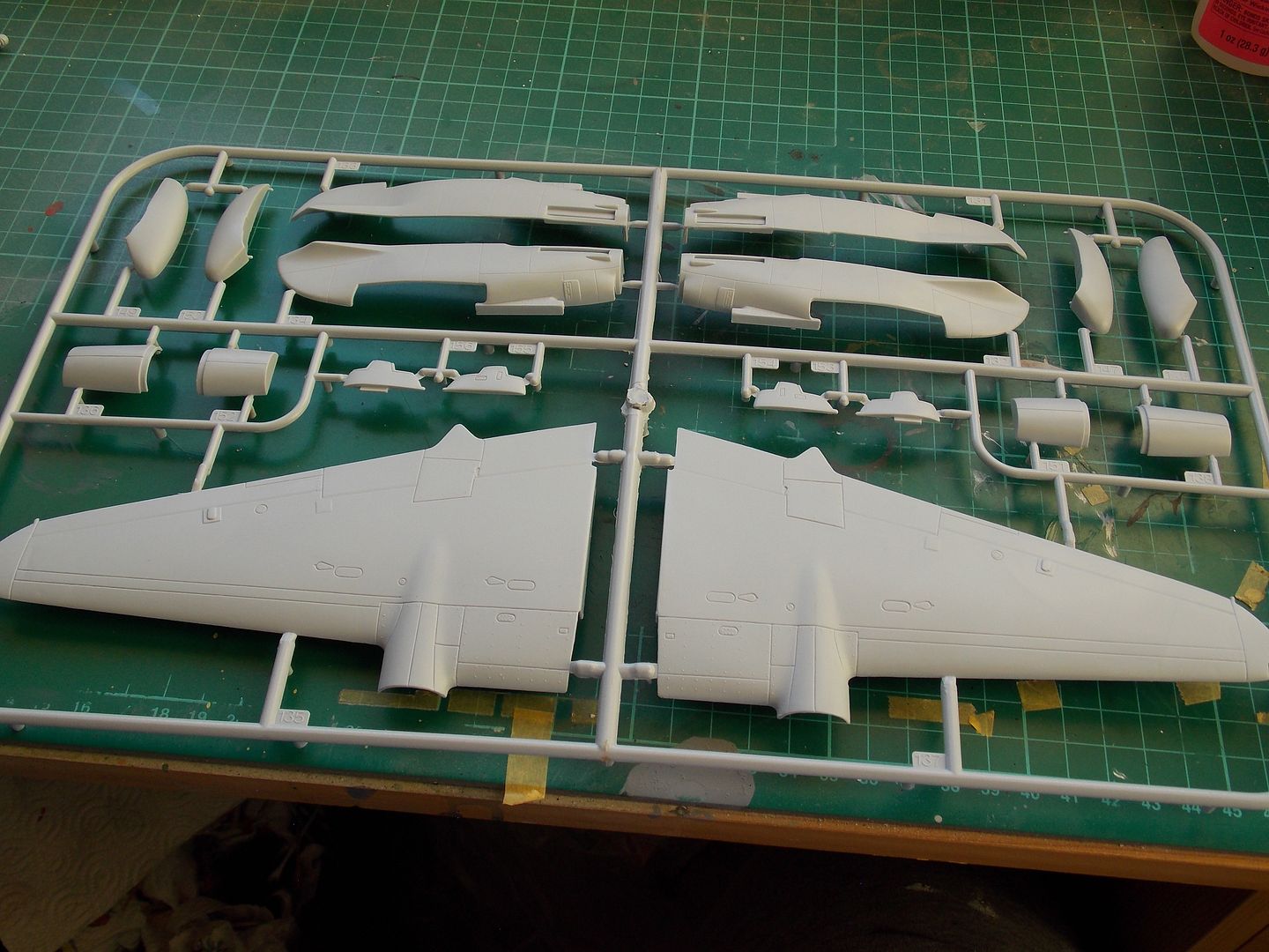

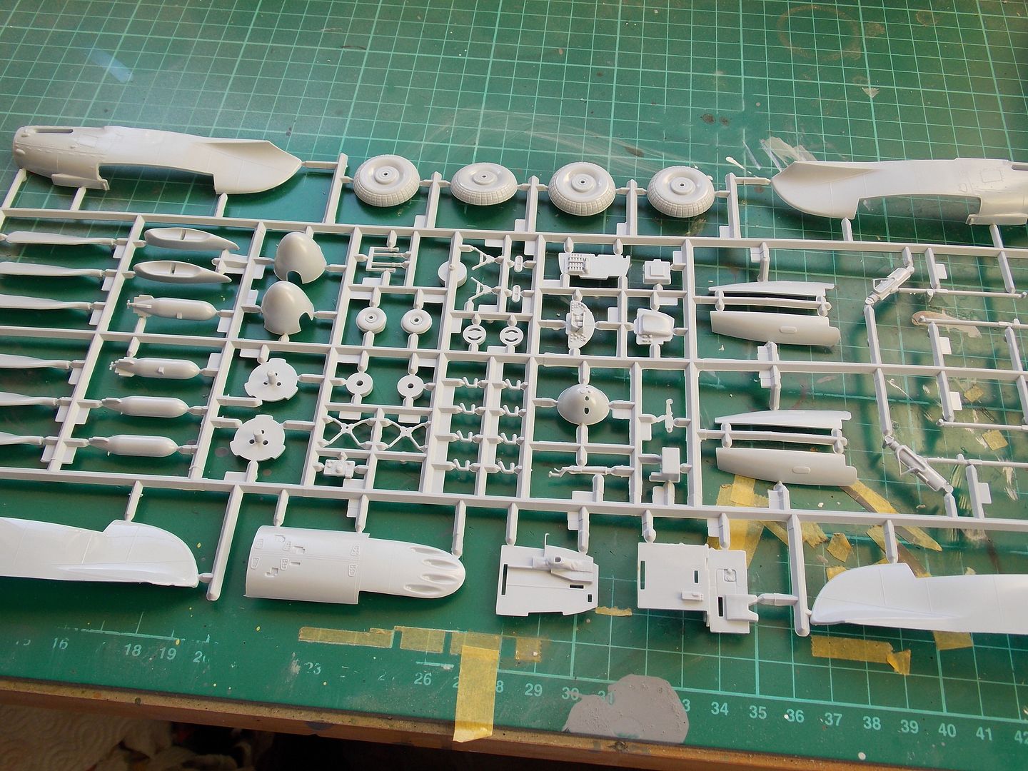

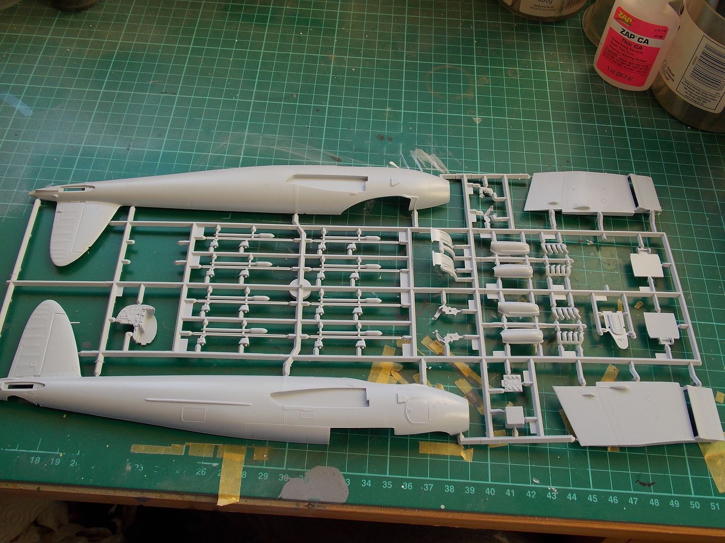

A big old bag full of sprues. Cheers Airfix.

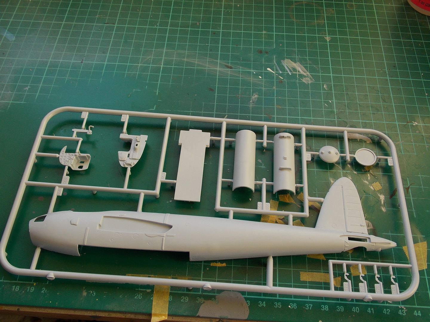

Six grey plastic sprues.

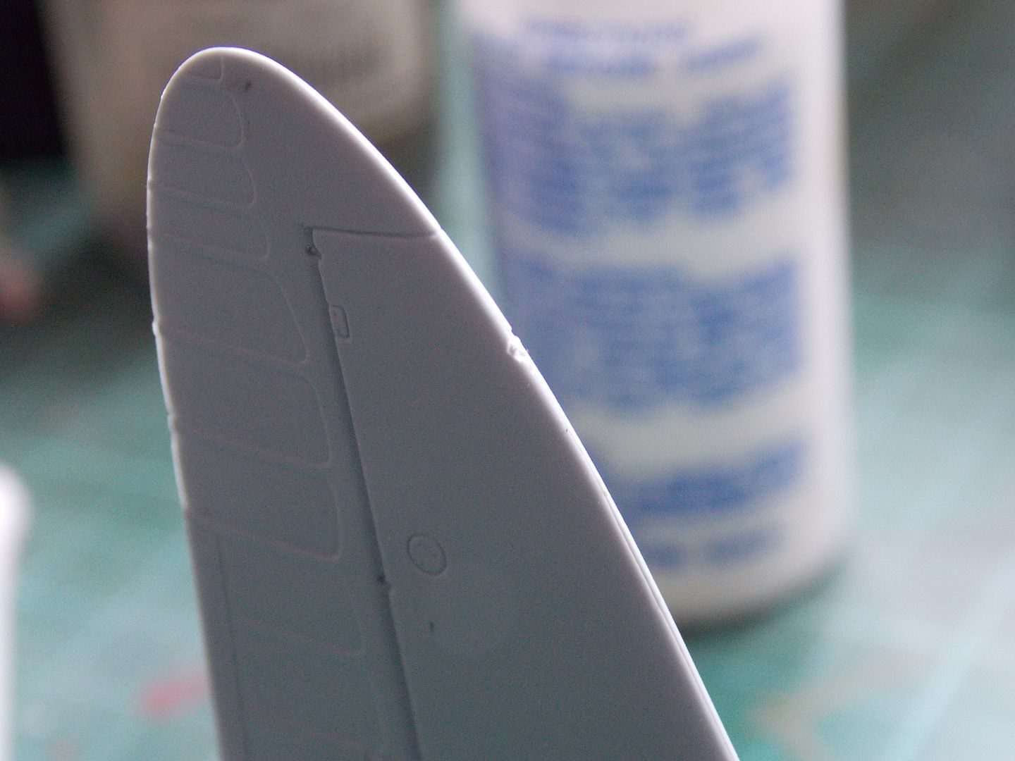

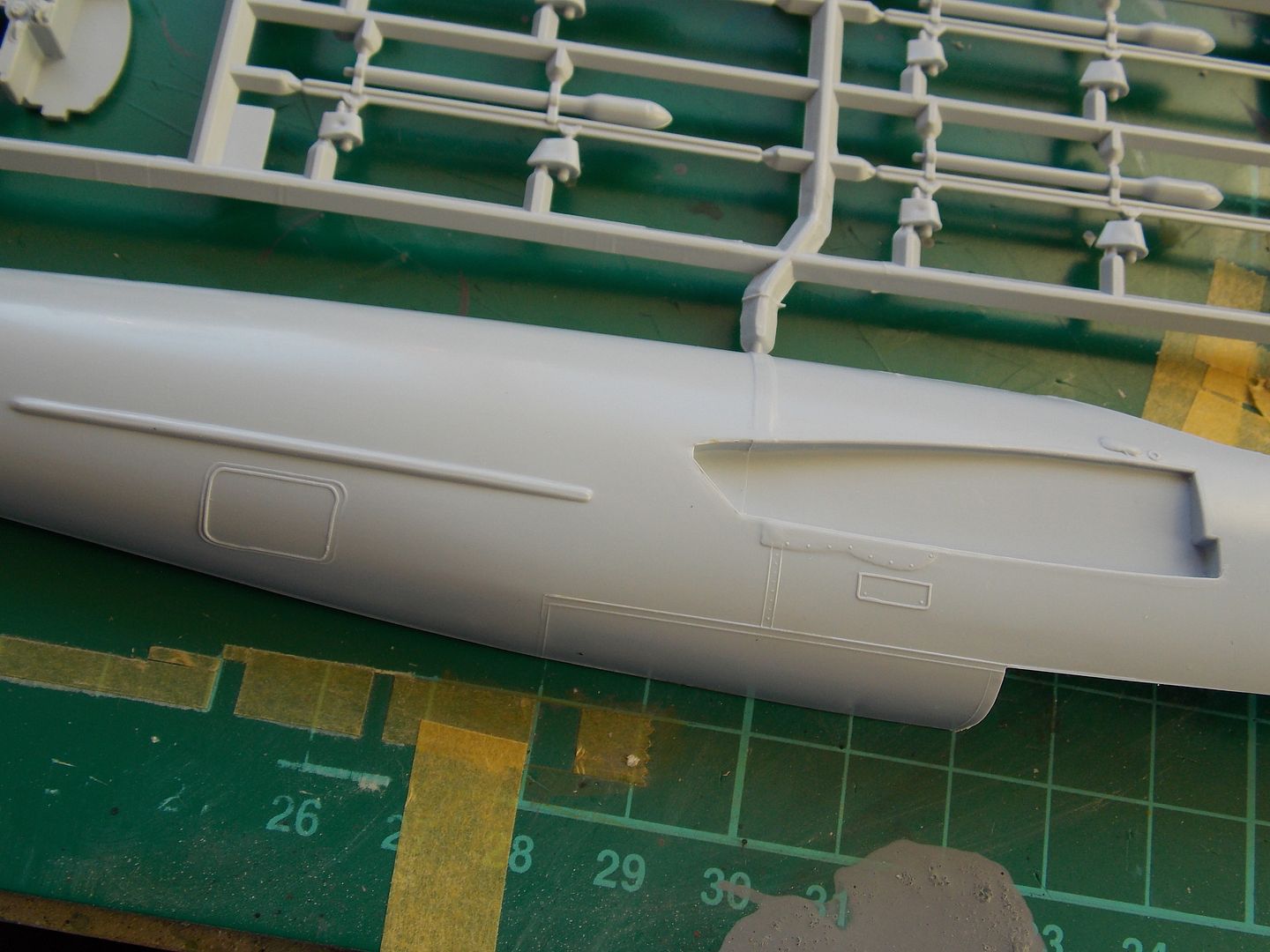

On closer inspection. Raised panel lines!
Flash.
Nice one.

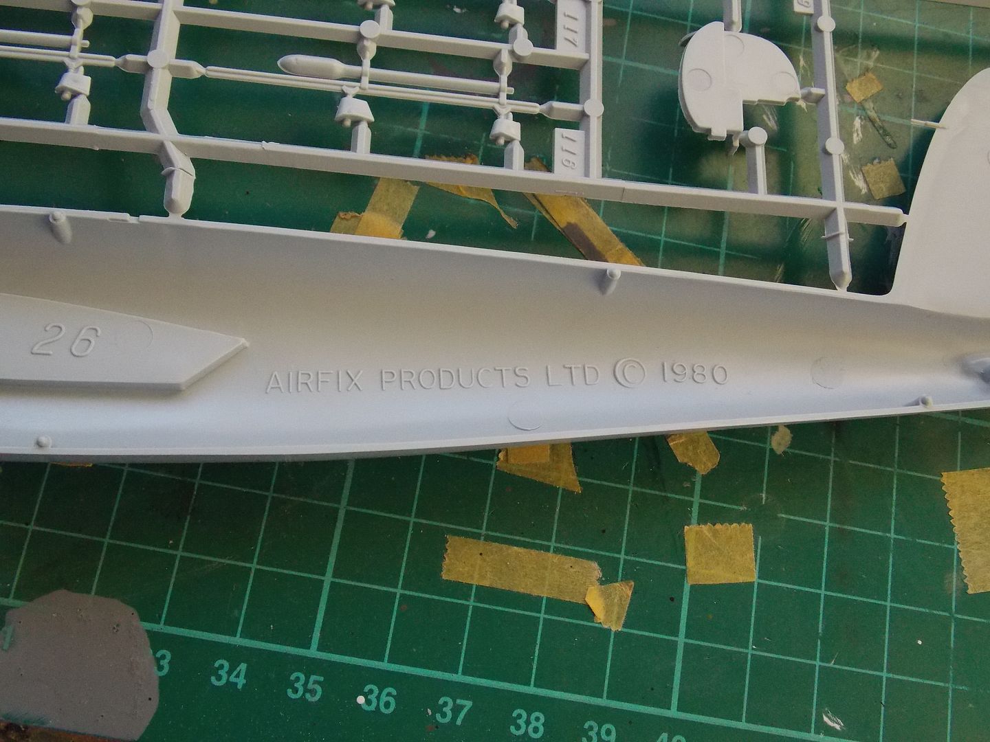

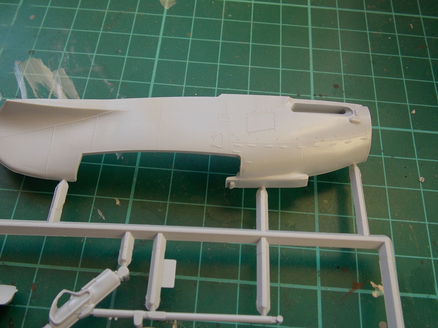

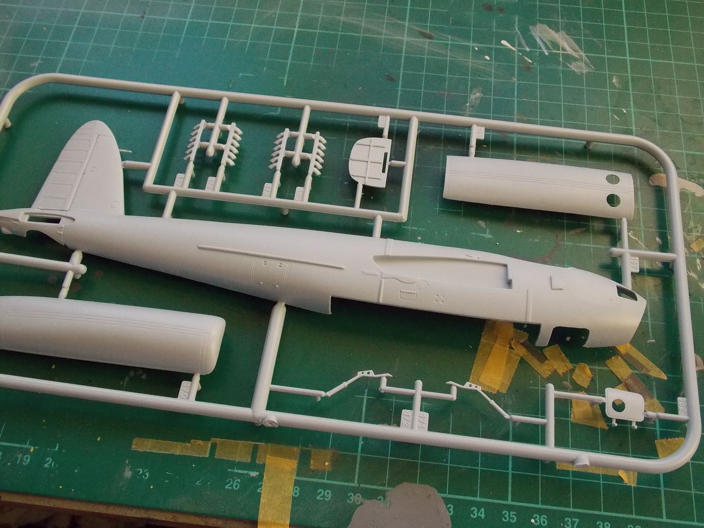

There is a new fuselage in here though.
Old wings.
New wings.
How cool?!

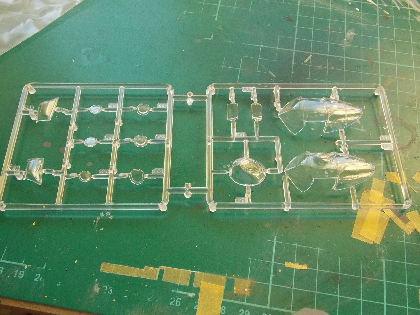

Two sets of transparencies.
New. I think.
Old. I hope.

This scheme looks cool.
Maybe. undecided yet.

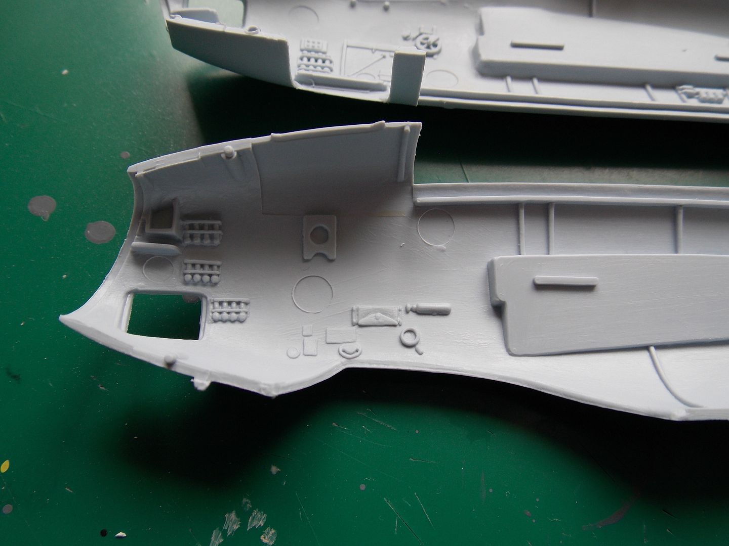

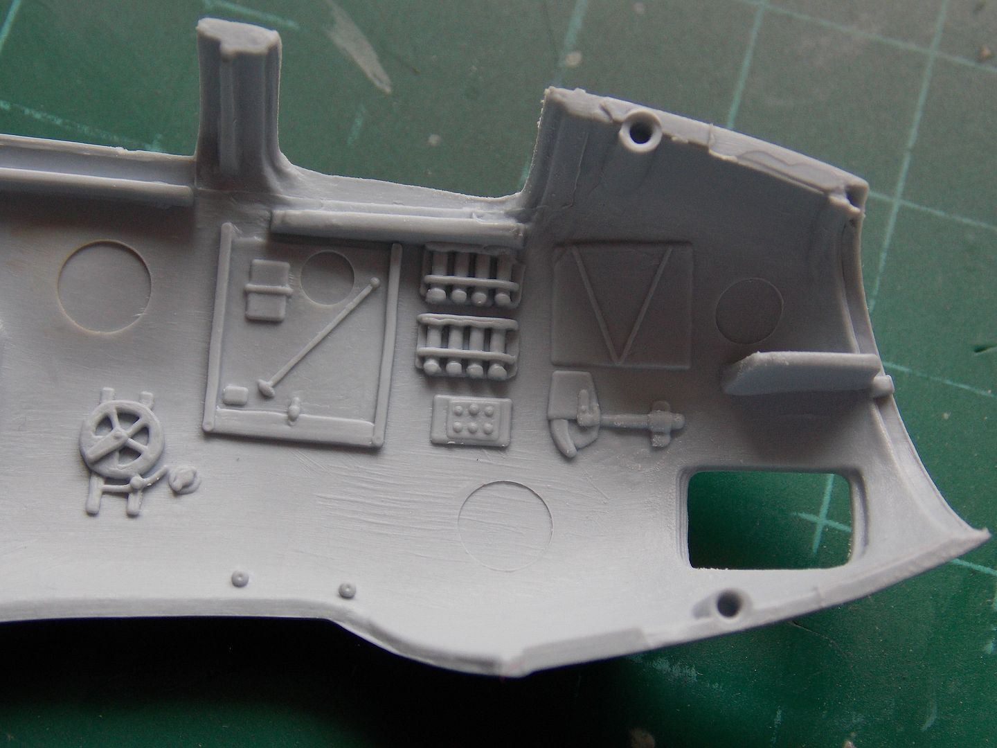

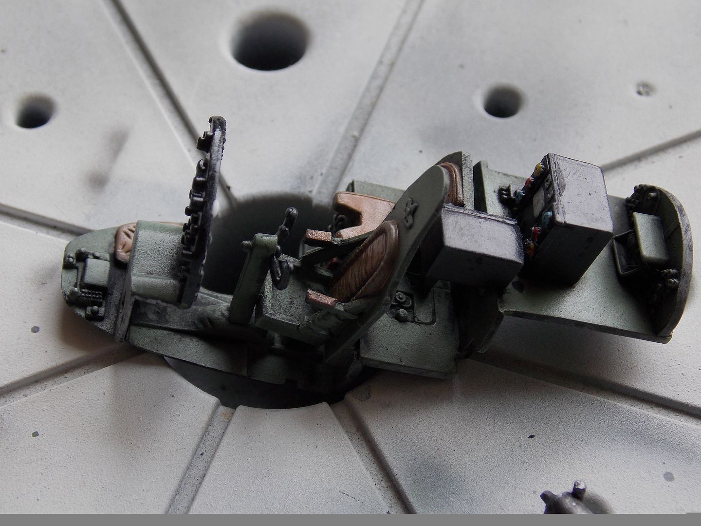

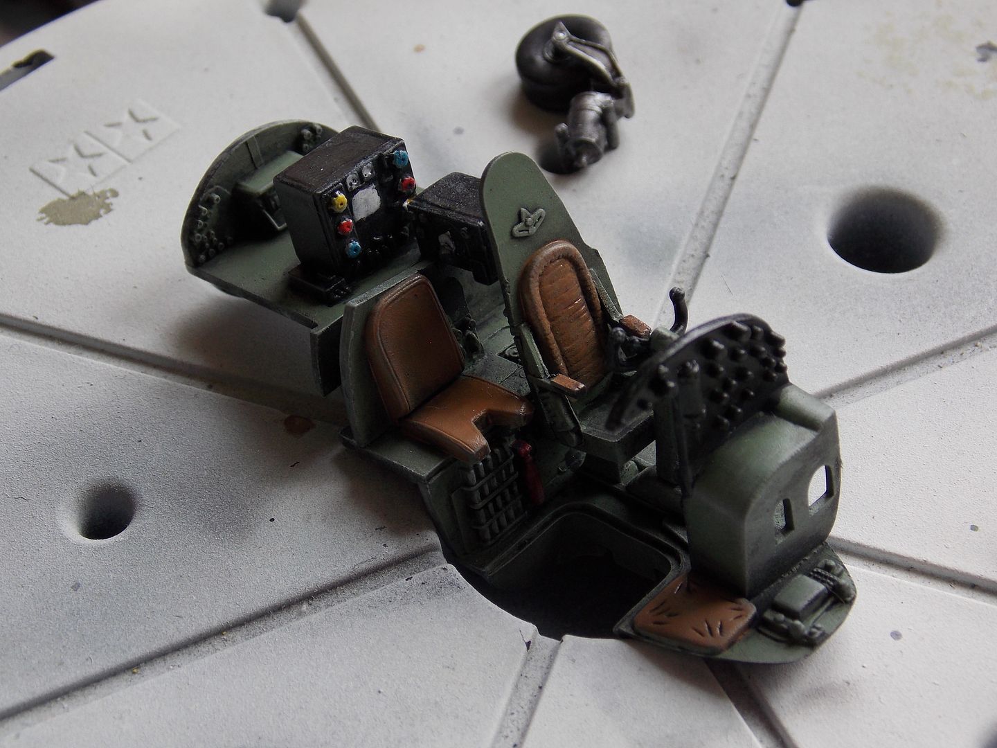

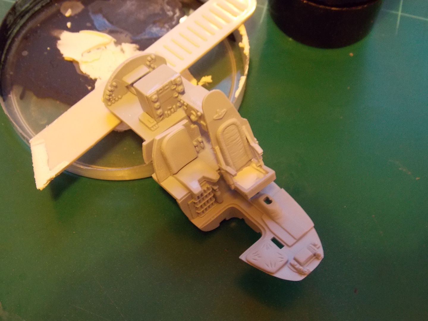

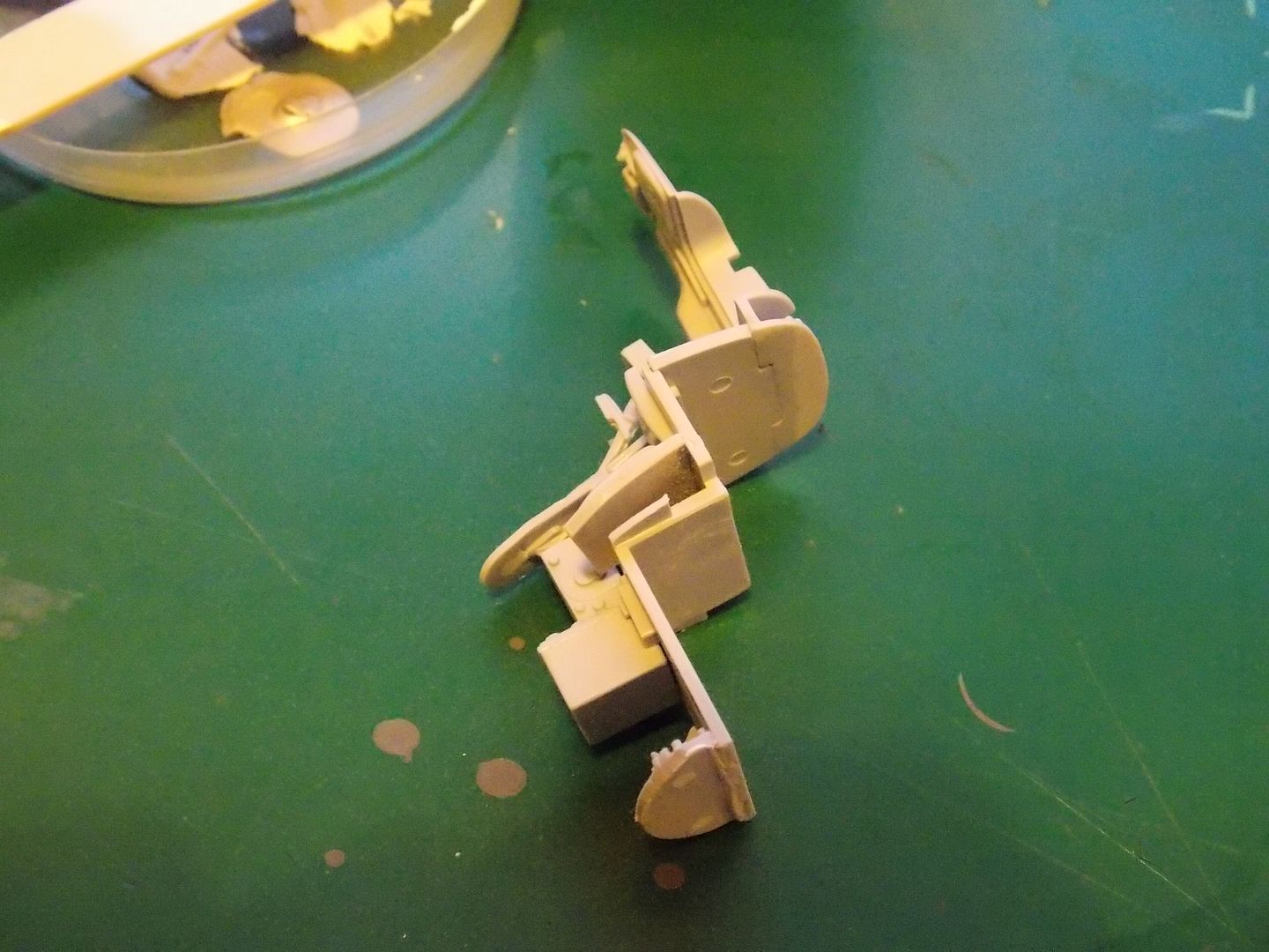

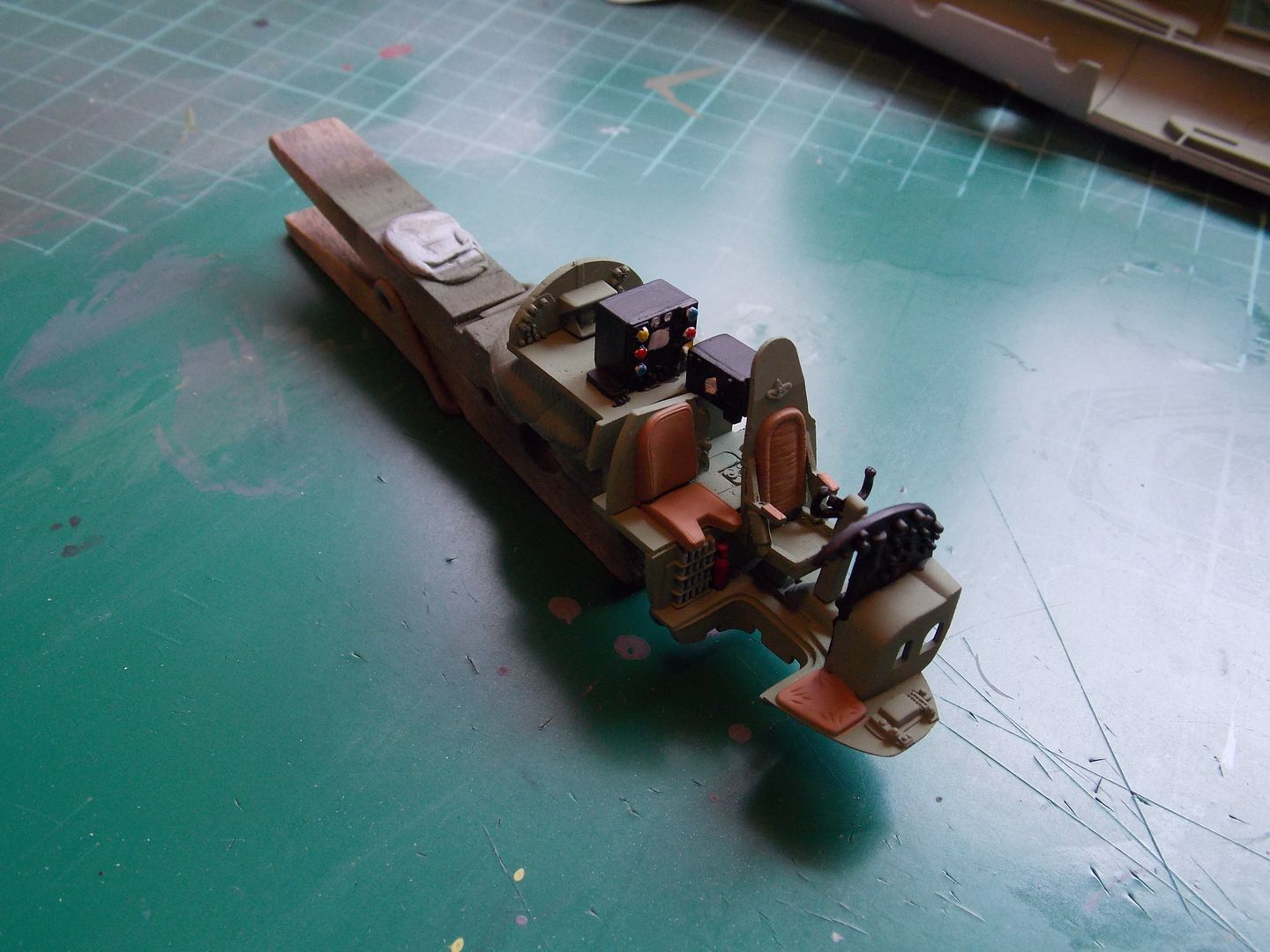

Cockpit went together pretty quickly and I got this done over an hour or so last night.
Going to need a bit of putty on this build.
Have decided to put the aftermarket away and do this OOB apart from some harnesses and a canopy mask (still need to check that out on the net).
Crew area primed up first thing this morning.

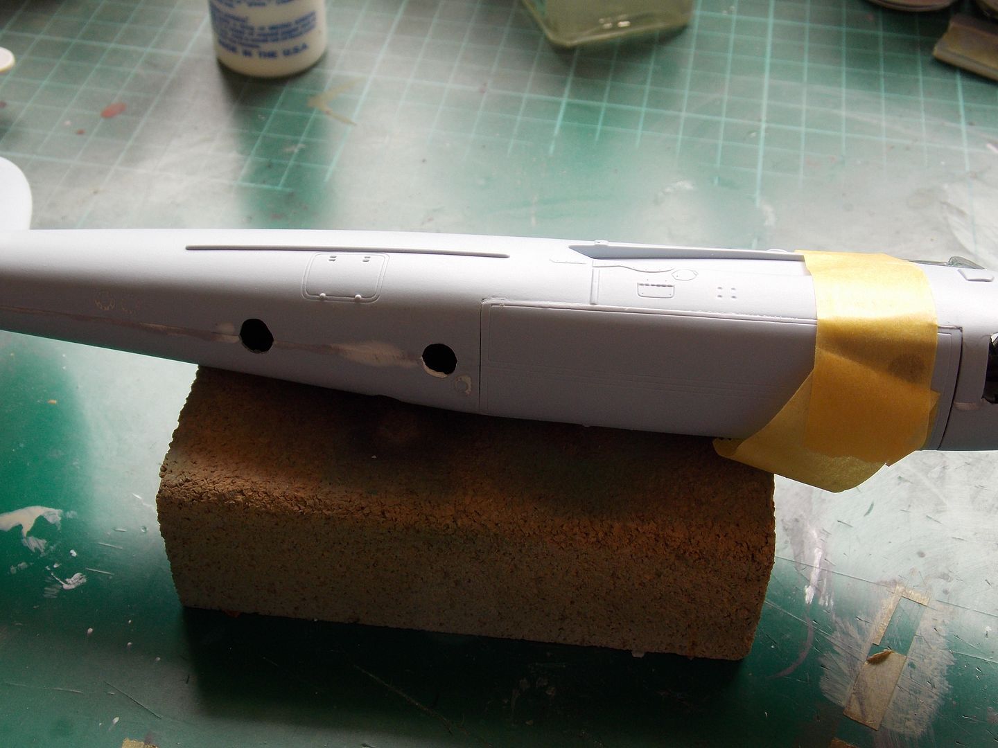

See what I mean about filler?

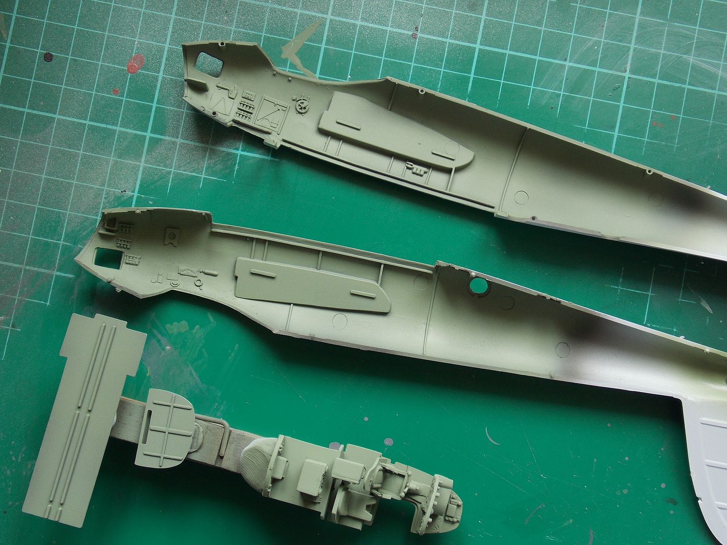

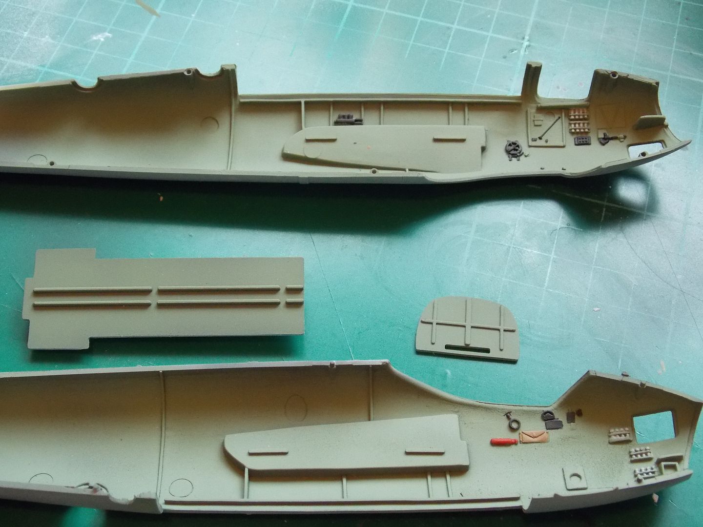

Fuselage halves were soon primed after a bit of filling and sanding.
Then given some lightened cockpit green.
Detail painting under way. I wish my new camera wasn't quite so good at up close.

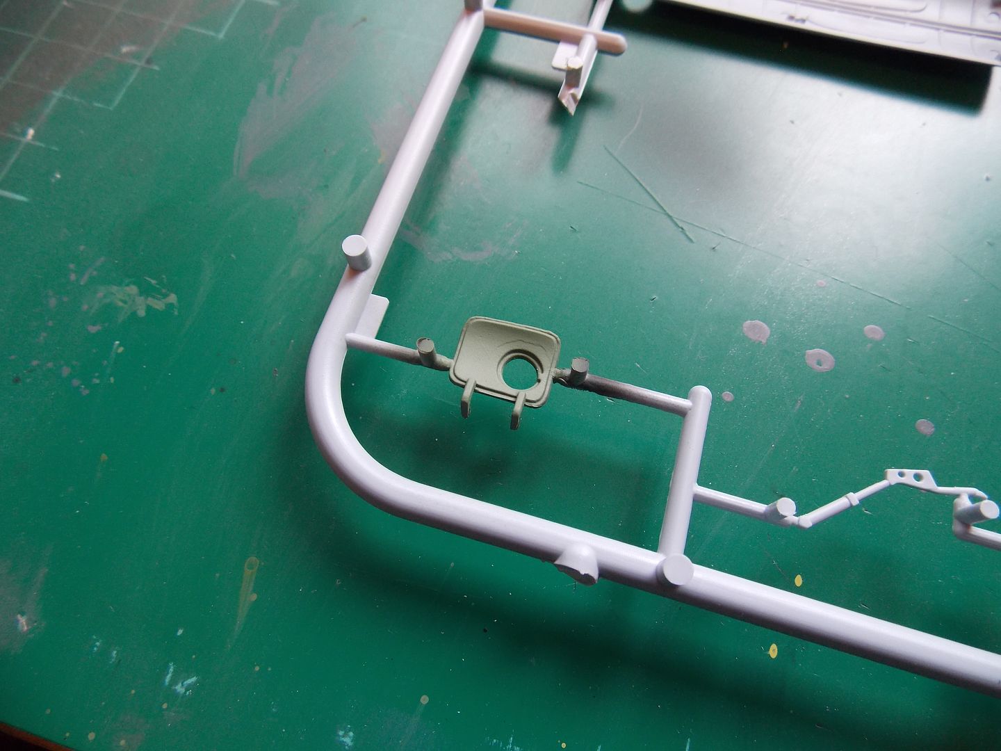

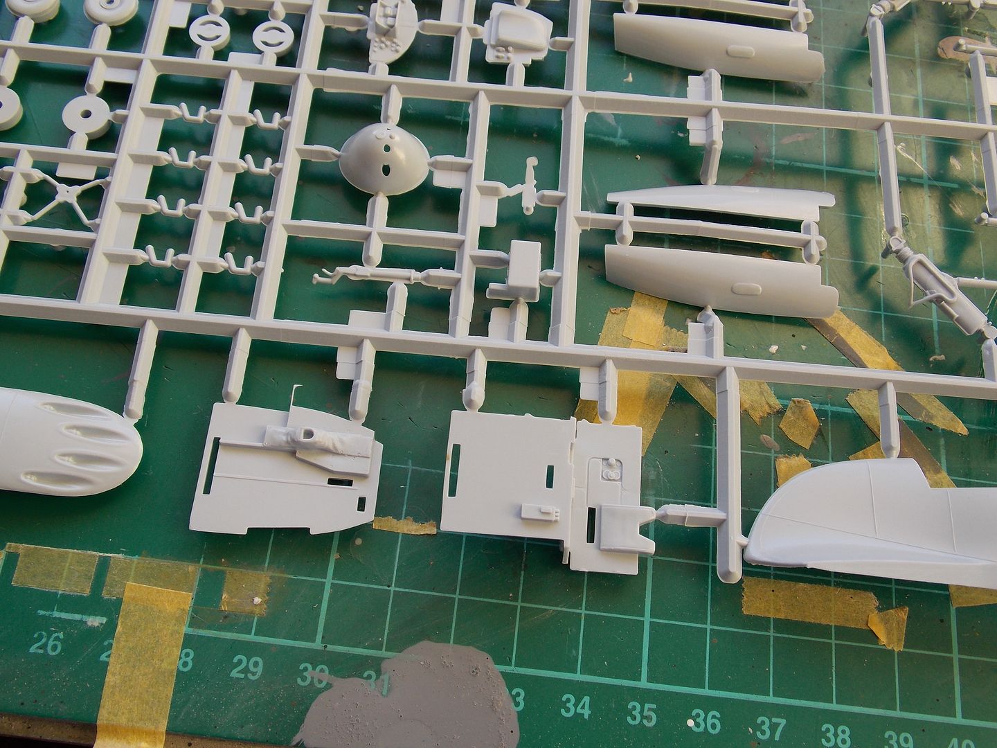

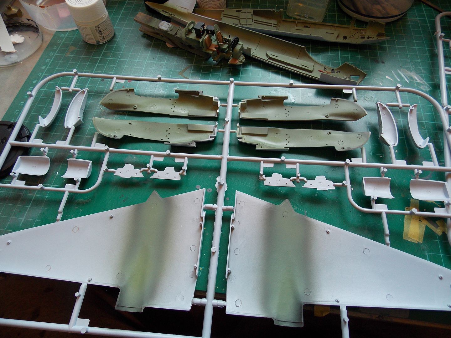

Also got the engine nacelle interiors done on the sprue. Bit of a blank canvas these.

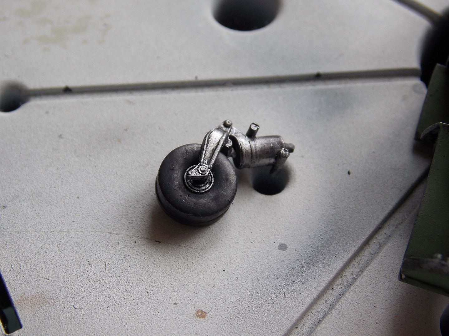

And the tail wheel. Interestingly, I read somewhere that the de Havilland works had a load of these left and used them for Vampire nose wheels..... cool huh?

Crew compartment washed and dry brushed.
Will be adding Tamiya tape seatbelts as I want to keep this as oob as possible.

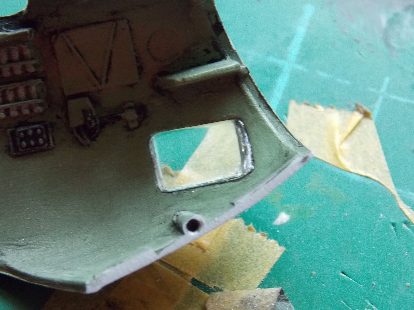

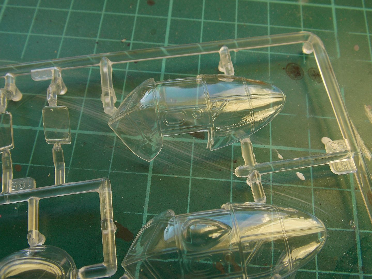

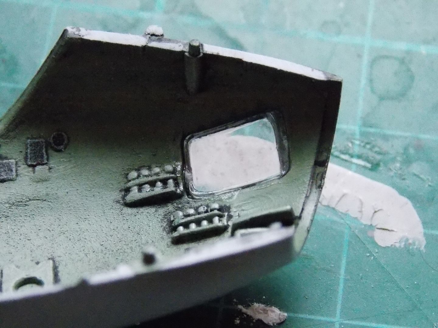

There are two clear parts that are meant to go in here as the fuselage halves go together.
Never going to happen. I'm thinking of glazing here with micro crystal clear at the end of the build.
Error in the instructions. Clear parts 185 and 186 are transposed so take care. Fixed using micro crystal clear thinned with water and run into the gaps. Fingers crossed they hold and don't pop into the interior during the rest of the build.

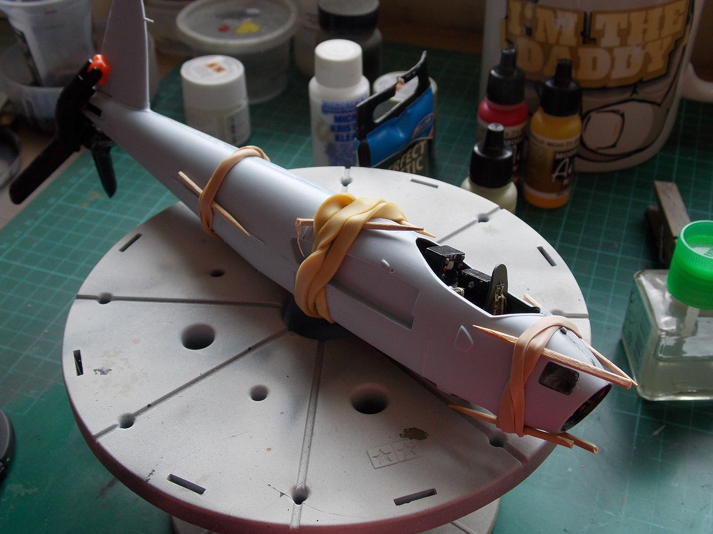

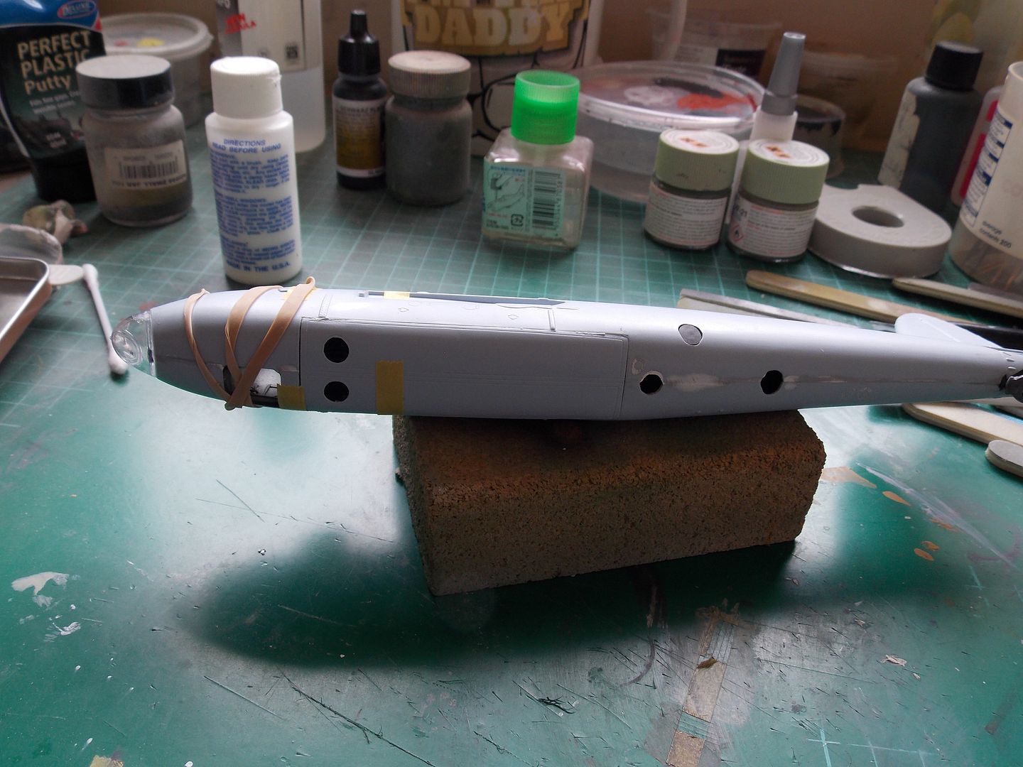

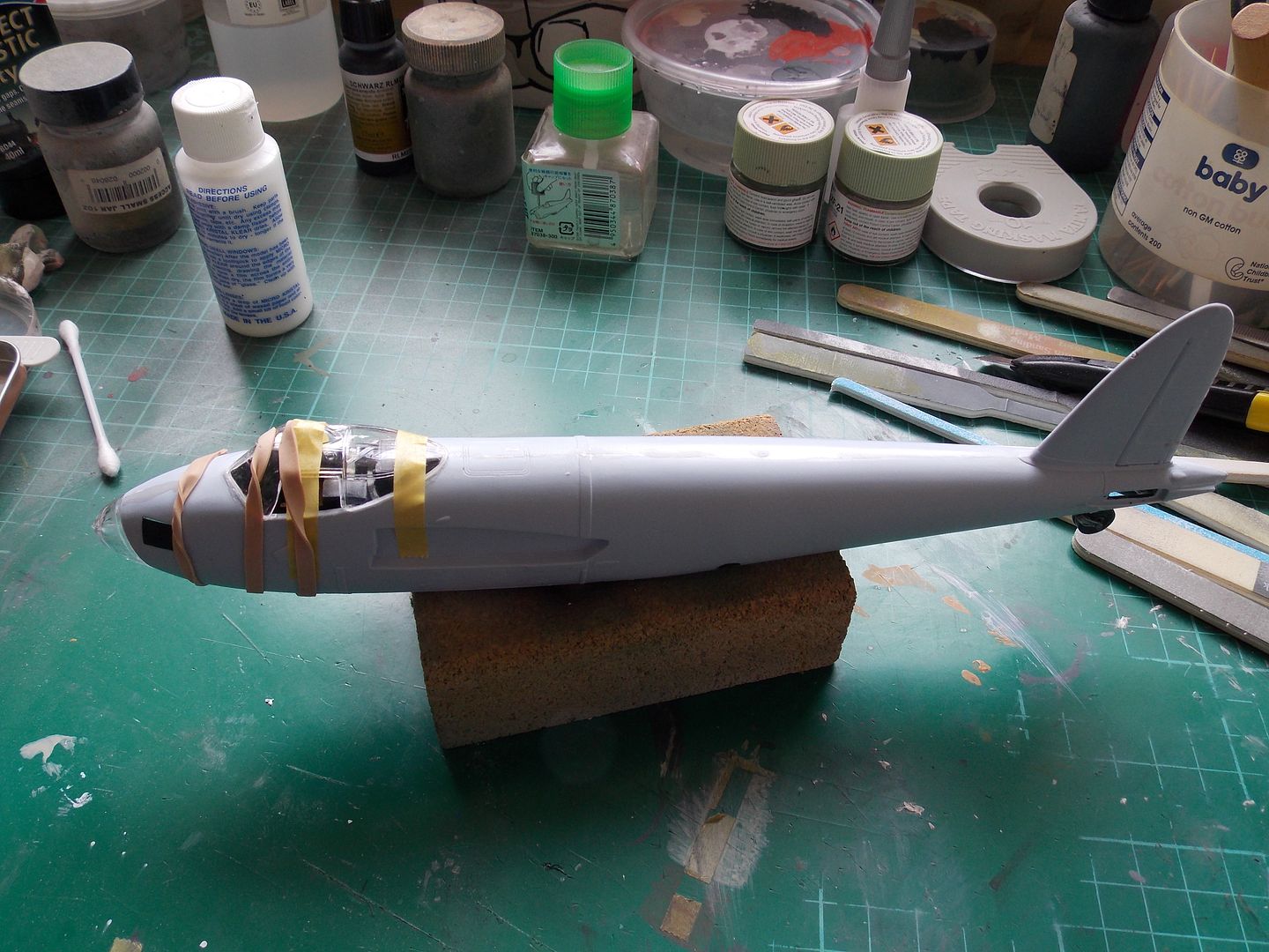

Time to button up. The fuselage sides bow out a bit at the front so I started at the back using extra thin and clamping as I went along.

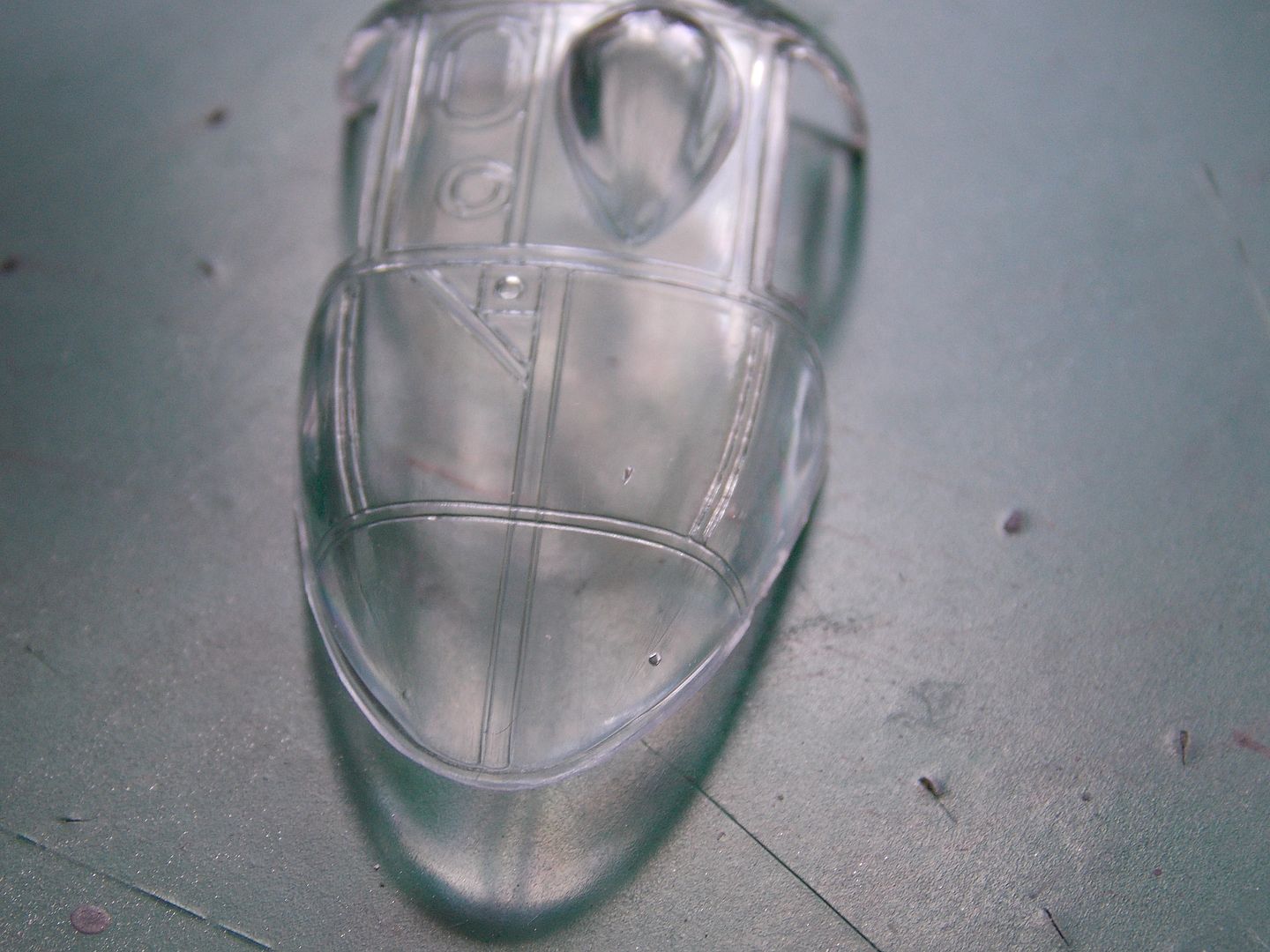

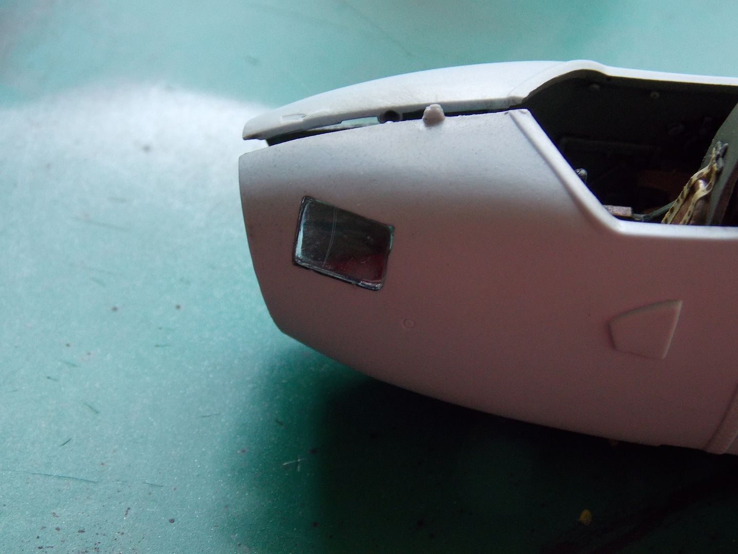

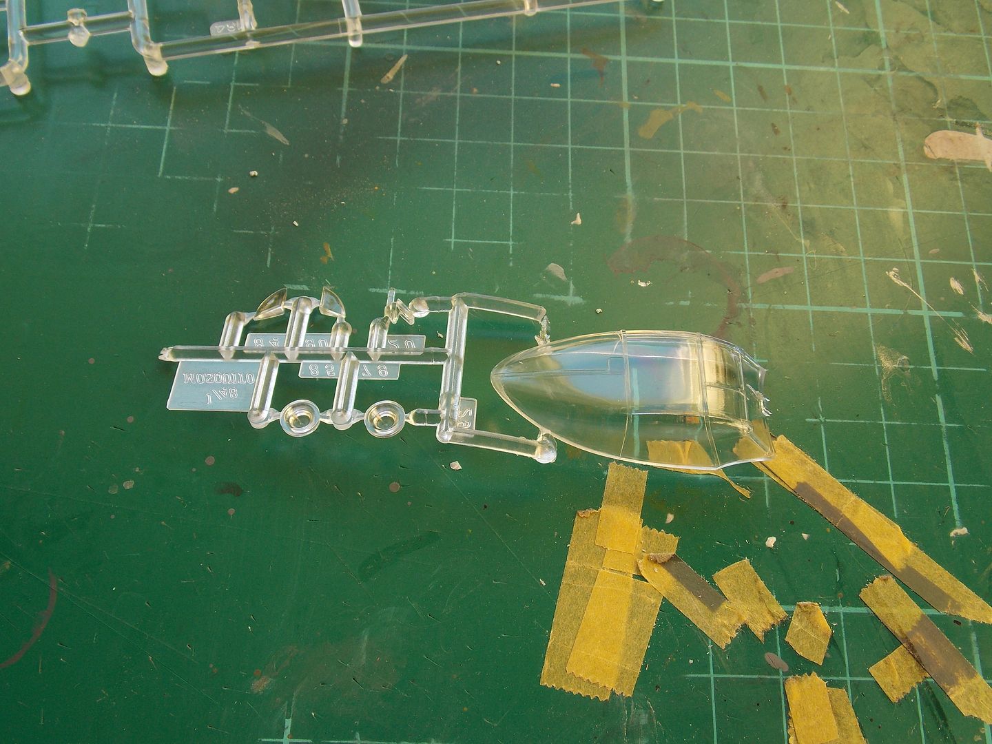

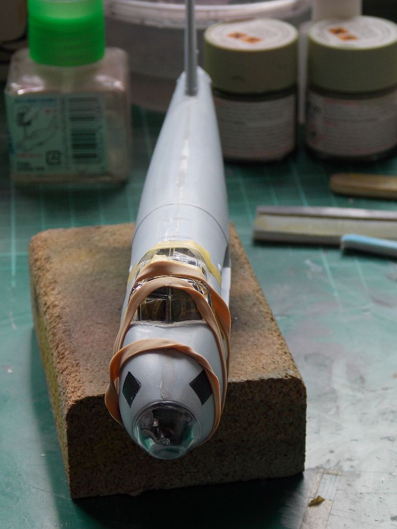

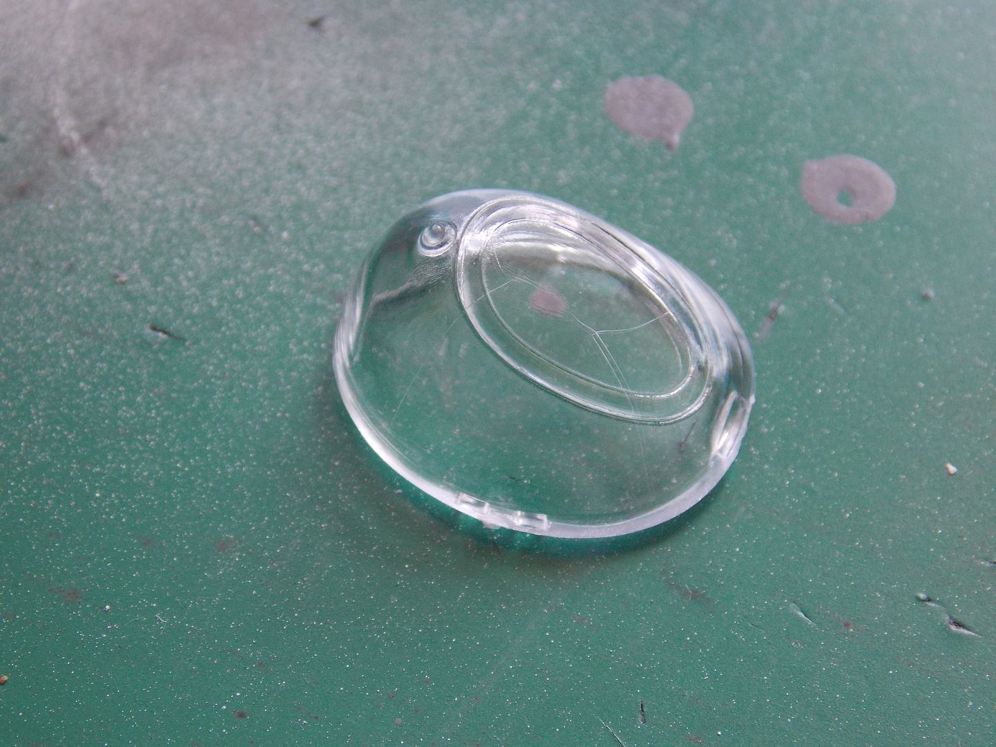

A closer look at the kit transparencies. I didn't realise that they were such a state until I took a real look.
You can clearly see bubbles in this shot.

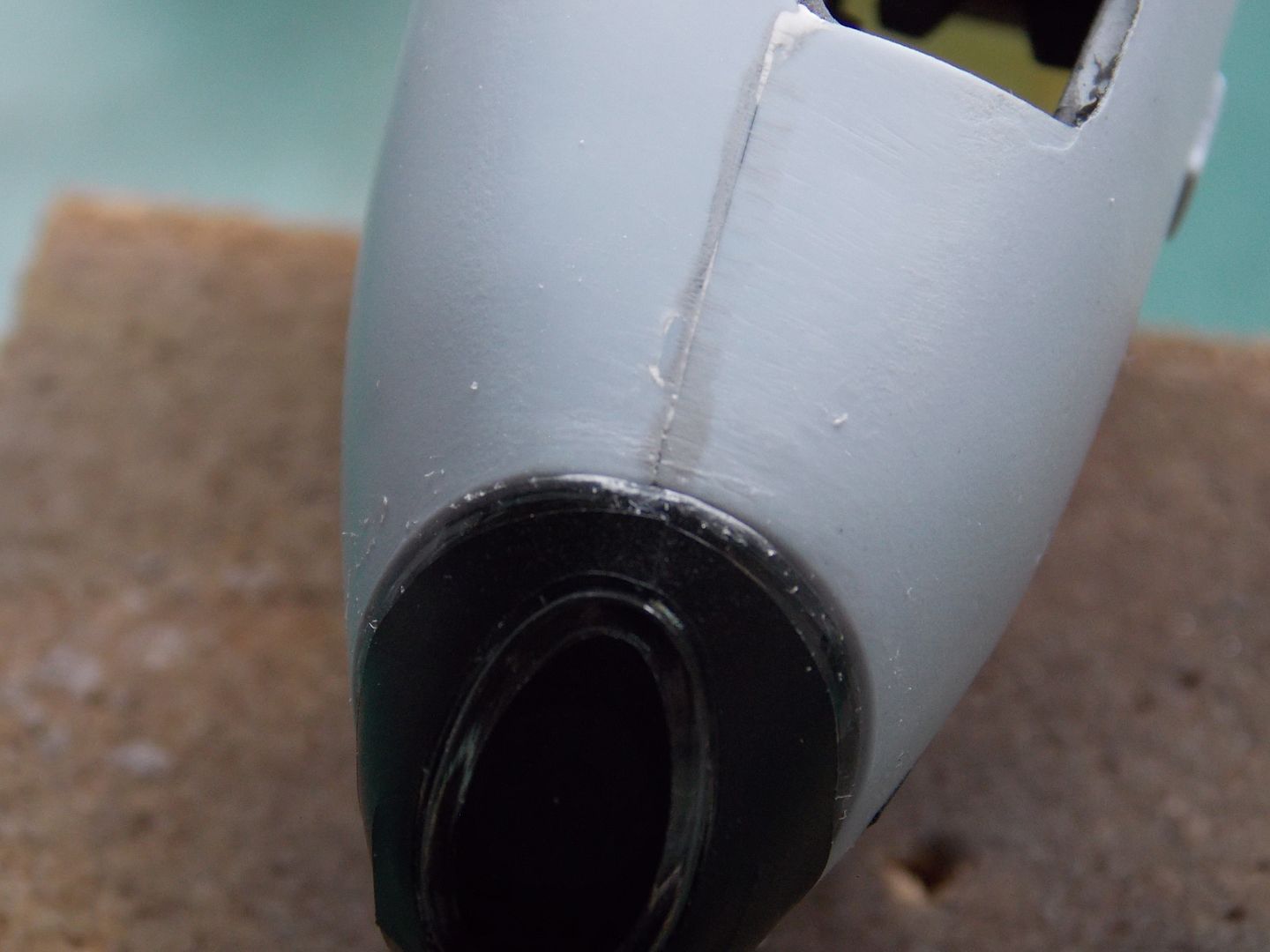

And webbing on the nose transparency.

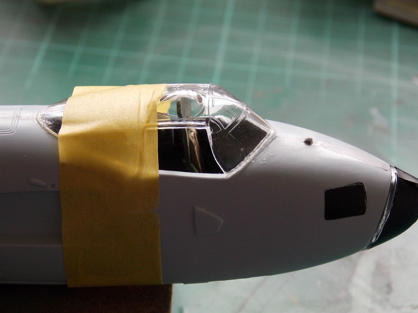

Ah well, fixed these onto the fuselage with diluted crystal clear.

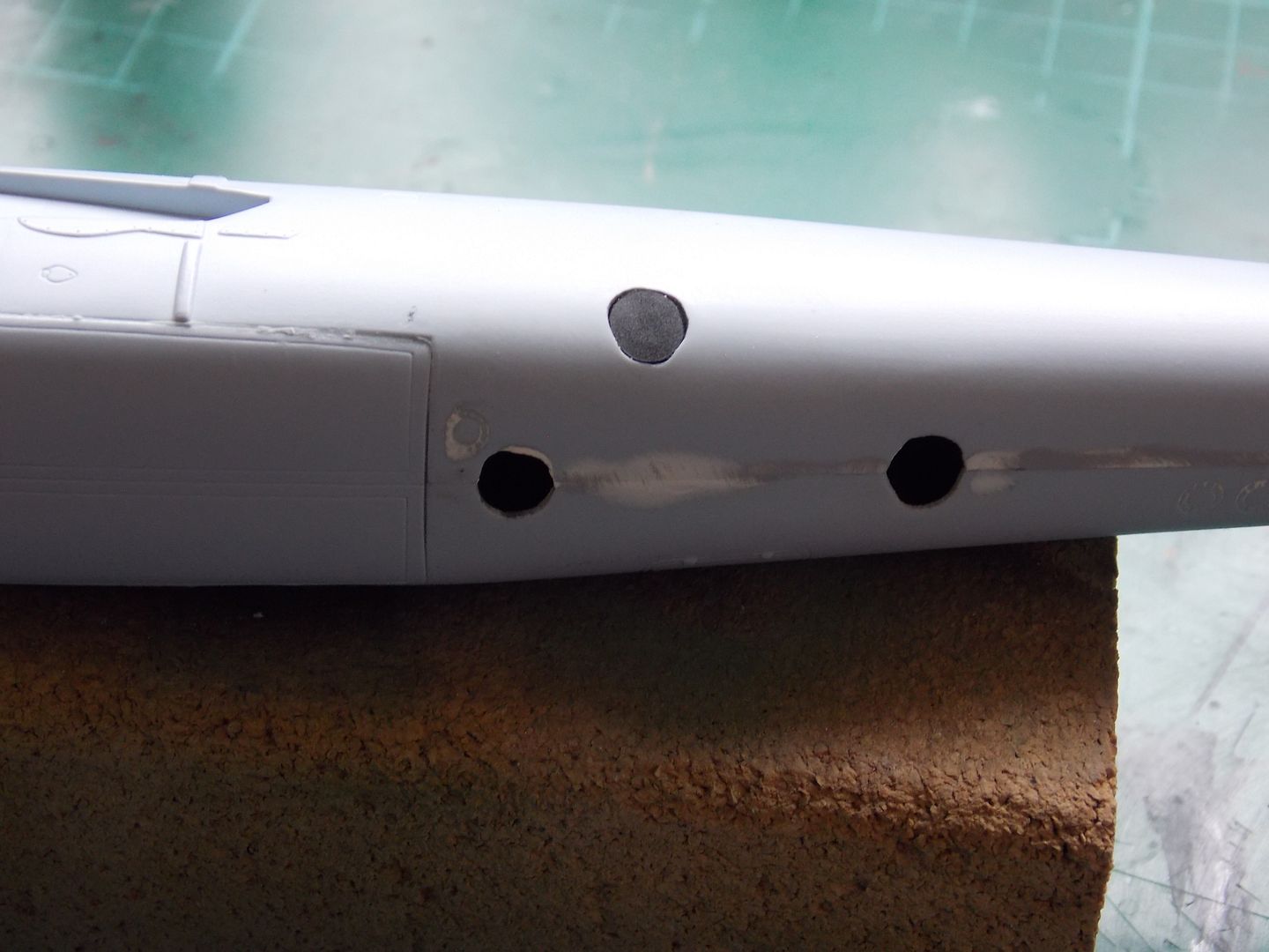

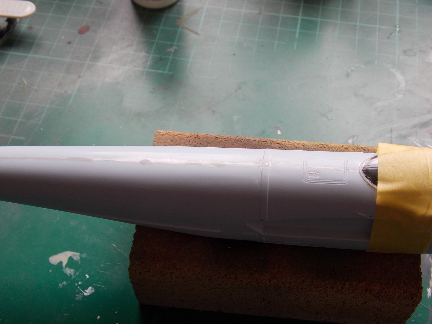

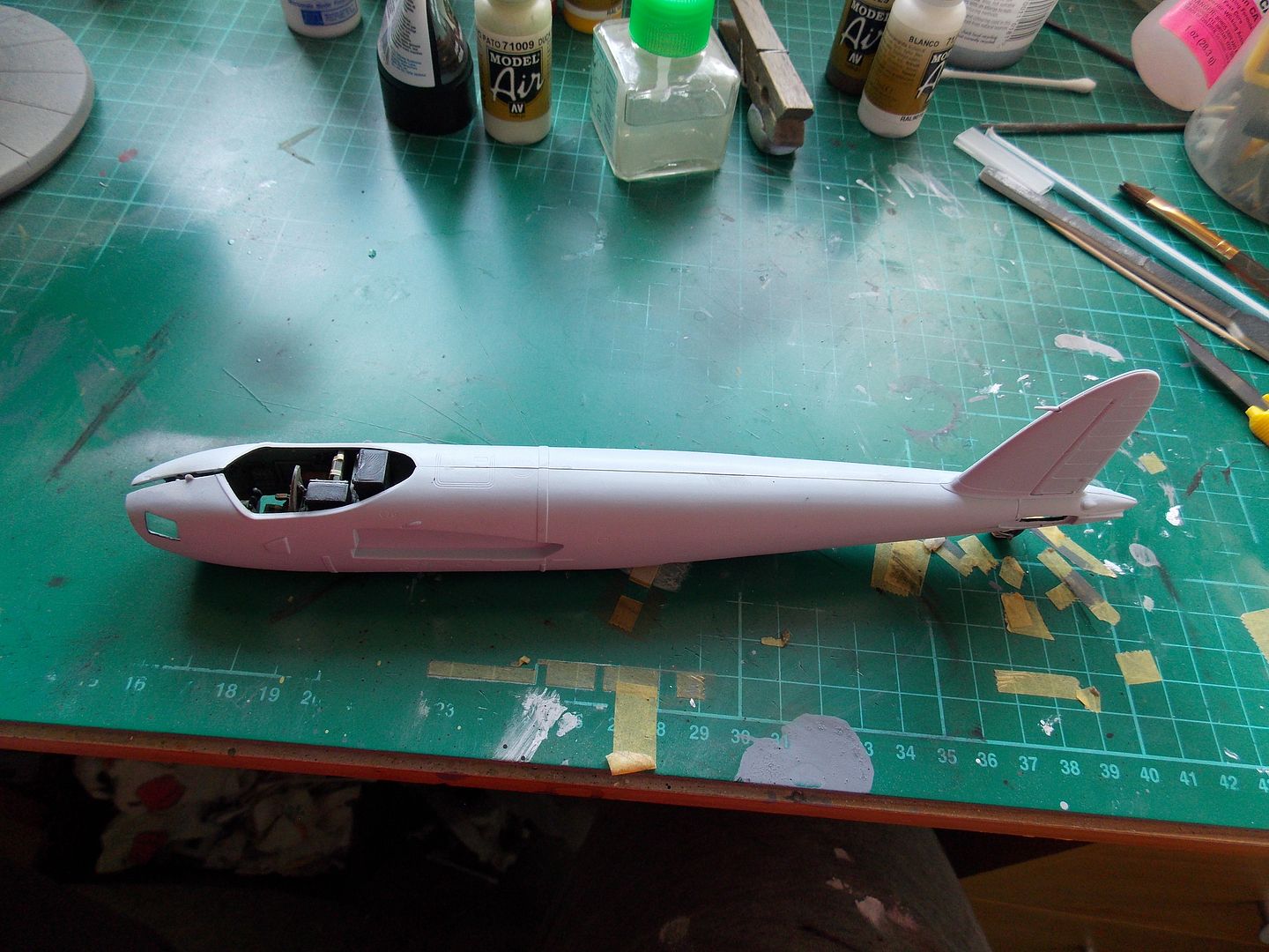

Spent a while sorting seams out but some are still a work in progress, particularly the lower nose that popped open again when I added the nose transparency. A few untidy bits to make good as well. Had started masking up when I noticed the canopy was loose at the rear so carefully added some extra thin cement and taped it up and that's where I had to leave it.
