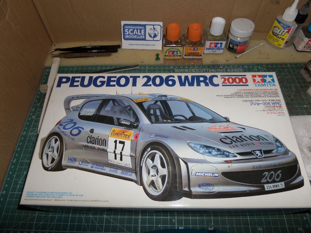

Tamiya 1/24 Peugeot 206 WRC 2000
Post by rodrant »
My entry in this Build , but will start it in some weeks , as now I'm a little busy with current builds , but curious to see how after all this years without building a 1/24 Tamiya kit will manage with the new techniques, I remember that I even do not do any Clear coat for decalling :-) , and no airbrush also , so will be good to build this ...well I know it is a Peugeot ... :-)
will be noce to do a all Gloss Aluminium color rallye car !
Cheers ,
António

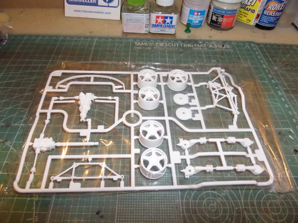

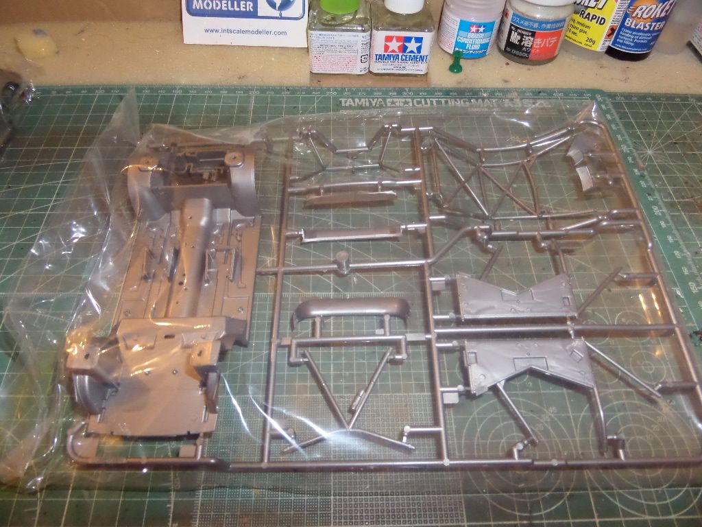

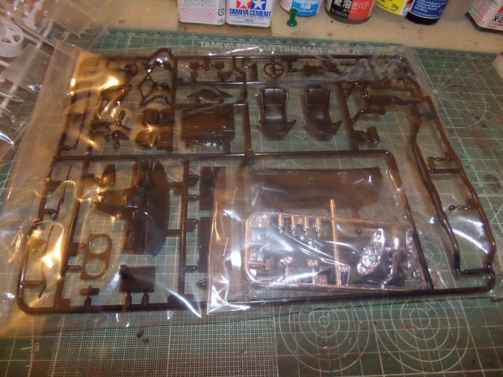

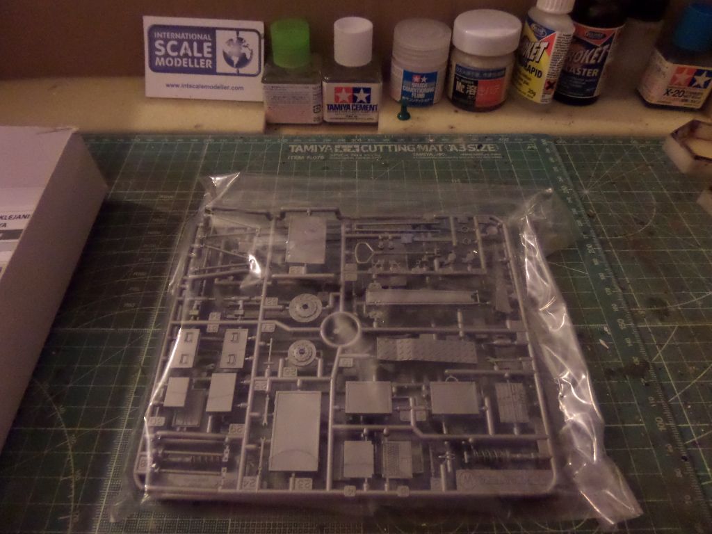

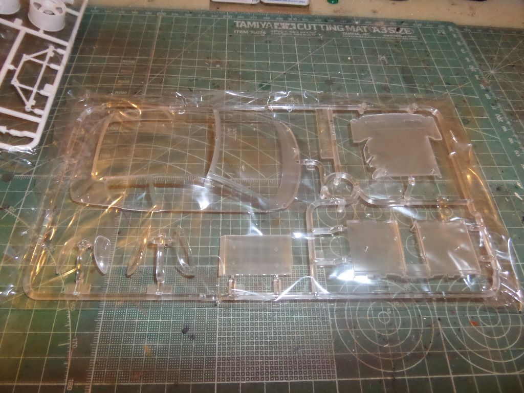

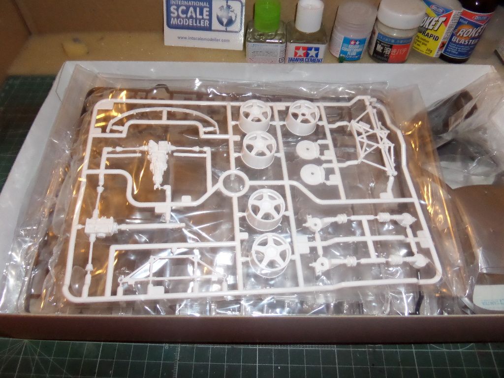

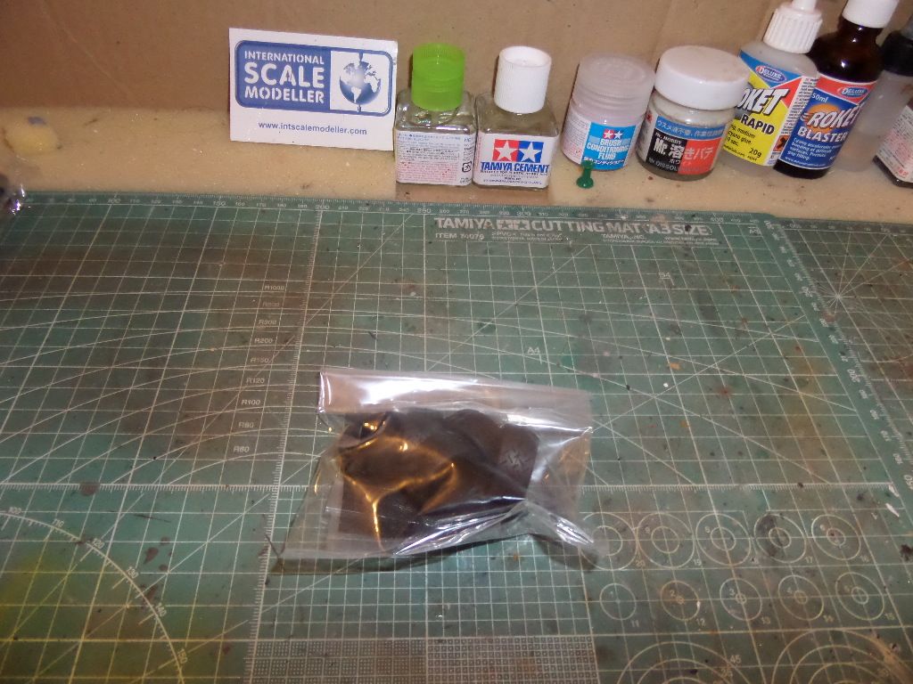

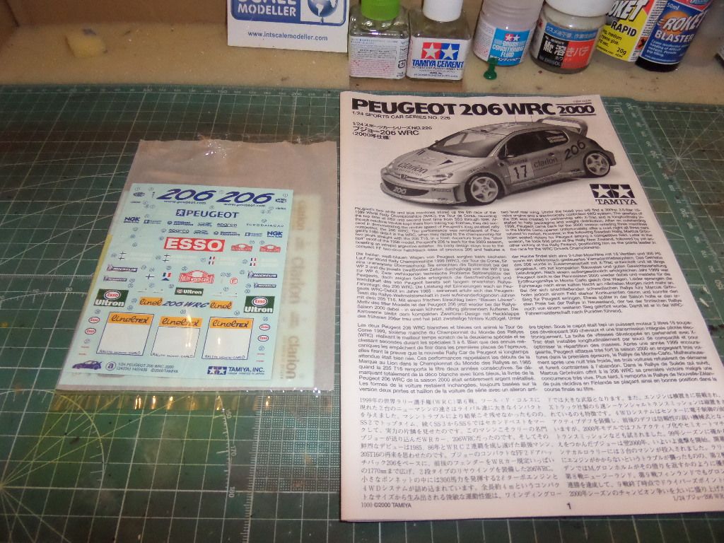

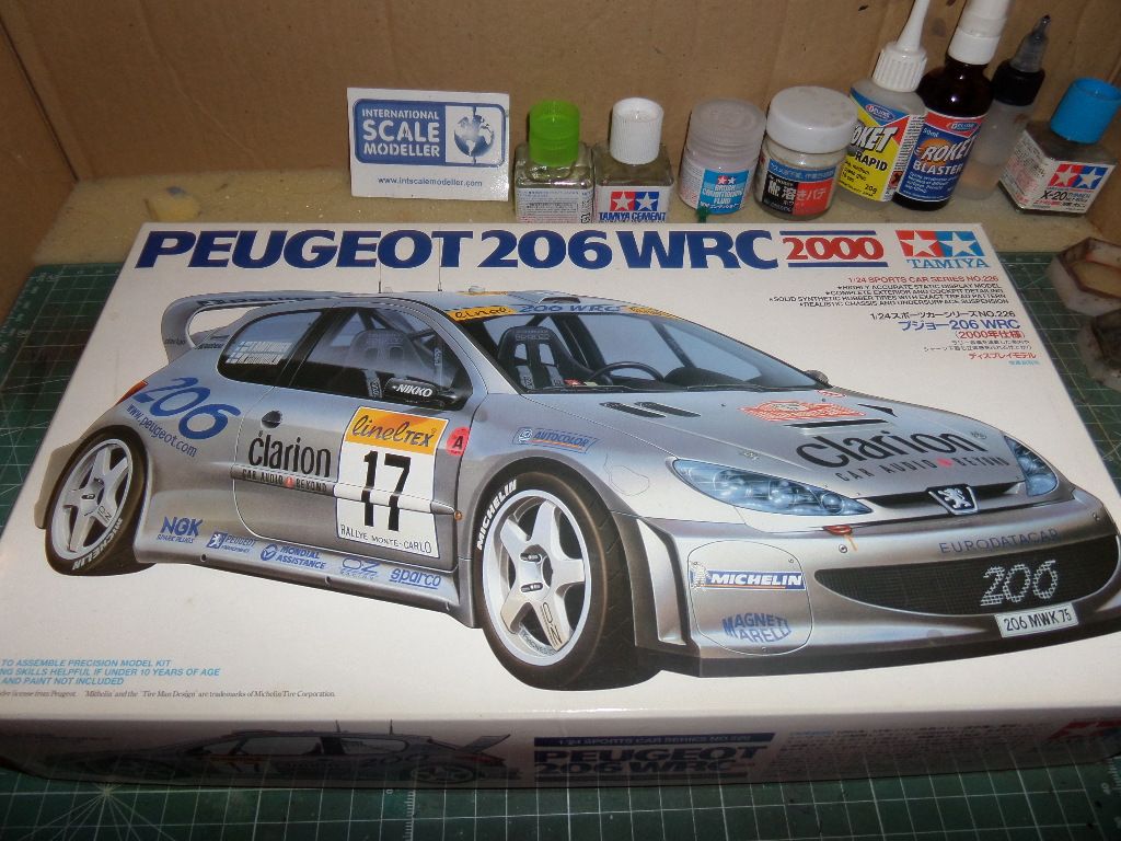

So time to make a start on this one ...
usual sprue photos :
Will use this aftermarket kits , about the brake discs not sure , as tamiya do the brakes and brake pads in one single piece , so I guess that I will not use them , yes for the seatbelts !

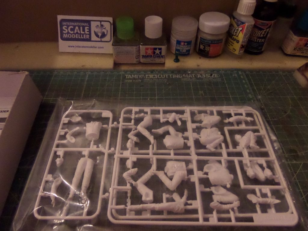

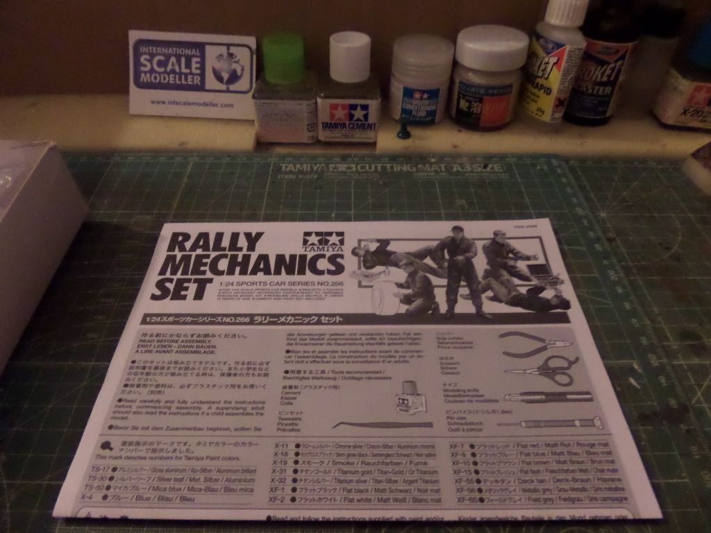

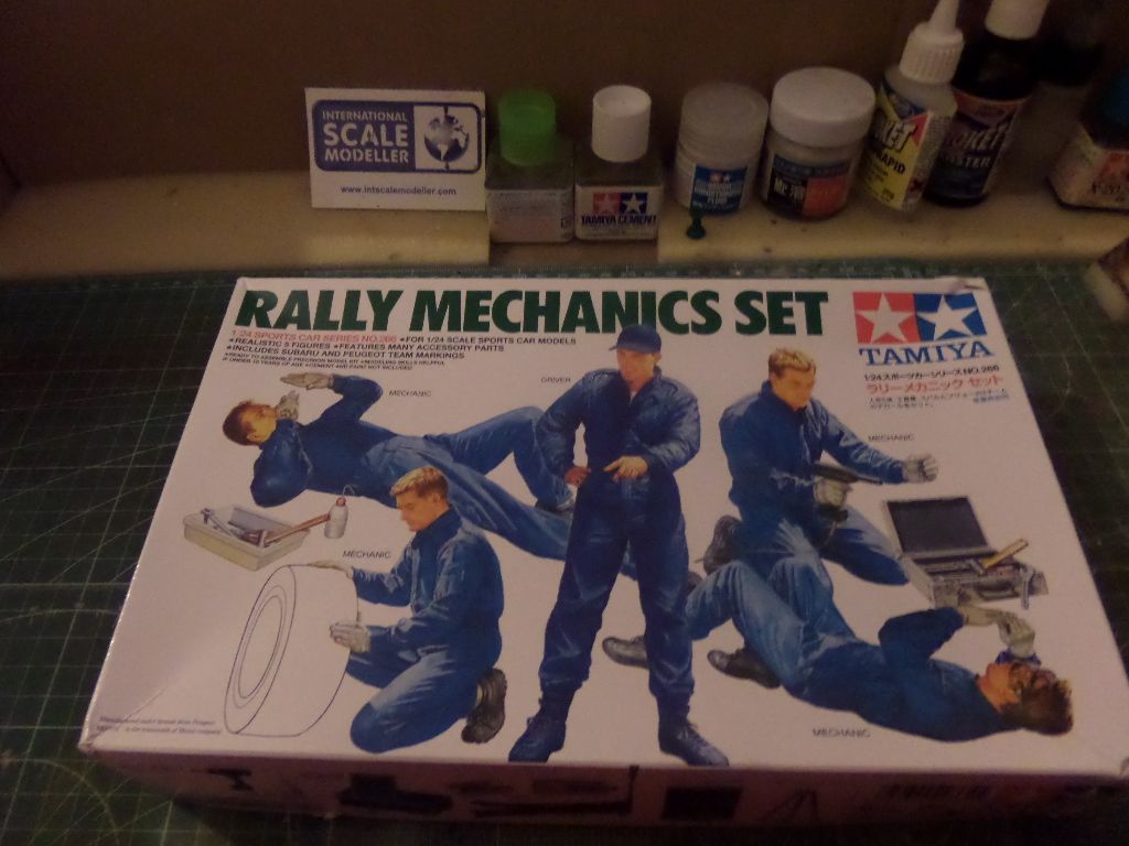

Also will use this Tamiya Mechanic set to do a small diorama of the Peugeot repair site in MonteCarlo Rallye .. :-)

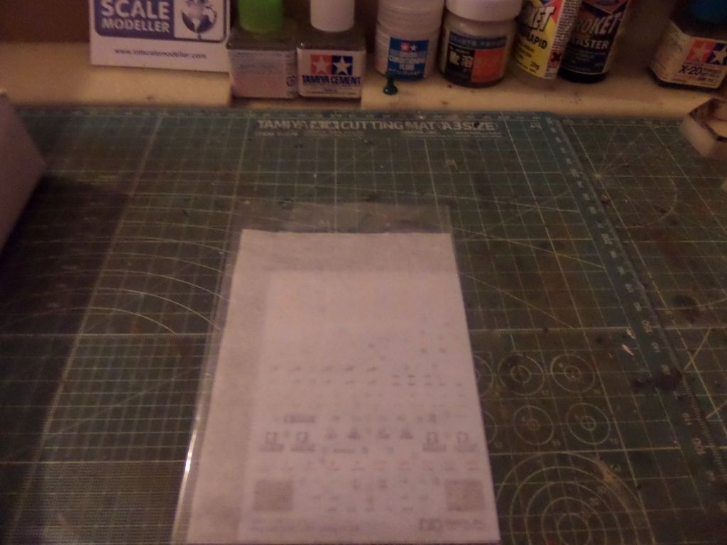

they have decals for two Peugeout versions and Subaru (Prodrive) Rallye team

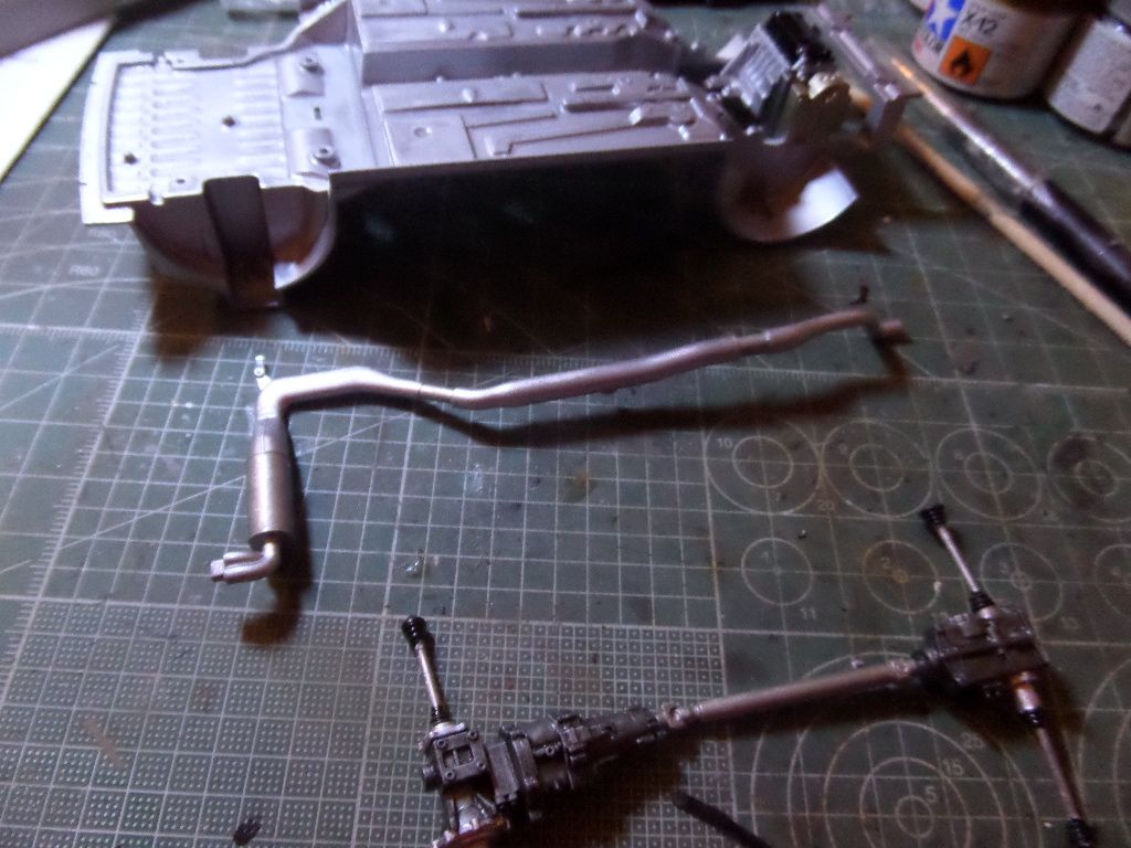

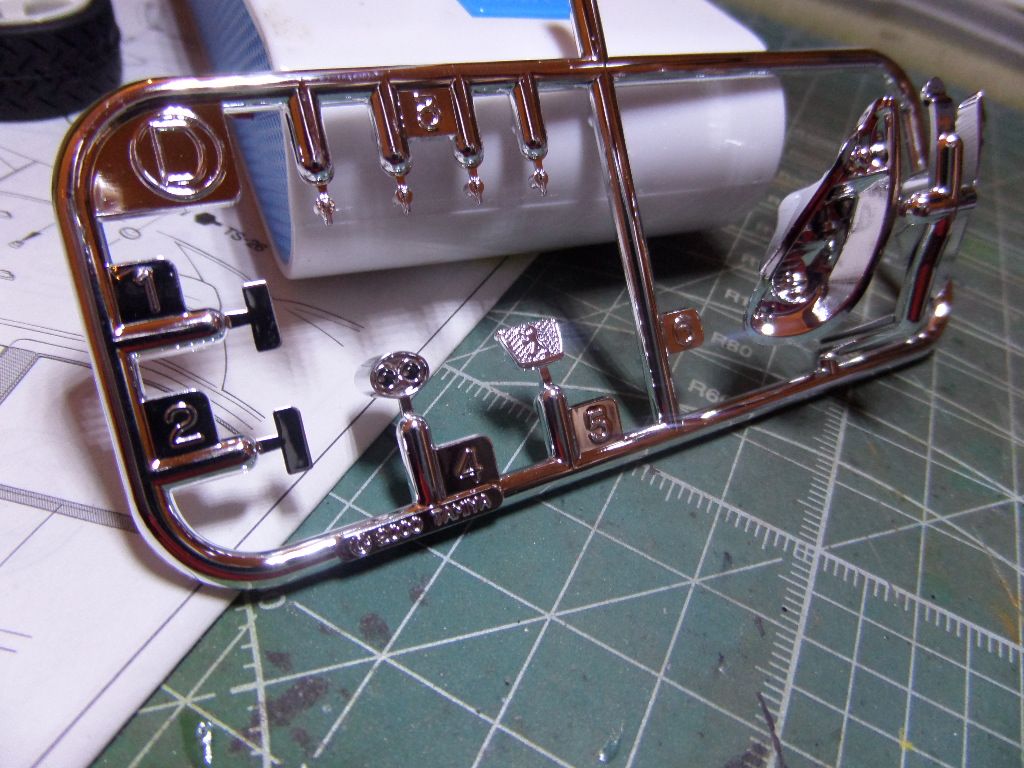

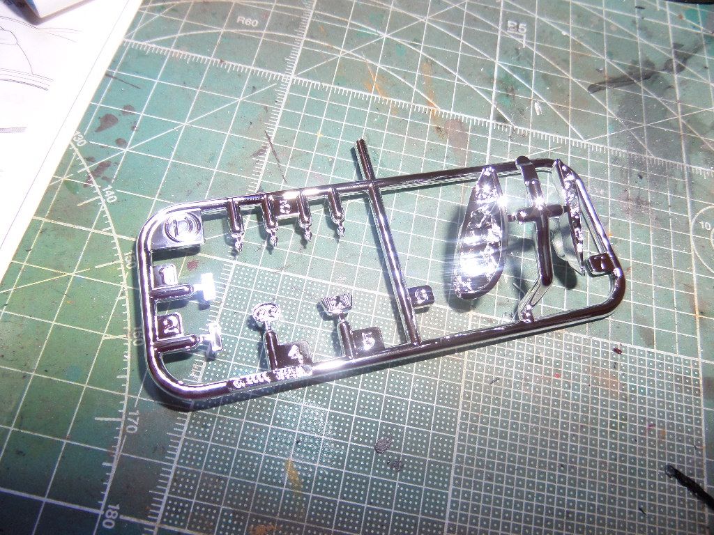

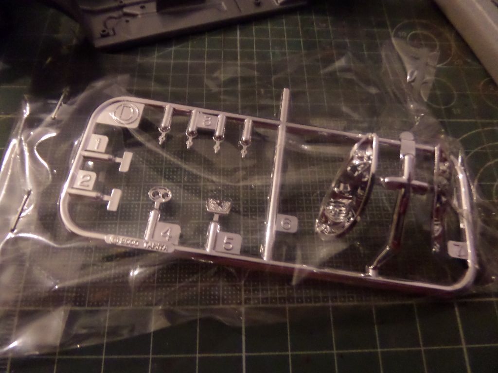

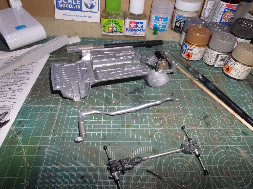

SO I started , and this also come , some chrome plasticparts for the exaust end , Peugeot symbol on front capot , headlights interiors ...nice still the color do not convinvce me but will use it like this ...
so already mke a strat , sprayed TS-11 the bottom hull , and spray the exaust with Tamiya X-11 ( my first time using this paints in airbrush , thinned it with Mr.Color Rapid Thinner , specific for Mr-Color and spray beautifull , I suppose that tamiya isn't real acrylics , now I am sure !
Both Diferentials now painted and ready to go on the undersurface of the car ! I already forgot on how many different mettalic colors we should us eon this car builds, think I use all Tamiya range on this first steps , :lol:
So , more to go maybe tomorrow ...

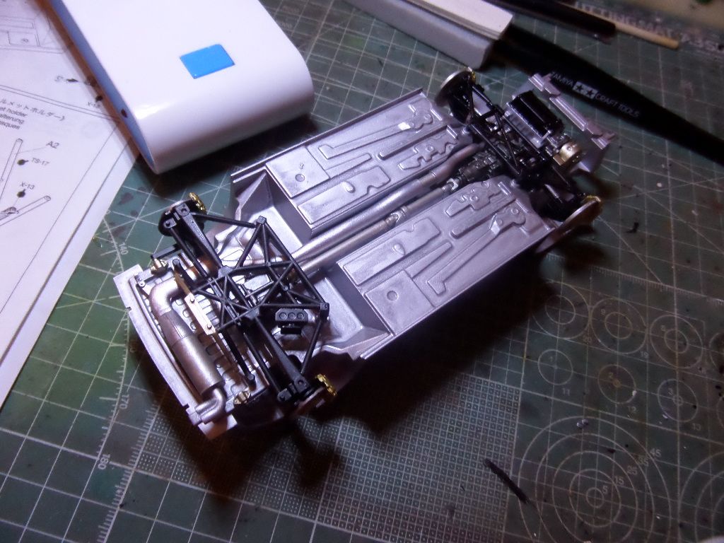

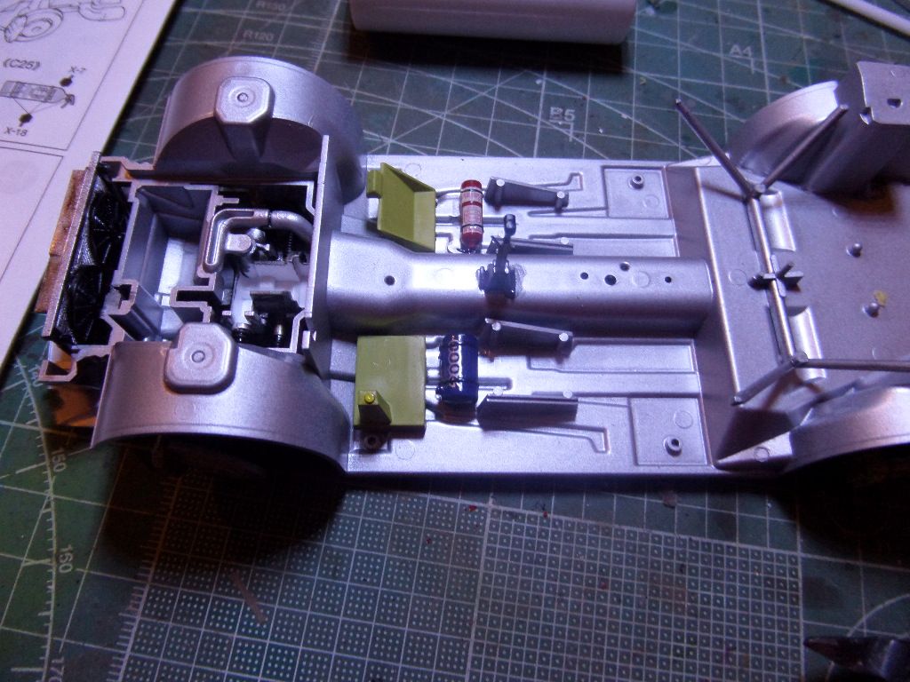

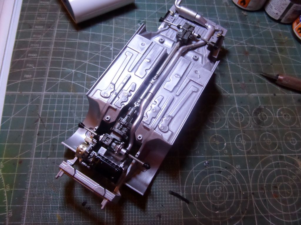

Some small update ...
So I now place all exhaust and differential on the chassis

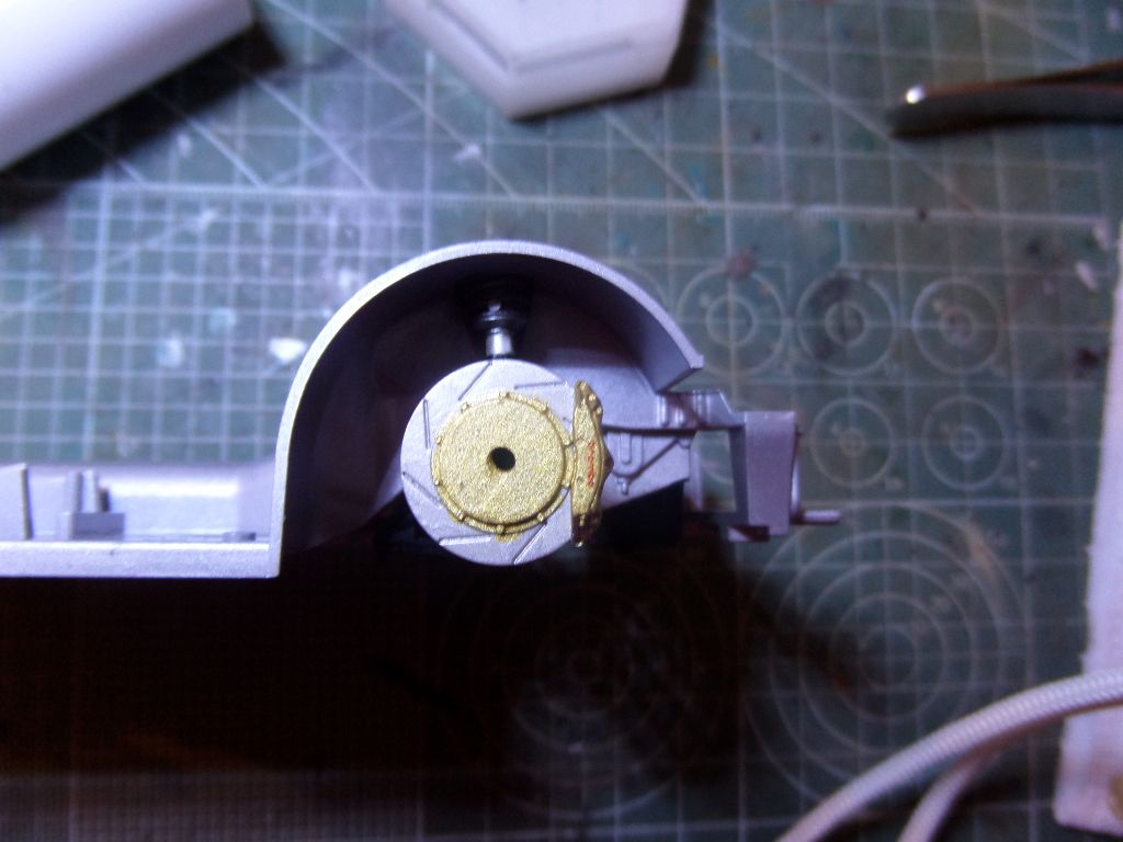

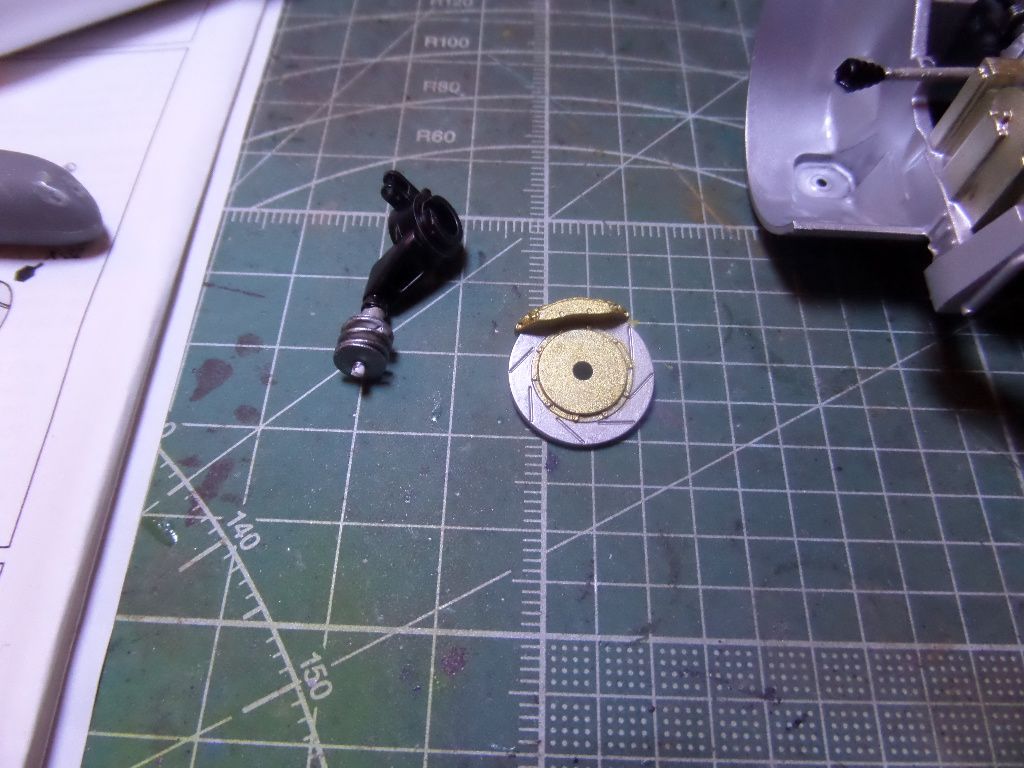

Time to do the shock absorbers and Brake discs ...I bought some PE discs , but to place them here I would have , or to cut them or to remove the brake pads ...neither option as Tamiya plastic has some nice detail and do want to make a not long build on this one ...
I think after painted it has some very nice detail :-)
Time to place the first decals (very small ...) on the brand of the Brakes ...Brembo it is the brand , well known in WRC :-)

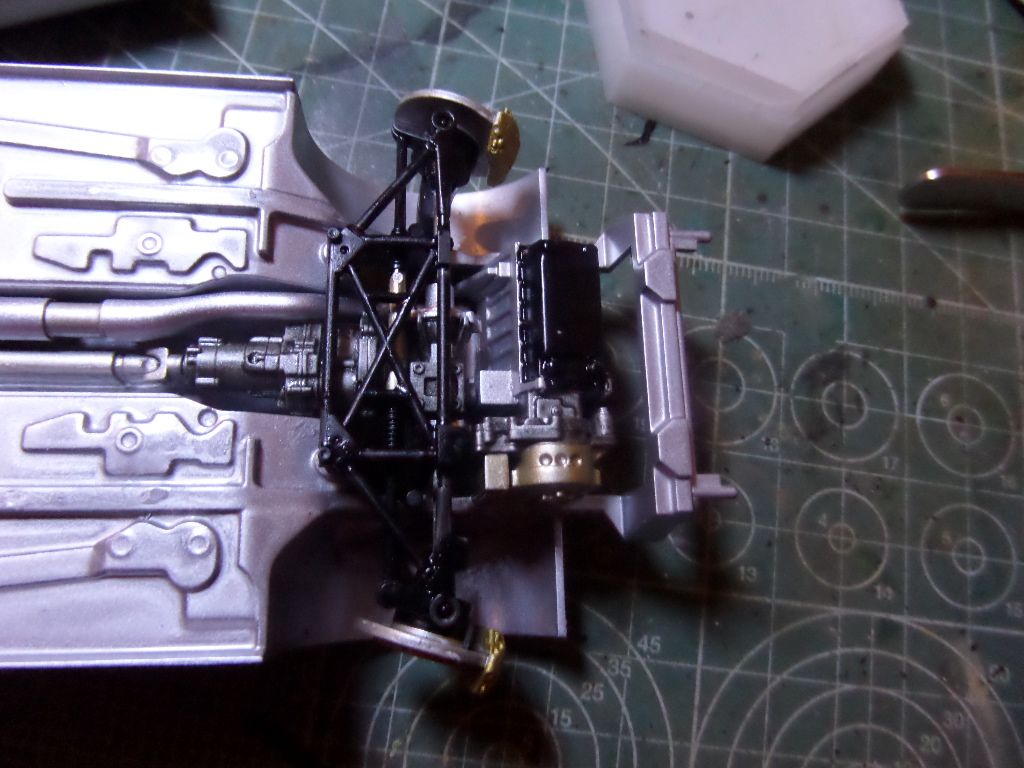

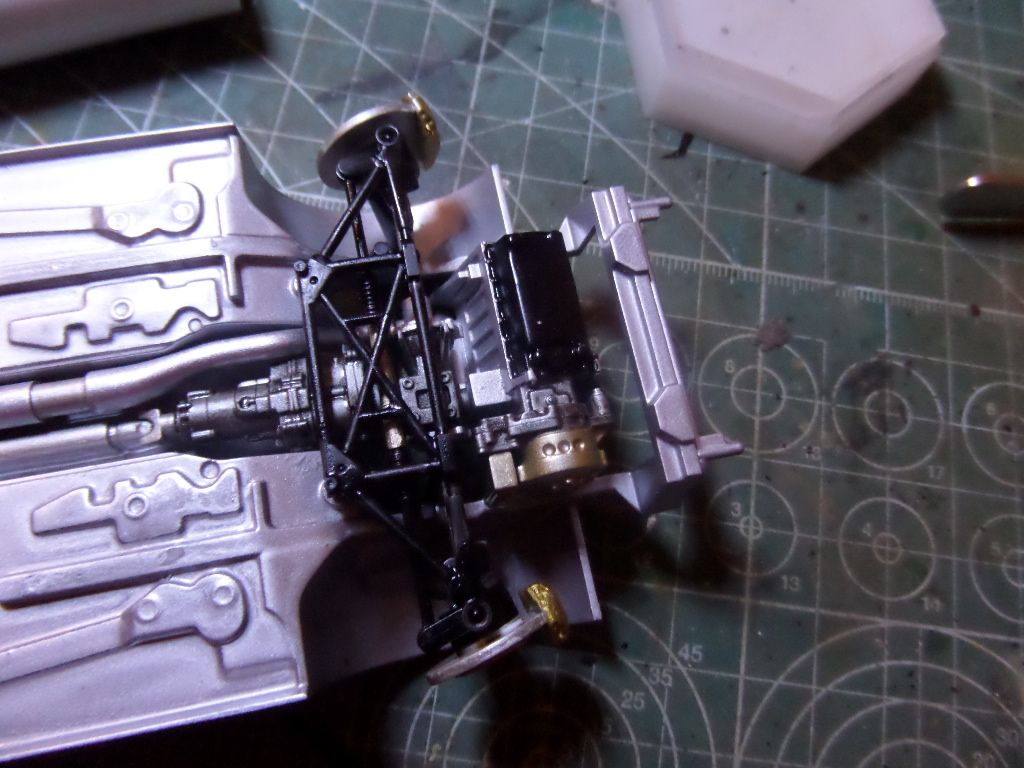

Front diferential with ecerything on place , also direction work :-)
and on this side :-)
and for the Image

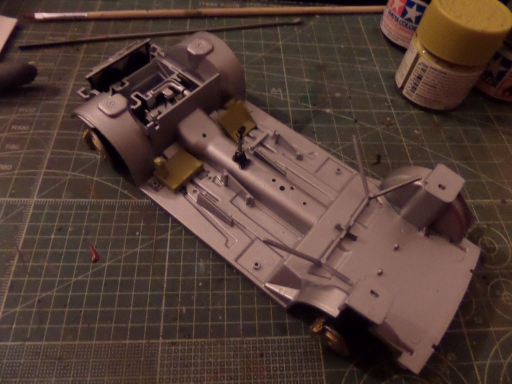

also on rear suspension and diferential all placed ...quick build , a lot of brush paint done ...

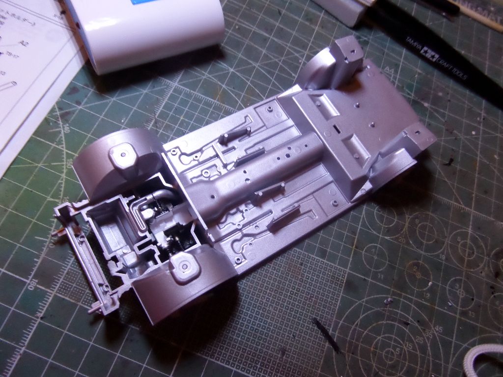

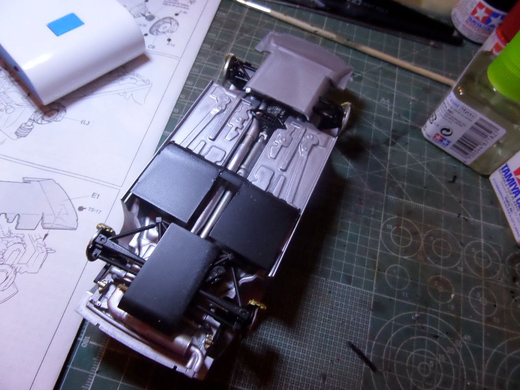

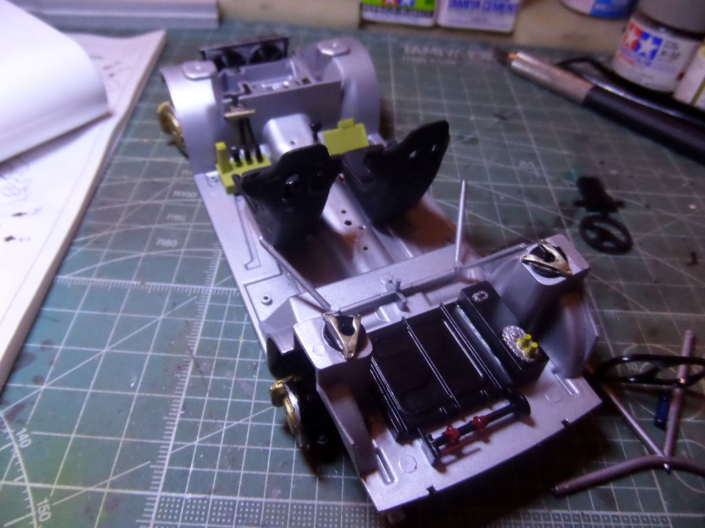

so , we now turn it upside ...

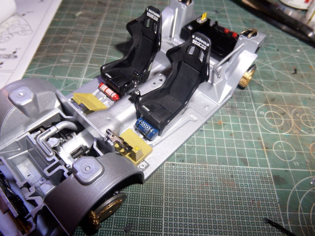

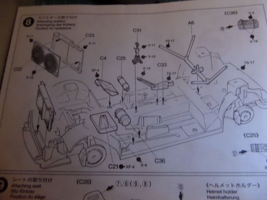

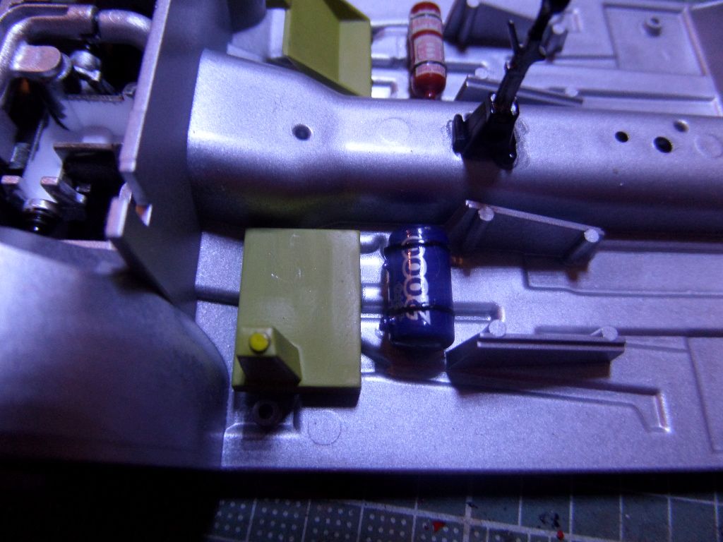

Time to place all the parefernalia of interior gadgets and accessories
I place the bottom protections of the differentials , the parts were clear plastic, guess that you can place thm like that to see the differential details ...always painted them :-)
SO littel by little small pieces painted and added ...

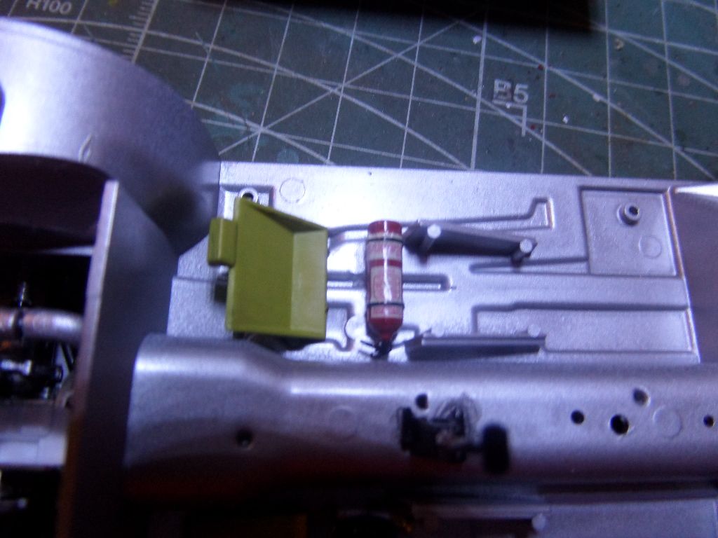

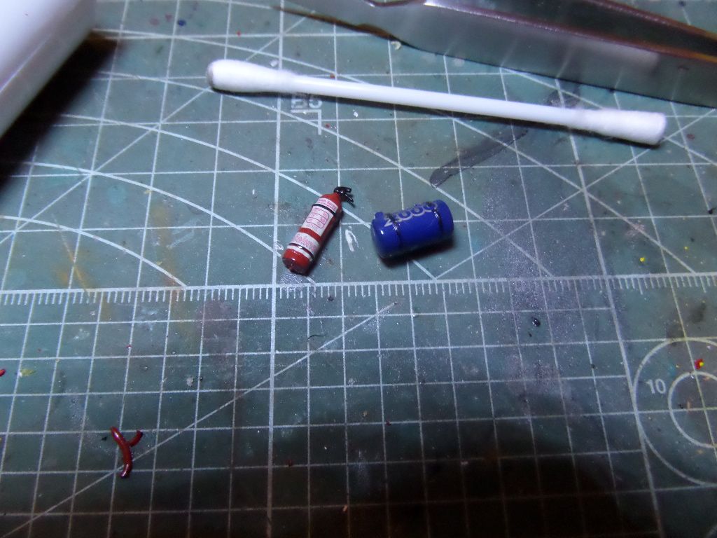

Fire extinguishers ...funny stuff , and liked a lot all of this small details

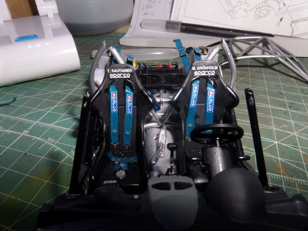

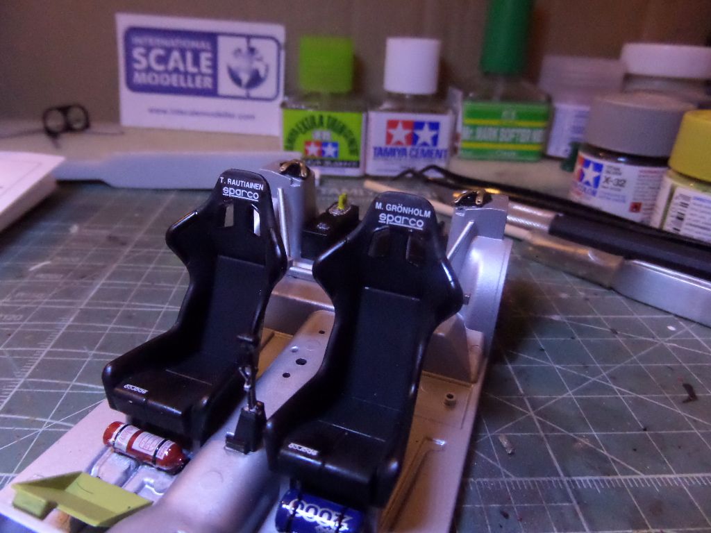

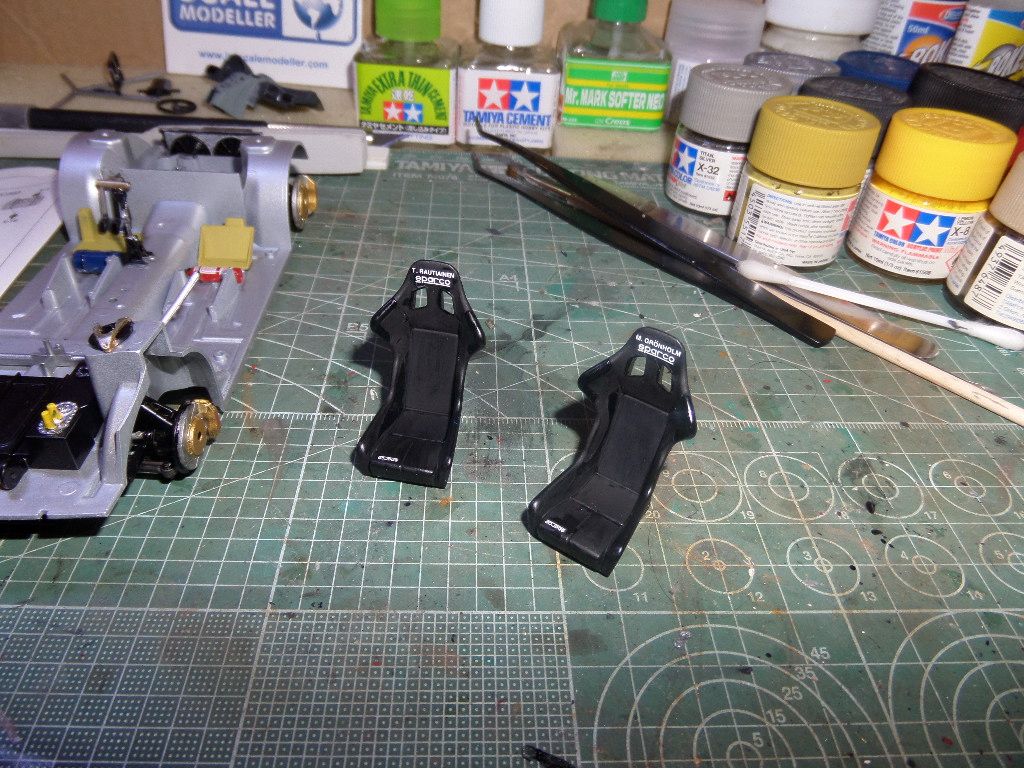

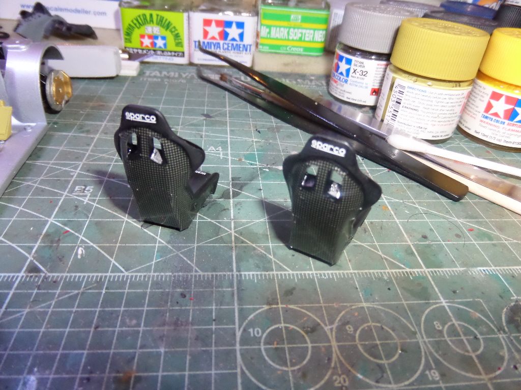

Seats placed just to see , real nice after some paint on them
Today's work was decals, the seats begin very nice with the decals on them :-)
Not so good the decals for the rear of theseats , depicting carbon fibre I think , hard to place ...but was pleased on how they turn to
Real nice, now only miss the PE seatbelts

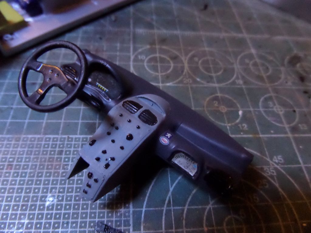

The dash
Really like the seats :-)

The fire extinguishers look great.
Nice work on the carbon fibre decals for the seats.
I made a bit of a mess of mine when I did them a while back. Tamiya decals are too thick and difficult to shape around the curves.

Really the decals ...The kit has two sheets of decals ...one the decals aren't bad , but the other ...I already mention this before and I'm not alone , Tamiya makes good kits , in some of their kits the decals are crap ! In this build so far I got all decals placed and no rip off or something ...

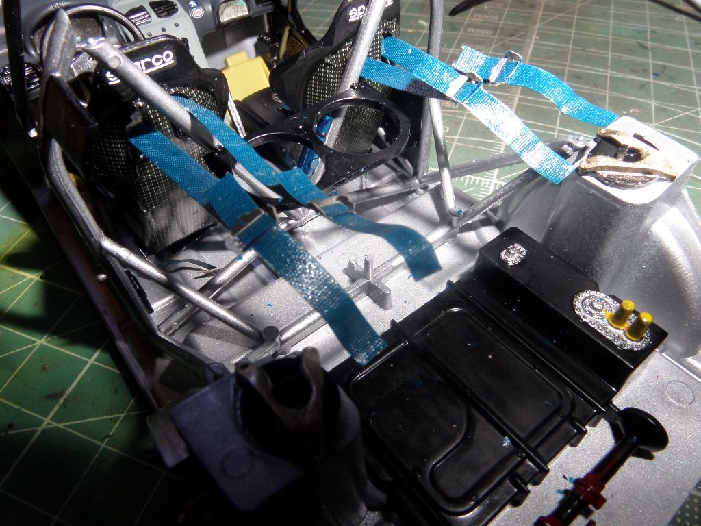

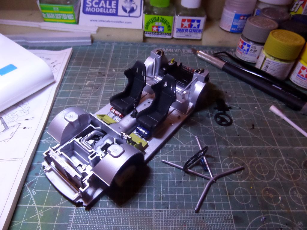

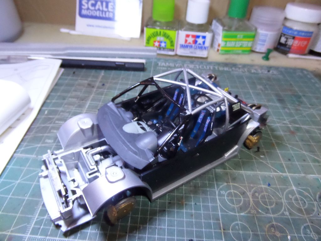

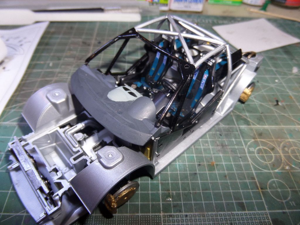

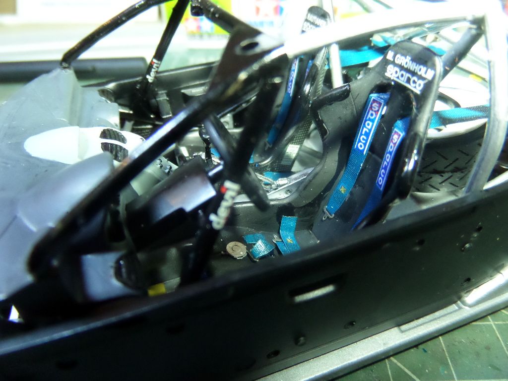

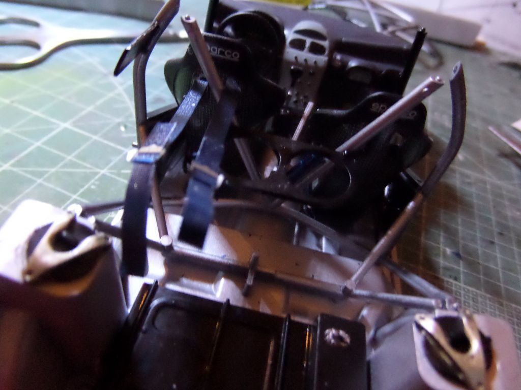

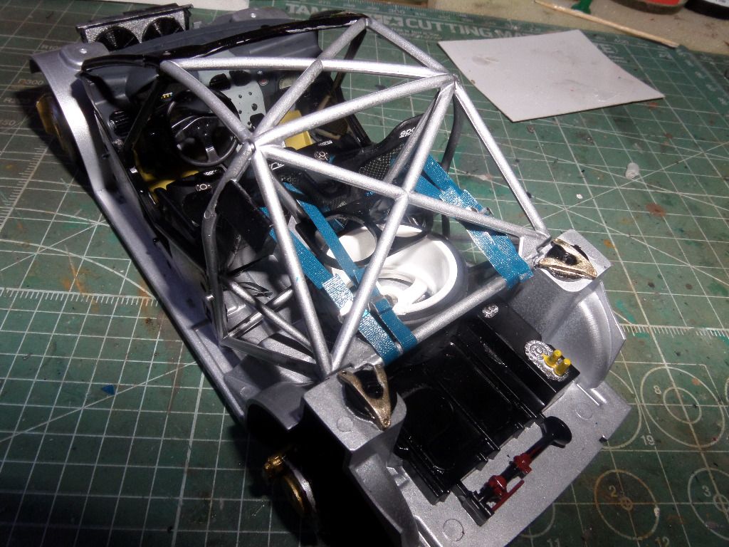

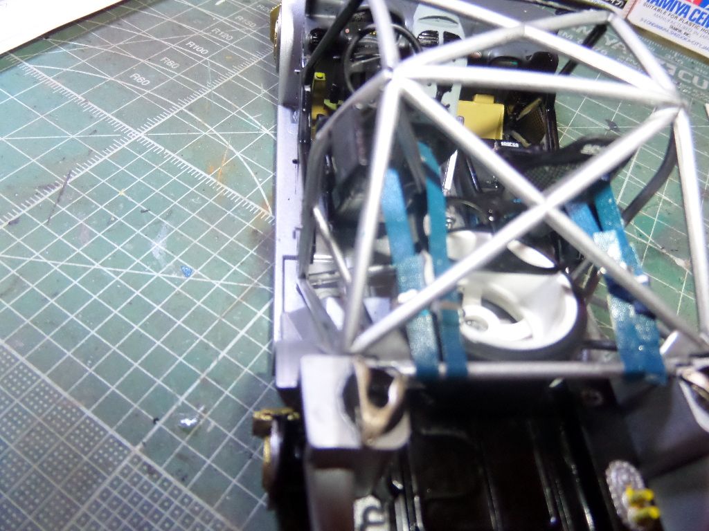

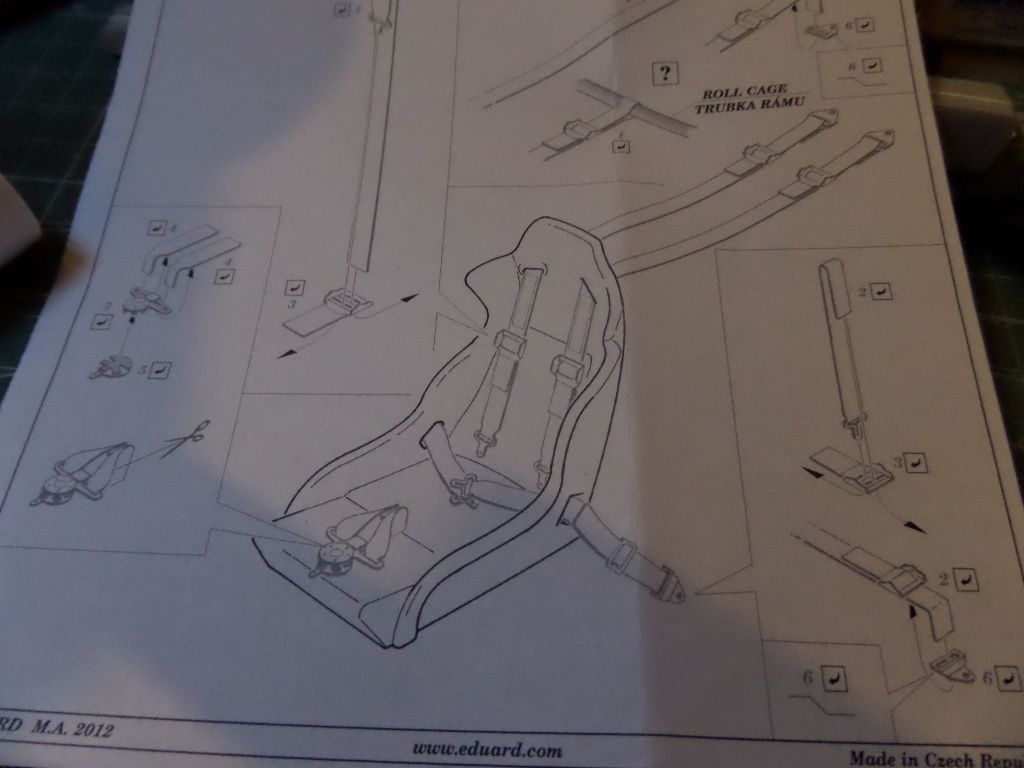

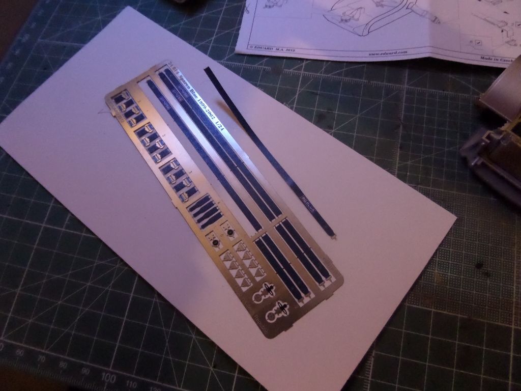

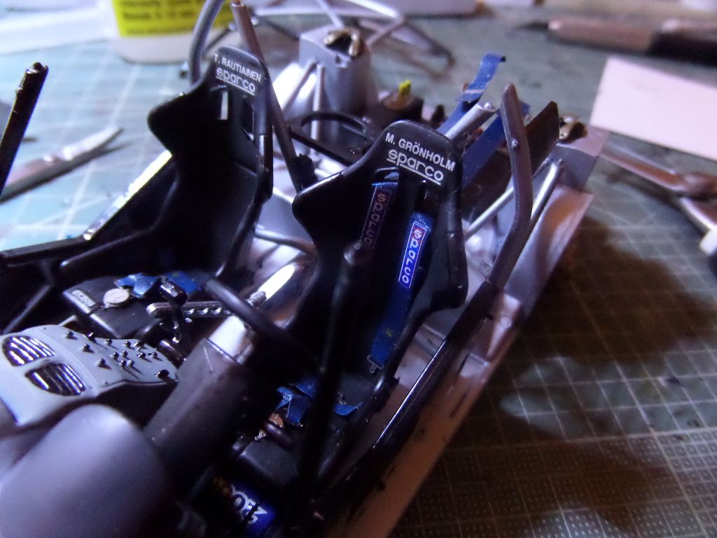

time to make the PE seat Belts , an after market from Eduard !
not easy ...easy are the cockpits from planes :-)
I must palce this before I placed the roll bar safety cage glued , they are going to be fixed to the roll bar
But already we can see the nice detail that this PE seatbelts bring to the model ! Nice!

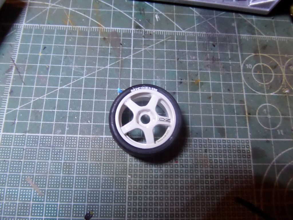

MAke the spare wheel ...so much work with the decals and thi is going to be unseen the wheel has its face on the floor of the car :-)

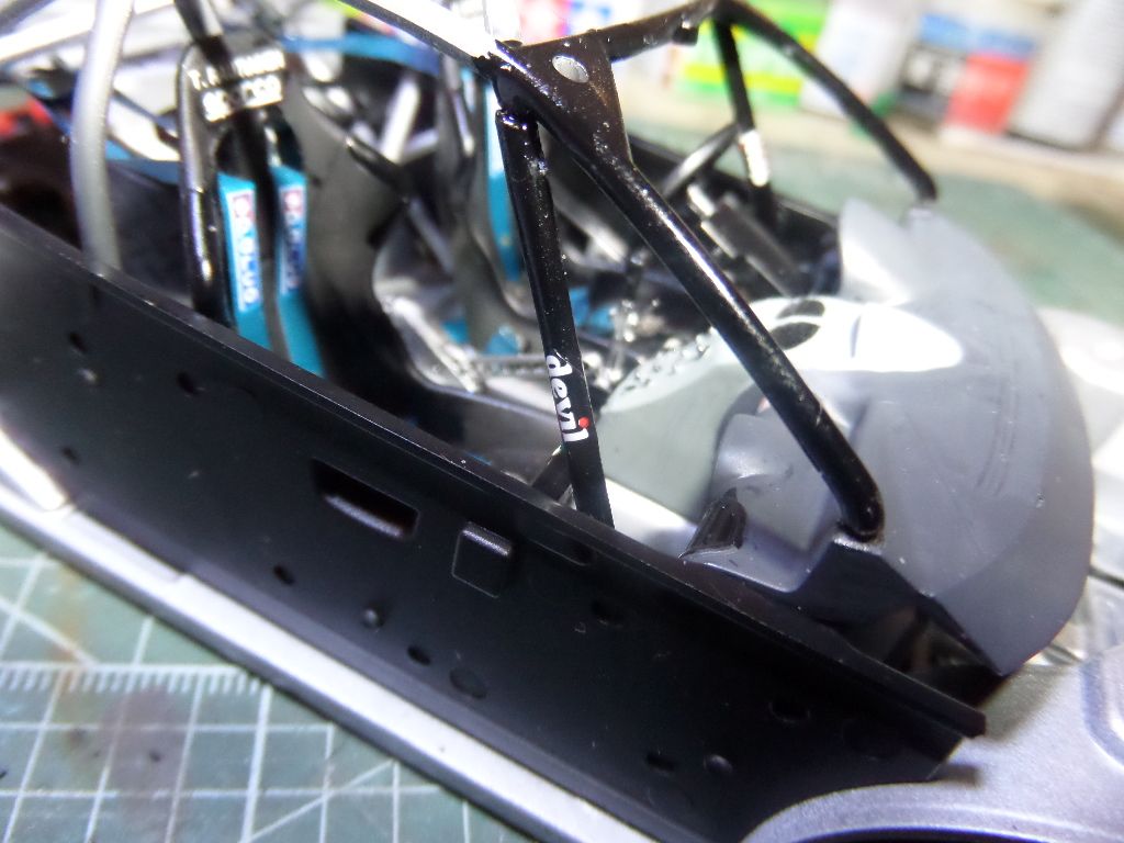

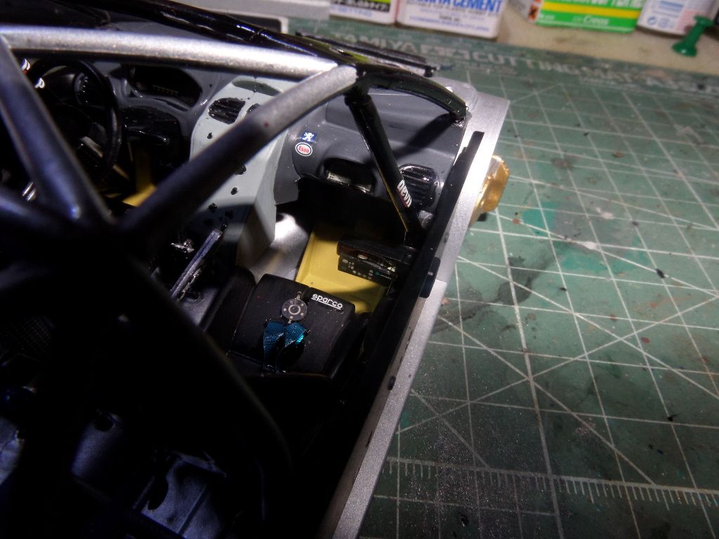

So PE placed and rool bar cage glued !
Todat placed the interior of the doors , has this device for the navigator
And almost forgot to place this decals ...2 on each side, and not easy to place ...

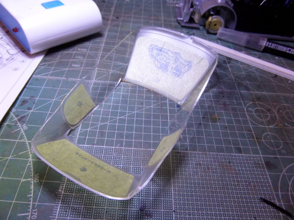

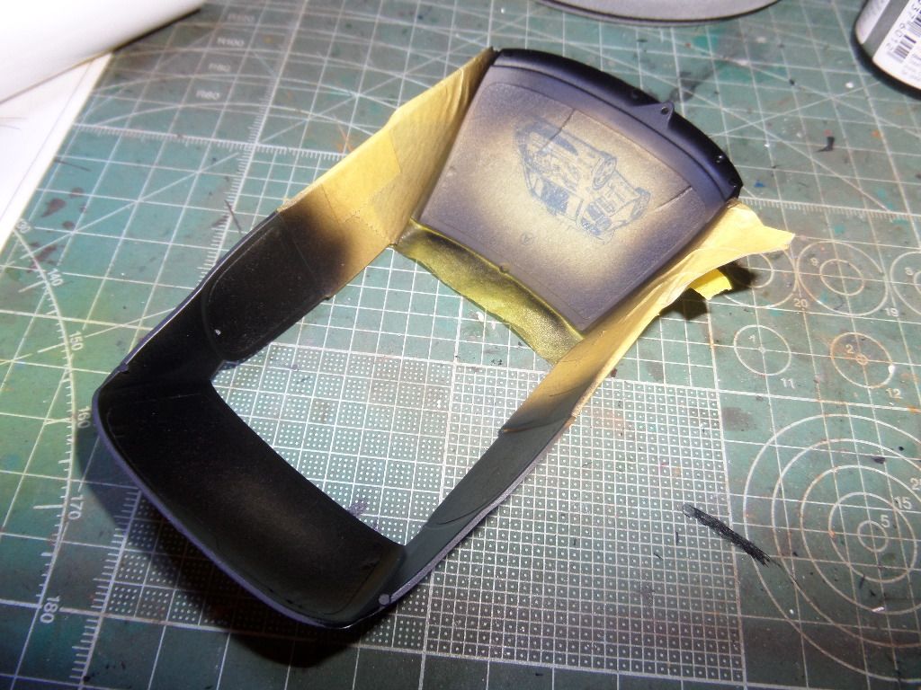

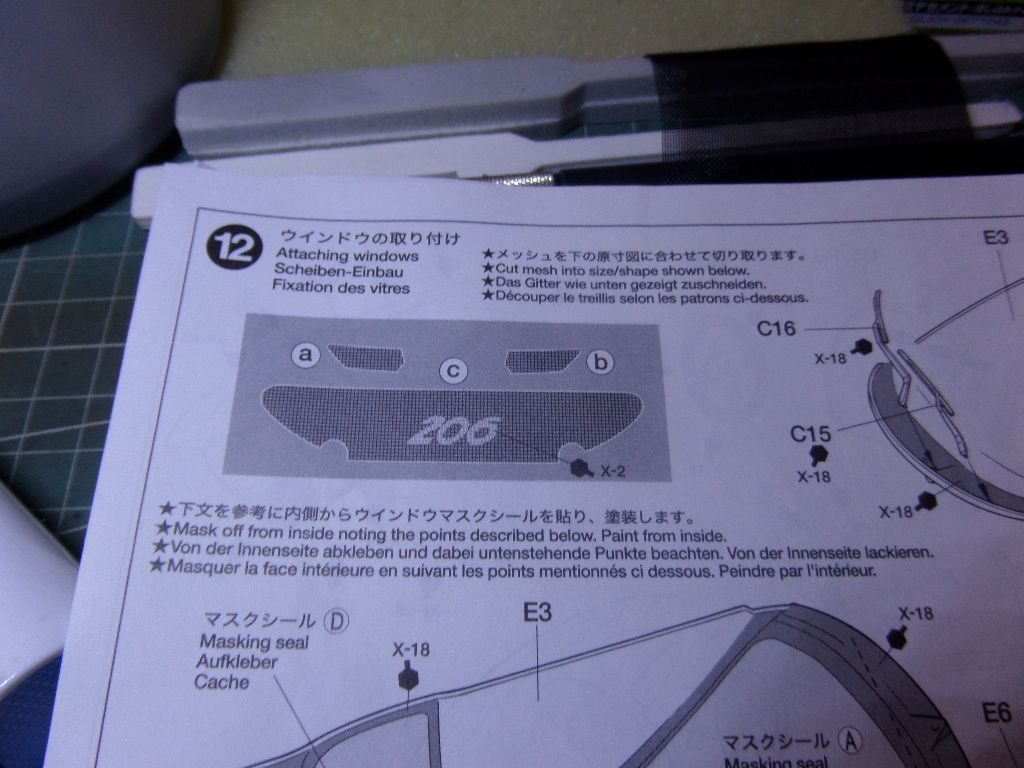

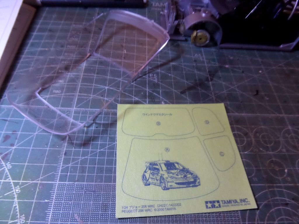

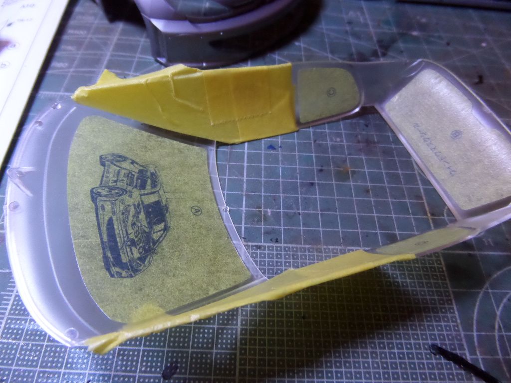

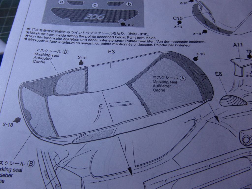

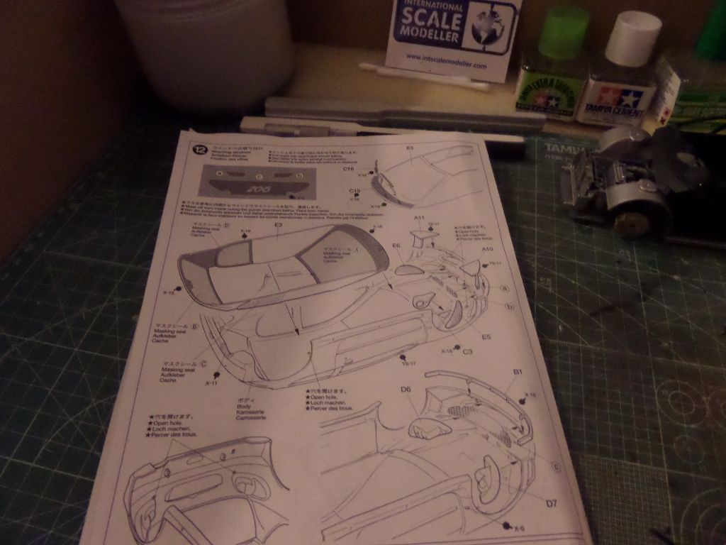

And now the building fase that I was always afraid when I make this models ...a Big Glass ...a lot of paint detail in black ...and to spray the car body !

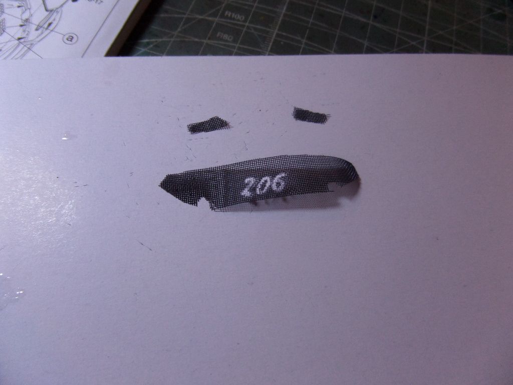

must do the 'grill' also ...and paint the 206 logo in it ...
MAsk the interior ...yeah ...right ...but we must have more masking ...
This is what I mention ...you mask in the interior and will paint interior Balck X-18 (semi gloss black ) , but what about the door windows :-)
I can imagine airbrushing and all become with little black particules ...so mask On !

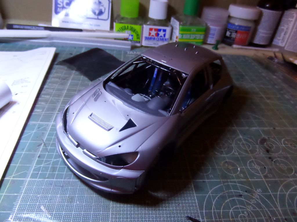

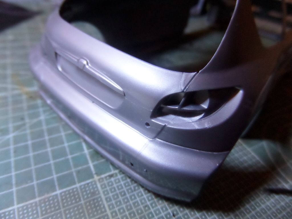

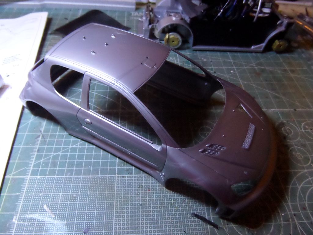

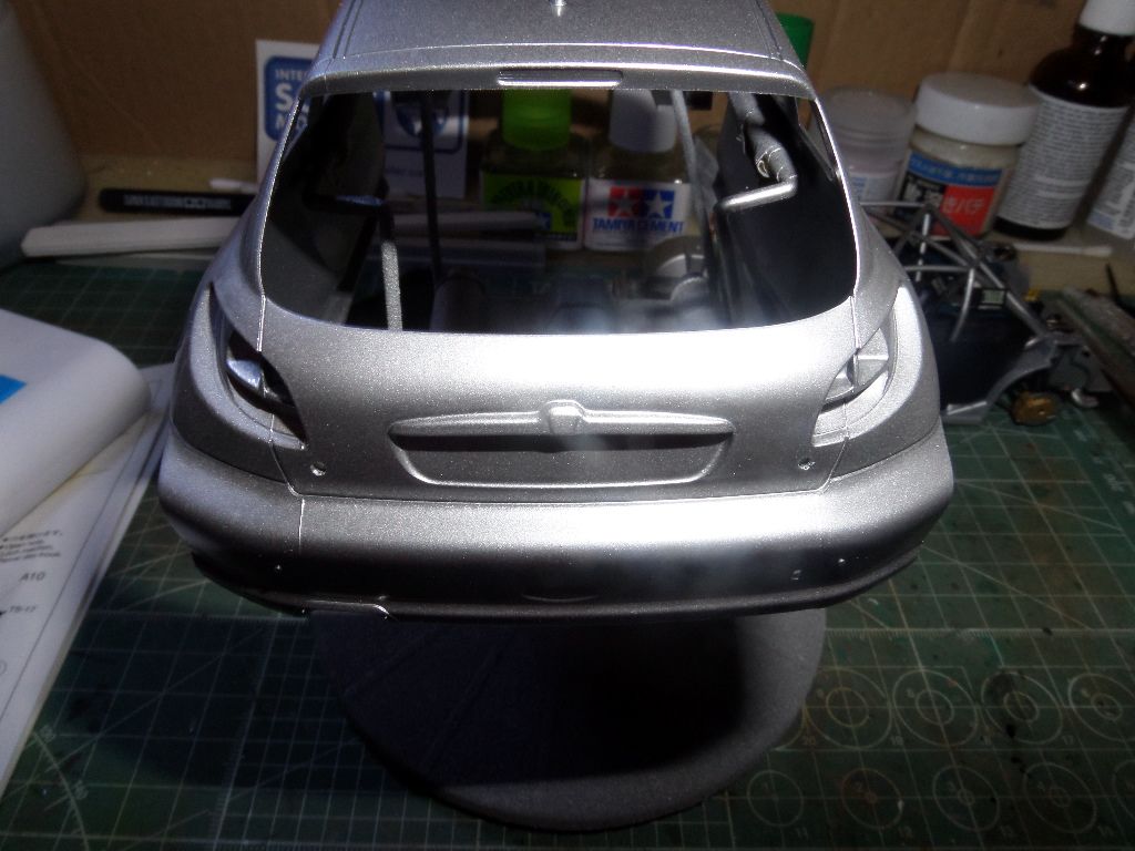

The body ...
Som edrills must be made in order to later fix the capot locks

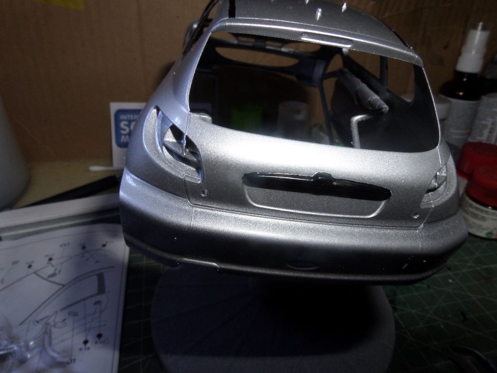

in the rear also

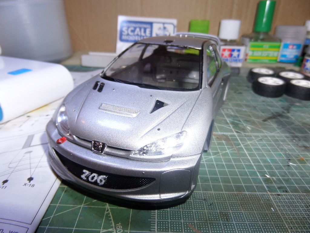

Looking like a Peugeot now ...I had a girl friend that had one like this , well it was the 1.1 Lt motor ...
Painted with spray TS-17 ...now I Paited it directly with spray with no Primer ...this Sparay has some reaction different than the others , maybe it is the color ...I only make small bursts and try to move along , if not you get a lot of paint excess ...think ot look ok , make two bursts and it is ok , I think , later after completly dry a coat of Gloss Clear coat and ready for decalling ...but first must do the detail paint work ...
The mesh with the 206 logo painted ...not bad I think ...

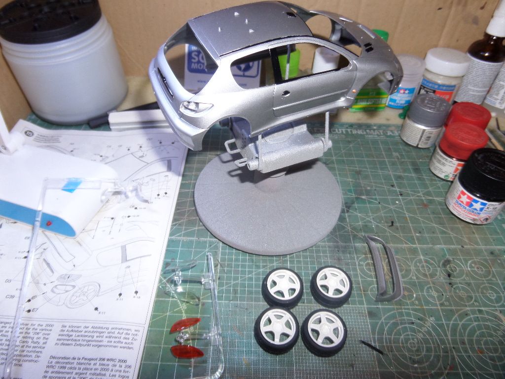

Now I make some more slow progress

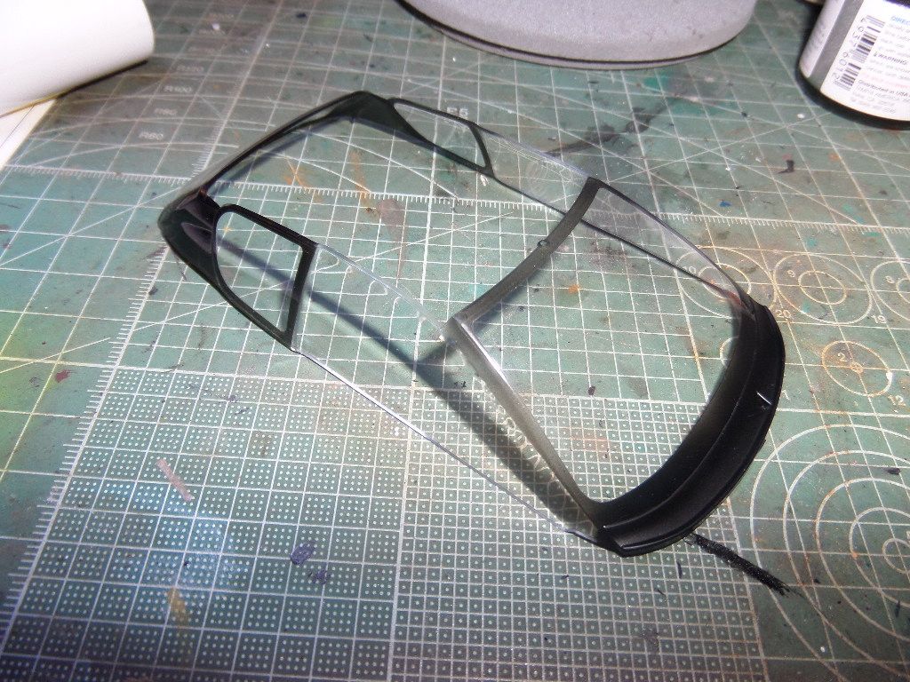

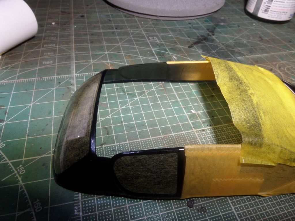

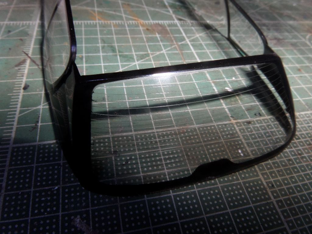

Finish making the wheels ,the rear wing and paint the rear lights on the sprue with X-27 Clear Red
also some more painting ...X-11 Chrome Silver on the rear optics and in the exhaust end
Also paint with X-18 the interior of the clear part
Try to paint this very carefully as some outside galss was with no masking tape , a little difficult step if you using airbrush ...but better finish that using brush that is for sure
It works and went ok this step of the build :-)
Shinny parts 8-)
Buffer and Peugeot brand symbol ...nice !

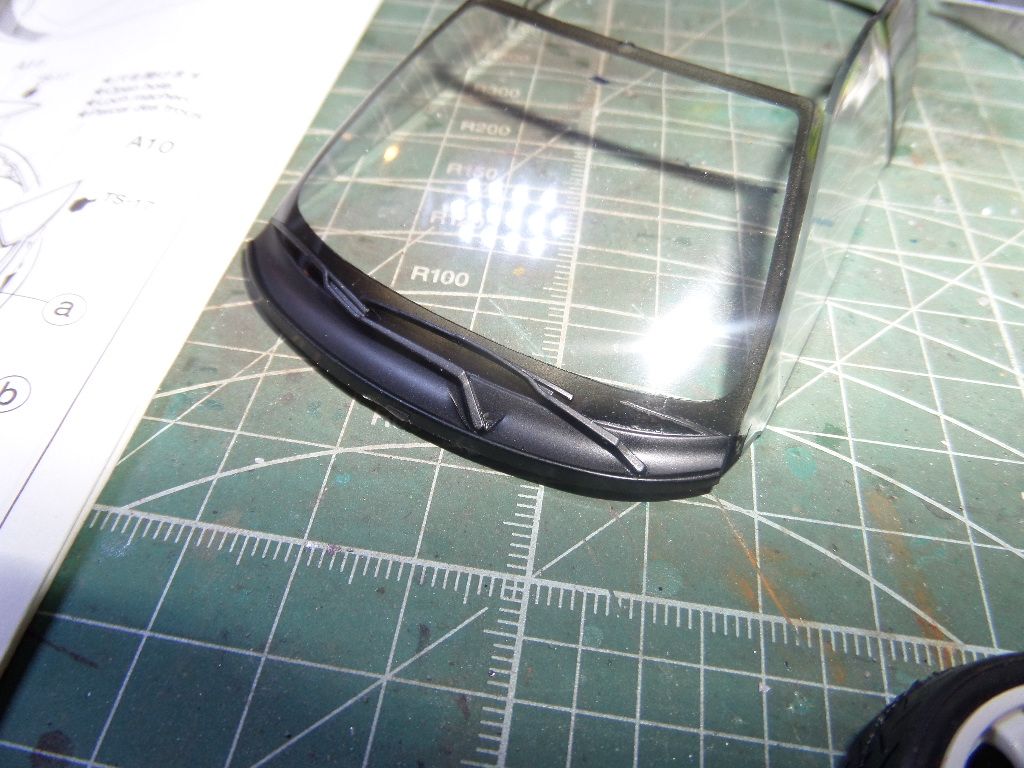

the whippers , LoL I do not the English terms of this car stuff :scratch:: placed in the front windshield !

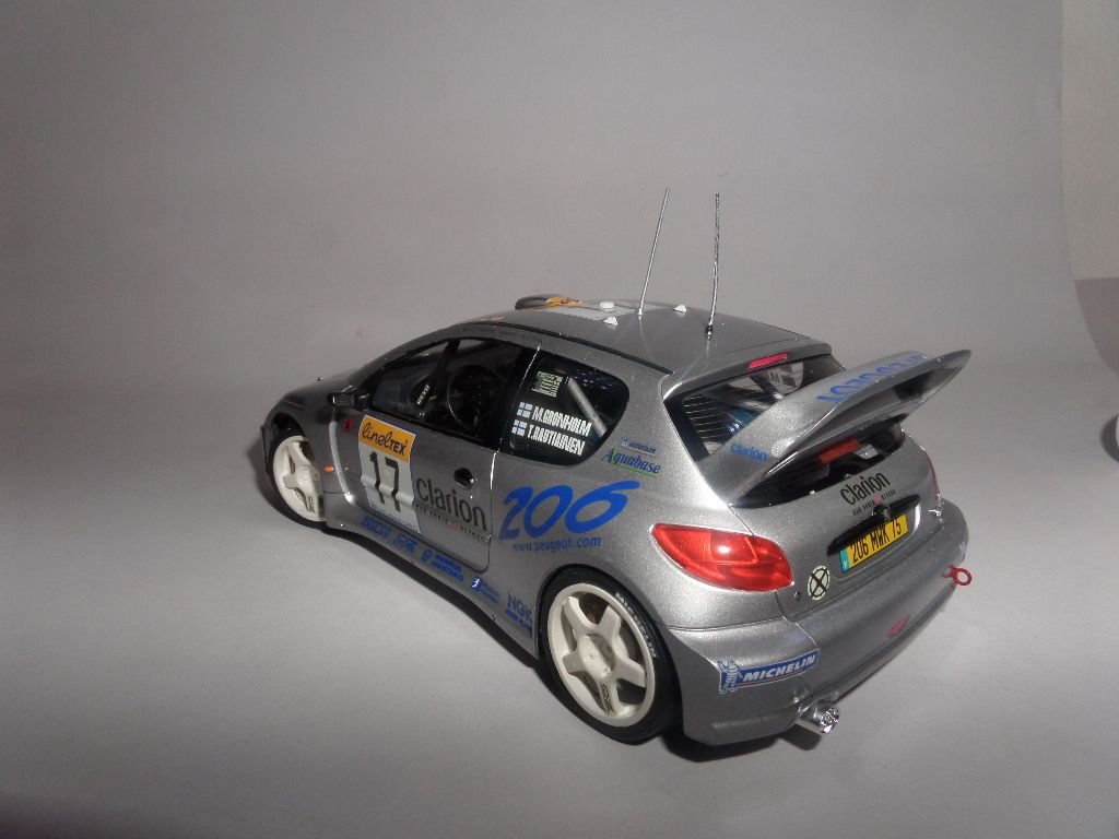

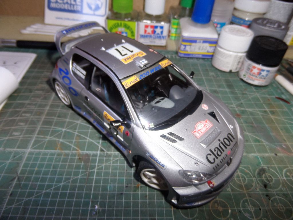

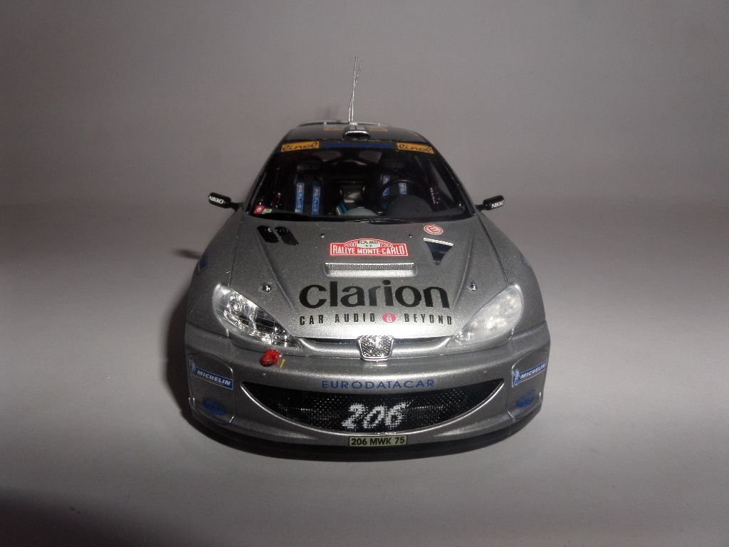

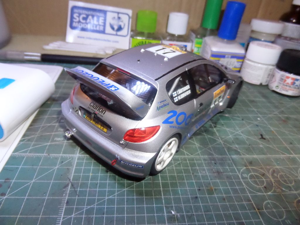

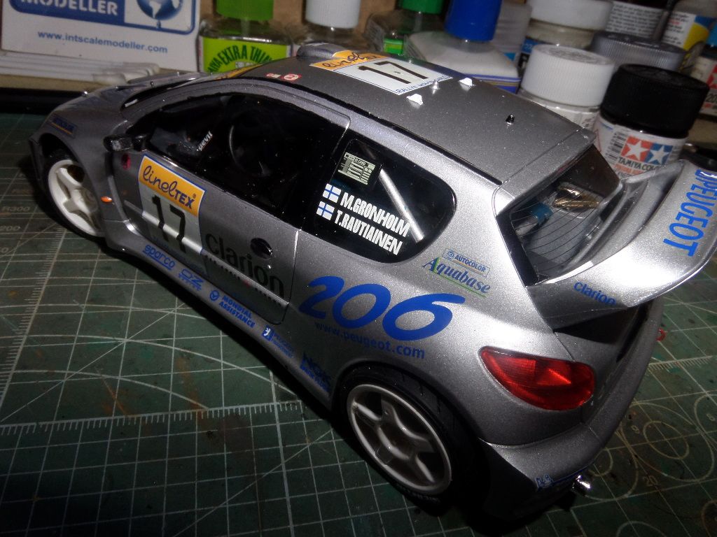

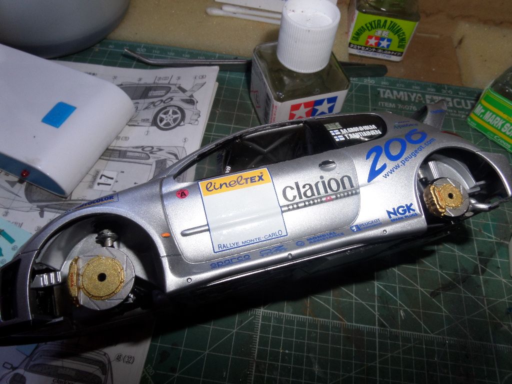

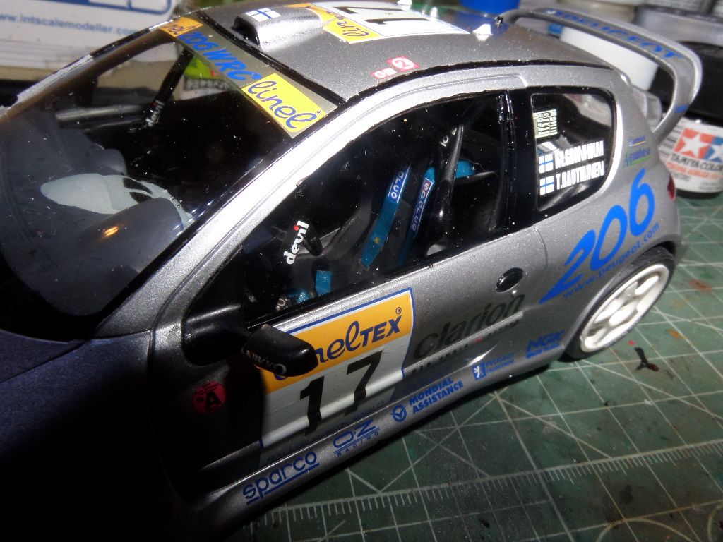

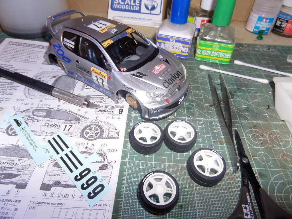

Time to do a final update on the car build , still have the mechanic set to do ... :-)
Decals and finishing the details ...
This white decals are ...well I will not tell the name , after I rip one , and after several minutes in tepid water they are thick ...very thick ...also some of the decals had a lot of glue so almost impossible to remove them unless they were in tepid water for a long time ...
A mistake ...I placed this decal in windshield , but before I should have placed one with a silver stripe ...still manage to save all this :-)

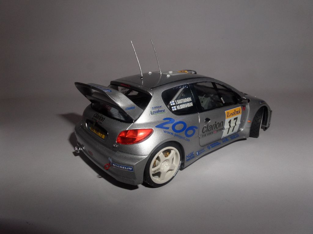

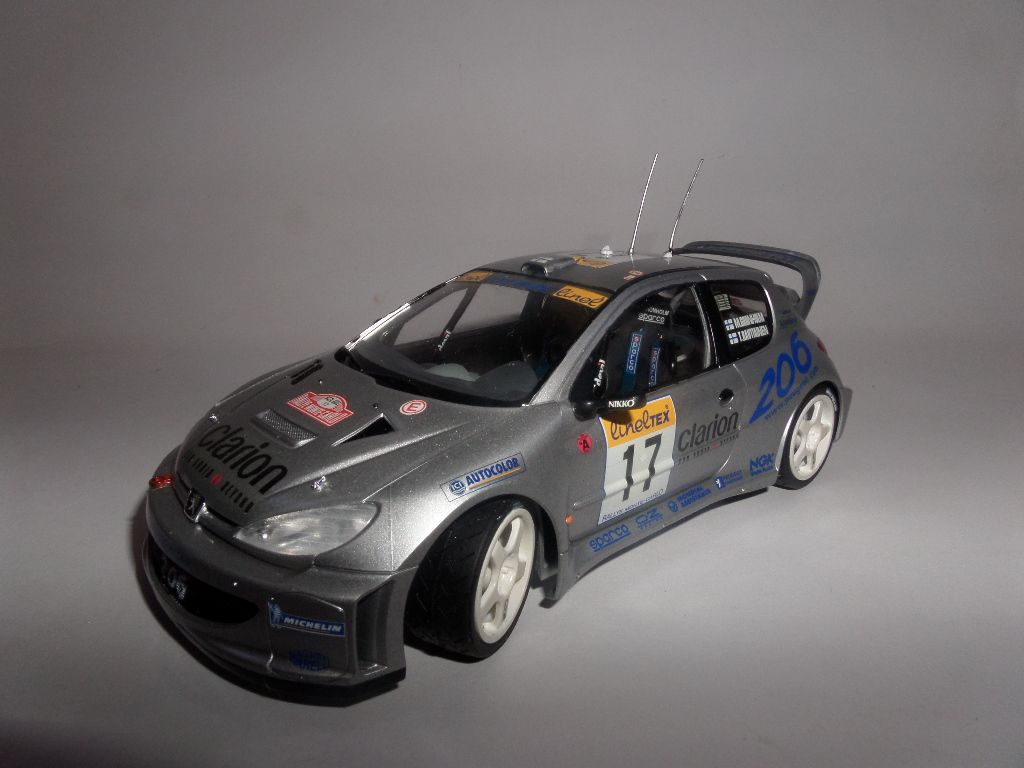

Finish the wheels and all decalling
Only now missing are some aerials and some white disc yo go betwene the numbers
With all this I manage to lost one of the back door clamps and misteriously gone one of the fron tyre 'Michelin' decals/adhesives
Again Tamiya decals are awfull ...did the best I can :-)

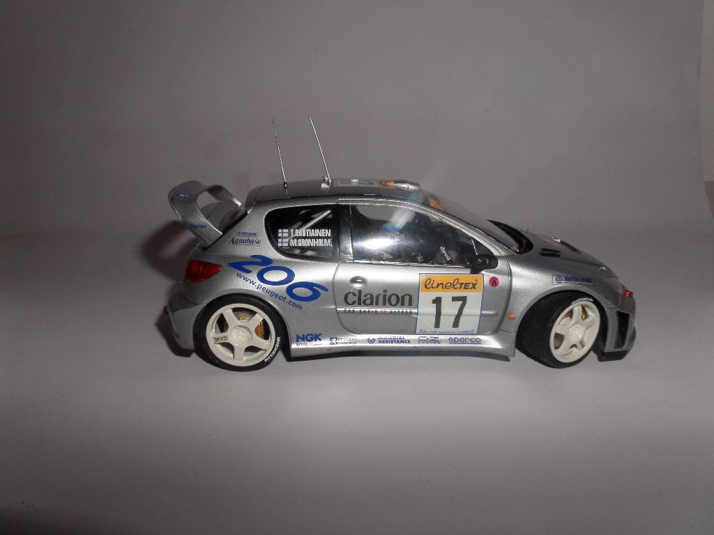

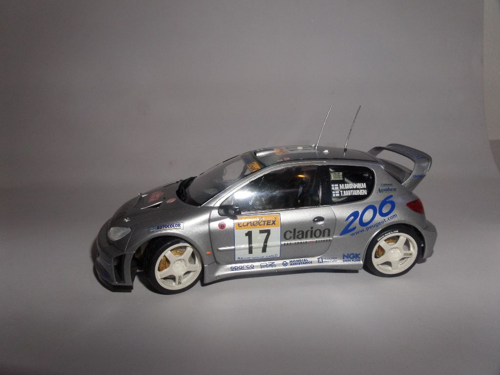

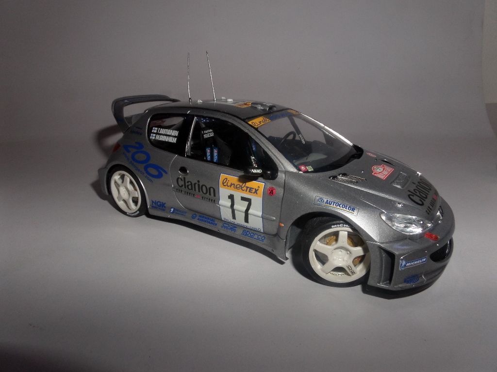

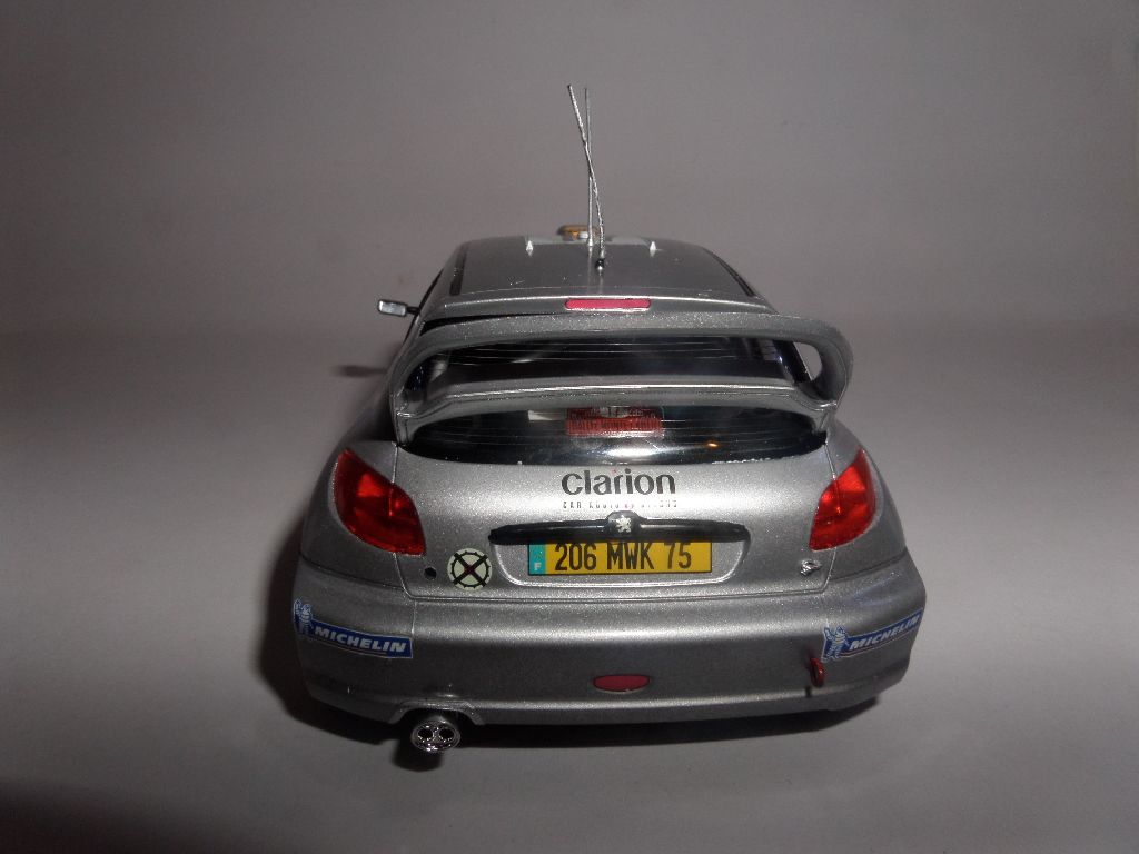

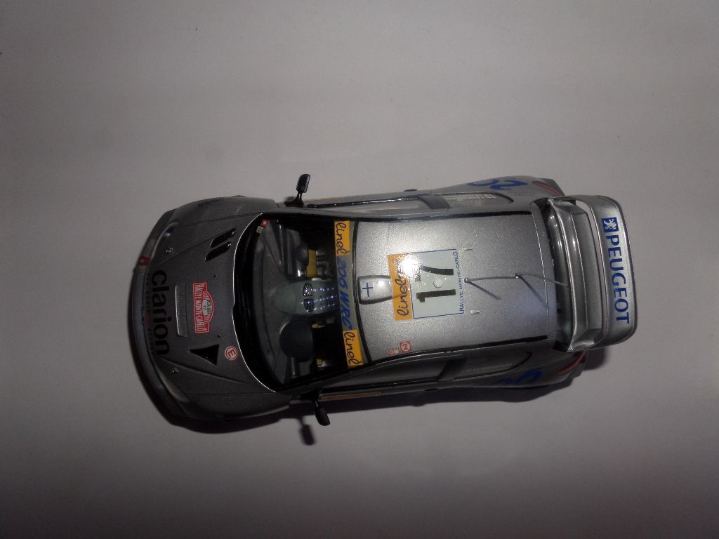

Some photos of the finished 206 WRC 2000 Rallye car :
Now to make some mechanics Rallye Team :-)
Cheers ,
António
a lot of stuff right now :-)
Homerlovesbeer
Posts: 804
Location: Brisbane, Australia
Re: Tamiya 1/24 Peugeot 206 WRC 2000
Post by Homerlovesbeer »
Great work Antonio :clap: , shame about the rubbish Tamiya decals. :bash:

Superb job, António!!!!

THank you guys , I now am doing a little stop on this build before I make the mechanics team ! ...this rallye was on winter time , and for the images that I saw a lot of cold ...so cold that this Peugeot (actually three of them ...) can't make a start on the second round after a very cold night ... the mechanics are a little summer fashion :-) , so I maybe consider this finished ...or try to make some winter jacket , at least for the pilot :-)
