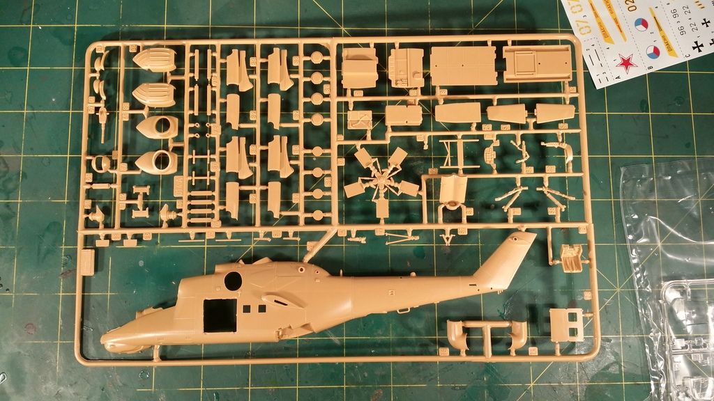

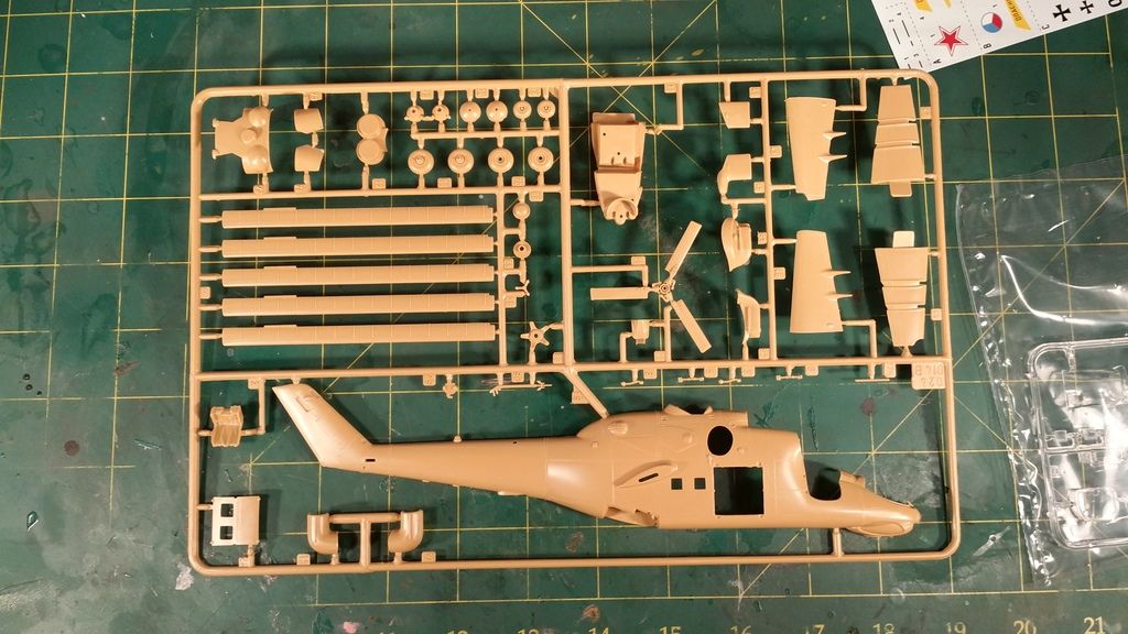

Two sprues in one bag with decals. Instructions are in Japanese but easy to understand as colour references are in English.
Sprue pictures:
Sprite A contains fuselage inner parts engines seat with seat belts modded on which is a nice touch. It also has an instrument panel with nice raised detail for the cockpit.
Sprue B contains much the same except has the main rotors.

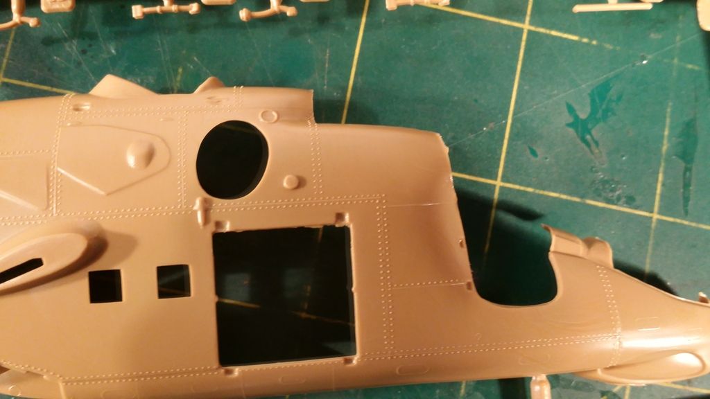

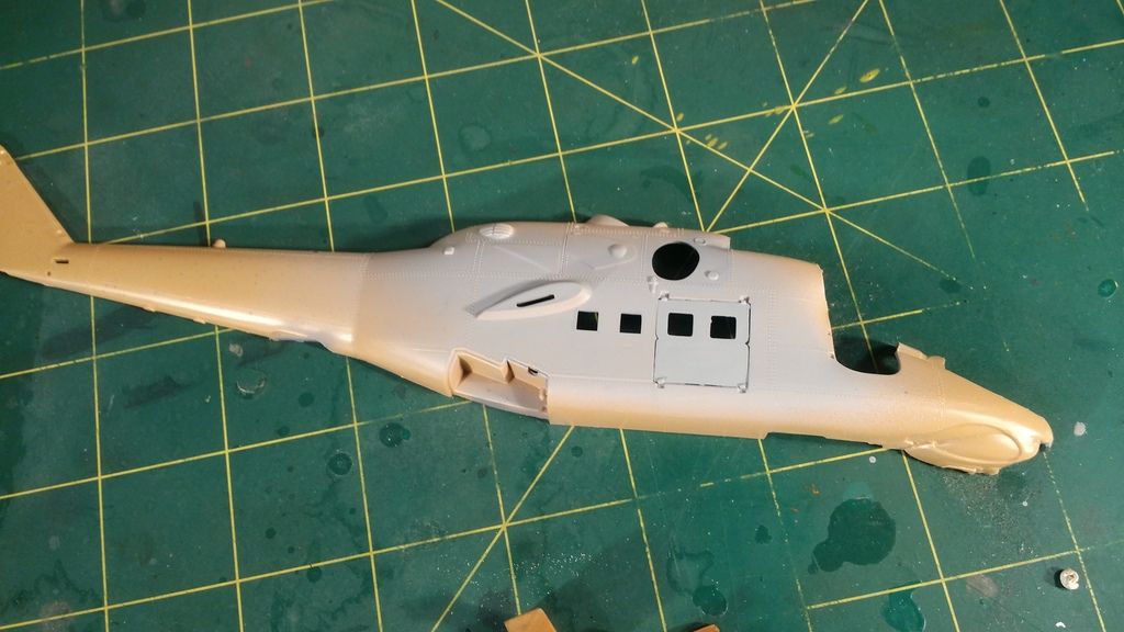

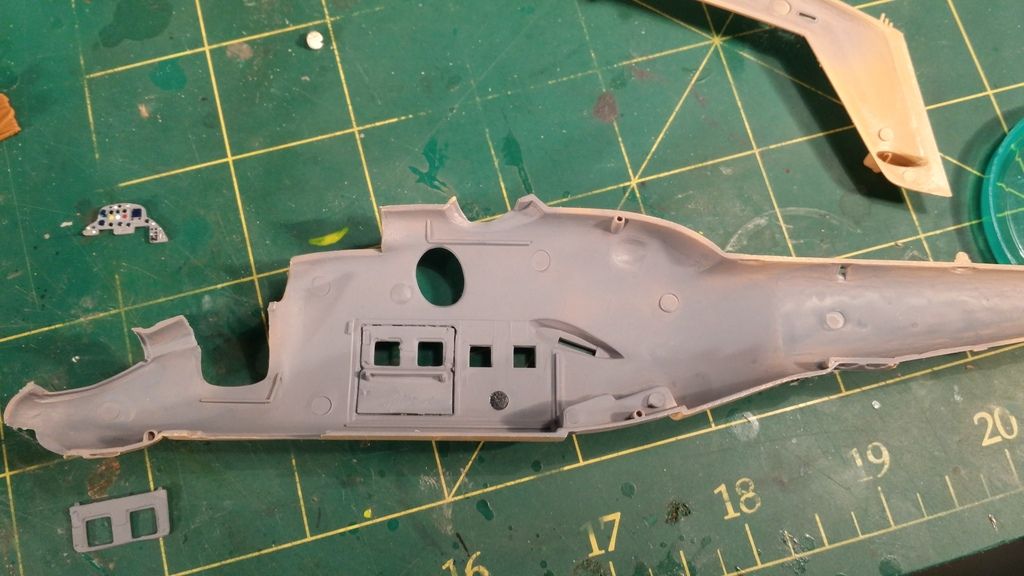

Here is a closer look at fuselage. As you can see there is raised detail instead of panel lines. I don't mind this and will see how it turns out. I think the actual chopper has rivets as well but will have to check some reference photos.

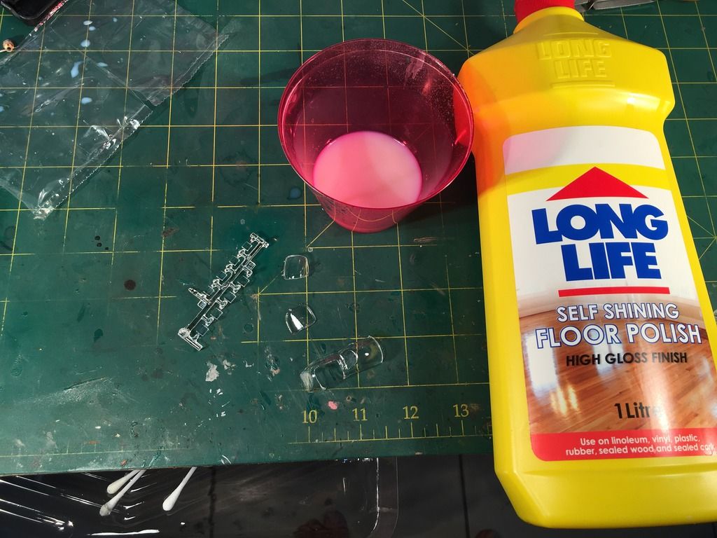

First off I dipped the clear parts in future known in Australia as Long Life Self Shining Floor Polish
These were then left to dry while work commenced on the build

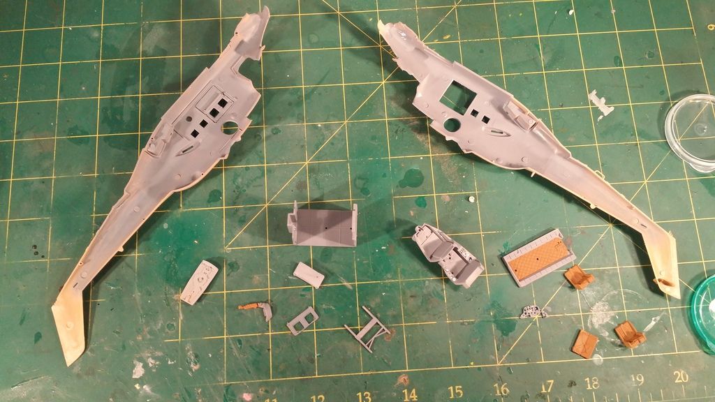

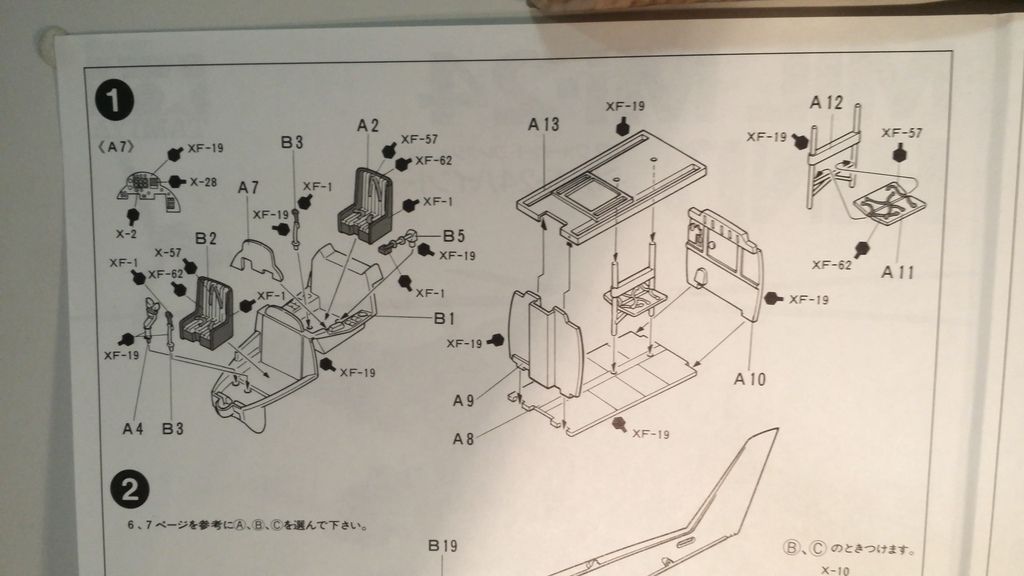

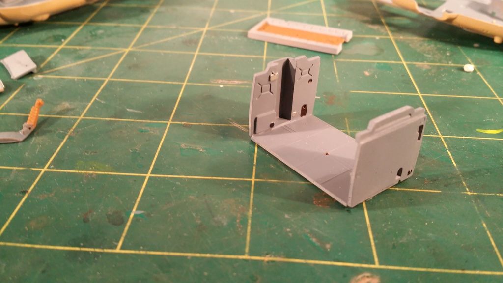

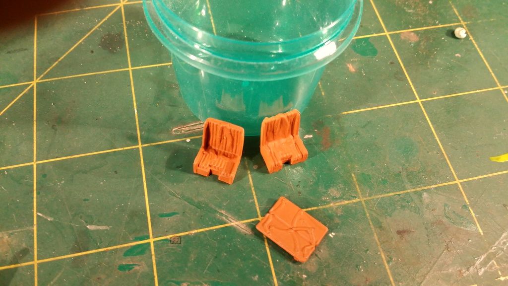

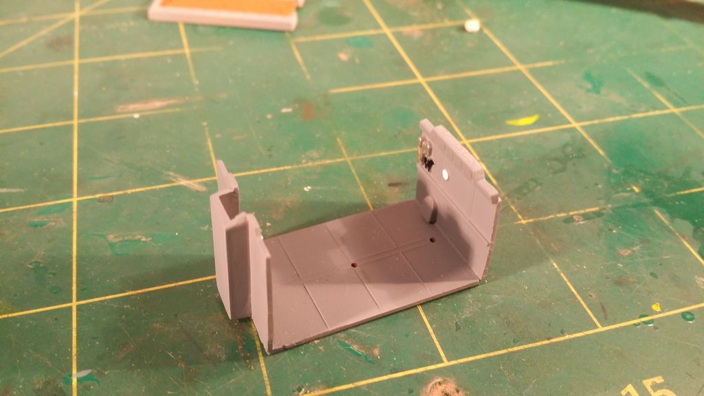

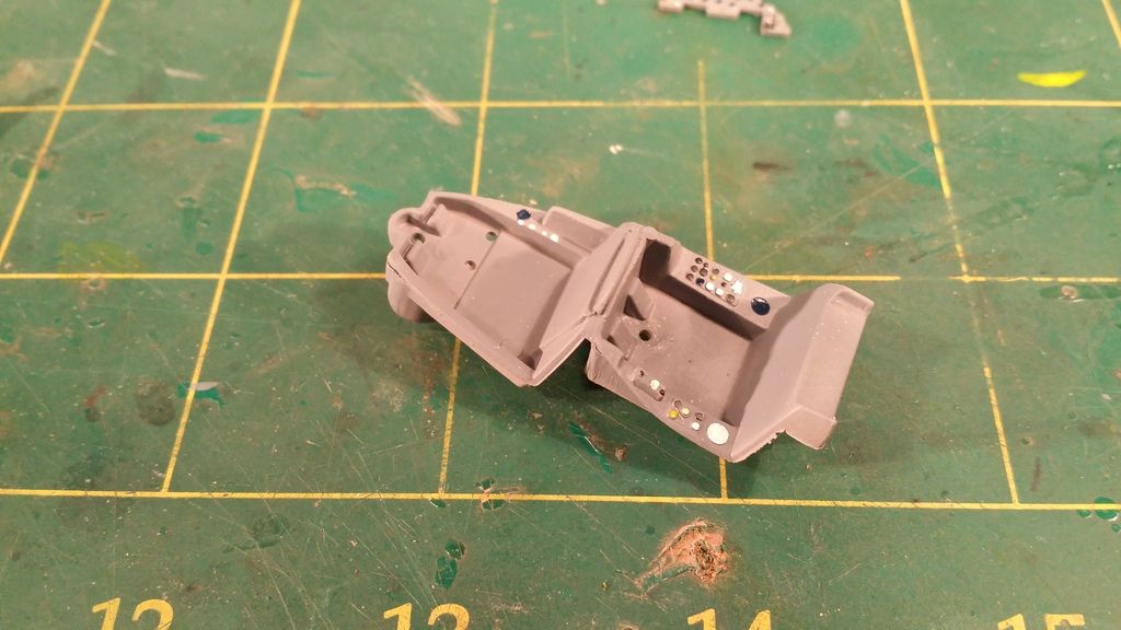

This is the interior, painted Tamiya XF 53 enamel, with details being brush painted.
This is the roof of the interior painted XF 53 and then Humbrol 62 - Matt Leather enamel. This will be given a wash to highlight all those lines.
The seats are also painted using Humrbol 62 Matt Leather enamel. Once this paint dries these will then be detailed up.
The cockpit instrument panel. I chose random colours as I saw fit. I chose to build it the way I want it to look not using reference photos. I gave it a touch of Black Gloss, White Gloss, Royal Blue to represent screens, yellow and red for important buttons and danger panels
Same thing with the colours on the panels in the cockpit.

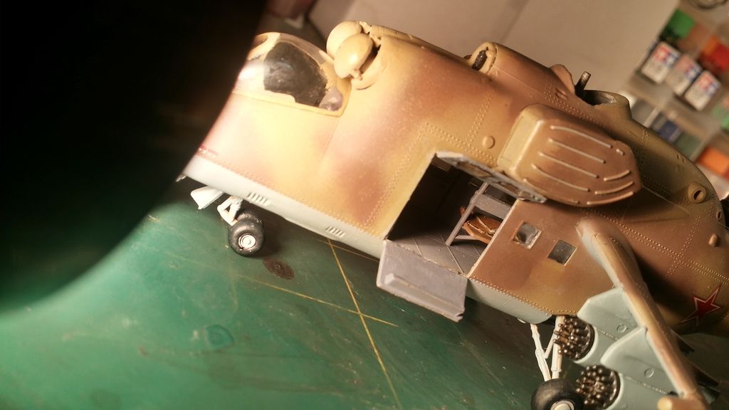

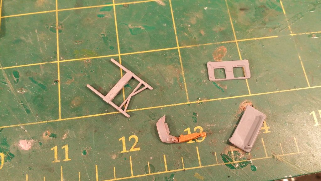

I will build one of the doors open and one closed to show off a bit of the interior.
The side with the closed door.
Primed a bit on the outside so I can paint it before I out in the clear parts.
This is the side with the door open part
Once again primed on the outside so I can paint over the windows before I put the clear parts in '

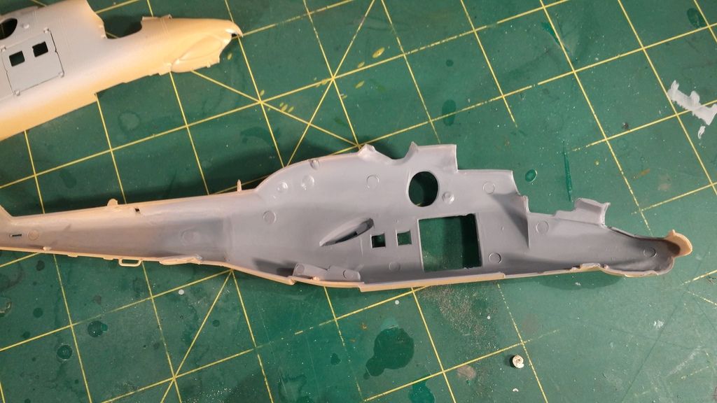

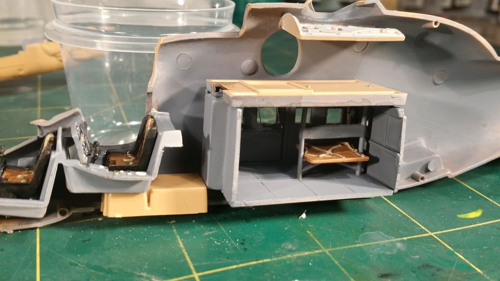

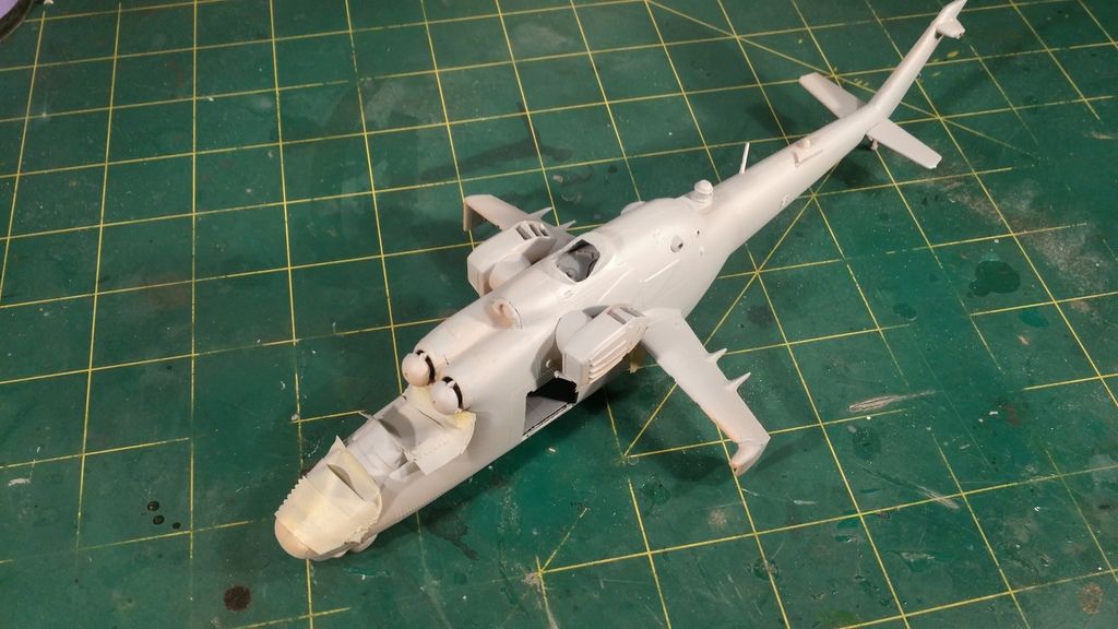

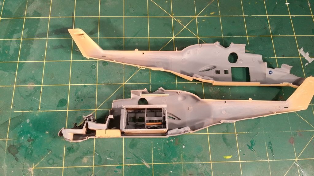

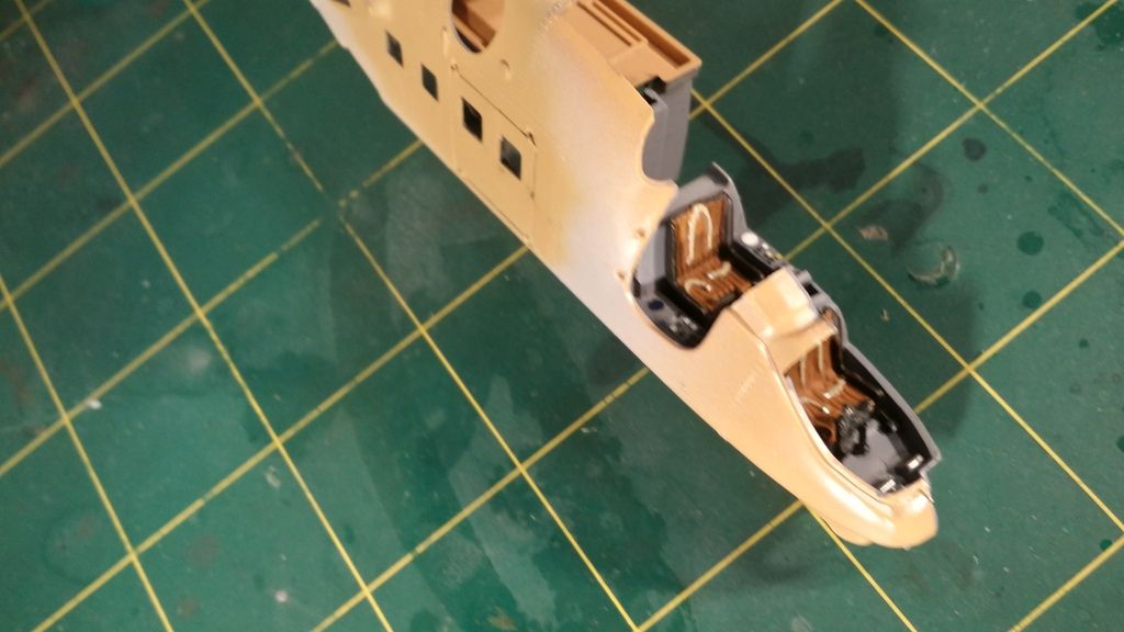

The cockpit has been assembled. The interior is also done. I have put this into the fuselage and also put the clear parts in. I painted the fuselage where the windows were before putting in the clear parts.
The cockpit was given a wash with vallejo light grey.
The fuselage halves are now being joined.
Will do some more work soon. Sanding the fuselage will be next ans filling in any gaps.

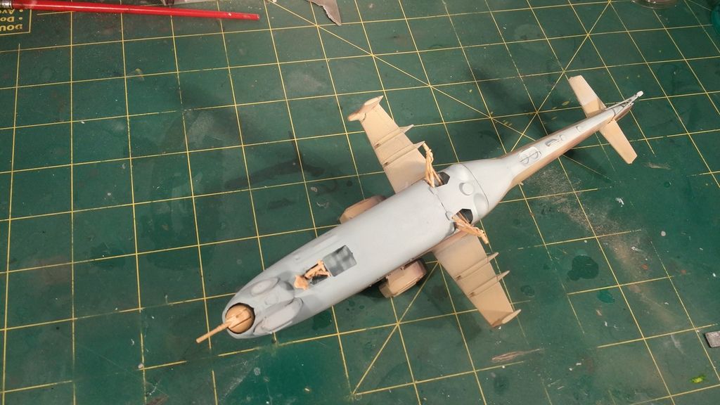

First off I filled all the gaps using Tamiya Basic Putty. This was pasted on using a toothpick.
This was then primed using Tamiya Primer Grey - from the spray can.
After priming there were still some gaps left on the roof and near the bottom
These were then filled using tamiya Surface Primer white - the one that comes in a bottle by being painted over by using a paint brush.

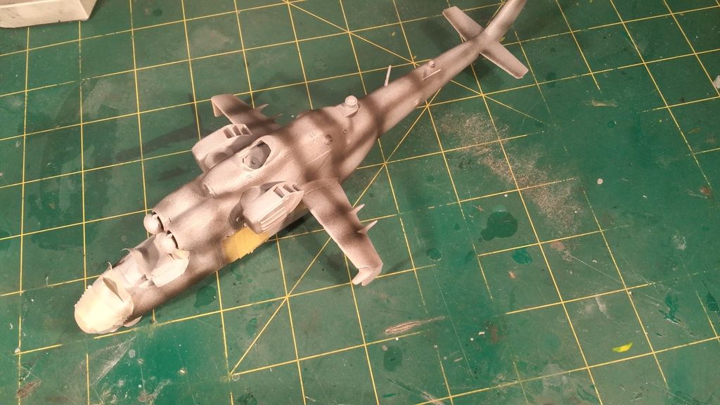

My attempt at pre-shading (didnt really work) I think my Preshade coat was too thin. I also paint with enamels so that might also be a reason

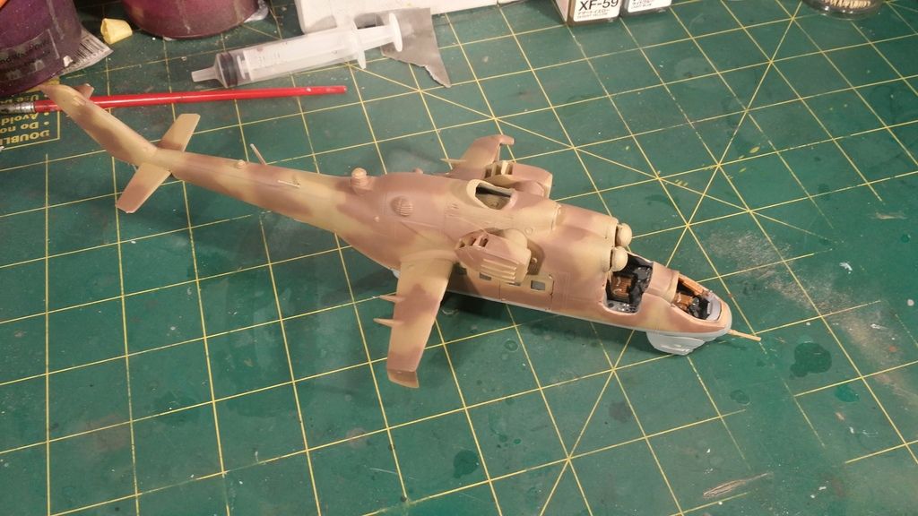

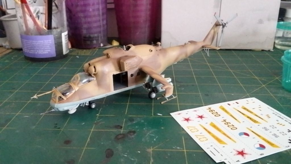

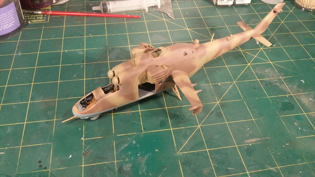

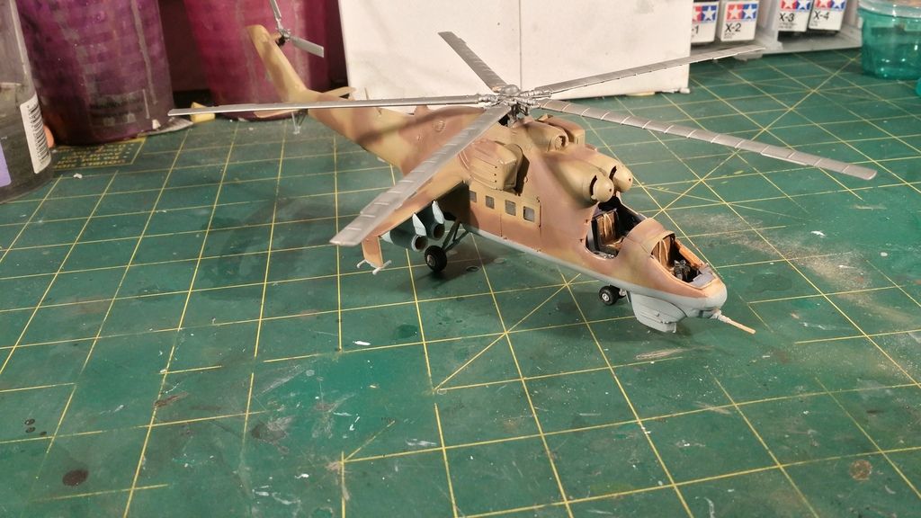

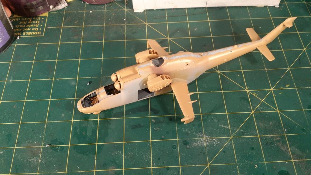

So didnt take much pictures during the painting. Did it all within 2 days. I painted the base Tamiya XF 59 - Dessert Yellow. Then free handed the camo pattern with an airbrush using Tamiya XF 59 Flat Earth. The bottom was then painted using Tamiya XF - 23 Light blue. These were all enamels thinned with enamel thinner with a paint to thinner ratio of 2:1.
The camo pattern was free handed because I have seen photos in which the camo has a soft edge, so I didnt use masking to paint it. Here it is

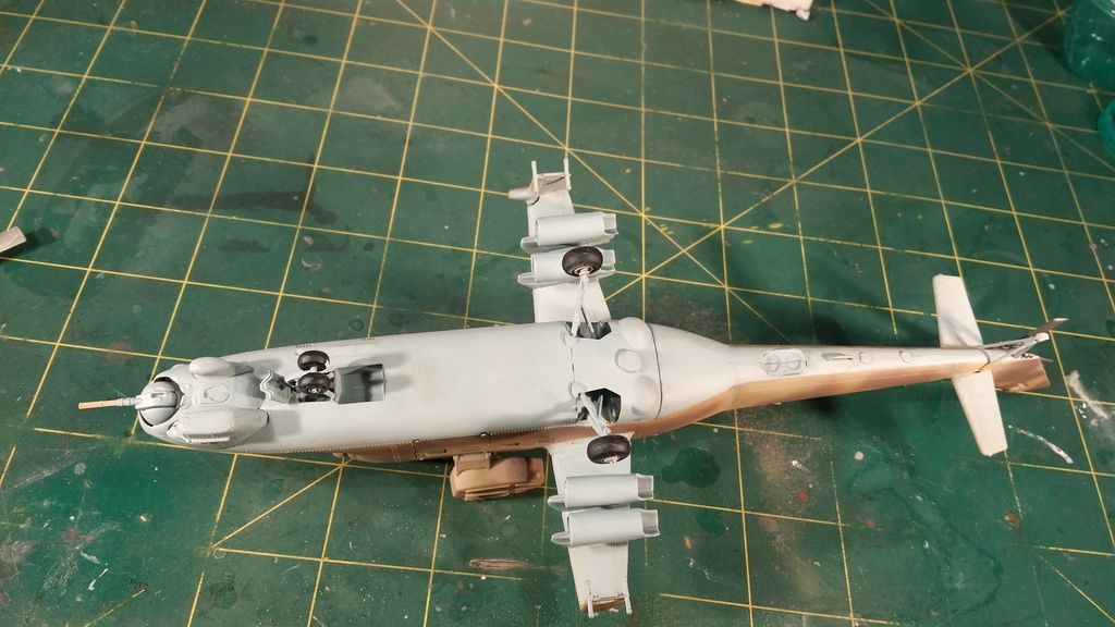

Landing Gear then being attached

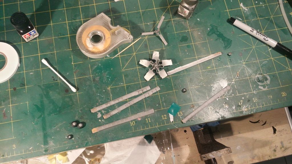

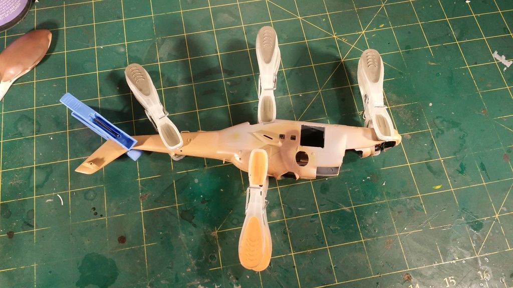

The rotor blades were then built and painted using Tamiya XF 56 Metallic Grey. These will be detail painted further but for now they will be left in the metallic base color. The tires and landing gear was also painted.
These were then all attached. The weapons are partially complete as well with the weapon pylons and the mini guns being done up. Only the front portion of all the guns and the small missiles on the sides are left here.

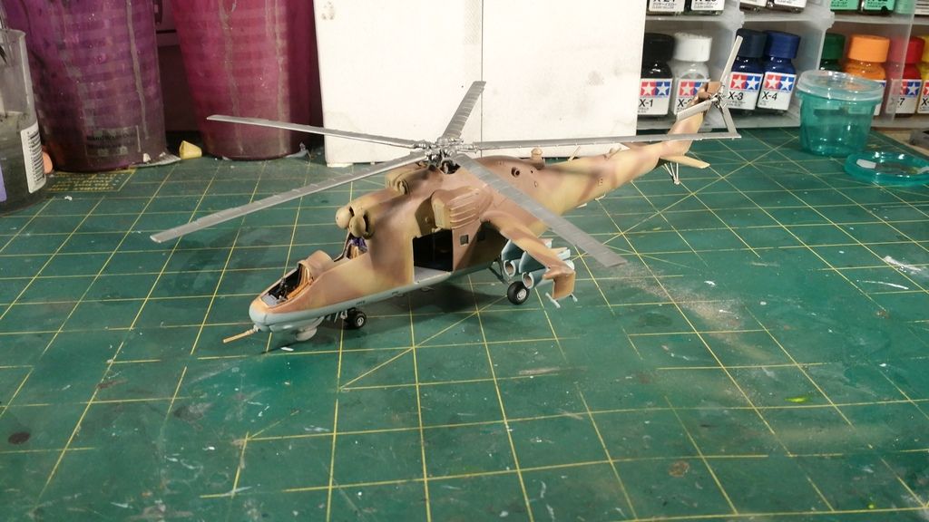

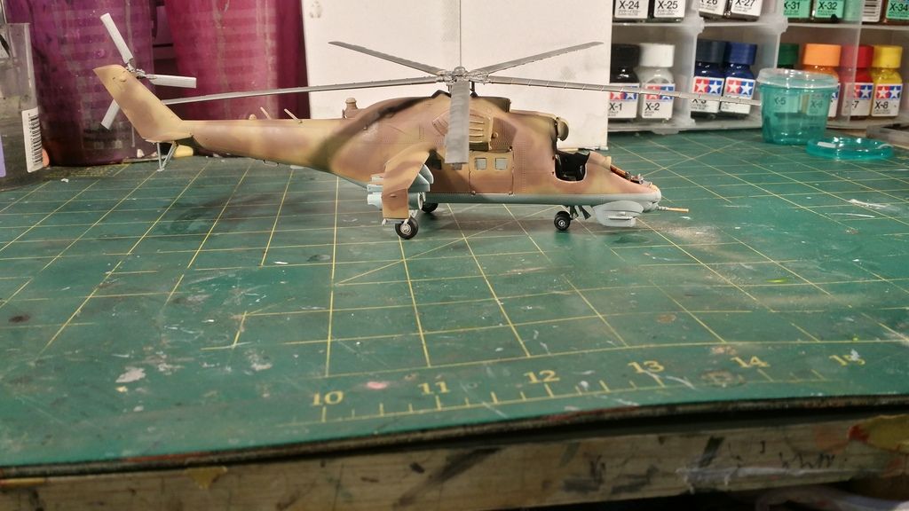

The rotors attached and here it is for now:
Lots of work left.
- The rotor blades need to be painted properly.
- The Weapons all need to be done up.
- Detail painting of small parts still to be done.
- The Canopy needs to be masked and painted!!!! I will probably spend all weekend on this one task.
- The Side door needs to be attached
- Decals and weathering (if I feel I want to weather it).
- Matte / Satin Coat

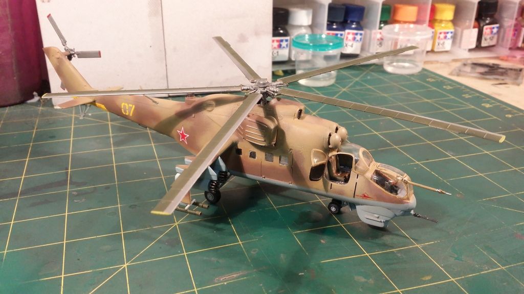

Build is almost complete.
I started work on the canopy in the early hours of the day. This is one very very difficult canopy to paint simply because of the curved portions which exist inside the other portions. Next time I do a Hind I will do the curved portions first. I tried to keep the canopy as clear as I could, but it did get dirty a bit.
Here are the updates.
After countless mistakes, I just free handed the curved portion
Gun front parts painted using Tamiya X 10 Gun Metal

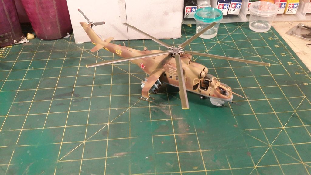

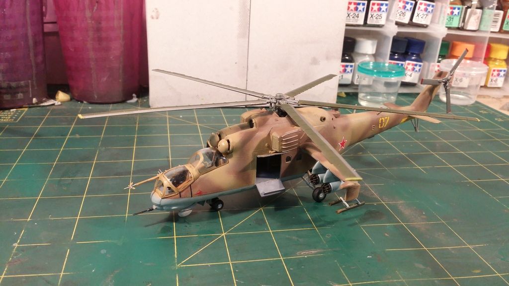

I repainted the body with more XF 59 Desert Yellow as I felt the camo pattern was too heavy with XF 59 - FLat Earth.
The cockpit canopy was attached. Now I must say their is a gun/antenna type part that actually has to be glued on to the canopy! I had to be super careful not to get any glue on the canopy. But some did spill over. This was then polished to get a clear as possible look.

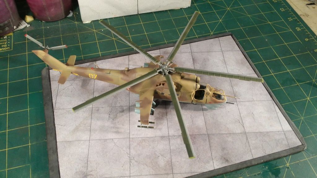

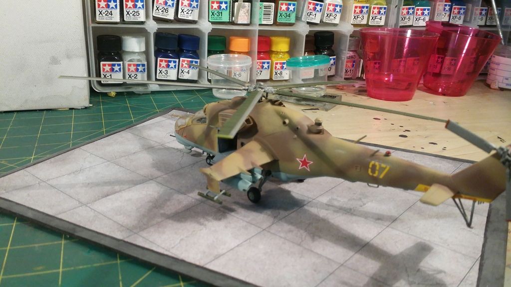

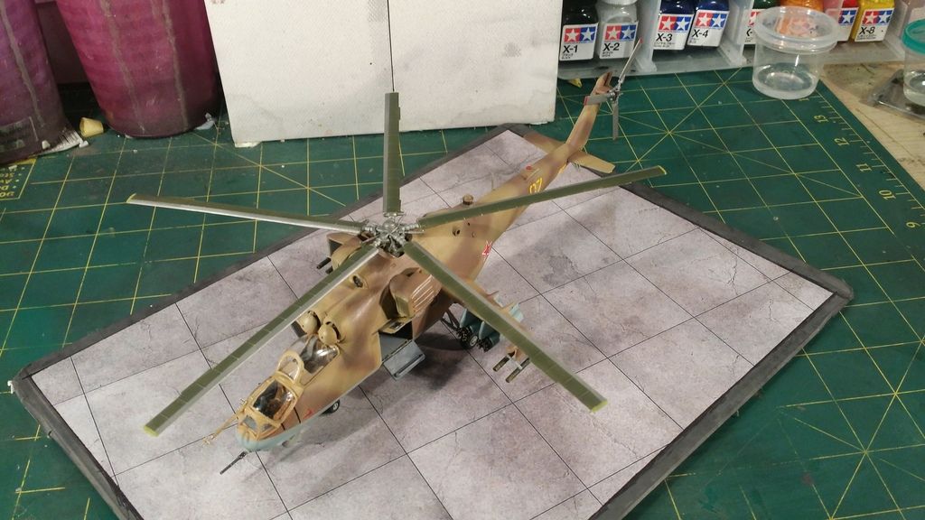

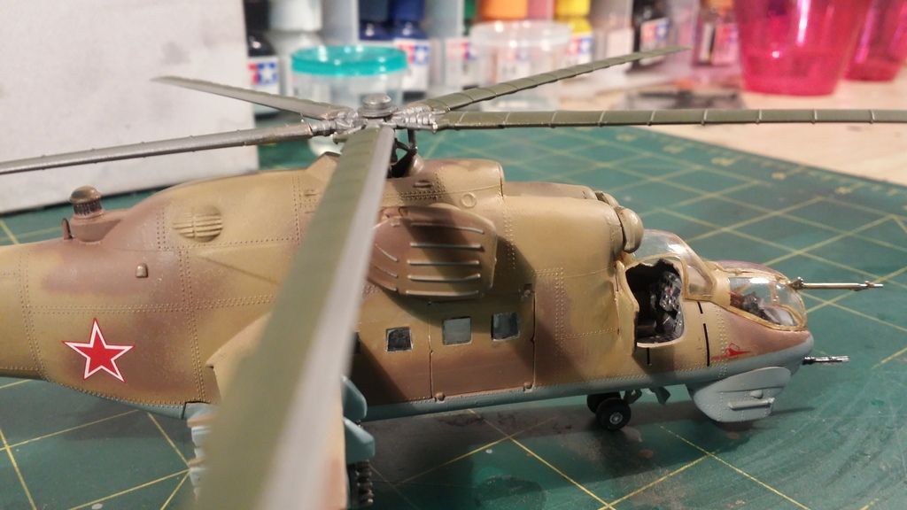

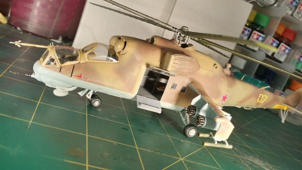

Decals were applied. The large blades were painted with XF 62 Olive Drab and Tamiya yellow green tips and with a metallic grey strip down the length of the blade. The tail blade was painted with a red tip on each of the blades. The side doors were finally applied as well.

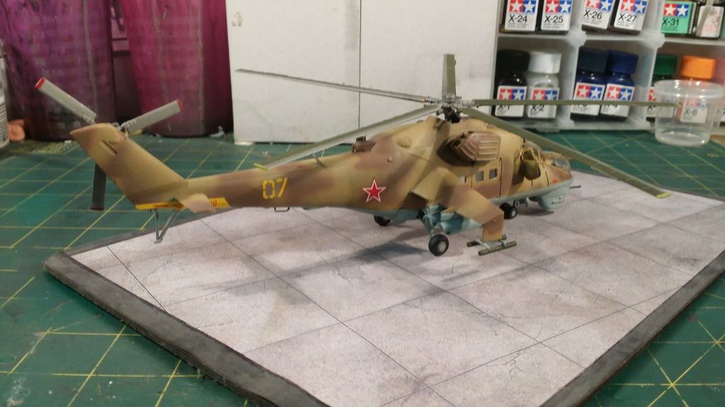

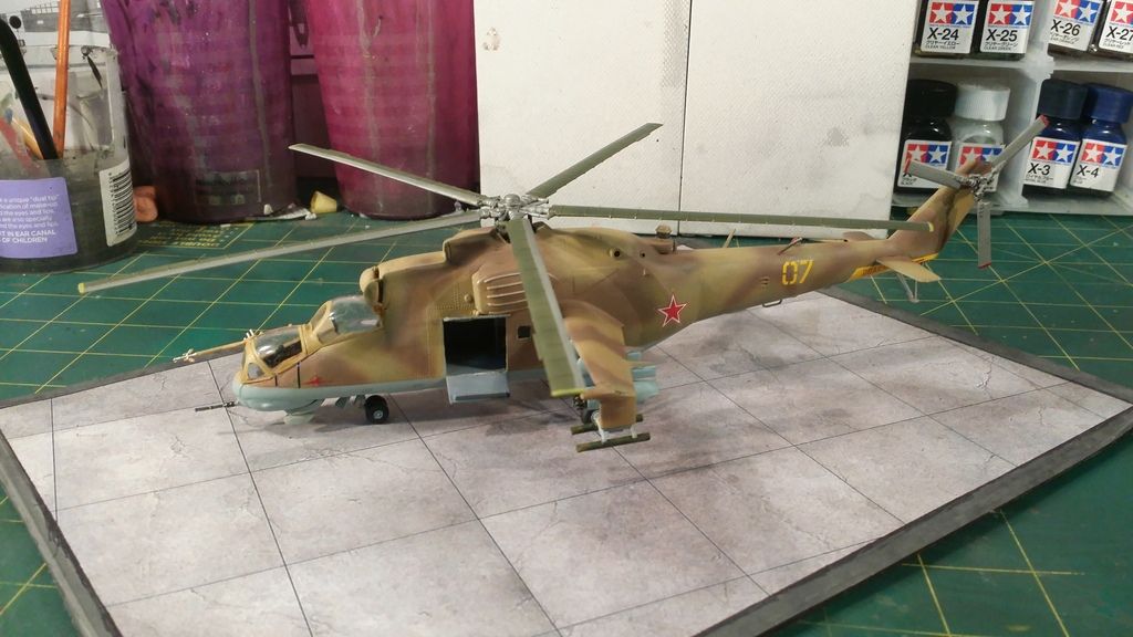

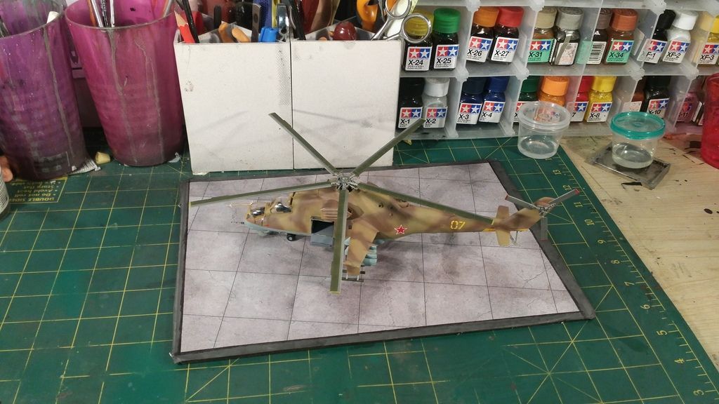

Here it is in almost complete.

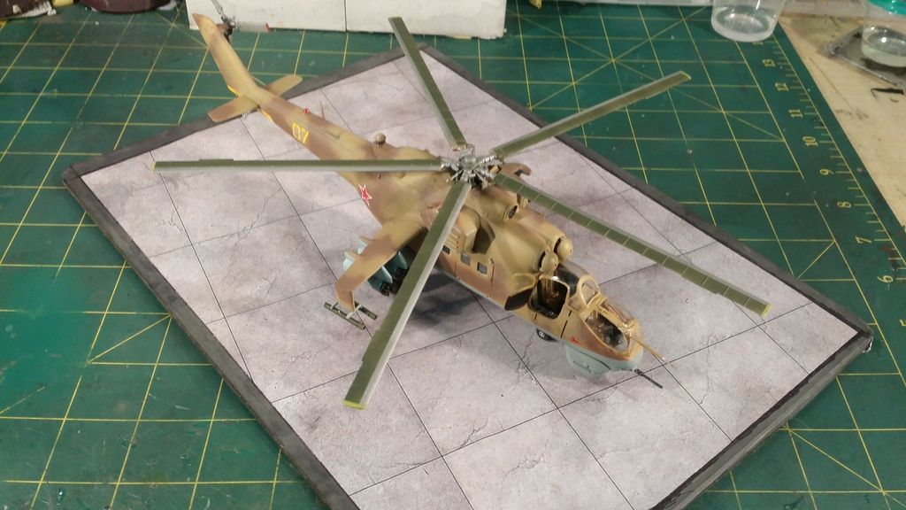

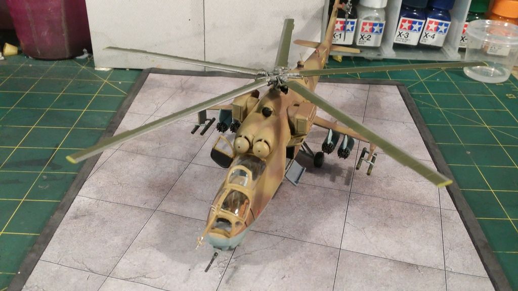

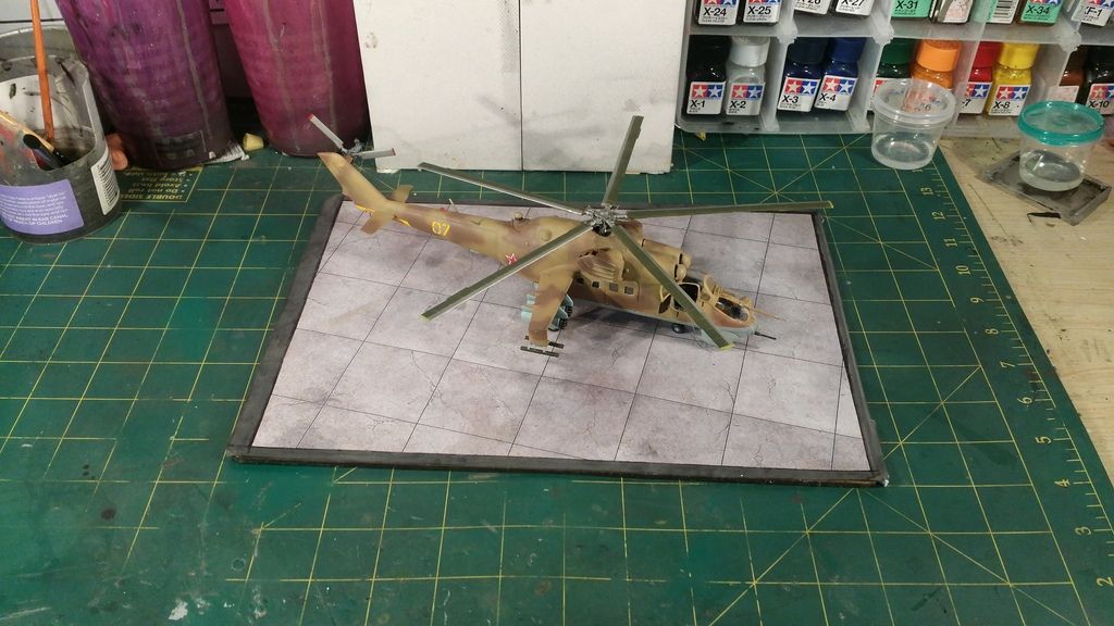

Here it is on a small diorama base I built last year.
I must say this is one very difficult kit to build, the fit is not the best, there are small parts that go on in bad locations.
Now will wait a bit, a few small parts are left to be attached on the tail. These have to be attached over the decals on the tail. The decals are very glossy so, once the decals are fully dry and attached I will clear coat this with a satin coat, and apply the final parts. I will wait for the paint to dry before applying a clear coat. I might then weather it. Might!
