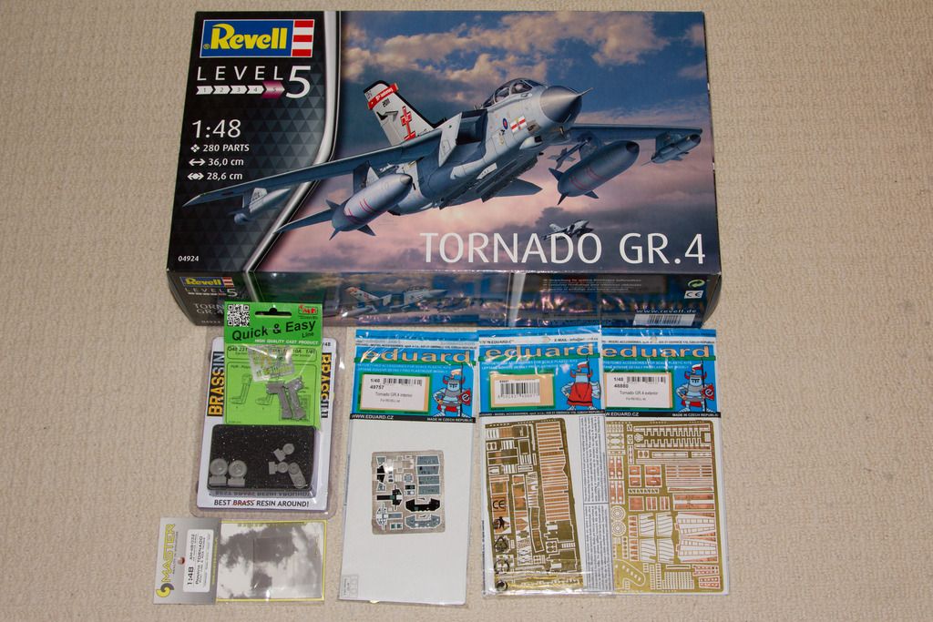

This will be my next build. Currently finishing Tamyia 1/48 Lancaster with lots of etch. Promised myself not to use so much etch on the next build.
Reference material is Haynes RAF Tornado, Airfix Mag with kit build by James Vaitkevicius, Model Airplane mag kit build bt Greg Phillips. Also various other clips of Tornado from magazines. Tornado SIG.
Famous last words.
As you can see I succumbed to just a bit of etch and other accessories.

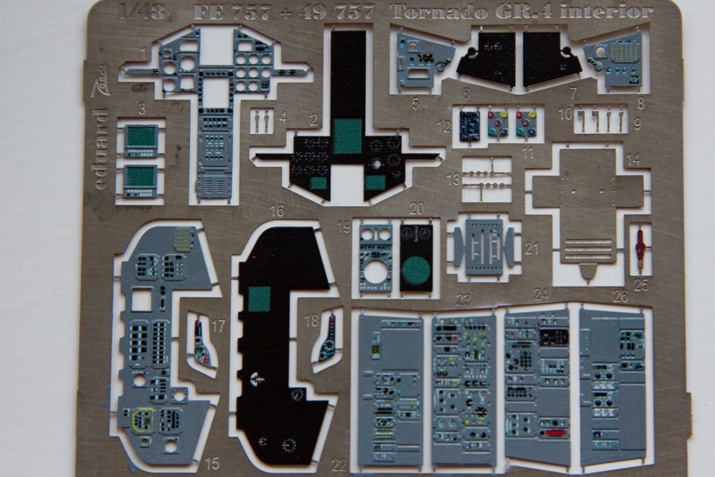

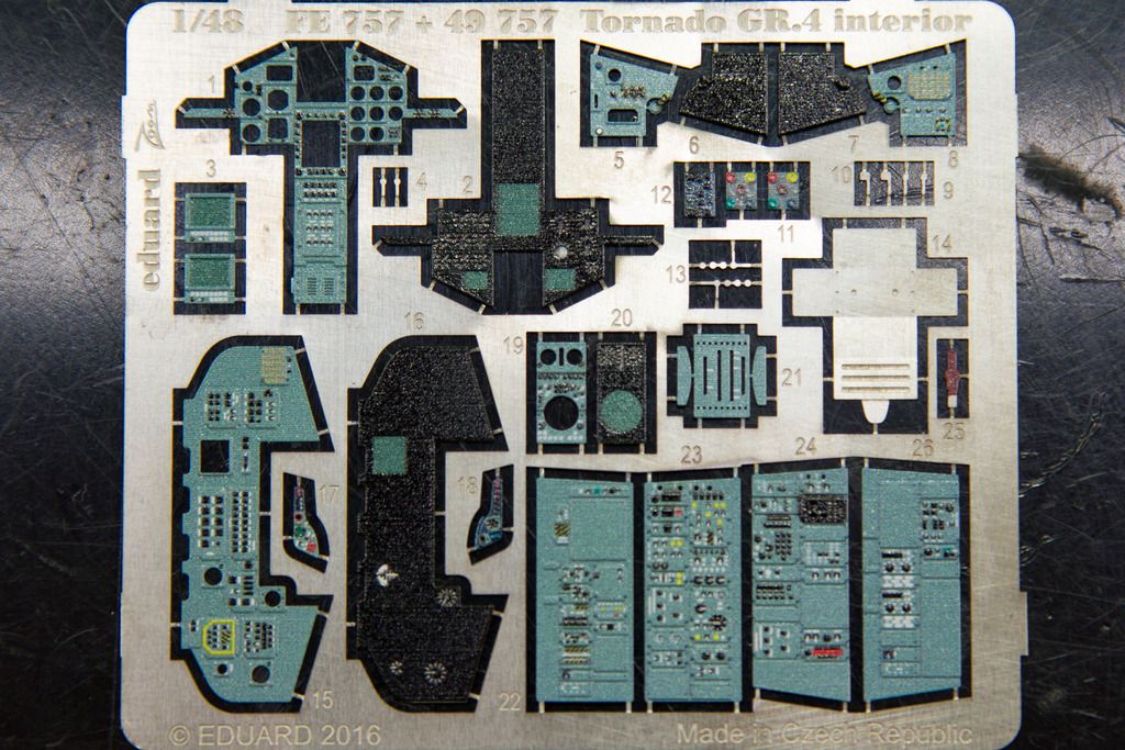

First the Eduard interior set. I kind of regretted this as it is completely the wrong colour. I bit the bullet and decided to paint it, all be it fiddly and having to wear a magnifying glass set for 2 hours.
Eduards offering with the incorrect colour.

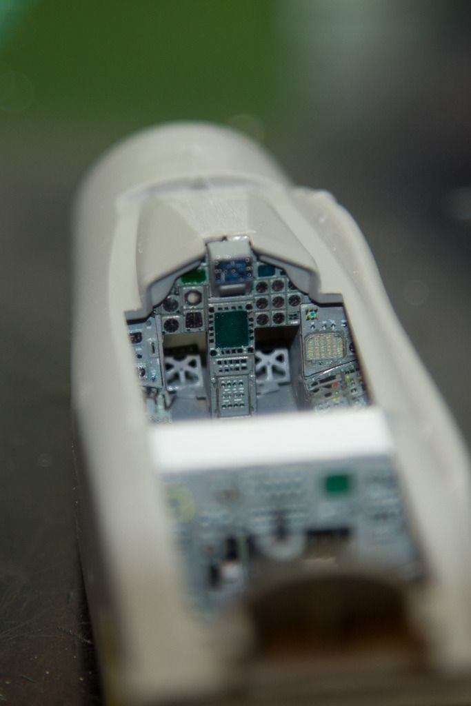

After 2 hours work this is my offering. I used Mr Hobby Aqueous H337. I am quite happy with it know.
I may have to do something with the glass monitors at a later stage.

As for Eduards' colour matches, when it comes to RAF/RN subjects they do seem to be somewhat off!
Can't say what the colours are like for other nations though...

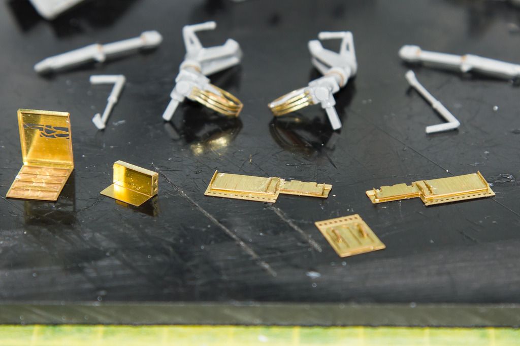

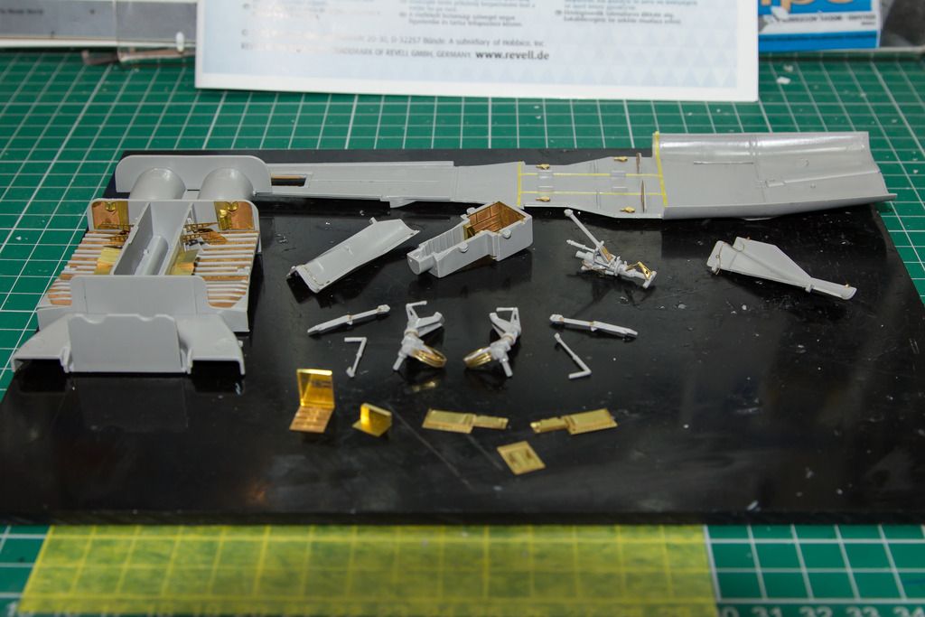

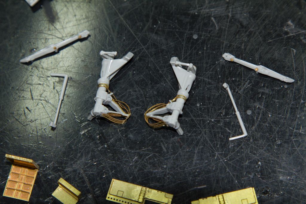

Latest update. Well have started with the undercarriage etch. Not too much of a problem. The hassle I had was with the part numbering by Revell. Parts were on different sprues to the ones named on the instruction sheet. I was going to put the correct ones on here but forgot to write some down as I found them. The sprues overall have quite a bit of flash in places and a couple of spots where the plastic has not quite flowed into the mould. Nothing that cannot be fixed though. The following shows my progress so far.
Since then I have started on the fin and underwing stores. I will post those photos later.

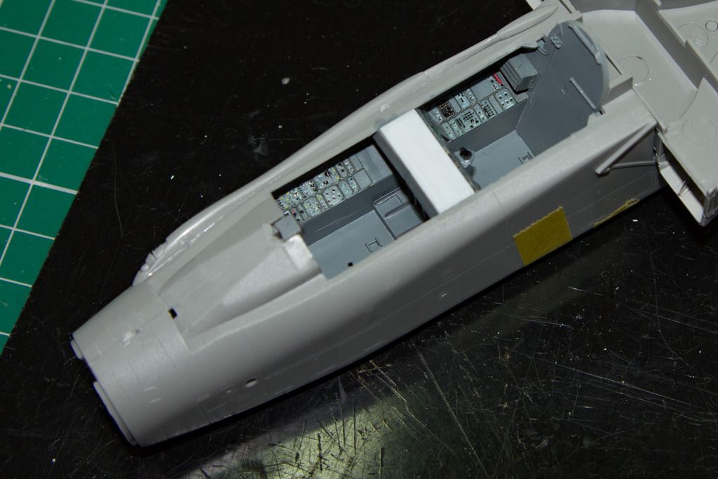

Front end closed and cockpit fits nicely. More photo etch to go in here. I have inserted a piece of plastic card between the front and rear cockpits as the join was awful. Did this with 0.4mm card trimmed at the edges so it doesn't appear so thick.

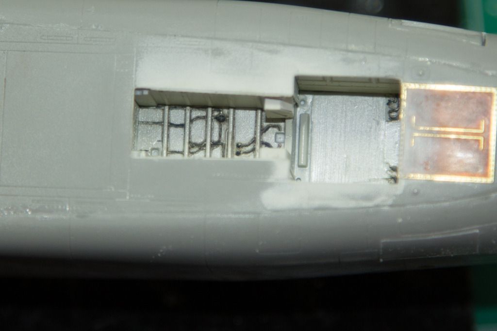

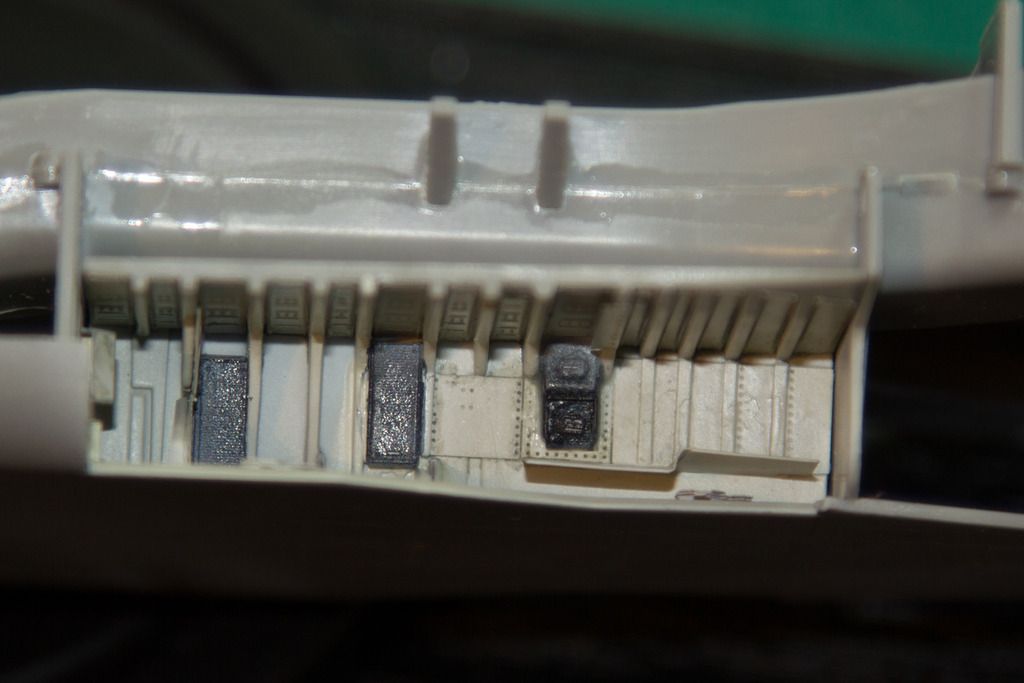

Nose wheel bay. Still a bit more work to do. More etch to go in.

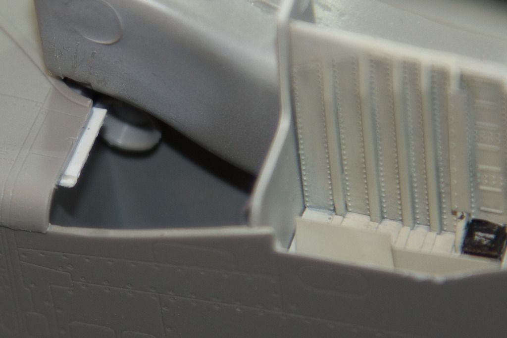

I fitted a small piece of plastic card where the fuselage side comes in as there was no support for it at this point. This helped a lot when fixing the sides in. All in all not bad fits but I need to do more dry fitting before committing to glue.

There is loads of PE but liking good.

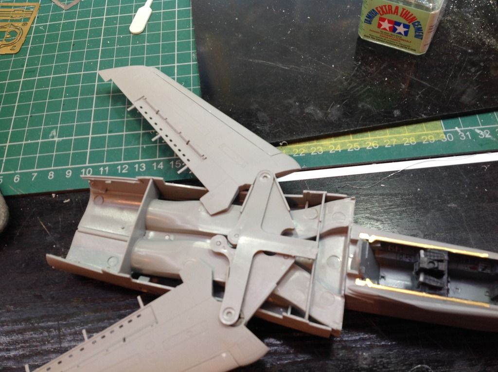

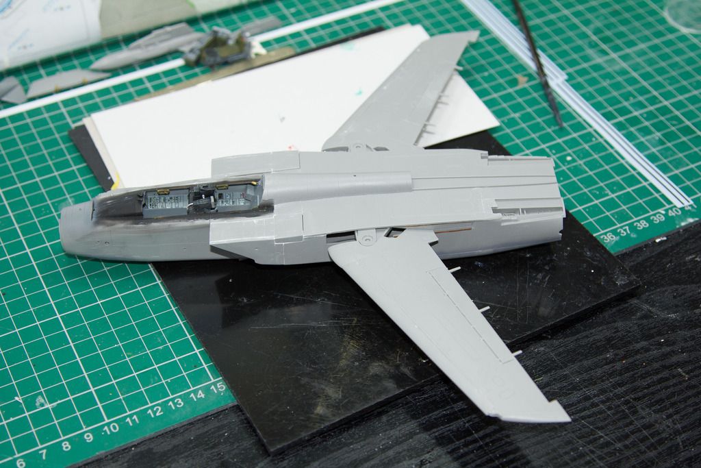

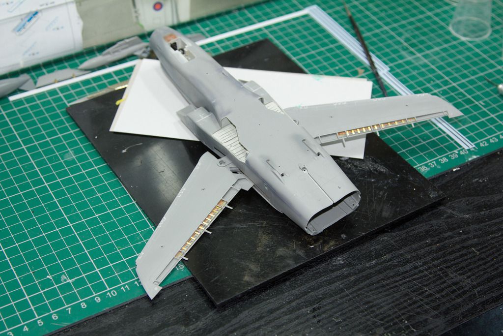

I am currently working on the wings. From the photo you will see them in position but only dry fitted. When you come to cutting the various parts off the sprues take great care as it would be easy to cut off part othe flap mechanism off as the sprue connection is so thick it is hard to determine where to cut. The moulds must be very old now and getting to the end of life as there is quite a lot of flash on some parts and as said previously the connection to the sprues is very thick in some parts. I have some more photos of various parts I have put together and will upload shortly.

Sorry guys for the late update. Other things going on.
Have proceeded a bit further than i expected before posting an update.
Have taken a while to get this far as the fit is not perfect and it took a lot of patience plus debunking and gluing together again.
A few wires added to the between the front and rear cockpit. Not 100% correct but fills a bit of a void in that area.
Tad more etch in the wings for the flaps to be posed down,
Have put kitchen foil on the canopy mirrors and painted the surrounds. Quite happy with the result. Microfoil adhesive used on the foil and a bit of patience rubbed down with a flat end toothpick.

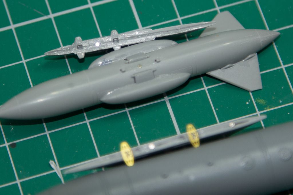

The following 2 shots of some underwing stores. I tried the paint on the fuel tank to see what it was like. Maybe a bit dark so will have to see about toning it down slightly.
I have re-scribed these fuel tanks as they had raised lines. On looking at some photos on line they are not raised.
You can just make out the small magnets I have put on the fuel tank and pylon. 2 x 1mm x 1mm magnets superglued in on the pylon and fuel tank. 1 x 1mm x 1mm magnet on the Boz pod. I saw this technique I believe on this site but maybenot. The magnets are from First4Magnets. Can be bought elsewhere on eBay.
So if the stores come off no more replying just magnetised back on job done.
Its coming along nicely now but have to sort out the inner of the intakes as I am not happy with those at the moment.
All for now. Catch you all later.
Thanks for the previous comments. Much appreciated.

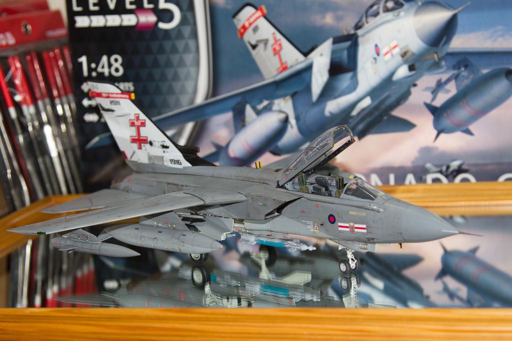

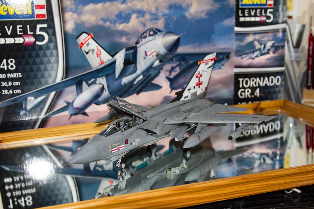

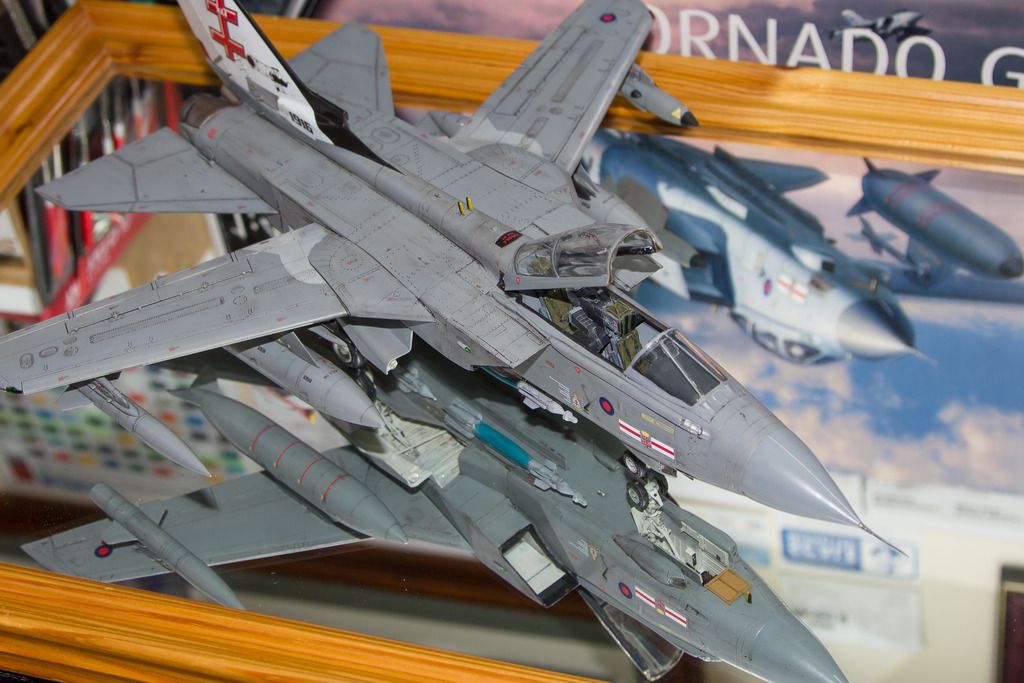

Well finished at last. As I have said before it is not my best work but will have to do. Will build another one soon as hopefully I know the pitfalls in the kit and the mistakes I personally made.
Well hope you like.
Re: 41 Squadron GR 4 Tornado
Looks damn fine to me.

Great one!!!

I have this kit only a different boxing with different markings. Have not done it yet. You did a great job!

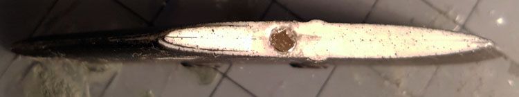

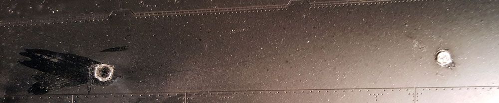

I did the magnet thing on my 1/32 Revell Tornado. Make things much easier. I will be doing it on the 1/48 when I get to it as well.
One of the magnets in one of the pylons...
One of the wings with the two magnets in the attachment spots...
Obviously both were taken before final paiting and all that jazz.

I think it loos great, keep ups the good work. I hope my Tornado turns out half that good.
