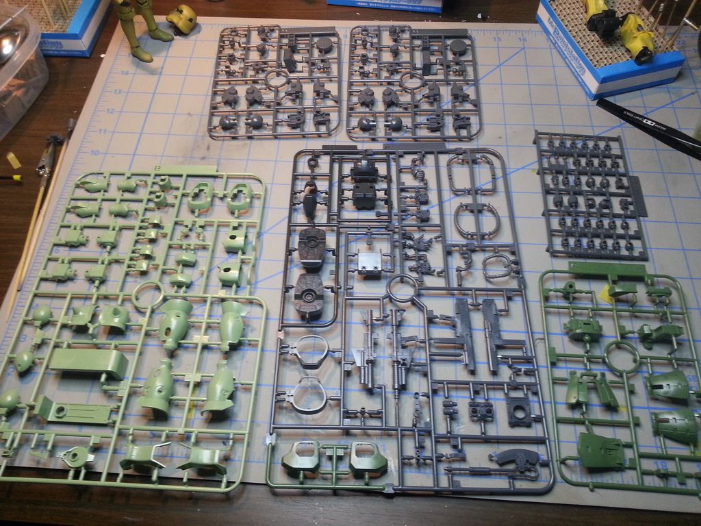

Unmodified kit from dalong.net:
I picked it because most HG Zakus have horrid seams down the forearms except for this one.

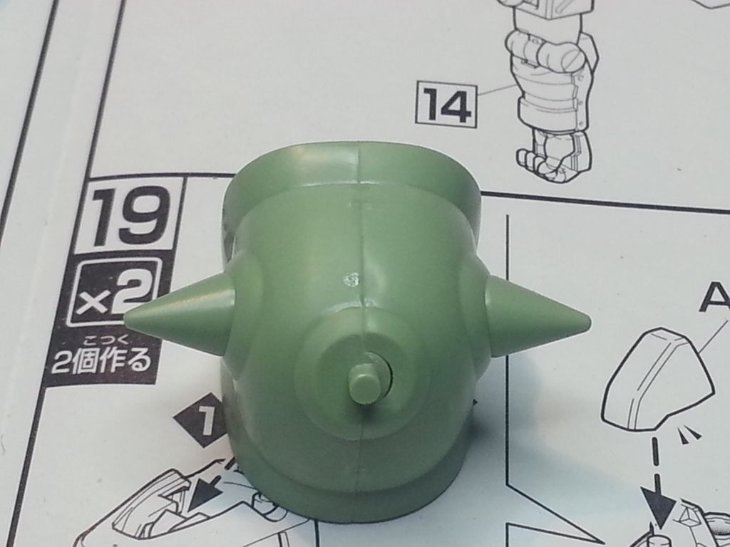

It did have a horrid seam on the shoulder, though.

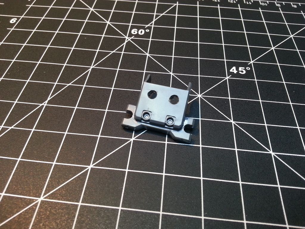

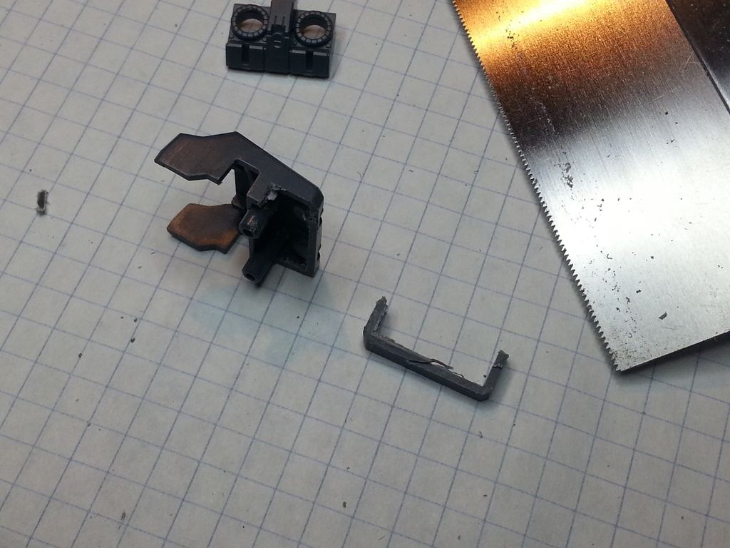

I want to give it some wings, a solar collector and heat dissipater arrangement. First step is modify the backpack to make room for a Gunpla Builders part:

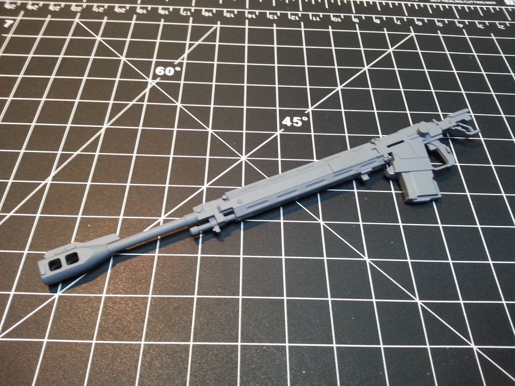

I took a rifle from the Gundam the Origin Zaku I Denim/Slender. The gun had seams down the top and bottom as it just sandwiches together. Whatever I couldn't get with TET and sanding I got with some Tamiya putty:

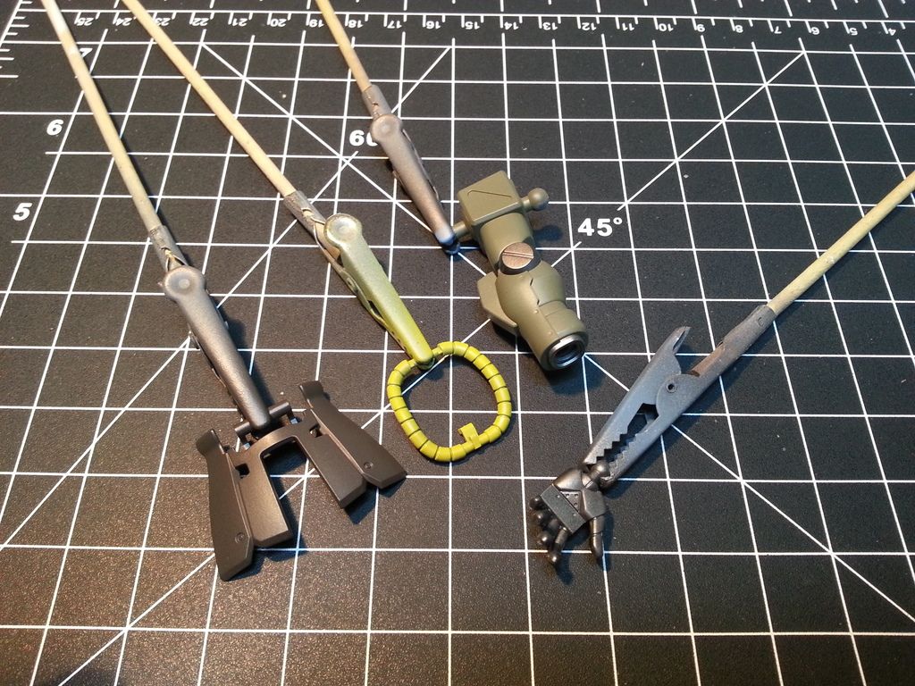

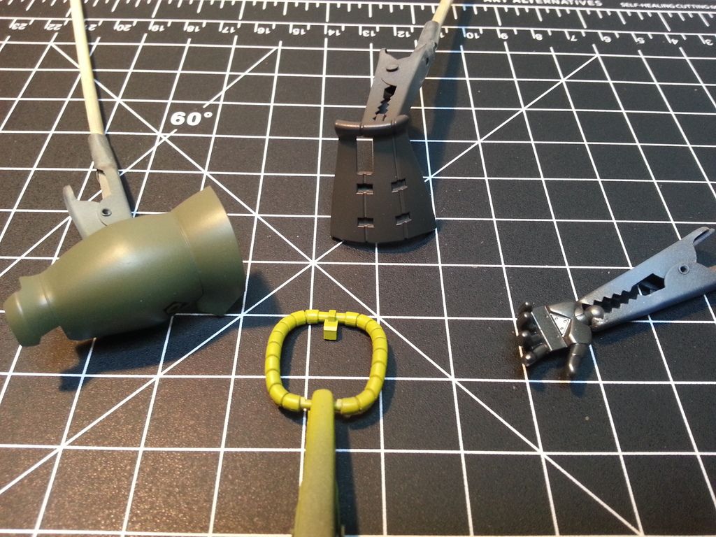

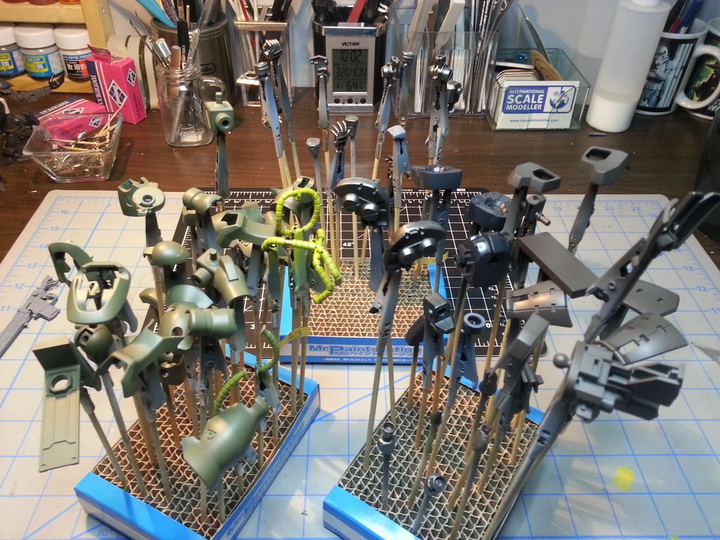

Primed with Stynylrez/Ultimate Grey, then painted with Mr Color lacquer. Mahogany/White/Black/Khaki for the dark brown, Olive Drab 1/White/Bright Green for the light brown, and Yellow/White/Orange for the yellow.
Metal bits are Alclad Magnesium:

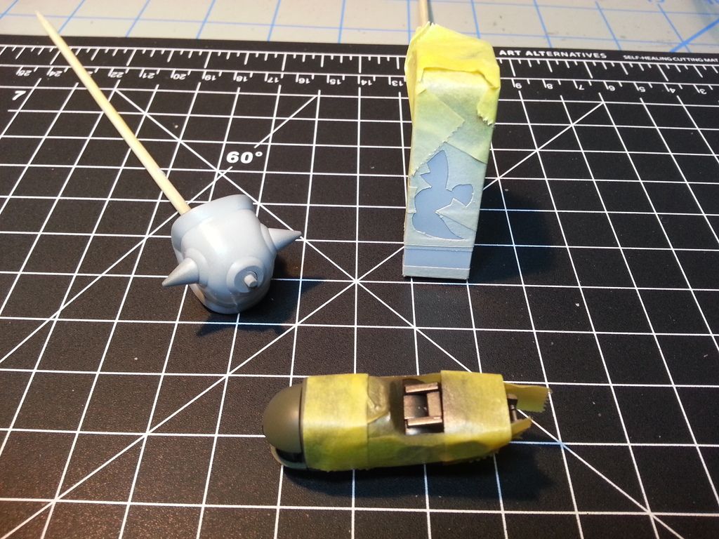

I cut a shape for a bee to put on the shoulder shield:

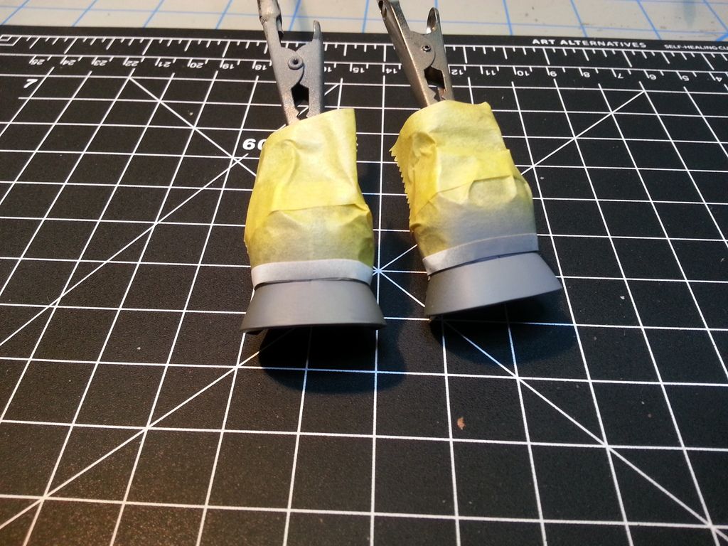

Missed a seam on the ankle armor, so I had to go back and fill that with some TET and sanding (just melt the plastic and press until beads form, sand away.) then re-primed.
Painted up the bee:
