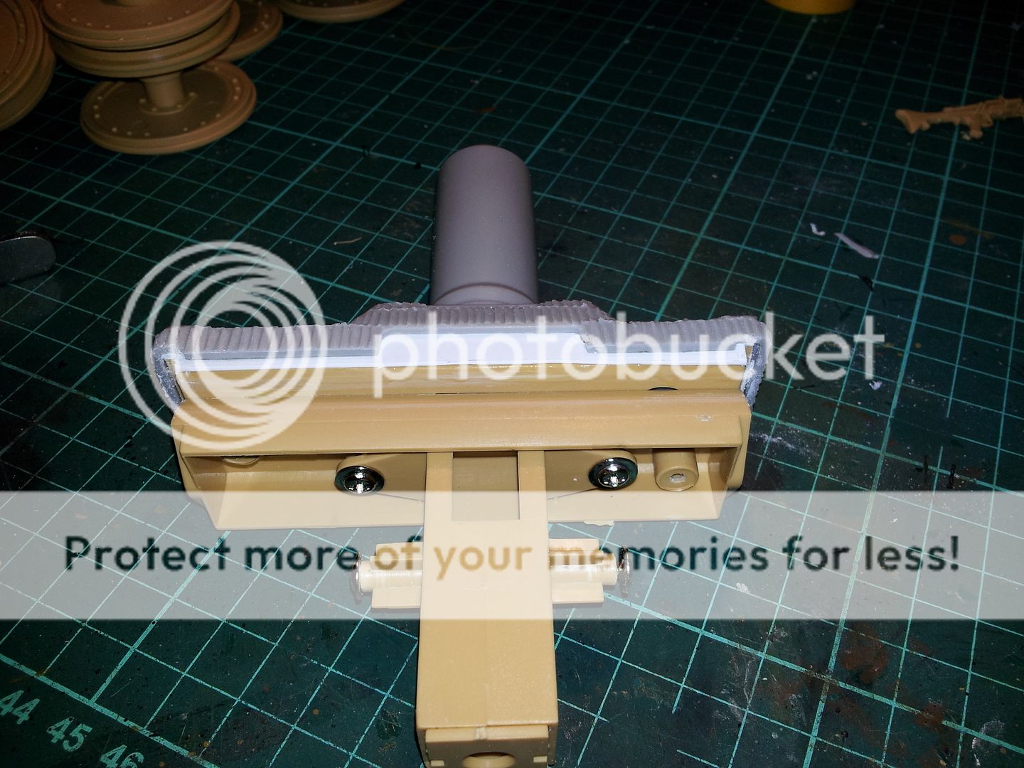

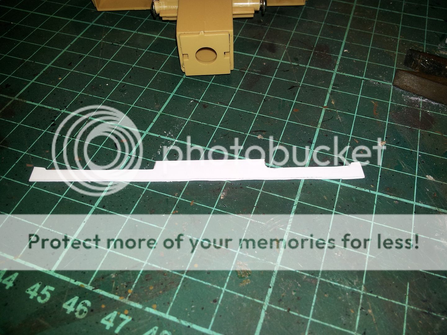

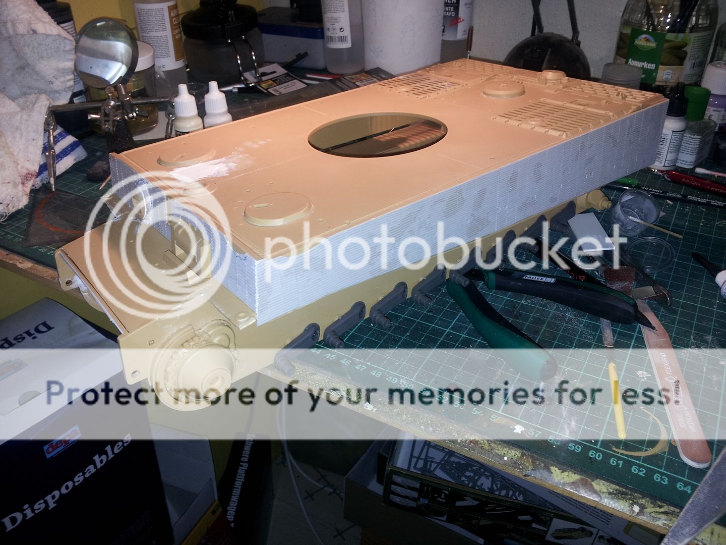

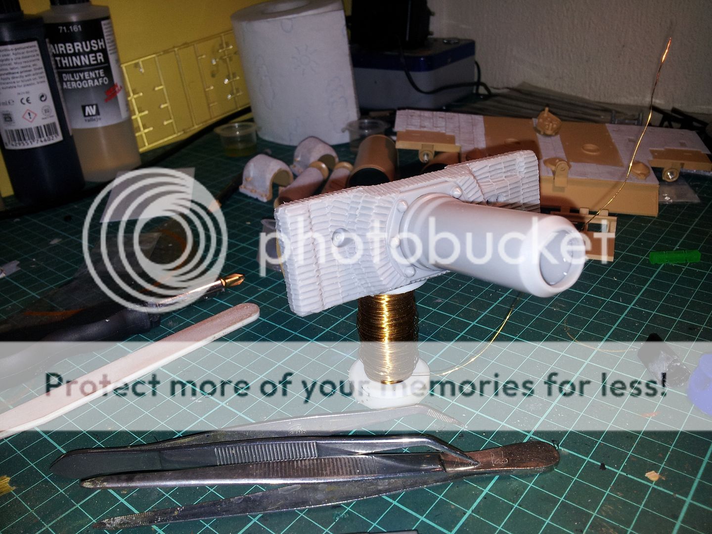

so as promised my pics of the tiger progress even if its not that much

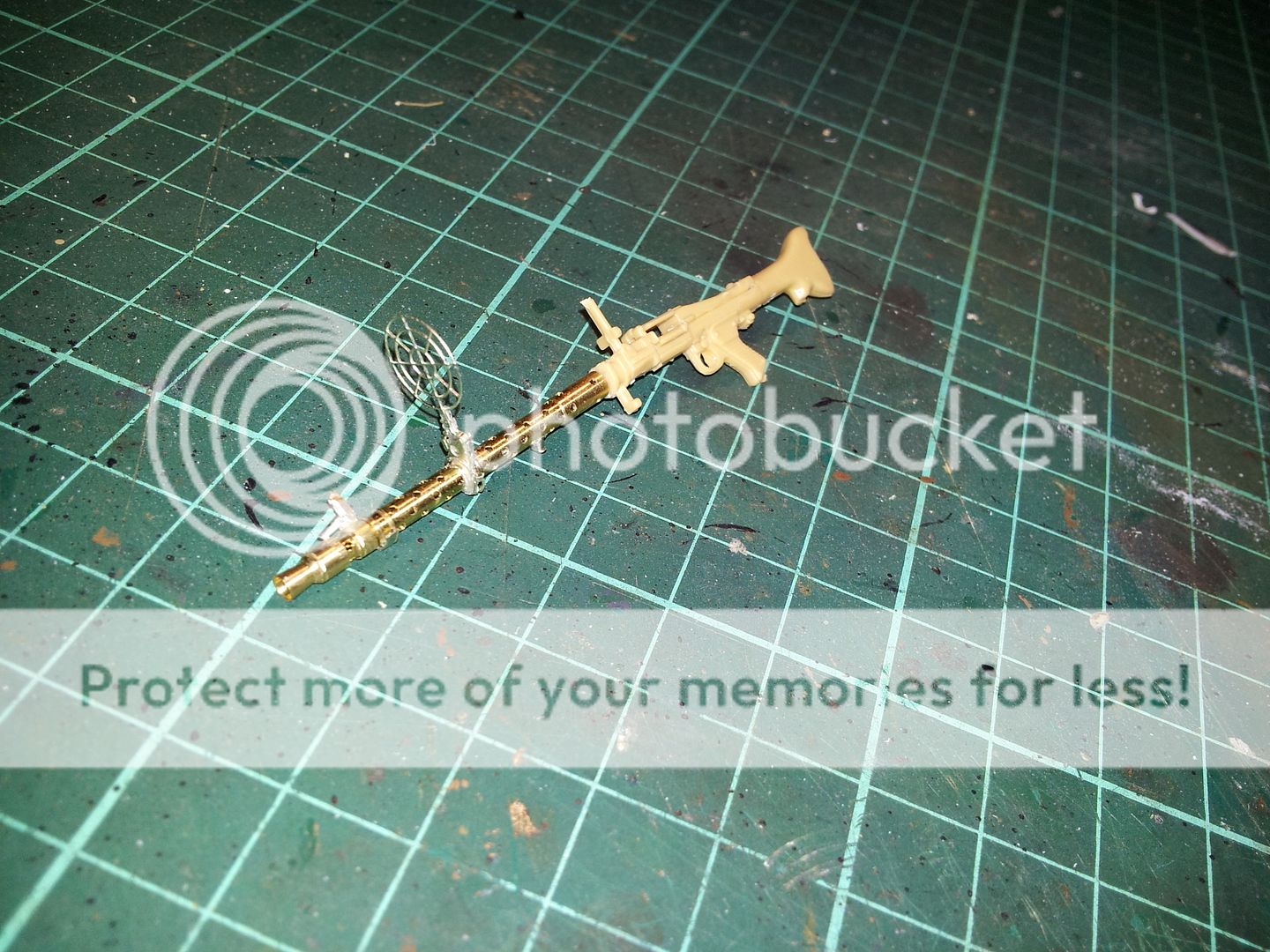

this is my aa mg34 for the turret roof ooh yeah before anyone points it out i know the barrel isnt really straight on the gun (i did not glue it yet)
as you can see i have travelled to mount roadwheel

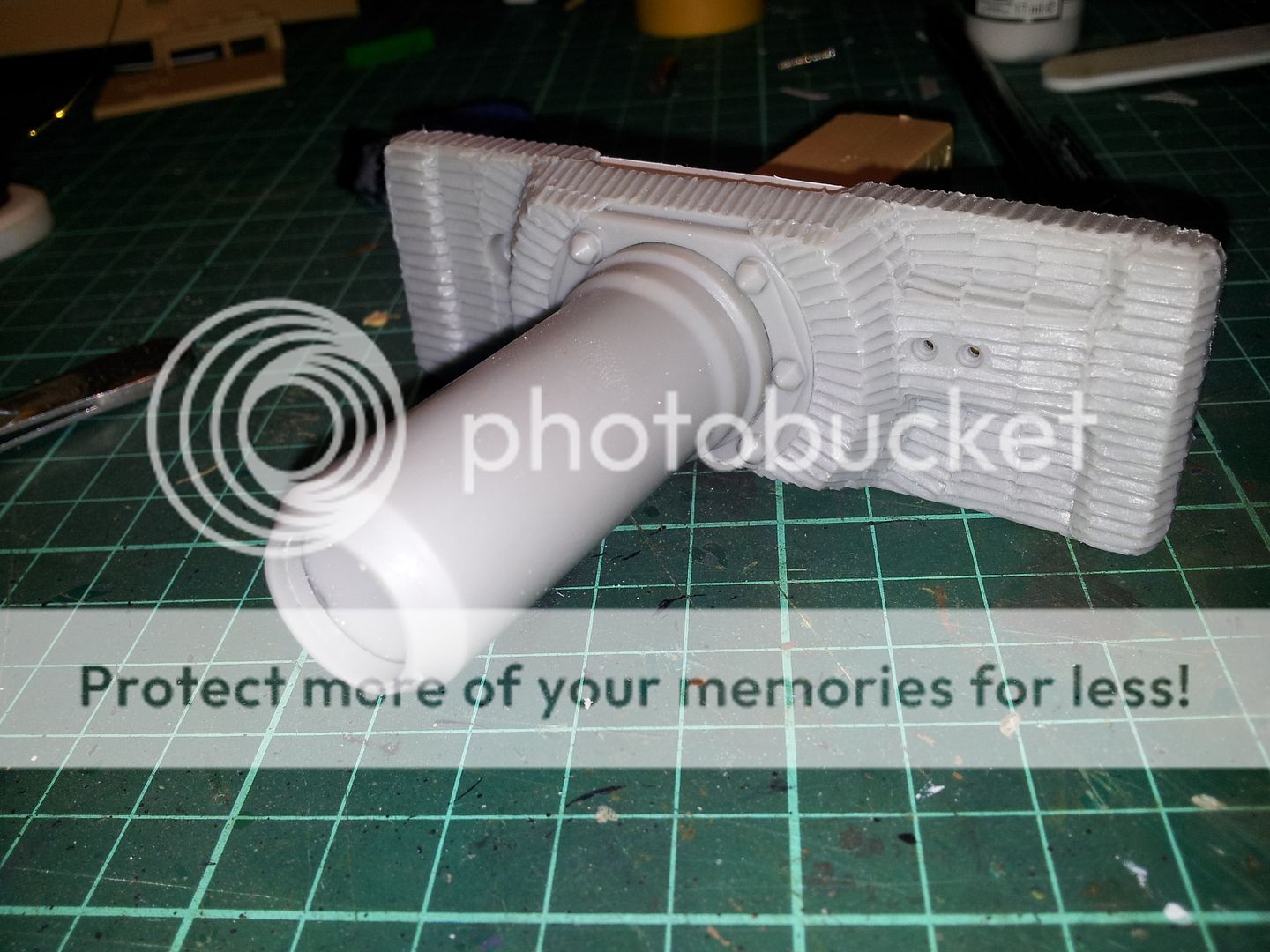

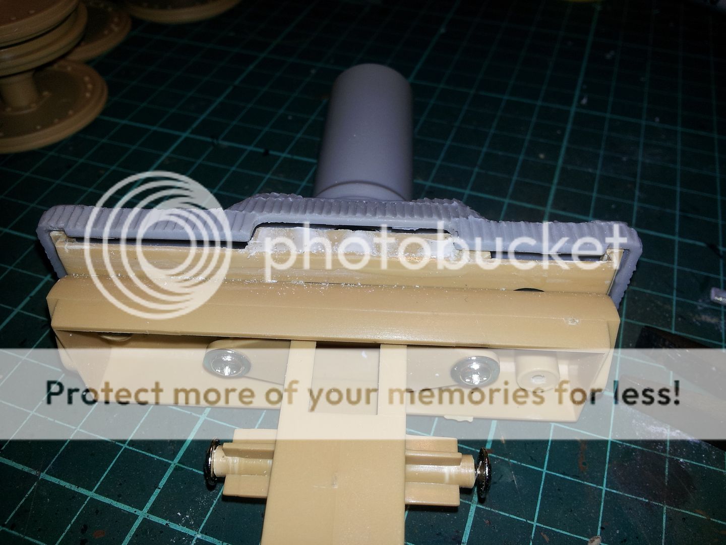

because i bought the tamiya zimmerit kit (why bother to look what you buy)
i had to cut the inside part of the gunshield and that left a gap
and this is the solution i should mention i made this pic before the final fitting
this is the final fit just needed a little sanding to make it flush with the kit part
so i hope you like it so far ihave some other thing to do on this beast like cutting off the side fenders and the turretbin to make the zimmerit fit on the tank but i guess that will be a big job but thats for another day
so if you want to share your thoughts and ideas on this subject please let me know it might be very helpful
cheers Mark

I don't remember if you had mentioned it or not, what did you use to make the zimmerit Mark?
From what I can see of it, it looks fantastic.
You should turn the mallet around and take a shot of it. I'd love to see how it turned out.
Hamilkar is putting zimmerit on his and I'm sure that he'd love to see it to.

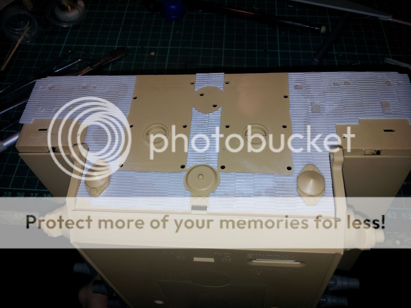

Re: my tiger 1 built
hello too all
i did some work on the tiger the past days
and this is what i've got so far

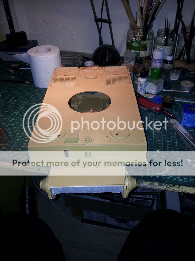

so this is what i've done to the big cats rear although it needs some cleaning up
and i have some shots on the gunshield
so let me know what you think about it
and i talk to you all later

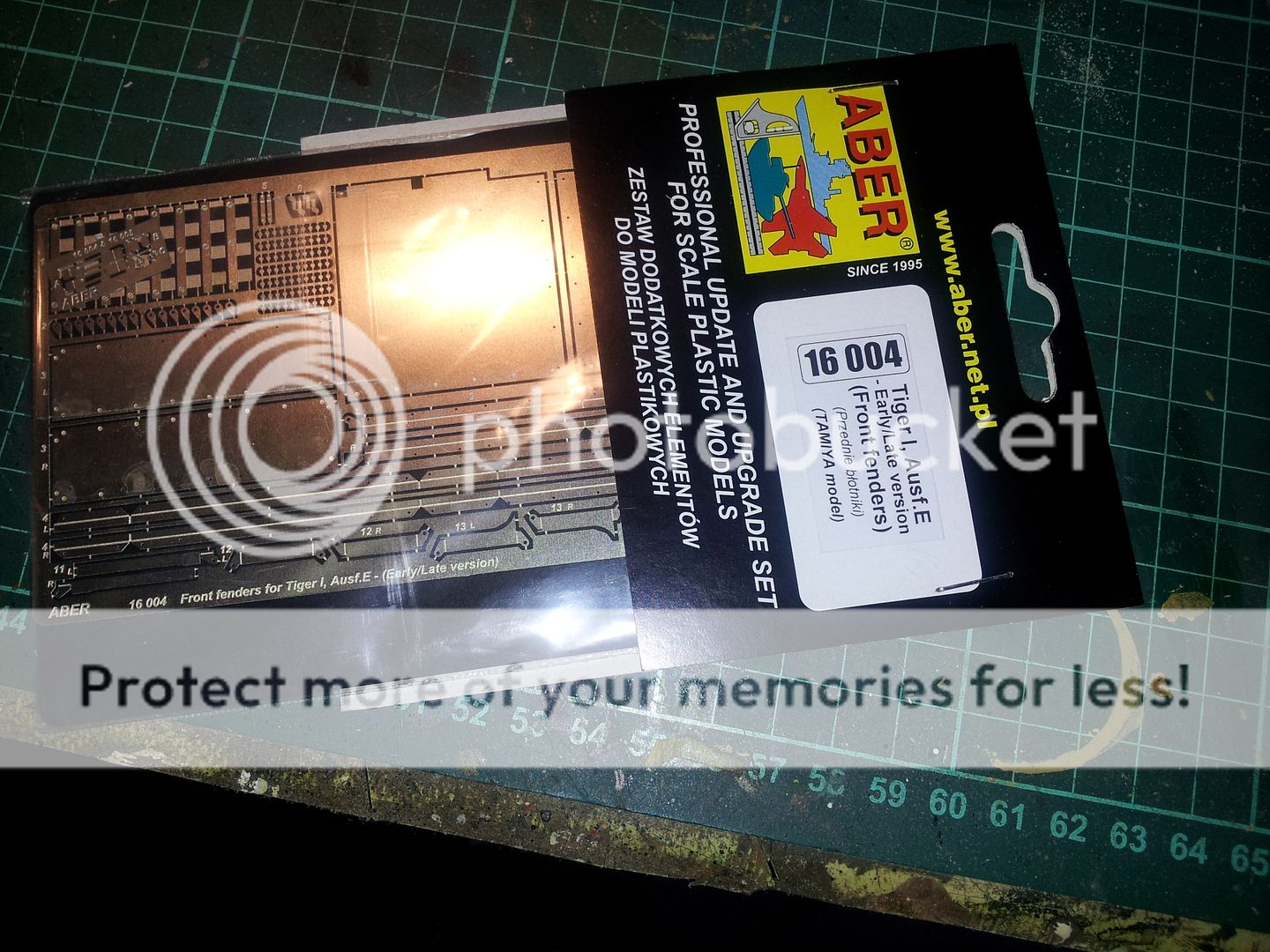

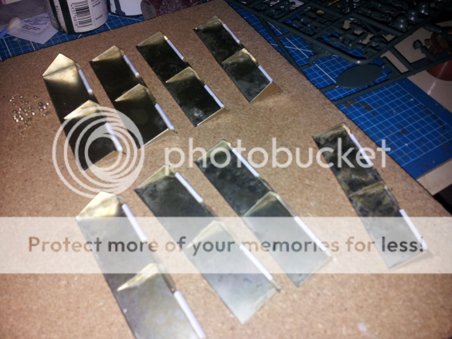

also i had some more work done on the tiger like the next thing
the cat had a diet
also i got me some goodies to make it look nicer :banana:
so this should keep me going for a while
let me know what you think and thanks for the comments everybody

Great updates Mark, you will really like the Aber accessories as the detail is unbelievable, i think the additional tow hook is a great idea and will add the same to my own, plus a great job on the convoy lamp holder it really looks fantastic.
looking forward to seeing how the skirts go together for you. :clap:
I was tempted to replace the side fenders on mine, but the costs of that on top of all the other AM sets that I got for her made it too expensive.
I left mine on but damaged the hell out of them.
I'll be leaving the front mud guards on mine off. I haven't decided what I'm going to do with the rear ones yet.
You've made me feel guilty now Mark, now I want to go work on mine. haha.
Great progress you've made Dude, that zimmerit looks fantastic. The mantlet especially!!!

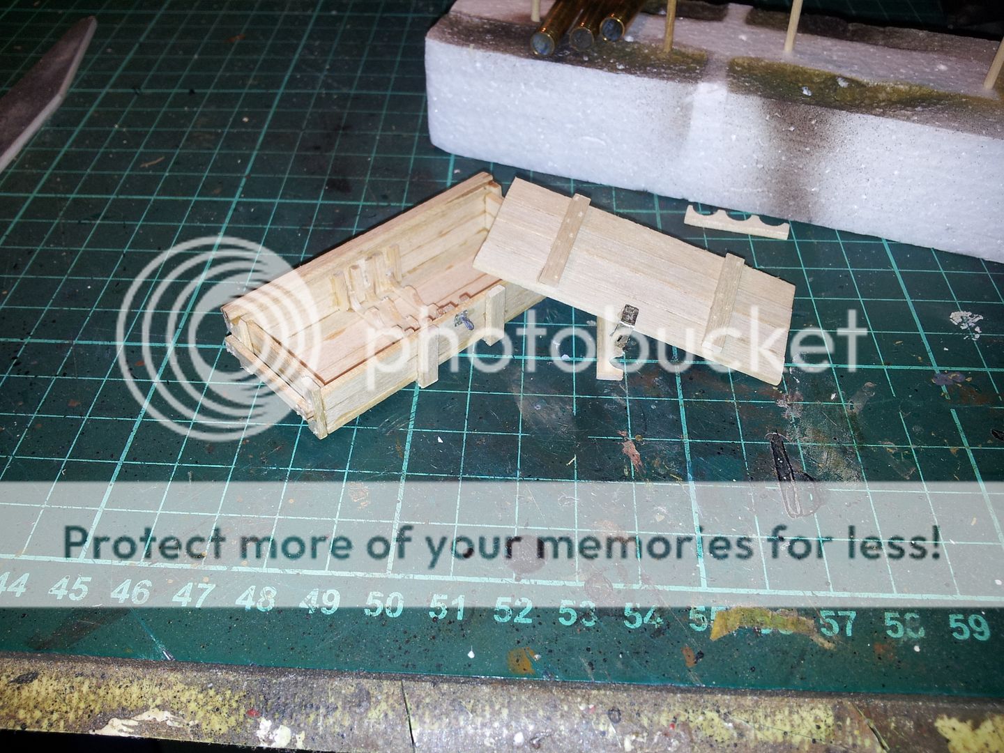

i started with ammo and the ammo box from aber and this is what i've got so far

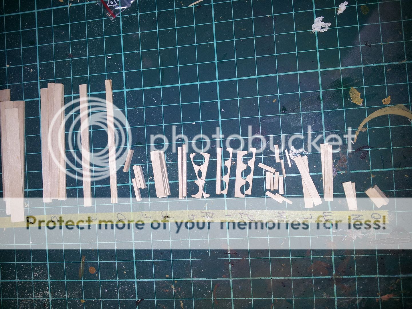

many lose strips of wood looks nice but you have to sort them out first (the 1:1 scale drawings help with this task)
should come in handy

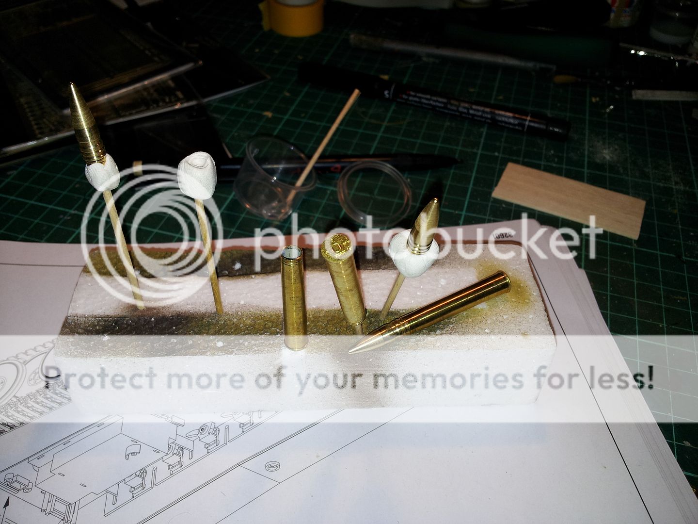

the ammo it self you get 3 and they are in 3 parts
the actual size of the rounds in cm so roughly 2.2 inch
the box before painting
also i started on the front plate of the upper hull

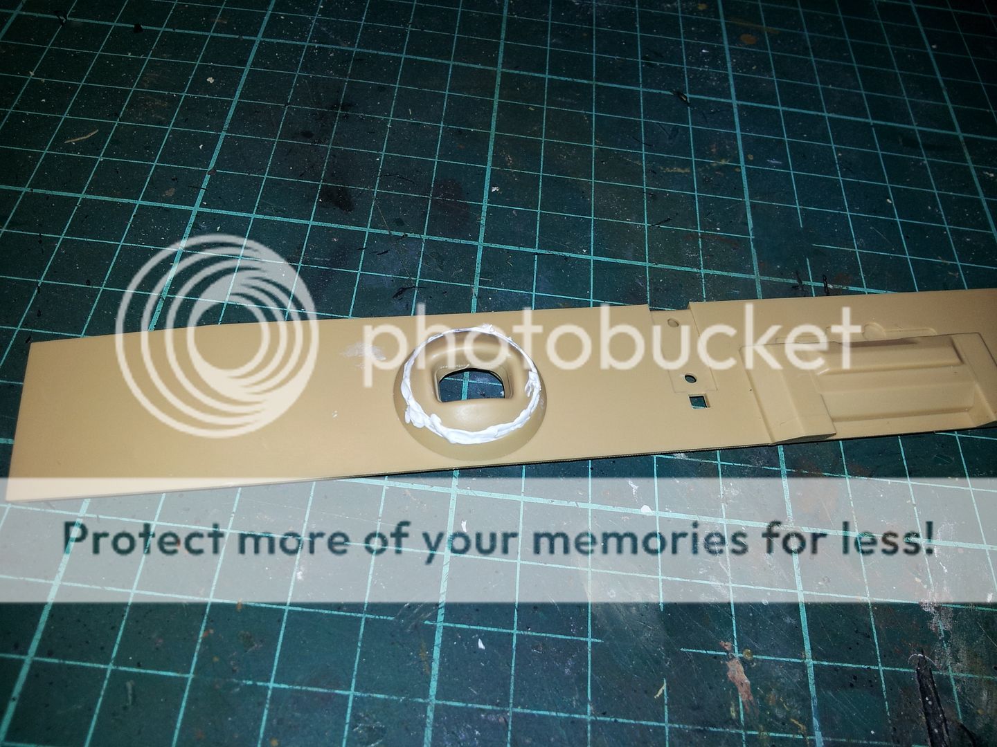

now for this part i do have some problems : the mg mount looks like crap (pardon my french)
and the drivers scopes need to be drilled out
further more the ring on the outside of the mg mount was turned in at the bottom and after a look at a dragon tiger i've built it should be more straight so out comes the putty
if you want an ammo box or just ammo for a tiger1 in this scale i can recommend the aber kit its great the nails are not that good (for me atleast) but it goes together well and the rounds themselves are awesome

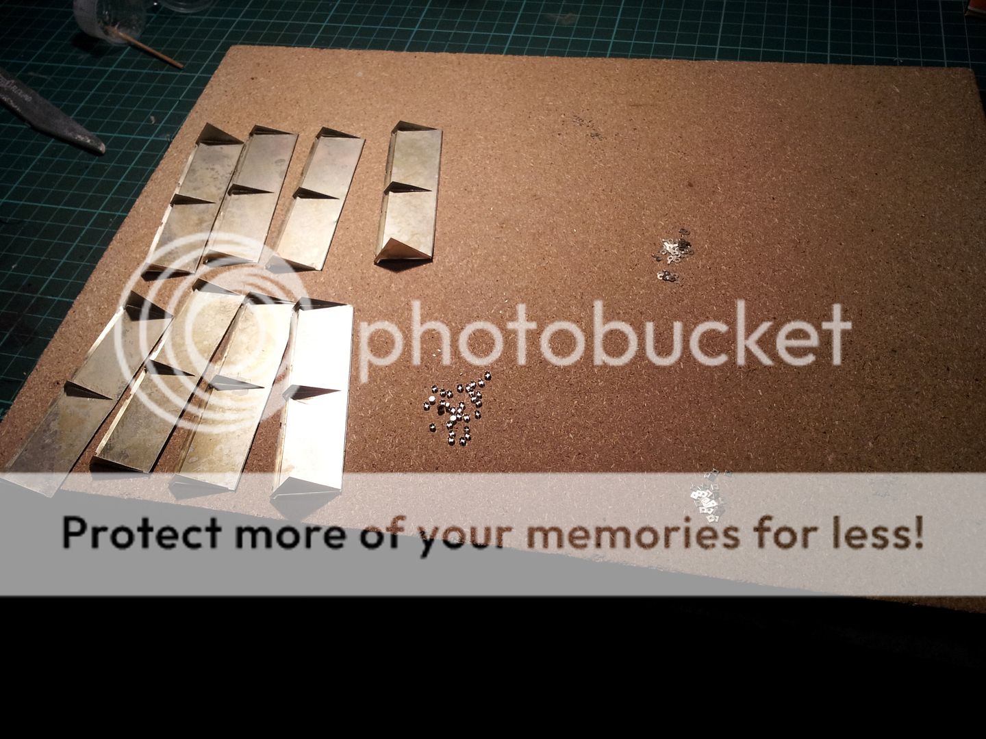

i started on the front plate where i needed to use putty because i didn't like the seamline on the mg mount
next up was the ball mount it self i went and cut off the socket for the plastic mg barrel and glued 3 discs of styrene on the left over plate
after that was done i drilled out 2 holes and placed in 2 tubes 1 original and 1 was drilled to make the aber mg fit and then just cover it up in putty (i had a photo of it but you can't see anything but a white blob so i'll spare that one

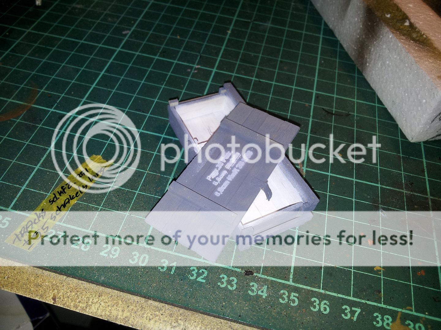

then i worked on the aber ammo box
it goes together well and looks nice i just can't work the provided nails so i just drilled little holes to make it look like there could be a nail in side and the painting
for the weathering i just sanded it very lightly i'll be adding dust when i finnish it with the tank

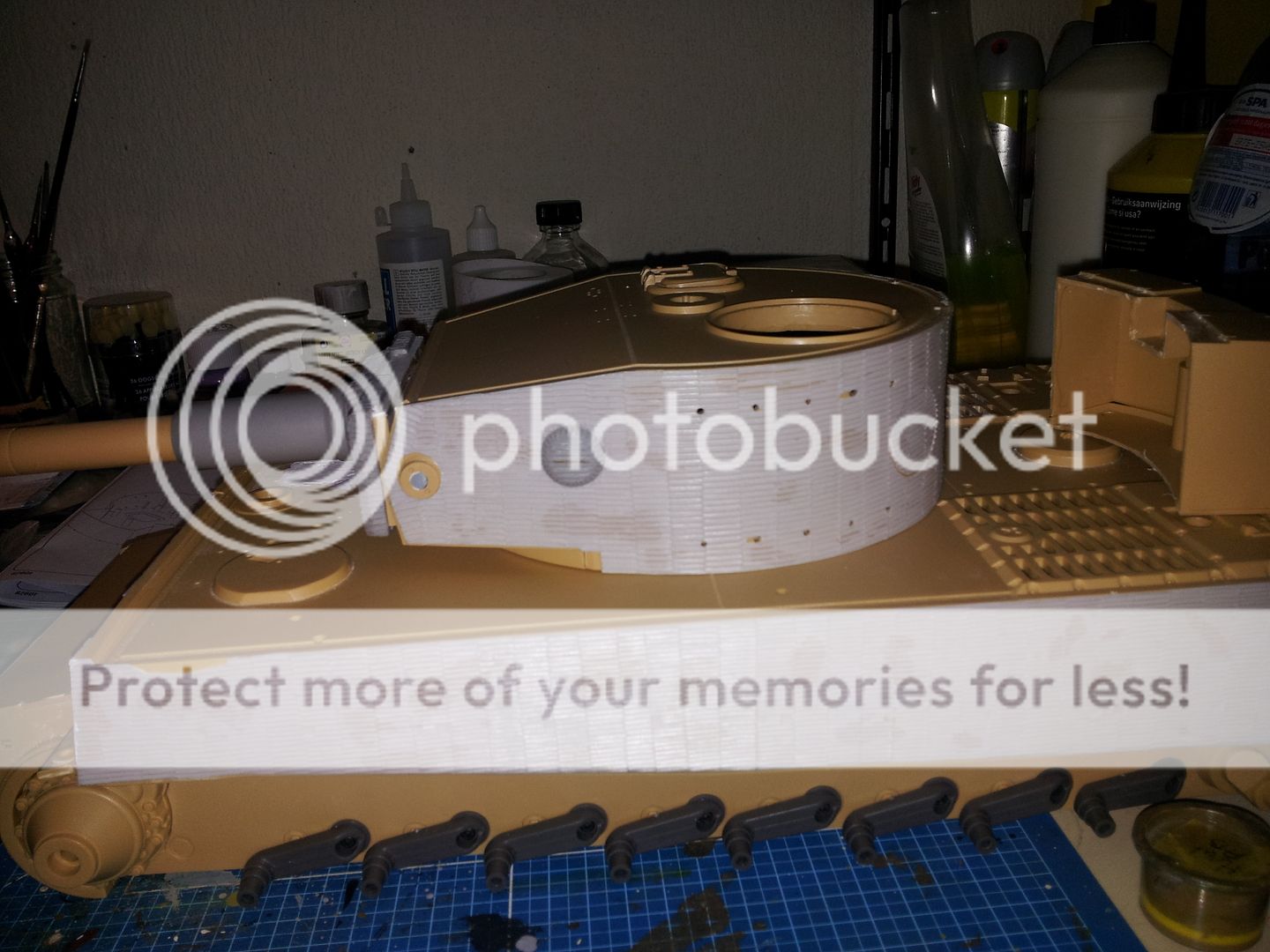

of course its now time to do zimmerit on the entire hull
now these are five parts in total and fit well perfect
i will be adding some more damage later
then i thought lets just fill the trach ejector pins cant be that bad right
i know i did only 2 row on the outside but i think y can't even see the others so i don't bother about them only sanding them for now

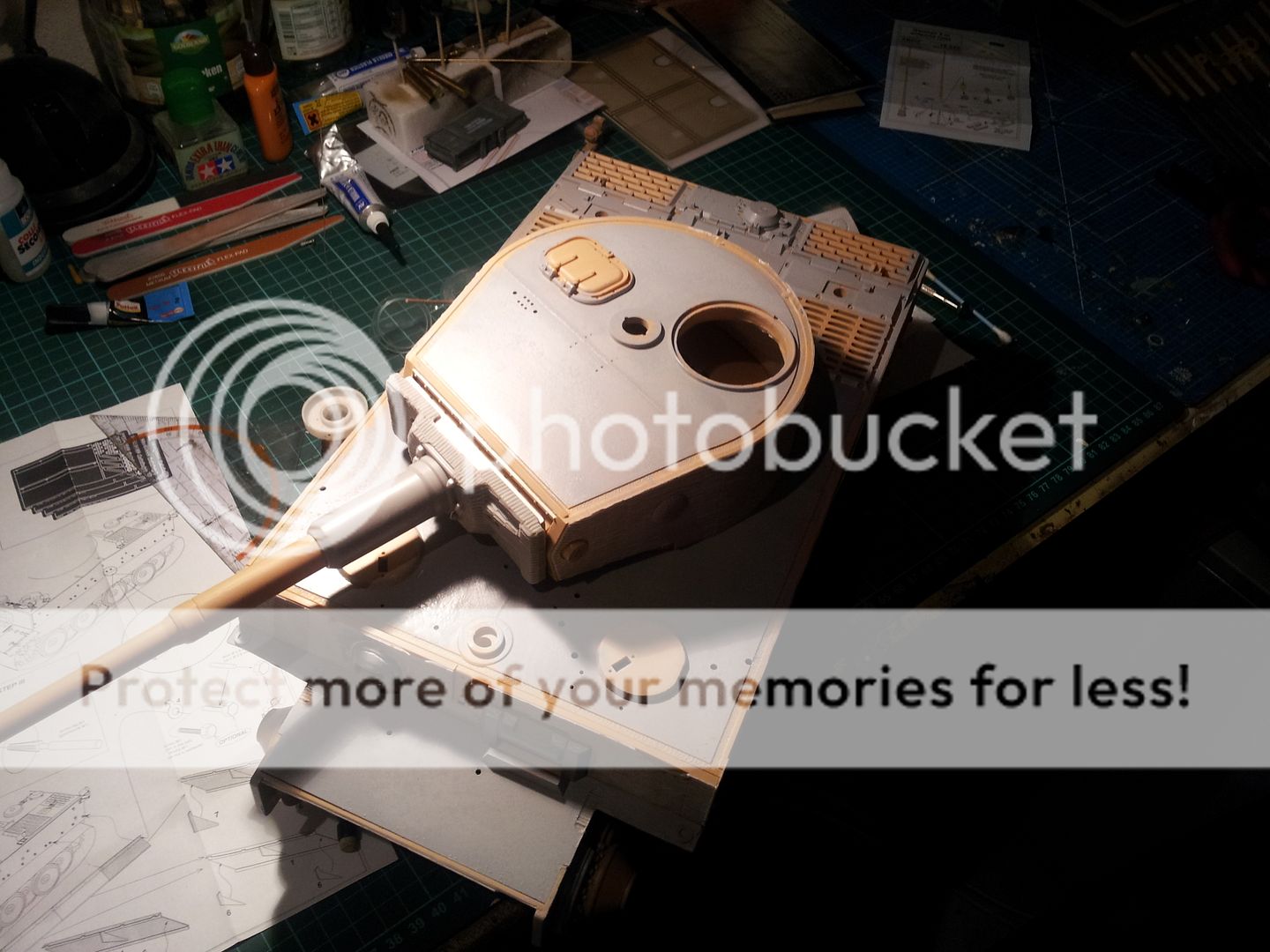

then i got to one of the biggest jobs of the build
removing the turret bin but i got it done
i will make a new wall on both the turret and the bin
then make the zimmerit on the turret and place the whole lot back in its place

We should rename this build to the great hobby boss hack and slash haha. These are some massive reconstructions Mark. Taking off that turret bin must have been tricky. Nice work buddy.
I'm planning on removing the outer wall of the bin and replacing it with either sheet lead I or copper.
Nice fix on the MG ball mount. :th: :th:
well the removal of the turretbin is.not.that hard you just need a whole lot of patience and about 2 xacto blades as they will become less sharp
but i think i will be rebuilding the bin and.turret walls later today then i can place the last parts of the zimmerit and then its photo etch time with the fenders or the texture applicatiom on the cleam parts of metal dont know yet

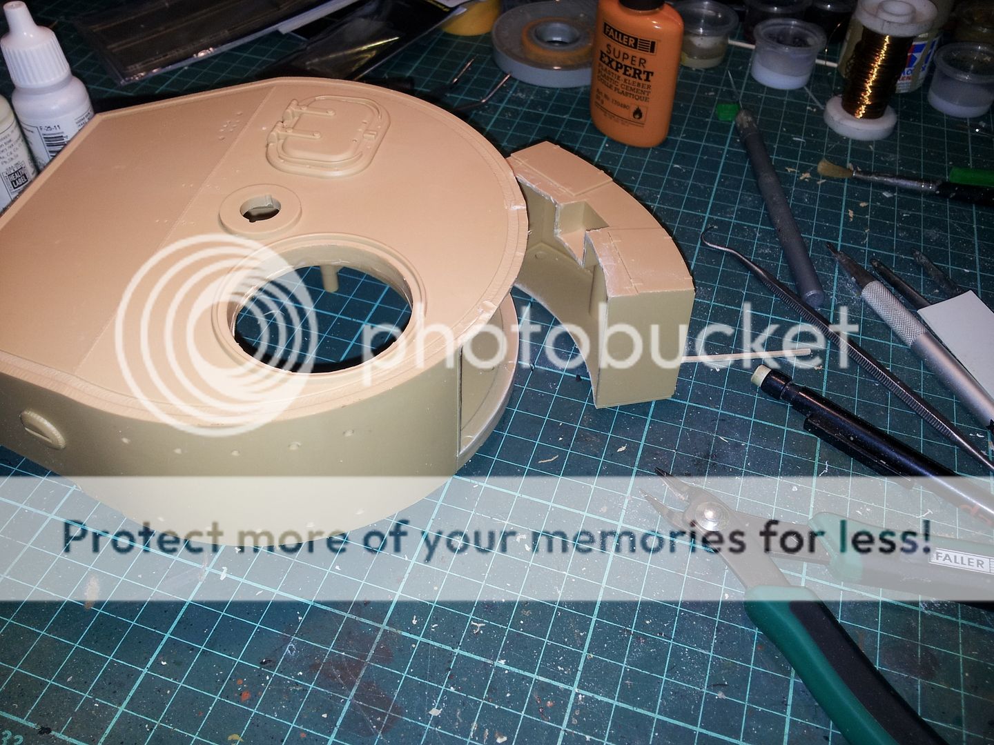

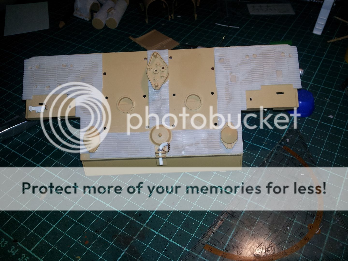

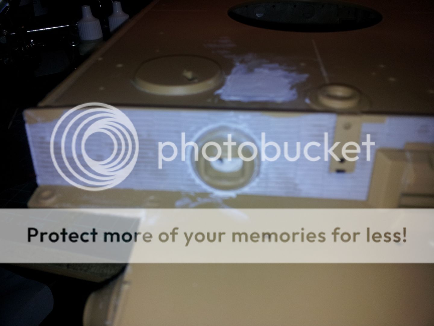

:hi:
i have a little update on the big tiger
it's not much but this is because i wanted to make room on my bench so i finished off 3 other builds this weekend but i'm back on the tiger and this is what i've got
so i got all the zimmerit on the turret and as you can see there is a gap on the back
but a little filler and a toothpick should fix that
also i need to make a lifting pin on tyhe back of the turret as this is missing
and here are my figures that i already have but do note they are only painted and not yet weathered
so i hope this keeps you all up to date for now
all comments are welcome
talk to you later Mark

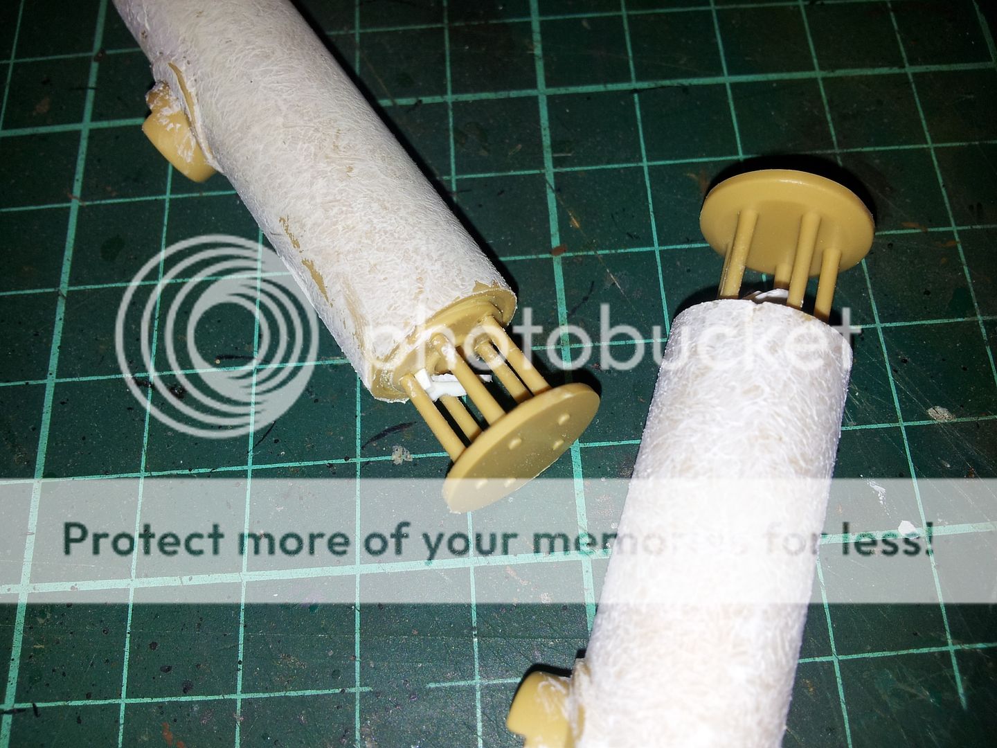

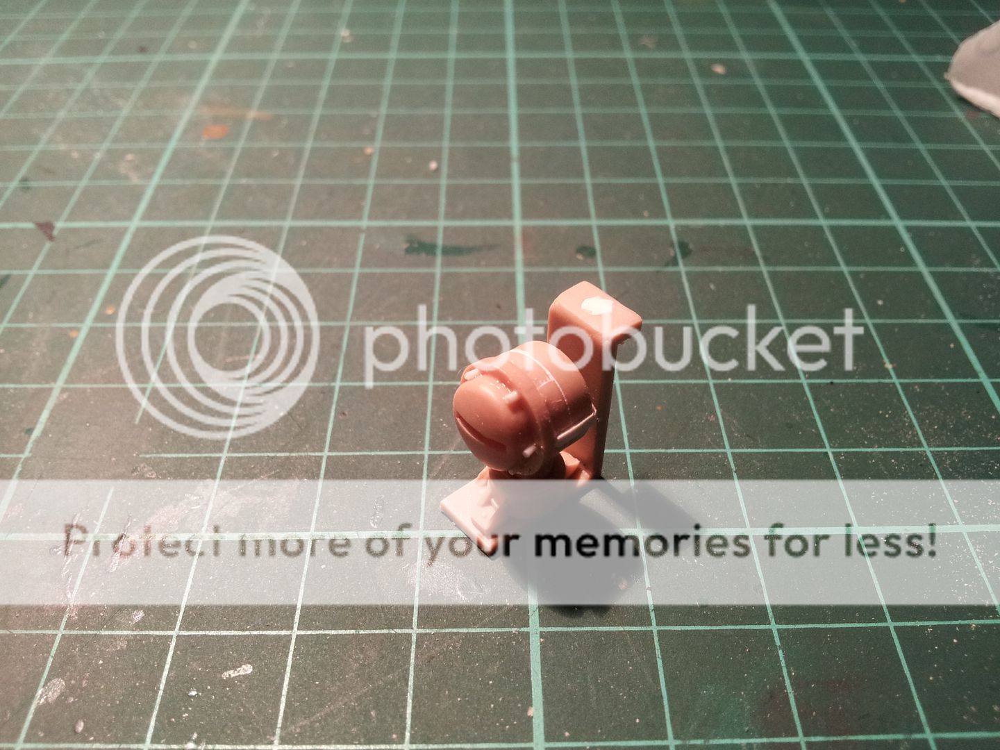

so this should be another update on the tiger
now i didn't do that much on it
but i have a real good reason and that is :cheers2: this got in the way and beer doesn't help my building skills a lot
and i finish 3 other builds that i was working on and that were standing on my bench
so now i have room to work :banana:
and this is what i did

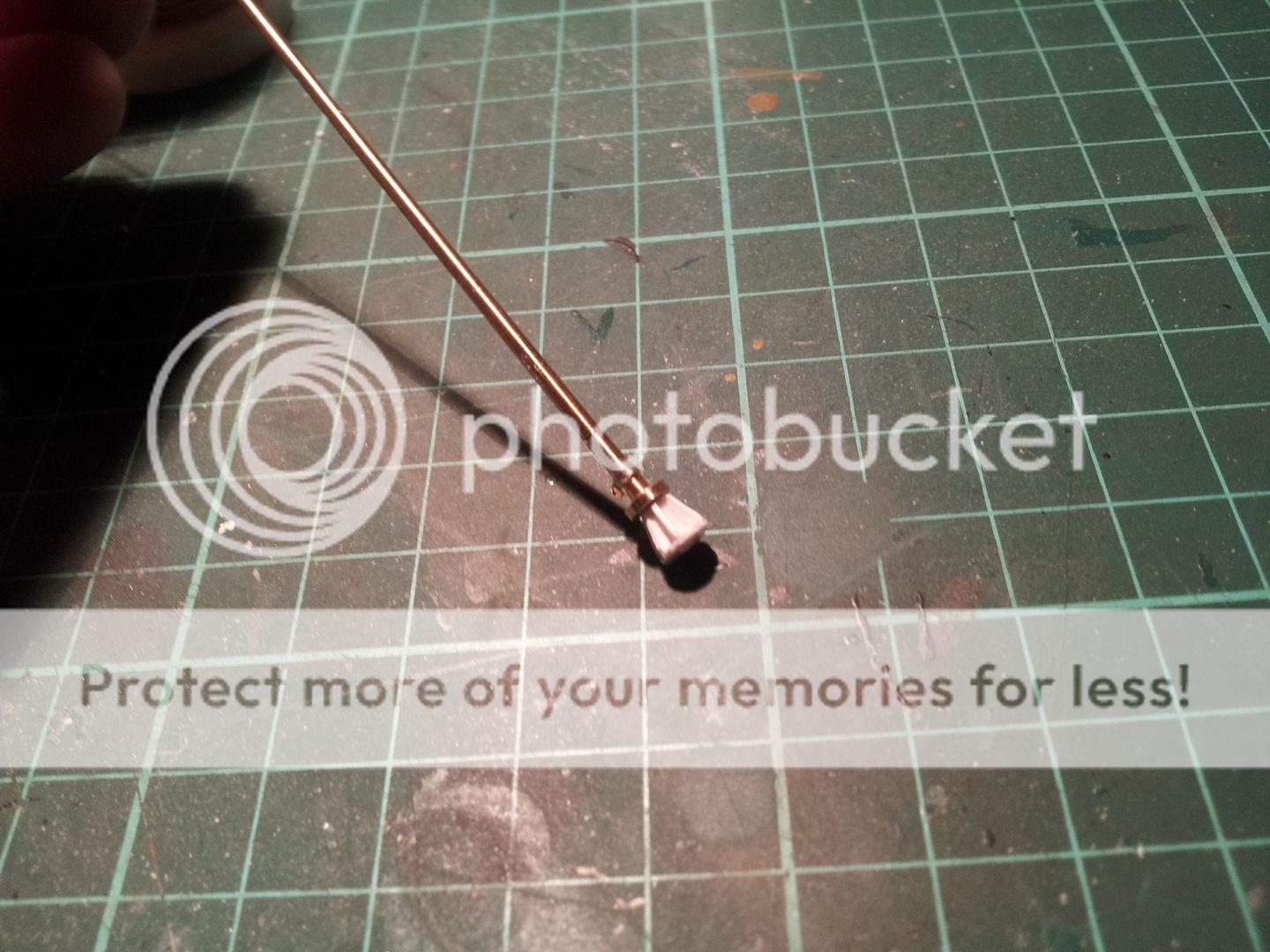

i made the headlight and replaced the strap on the back side of it
also i added 6 small pieces of styrene to replicate the screws holding the front and back together
next up was the antenna the point about this is that the aber antenna is for the tamiya kit so it's just the antenna and not the mount for the antenna but it's a easy fix with a piece of tube and some flat parts
and then there was everybody's favorite task : mr surfacer
its dries fast and applies easy but man you can get stoned from this stuff really what a smell i almost forgot about that after 3 years not using it but it's back
and that's all i can do for now although i also got to work on the side and front fenders but i need some materials before i can go any further on those
so let me know what you think and talk to you next time

hi and :welcome: to a little update on my hobby boss 1:16 tiger 1
i know it doesn't look like much but believe me it's quite a lot of work doing the side fenders in a PE set
this is because they are too big for my bending pliers and i don't own a bending tool since the prices on those things are insane (plus i wounld need the biggest one i think)
but this is what i came up with and for the first time it fits in 1 photo
the reason that they are still laying around is that i thinkl the fit on the tank will be kind of fragile since each piece fits on 4 1mm square blocks on the tank and i have the zimmerit on there aswell so so i want to reinforce the upper part of the fenders by placing a styrene stip in between each hole so i can glue it to the hull on a larger surface
i would need a 0.7 or 0.8 mm strip witch of course i don't have (yet)
so tomorrow i'll go to the hobby store and building this monster shall continue
see y'all later

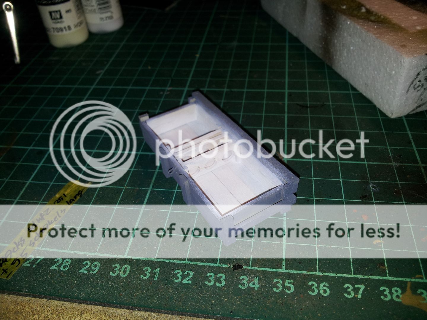

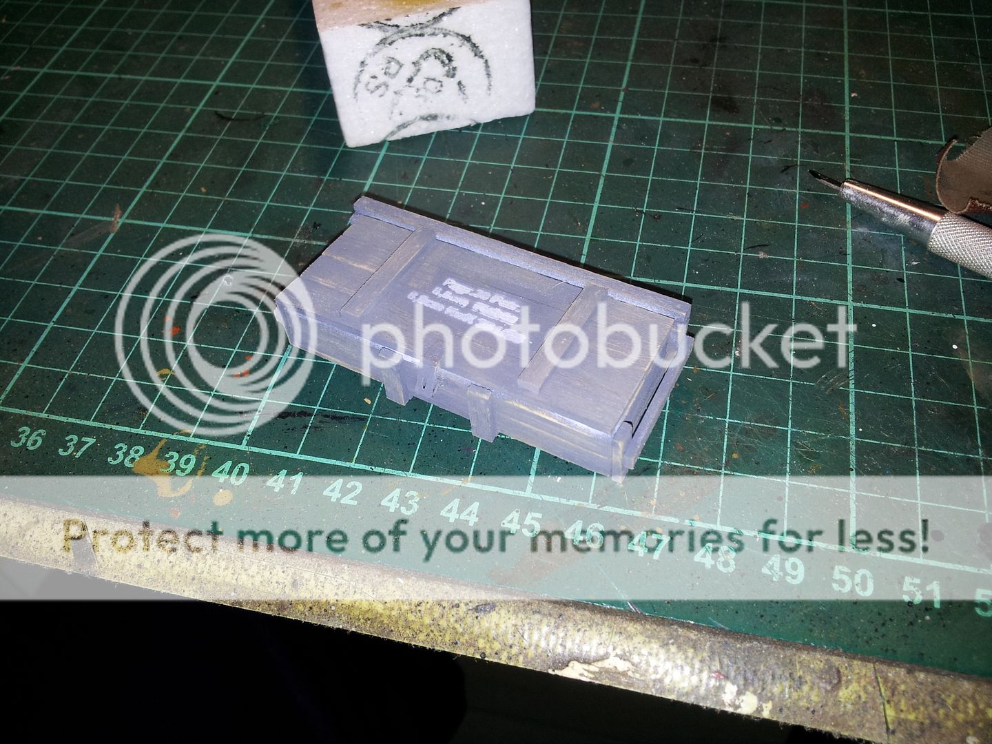

so here is just a little update on the tiger since i have done that much on it the last week or so
i have my styrene that i needed and made the supports on the side fenders as you can see here
the i went at it on the turret bin and i have tried it with lead and brass to replace the outer panel and it can not be called a succes so i spare you the photo's
the lead folded under its own weight and the brass is just a pain in the behind to work with
so i think i will just sand down the inside of the bin and damage it that way
also there have to be some rivets on it (don't know how many i don't count them)
so i can work on those aswell
i dont have a punch and die set since these things are to expensive in my opinion
but i have another way on how i can make them
i use a sheet of aluminium and drilled a hole in it the same size as i want the rivet
then take a piece of old sprue ( cut it straight)
heat that up and press it on the hole while holding the plate in your hand
this way it will form a long rivet that you can cut off an glue in place
so that is what i will be up to
see you next time
HAHA!!!
Mark that is a very very old school way of making rivets.
Well done buddy... very well done!!!
:clap: :clap: :clap:
