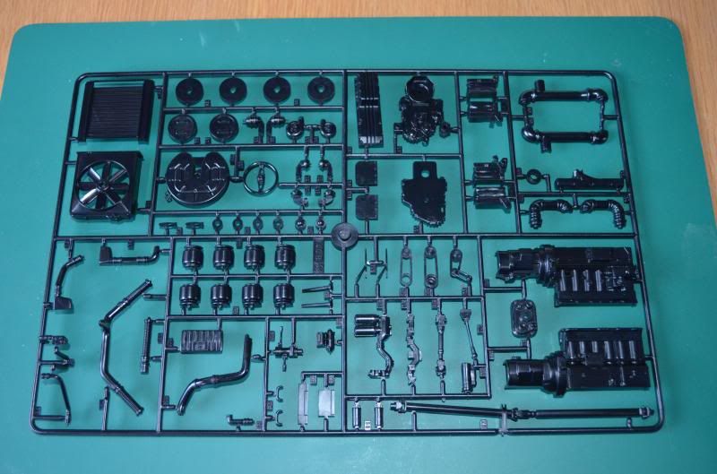

Second sprue is also black styrene and has part,s for the engine, some more suspension and the radiator and fifth wheel.

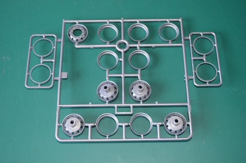

This sprue ia moulded in a metallic grey and contain,s everything for the inner wheel rim,s

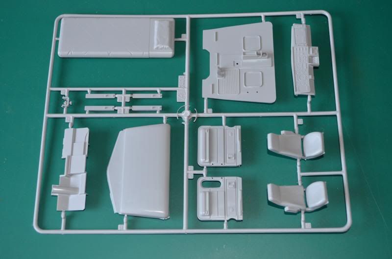

This sprue, moulded in white, contain,s the exterior cab part,s and the 63" sleeper cab.

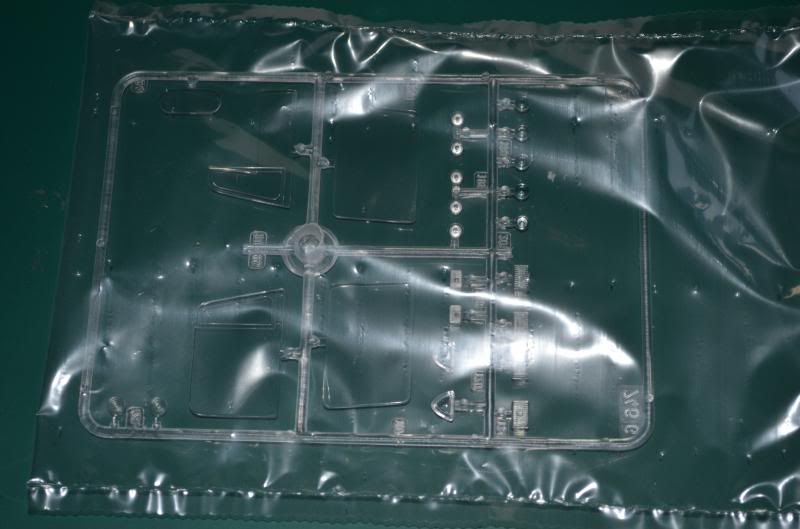

Transparencie,s,I am leaving them in the bag as I am very prone to scratching clear stuff, so these will be dipped in future and left until they are needed.

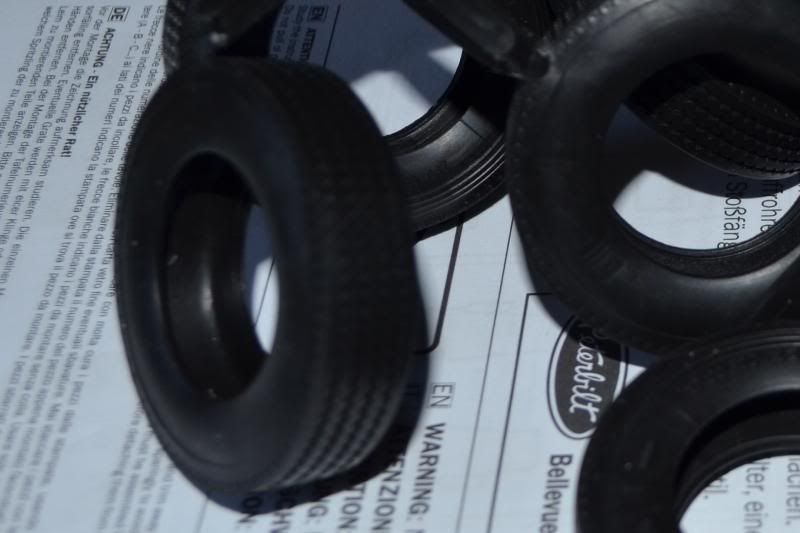

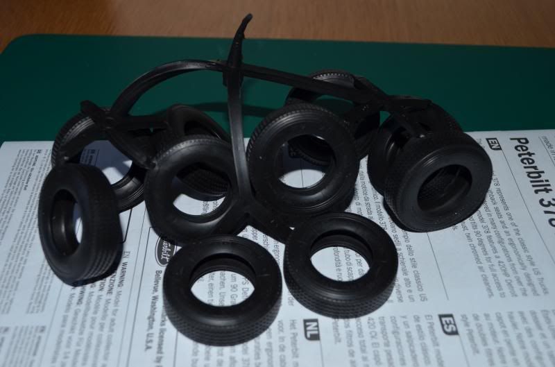

Tyre,s, nicely moolded if a little on the soft side.
Close up of the tread pattern, there is the very slightest of seam lines but a No. 11 blade scraped along this will sort that out.

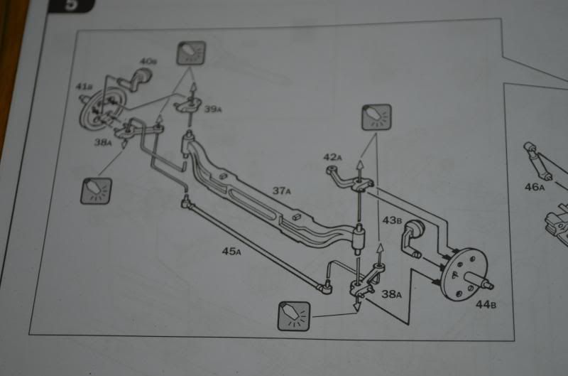

Instuction,s are an A4 booklet
Build sequence,s are nicely illustrated and easy to follow with detail painting shown throughout the build sequence.

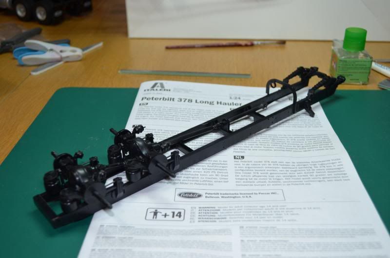

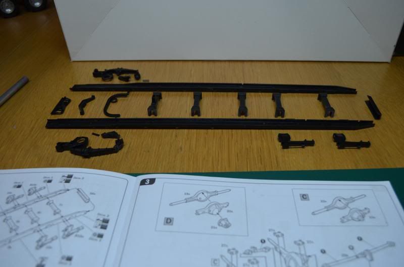

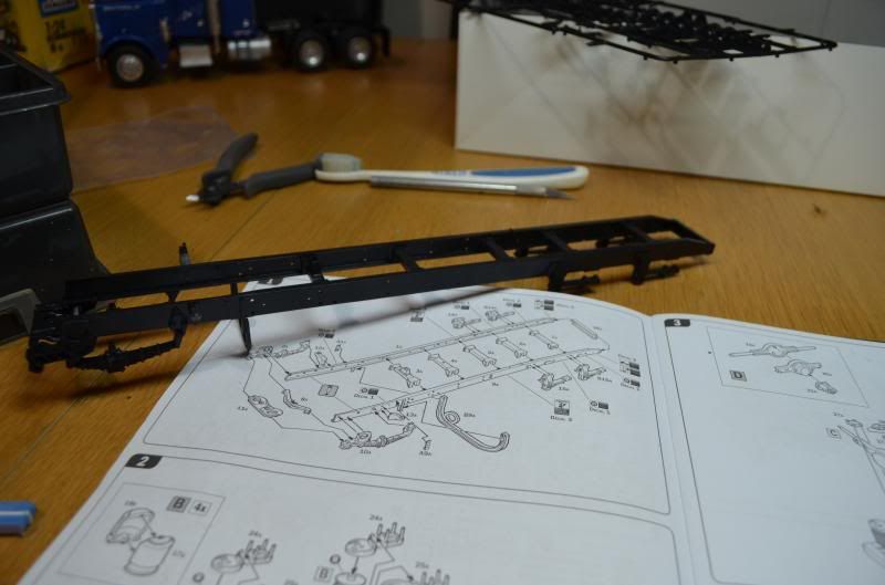

Step 1 is the main ladder frame for the chassis, correct alignment is crucial here if the model is to sit correctly
All the necessary part's removed from the sprue's and cleaned up ready for assembly.
All done and nice and square thank's to nice fitting and positive fixing point's

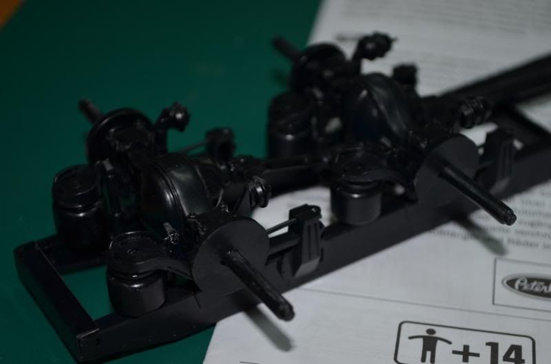

Next up are the rear suspension unit's
Again wonderful fit and flash free part's make construction a doddle.

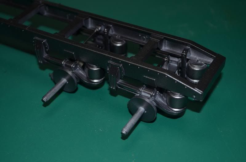

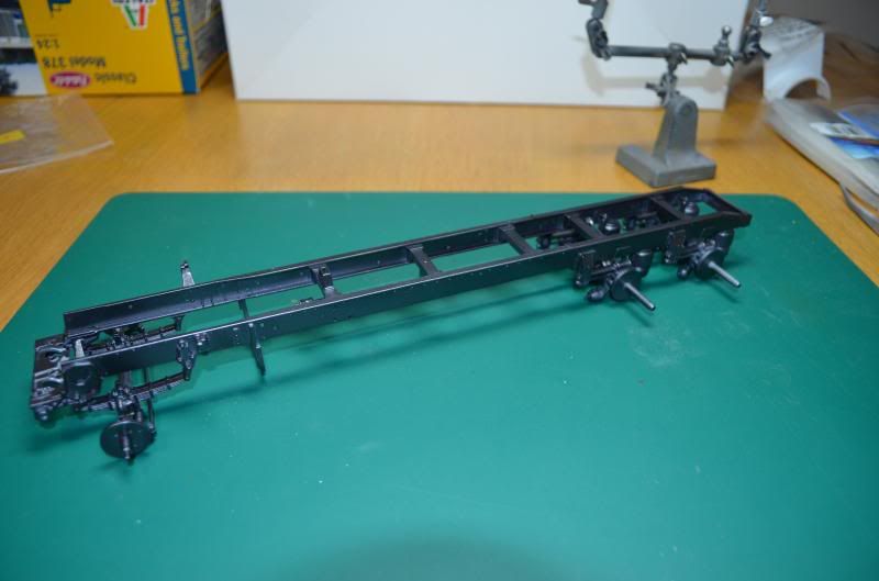

Rear axle's next
Constructed and fitted to the chassis

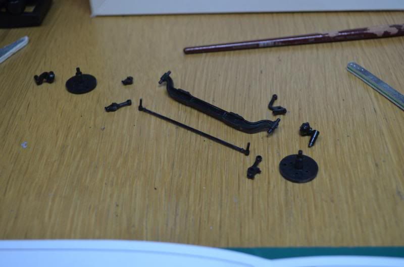

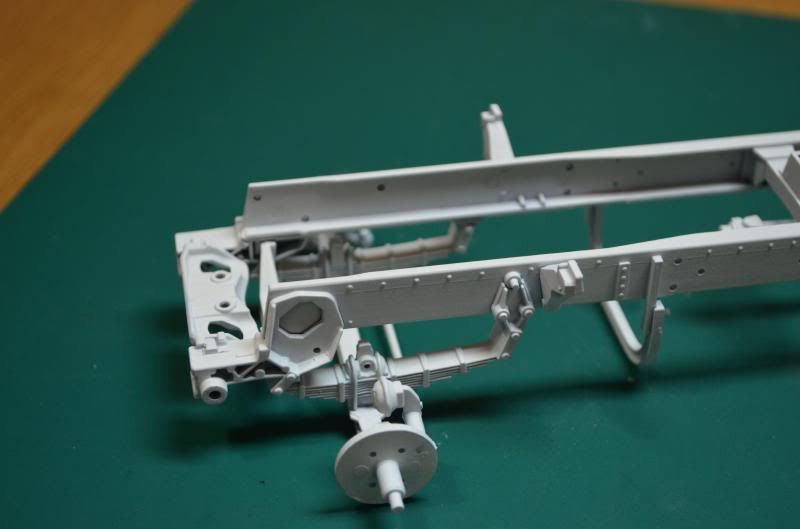

This next step is for the front axle and steering
Built and fitted
Construction coming along nicely
Chassis primed with Halfords white primer

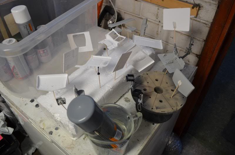

All part's for the cab and sleeper interior's and exterior's ready for priming. The primer is Halfords Grey plastic primer. It's in a jug of warm water, this improves the flow of the spray.

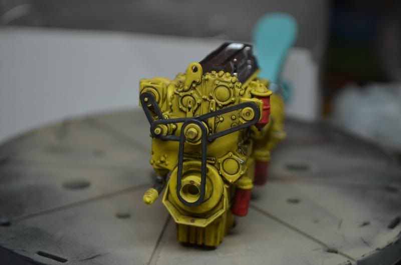

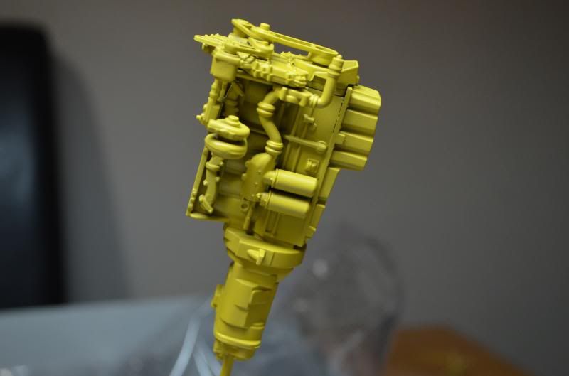

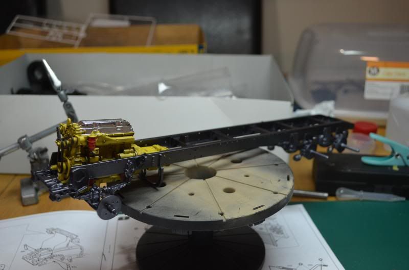

Here is the engine sprayed in my representation of Caterpillar yellow {Tamiya X8 lemon yellow and a couple of drop's of XF 13J.N Green}.
Chassis all sprayed up ,Tamiya TS38{ rattle can} it's covered quite well.
A few touch up's here and there :oops:

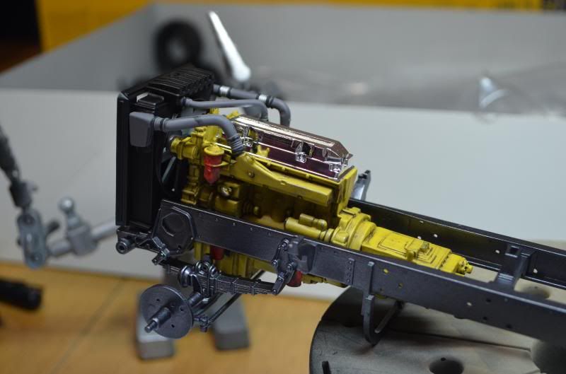

The completed engine, detail painted and a wash of Ultimate dark dirt and dry brushed with Mr Metal Iron.
Other side
And the front.
Engine fitted to the chassis
