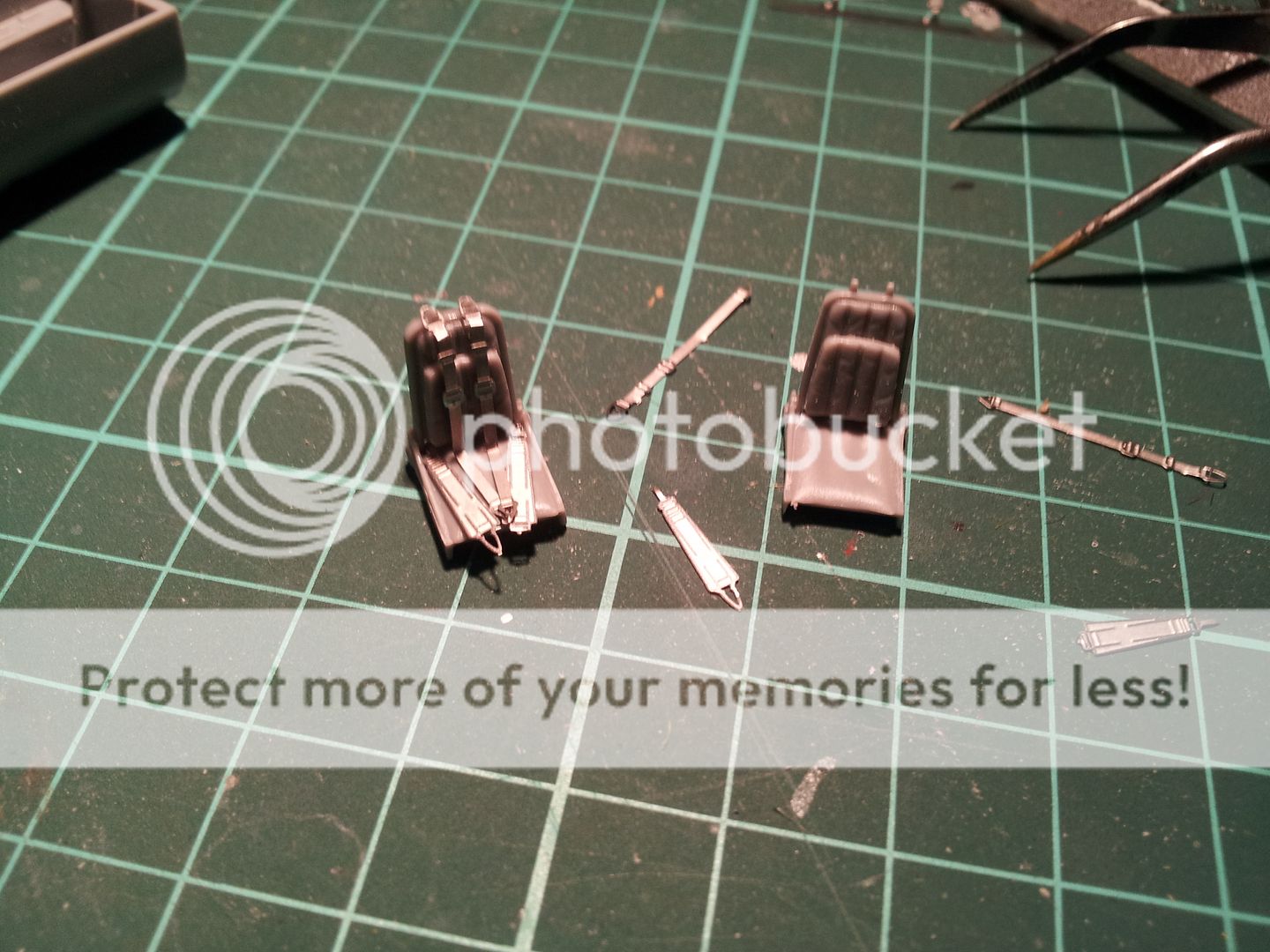

here we have the seats with that good old way too thick silver photo etch
it is much stiffer than the yellow pe but the detail is good

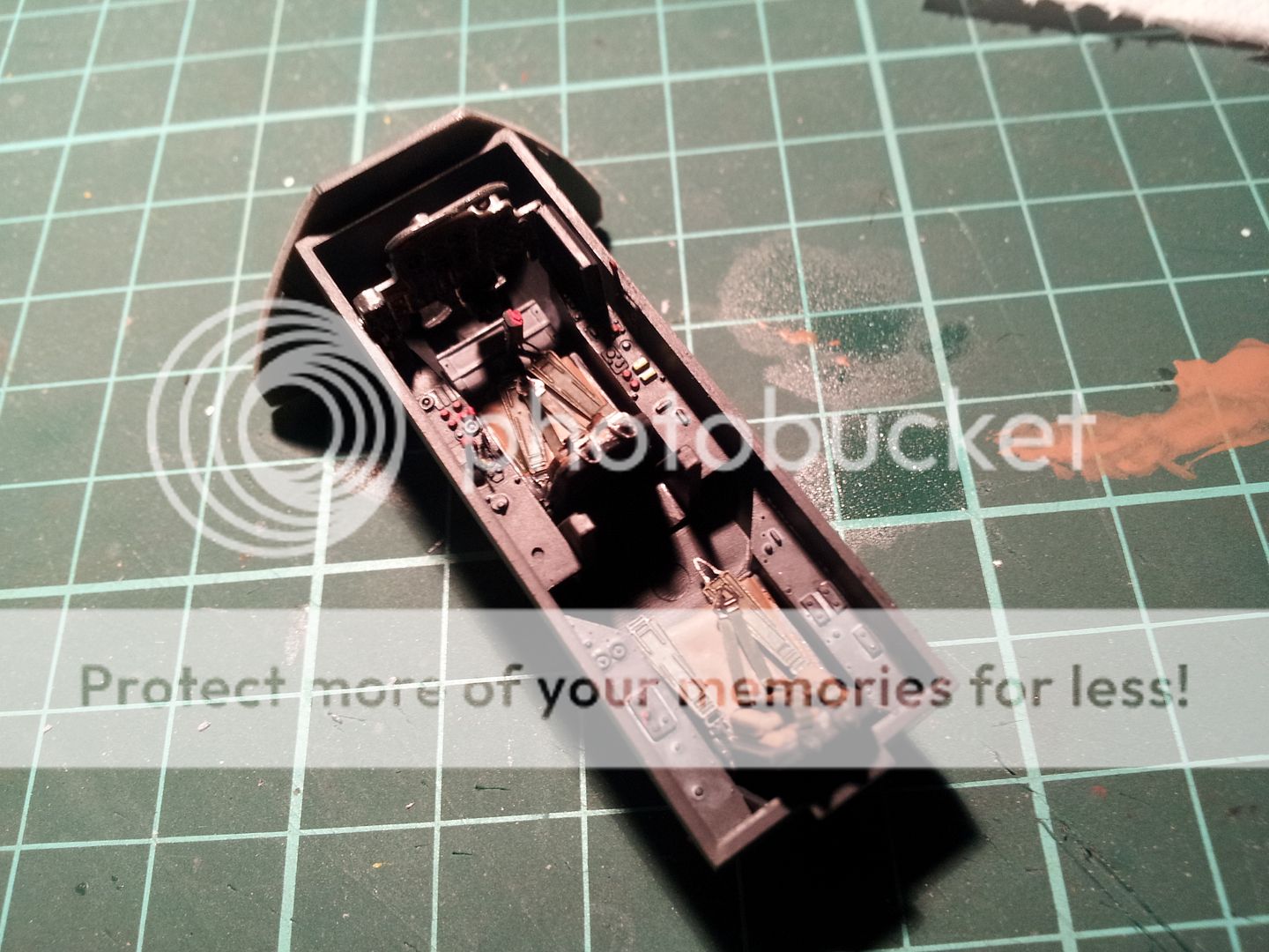

the cockpit after painting
it is painted with dark grey by Vallejo as a primary color this is from the modelair range
some parts where painted black like some of the control panels and the instrument panel
some buttons are painted with mr hobby #3-4 Yellow (can't remember the number)
and some Vallejo red from the model color range
then the instruments where dry brushed with some Vallejo gunmetal grey and some places around the cockpit had the same treatment to resemble worn spots
as for the wash because it is a dark interior i have chosen mig productions winter white wash
this really pops the instruments thanks to the contrast i makes

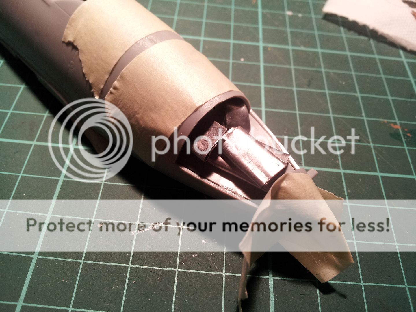

the instructions warn you about the fact that this is a tailsitter
they advice 20 grams of added weight
this is a bit more and it is sheet lead from a angling store
this is much cheaper then lead foil and it has the same properties but it is thicker
and the 2 fuselage halfs are glued together
i forgot to paint the topside of the interior :scratch::
this is no real problem but is makes painting a bit harder down the road
as i have to mask the interior to prevent spills on my finished cockpit

Great progress, the cockpit looks very nice. :th: :th:
With those PE levers, you can put a small blob of pva or thick ca on them to give a round handle. A bit late after you've already painted I know! Lol!

Nice progress with the cockpit, Mark....love those PE seatbelts.

i rounded them with some thick paint
that works aswell

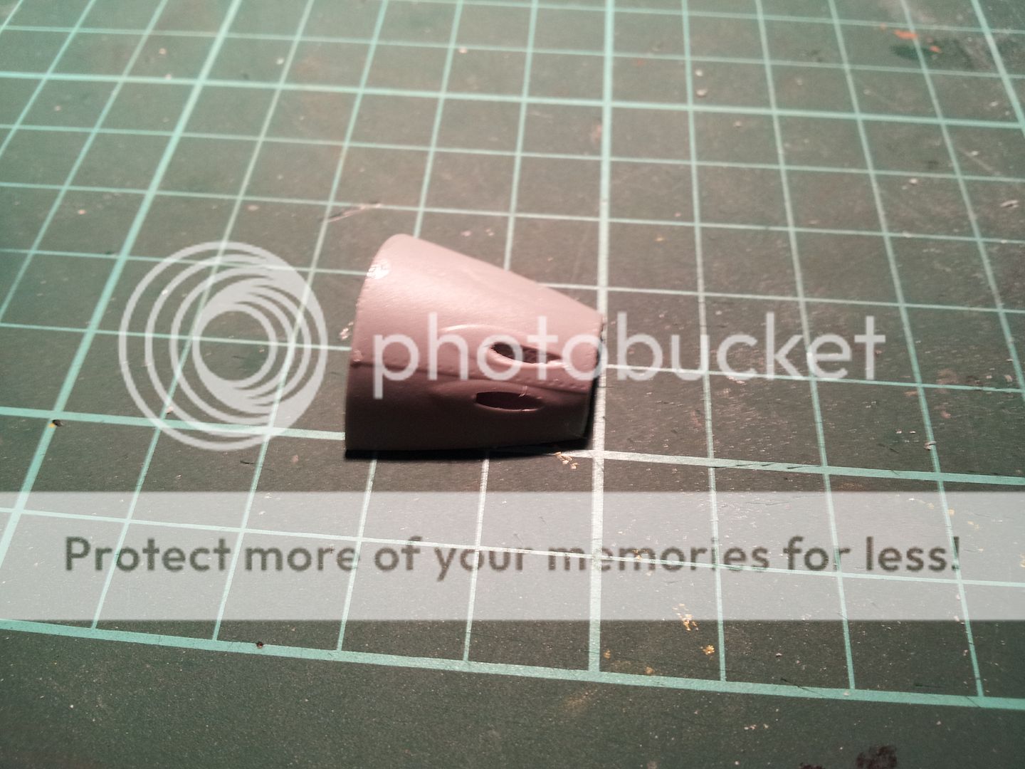

i started with the cowelling of the cannons
i did some research and most of the me 262 night fighters had 4 nose cannons just like the regular 262's
but the kit part is made with just 2 so i decided i would change this
to end up with this
here is the inside of the part and it is clear to see that this is a easy step
i just drilled them out with a small drill bit

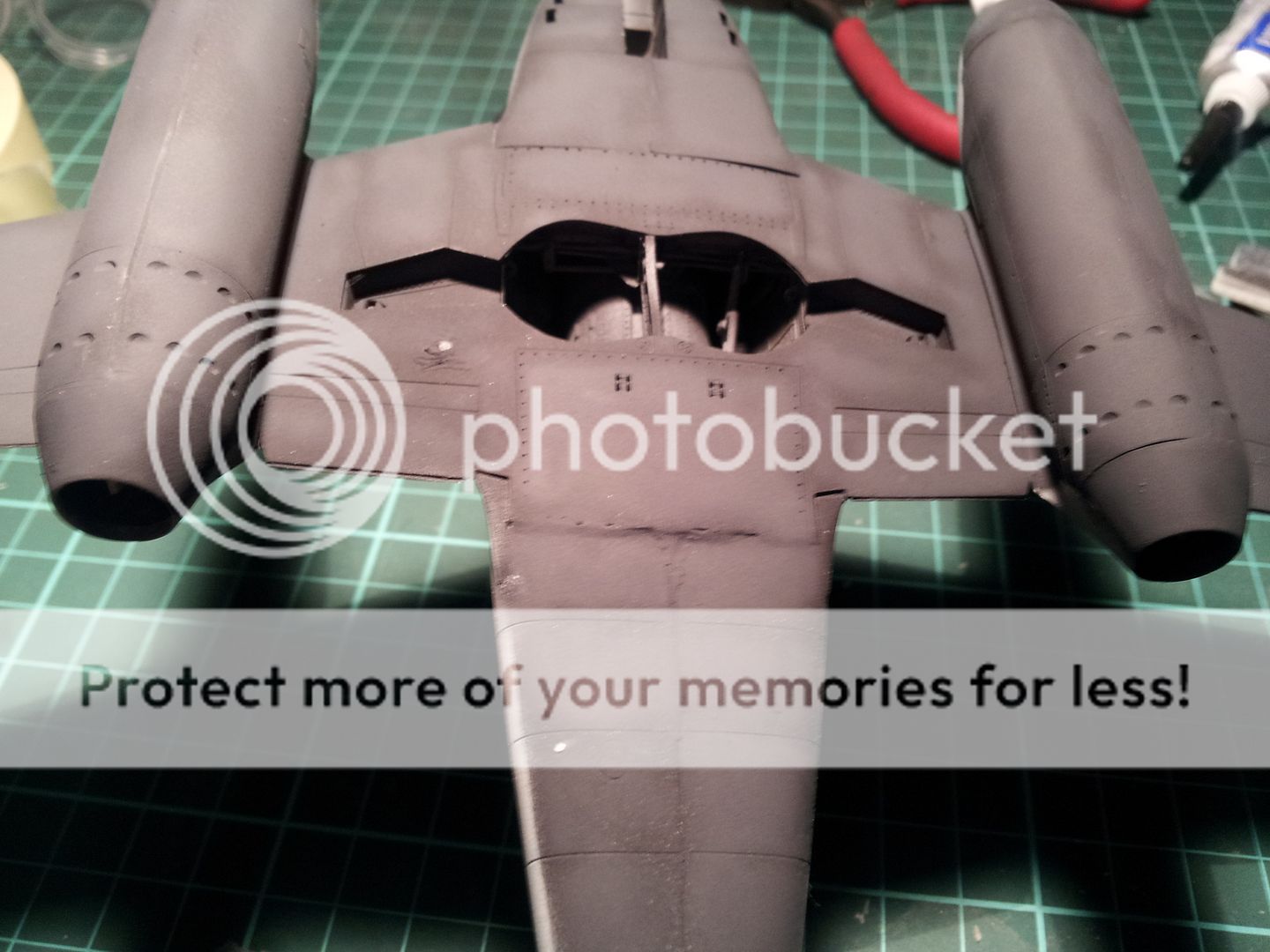

here you can see where i had to use putty but it is sanded already so it is ready for primer now
i will use ak grey primer for this
and the pieces that are painted seperate like the landing gear and drop tanks

Nice to see someone building the same kit as me. It's my first time working with pe and that silver photo etch is tough.
Re: Italeri 1:48 Me 262 B-1a/U1
robertw wrote:Nice to see someone building the same kit as me. It's my first time working with pe and that silver photo etch is tough.
yep the silver colored pe is tough and much more rigid then the yellow stuff
but the pe in this kit is thick to
except for the antenna's as i keep bumping in on them and then they bend again
but if you're making the same i should have a look to see what you are doing with it
