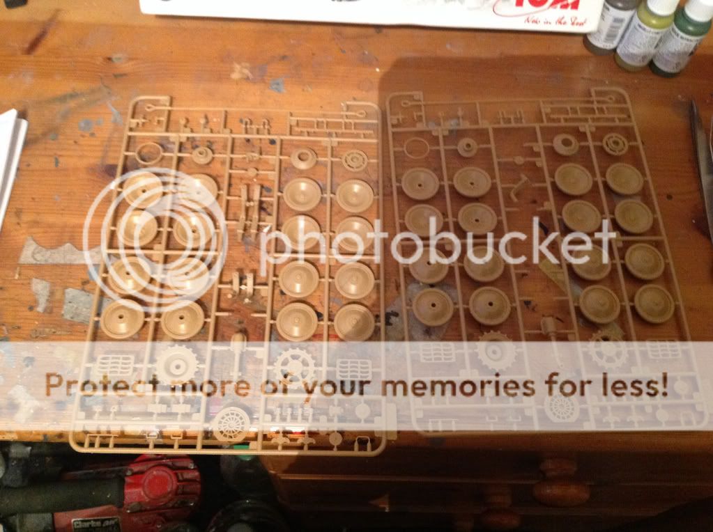

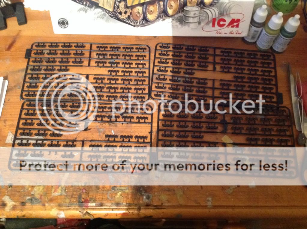

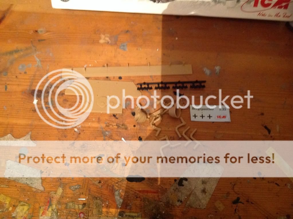

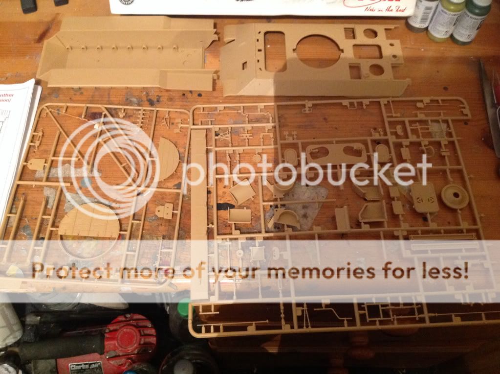

Sprue shots...
And all the bits that were loose in the box!!
Destructions...
All in all, looks like a nicely detailed kit, time will tell as far as fit goes.

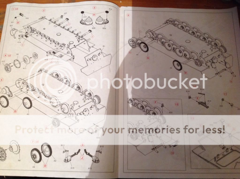

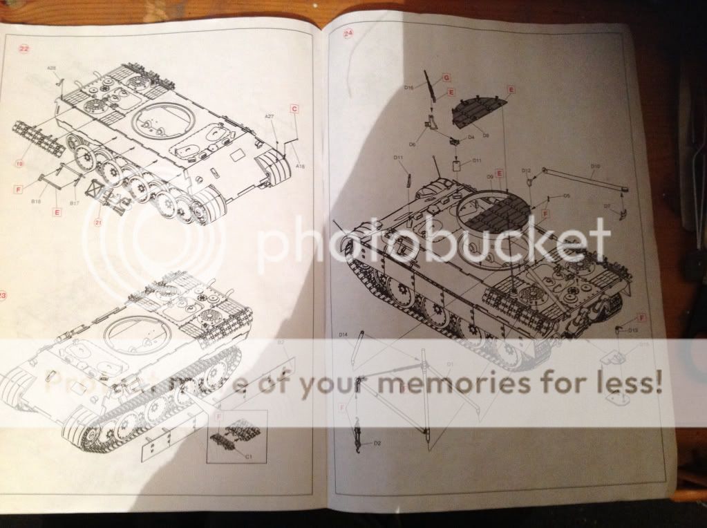

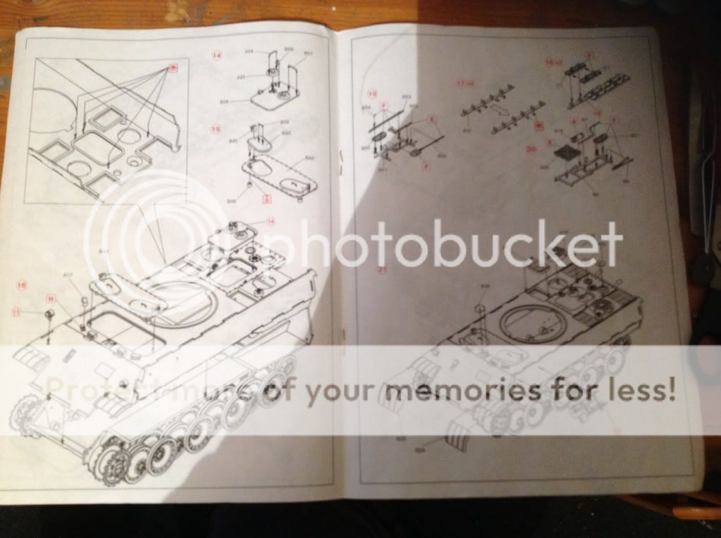

This is the second ICM kit I've built, and like the last one, this has a numbered parts map.... But the actual parts on the sprues aren't numbered! Lol! Oh well, shouldn't be a problem.
No interior provided, which is a shame, would've been nice to have those big hatches open. Might see if I've got anything I could stuff in there instead.

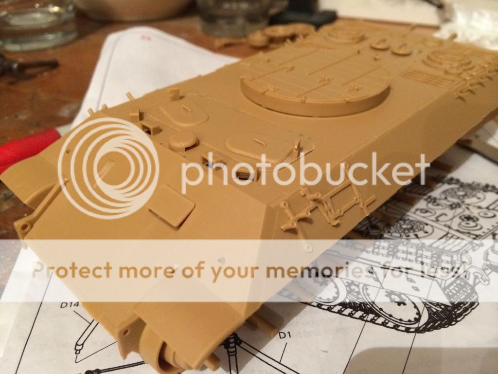

Lower hull completed, no major problems.
And upper hull (mostly) done.

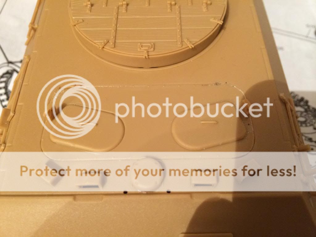

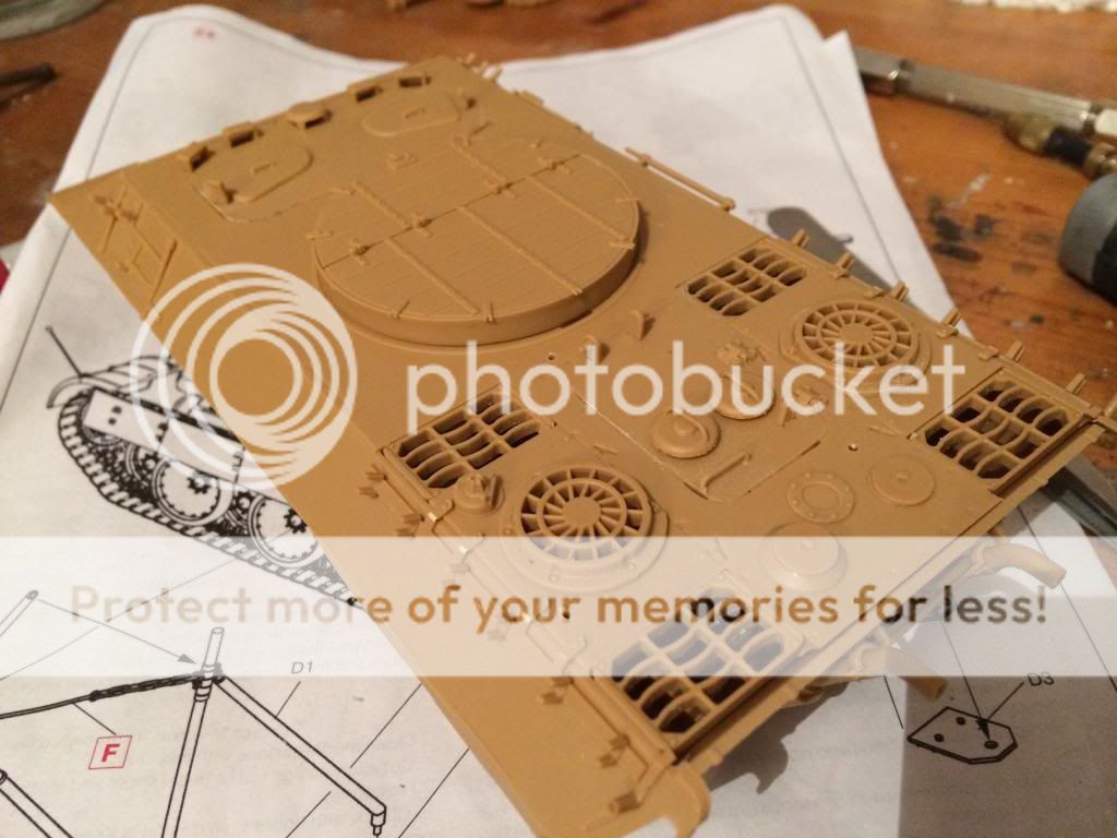

I did have a couple of problems, the front and rear deck panels didn't fit. So I started sanding them down. After test fitting I realised it was the radius of the panel corners that was too big. Rounded them off a bit and in they went. Bit of filler needed where I'd started sanding the edges, but not much.
Also needed to extend the notch on one side of the lower hull to enable a good fit of upper hull.
Thought I'd dry fit the tracks next. Oops! The track links are really brittle. Some of them snapped together fine. I thought 'great, workable tracks, no glue needed!' Then they started exploding on me, bits of plastic all over the place!
Not wanting to lose my rag, I've sacked this set and ordered some AM ones. £31 for friul tracks! Don't think so! Got some trumpeter ones instead.

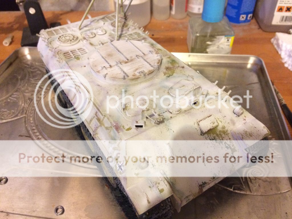

Re: Chiefs ICM 1/35 Bergepanther (early version)
Hi guys, thanks for the comments :th: :th:

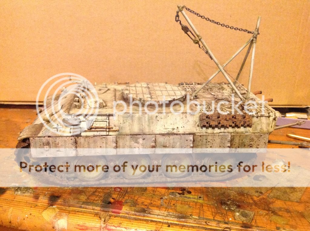

Made a little more progress on this, not much though!

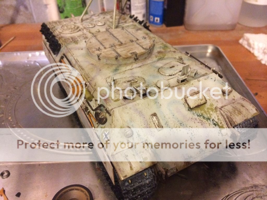

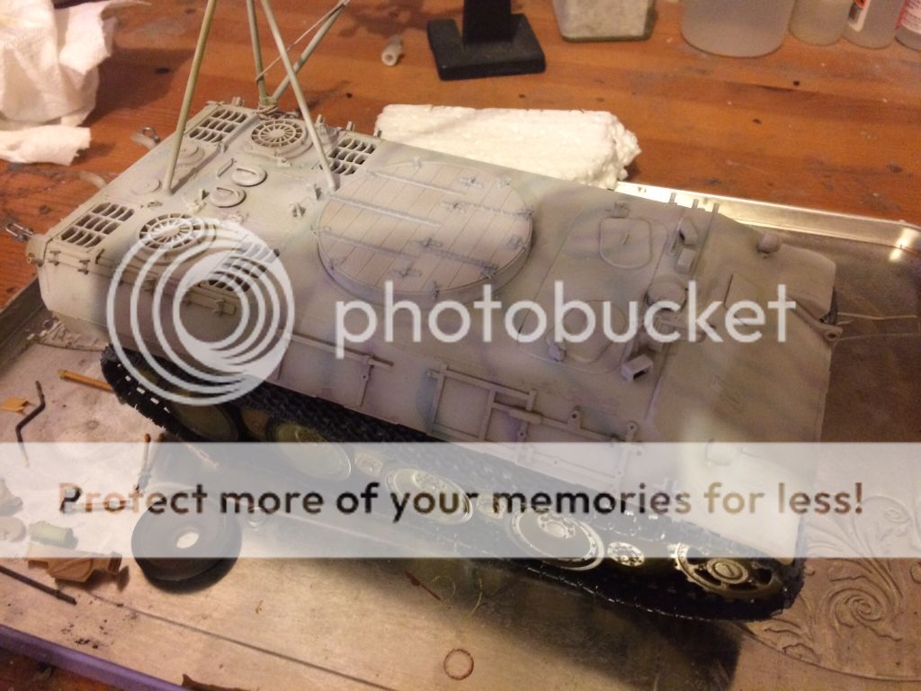

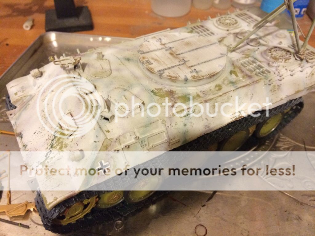

Gave it a light winter coat, preceded by a layer of worn effects.
After applying a little water I started on the chipping. I didn't want it too heavy, but I made it more prominent on the left side, where the crew would be working most.
Next up was attaching the breakdown kit etc. and painting details.
Followed by a dark brown wash.
And that's where I am for now. More weathering to do next!
Thanks for looking fellas! :cheers2: :cheers2:

Awesome! May I ask what you used for the winter coat? Thanks! :cheers2:
AchtungPanzer
Posts: 2299
Location: Cracow PL
Post by AchtungPanzer »
:crazy: its all :cheers2:
felisbarcinonensis wrote:Awesome! May I ask what you used for the winter coat? Thanks! :cheers2:
Cheers dude! tamiya xf1, neat, for the winter wash. :th:

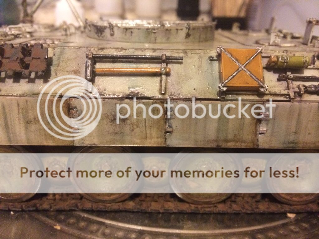

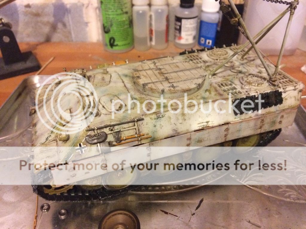

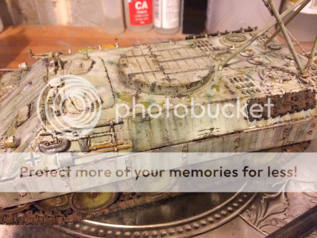

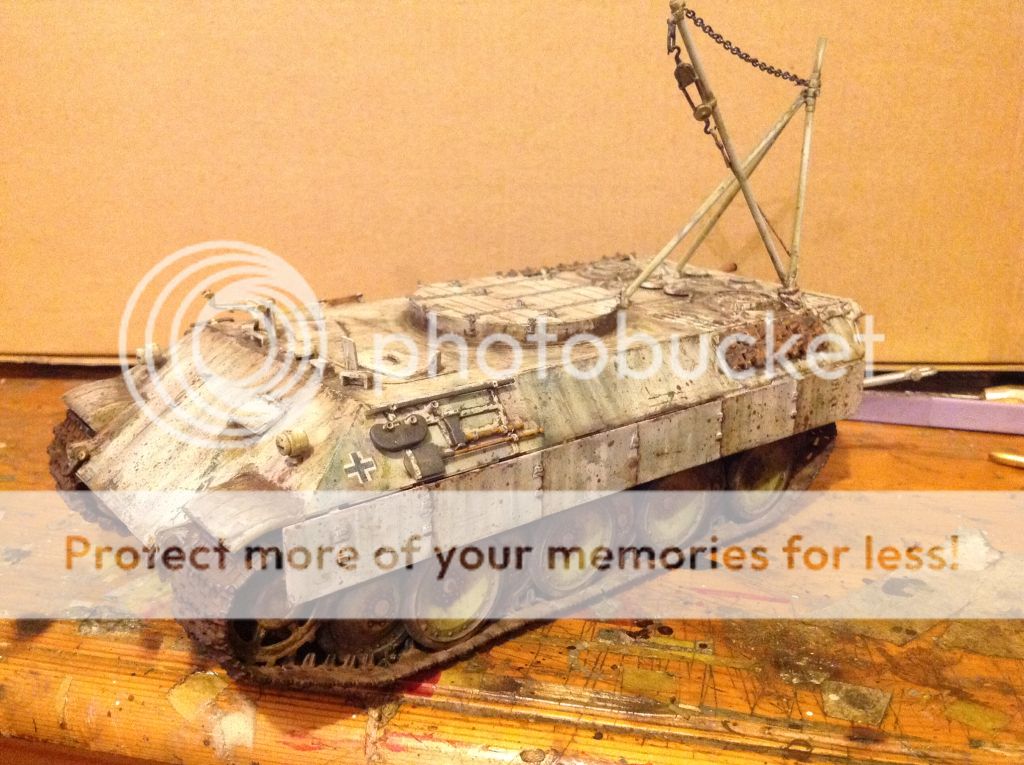

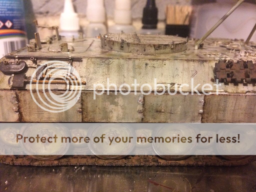

Hey fellas! :th: thanks for the kind comments. Finished this a few days ago, only just getting round to posting it though!
You'll have to take this with a punch of salt as I can't really remember which pics go with which step! Lol :scratch::
If memory serves.....
After the dark brown wash was sealed in, I did some chipping with a small brush and dark grey paint. I don't know how you guys manage it! I just can't get it to look right :wall: practice, practice, practice, I suppose! :scratch::
I think this is showing some streaking...
But this could be as well?!
Streaks were done with enamel washes.
Not sure what I've done here, possibly some highlights with white oils?
Or it could be that I've added some dirt pigments in the nooks and crannies.
And I think this is it finished...
Final pics in the reveal section :banana: :banana: As ever, thanks for checking in guys! :cheers2: :cheers2:
