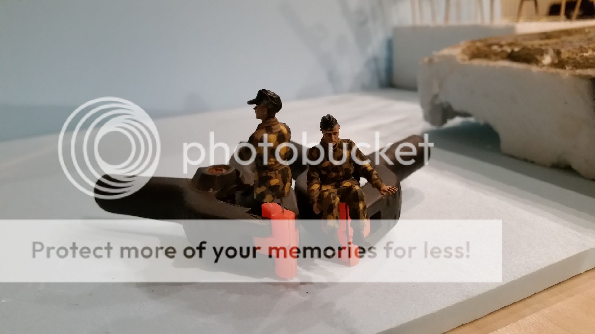

step 9
i then used english uniform to make a basecolor for the hair
step 10
then the hair was drybrushed in various thicknesses to get color variation between the figures
and now the heads are finished

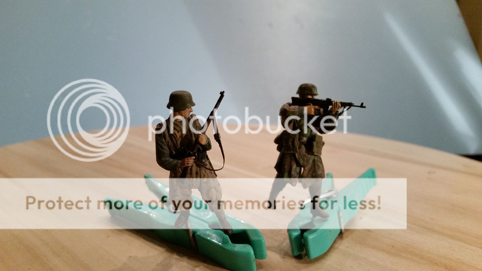

i do want to point out that the figure here is a 1:16 verlinden tank commander wich i will use in my big tiger build
but because my camera (phone) looses focus when zooming i have chosen to use these pictures as they are of better quality
altough the 1:35 scale figures had the same treatment as the bigger ones did ,so no difference there

step 1
the dark green and field grey where mixed in a 2:1 ratio to make up the base color
i use this mix as i find the german uniform color from vallejo too bright
step 2
the german uniform color was used though
i use it as the highlight color for the uniforms and i dry brush it on the figures
it is hard to see but the sleaves show the results the best
step 3

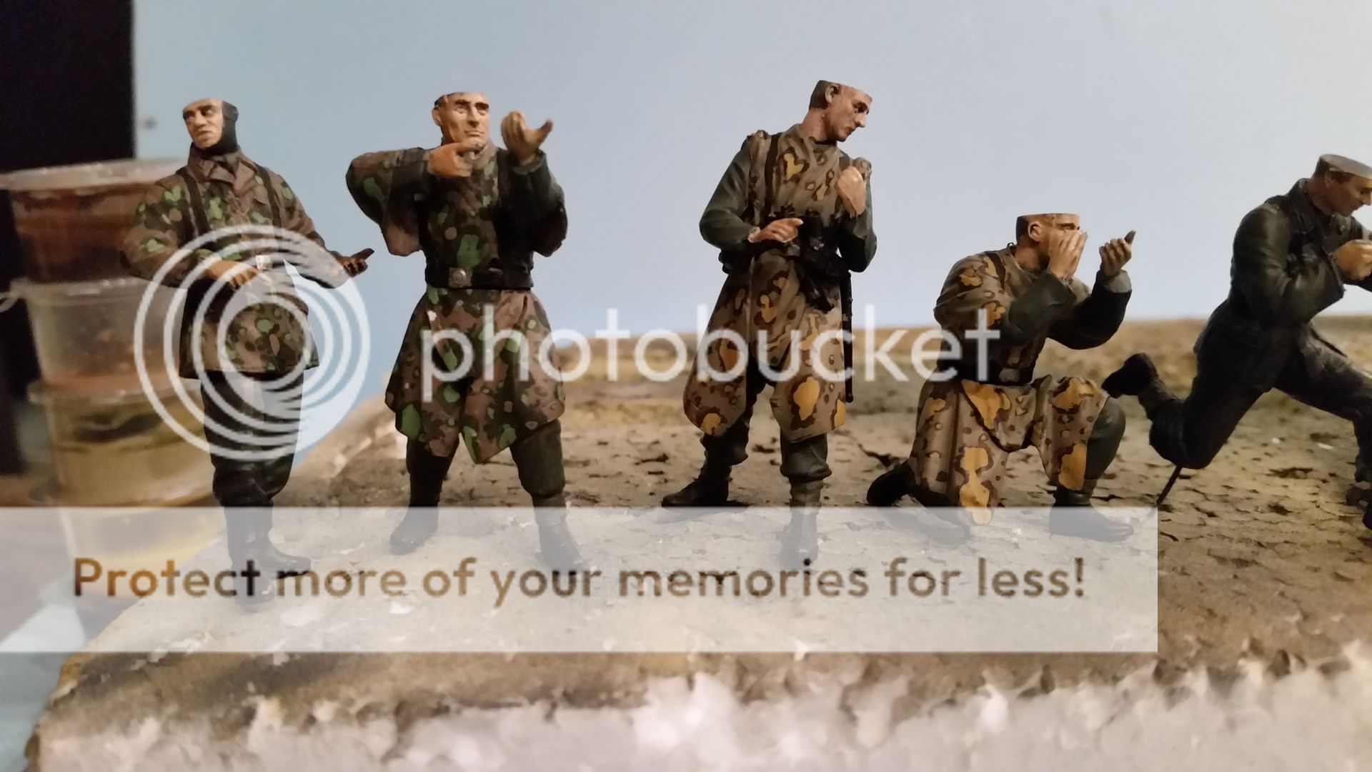

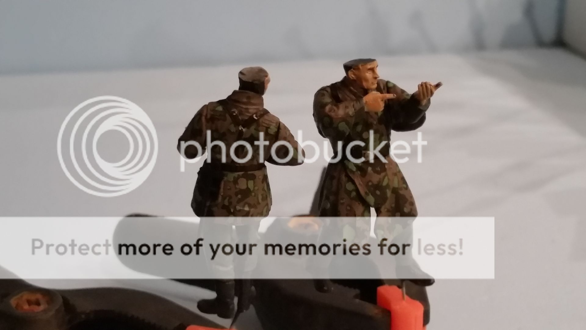

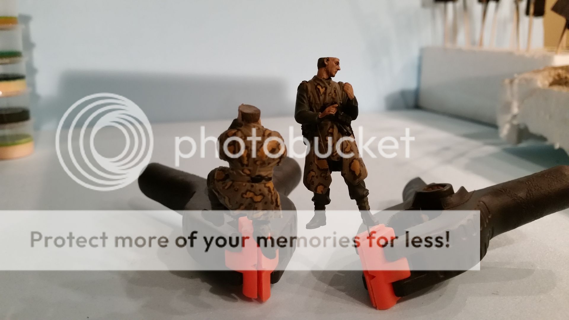

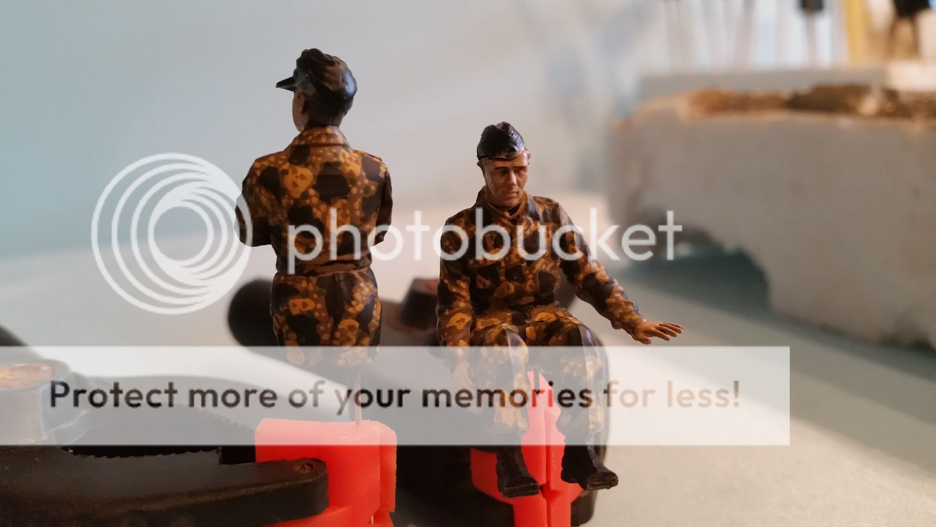

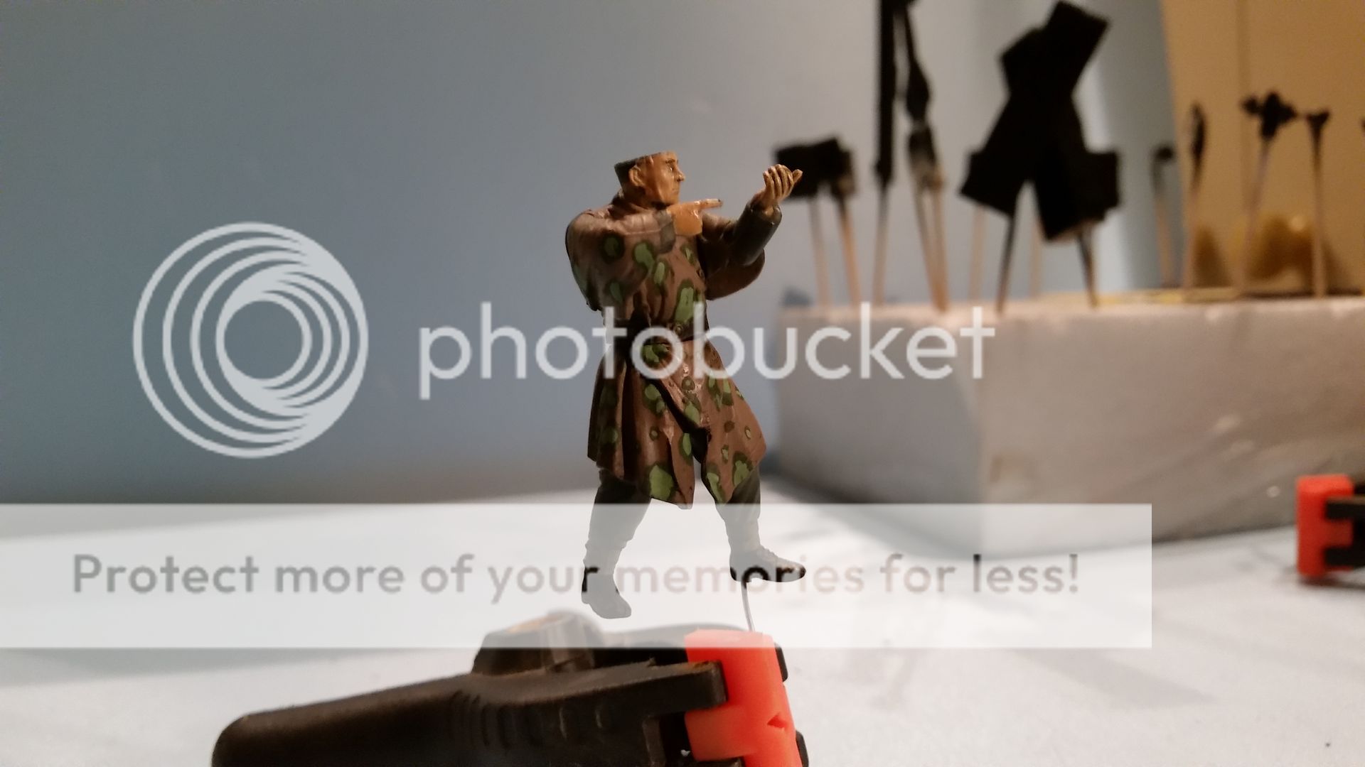

plane tree pattern no. 5
paints
german camouflage pale brown
flat brown
military green
sunny skin tone
ss camouflage bright green
black
color mixes
base: german camo pale brown and flat brown in a 9:1 ratio
medium green : military green
light green : sunny skin tone , ss camo bright green and military green in a 2:3:1 ratio
dark green : military green and black in a 2:1 ratio
side note :
if you look at most of the WWII german camo scheme's they look fairly busy but you van break them down into steps
during the build up of these scheme's it can look like a ocean with the base color as the water and the camo colors as islands and land masses
this is also the way it is explained in the book : modelling Waffen SS figures by Calvin Tan (Osprey)
this is the book i use for reference and in my opinion is a good book with a lot of pictures of the way he builds up his figures
but unlike me and most of the modellers out there ,he is a master builder who has won prizes ,been published and makes master figures for modelling manufacturers
but i will use some of the terms he used in the book to make it all a bit easier to understand (like i know what i'm doing :shock: )
step 1
the base color was applied on the camo smock
step 2
patches of the medium green where applied
these are the islands (smaller dots) and the land masses (big patches)
step 3
most of the islands where filled in with the light green mix but not all some must remain medium green
the land masses however are all filled with the light green
step 4
pathes of dark green are added
these should have a very random shape without any straight lines but the best way is to make them look like a string of dots
this color needs no small dots scattered around
i did add a number of small dots of medium green filled with the light green as i thought i didn't have enough of those and there was too much of the brown base visible
but after this step it is done for the time being
this is also one of the most common camo scheme's used by the SS
and is pretty similar to the oak leaf (spring) pattern but this is more elaborate

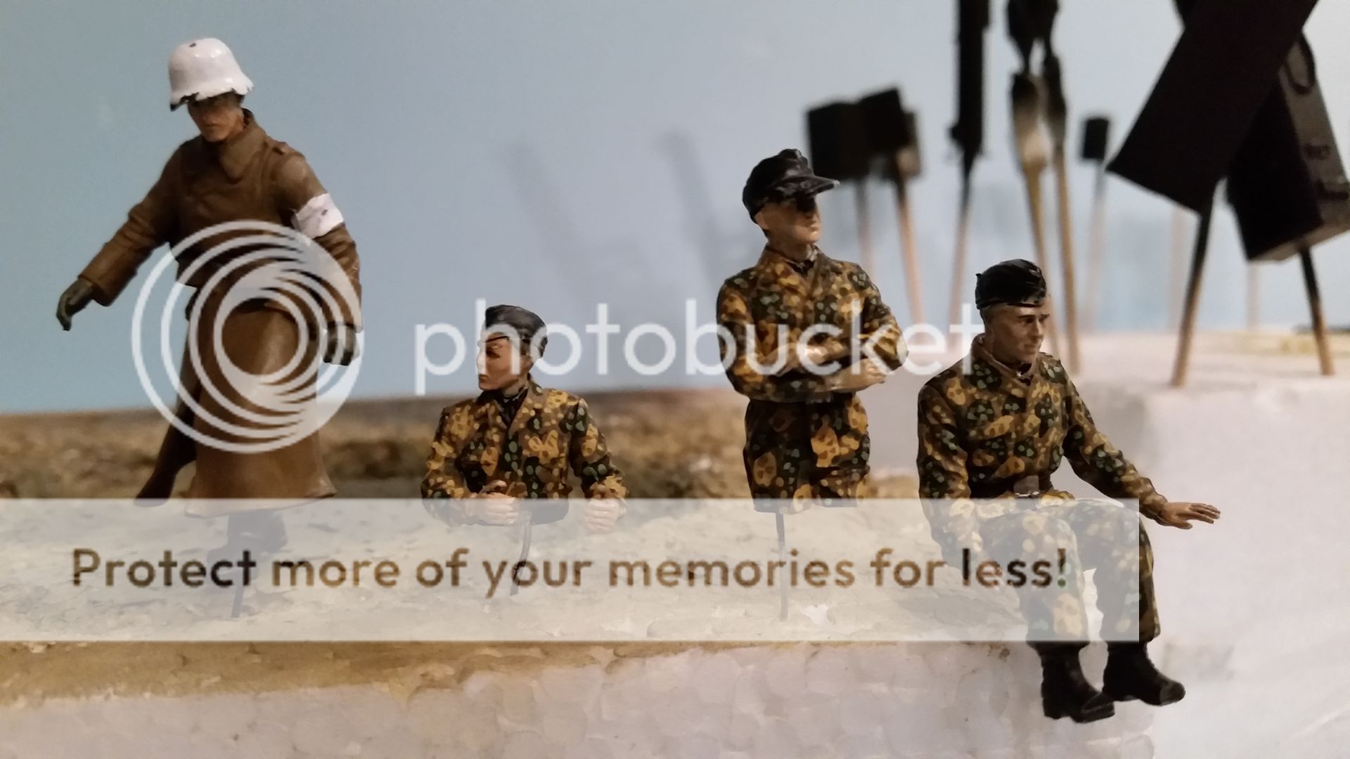

Oak leaf pattern Autumn
paints needed :
german camouflage beige
english uniform
german camouflage black brown
flat brown
orange brown
german camouflage orange ocre
paints mixes
base : german camo beige , english uniform and german camo black brown in a 6:1:1 ratio
medium brown a : german camo black brown , flat brown and orange brown in a 1:3:2 ratio
medium brown b : german camo pale brown and german camo black brown in a 3:1 ratio
dark brown : german camo black brown
ocre yellow : german camo orange ocre and orange brown in a 6:1 ratio
step 1
and the first of the camo colors was applied aswell
the color is the dark brown
this will serve as the base for the ocre patches of the next step
step 2
the dark brown patches where filled in with the ocre
this is done to the smaller brown dots aswell
step 3
barely visible but there where dots of the 2 medium browns added to the borders of the dark brown
there are some dots of these colors aswell and these where filled in with the base color but in the same way as the ocre was applied to the dark brown
and that completes this scheme , it is not very hard to do and looks a whole lot different from all the other schemes of the time
it was used during the autumn season but at the end of the war soldiers used any kind of camo they could get so it happened that the allied forces came across solier wearing this camo in winter and spring
because it was used on thicker clothing that was used in the colder months it was a very uncommon sight in the summer

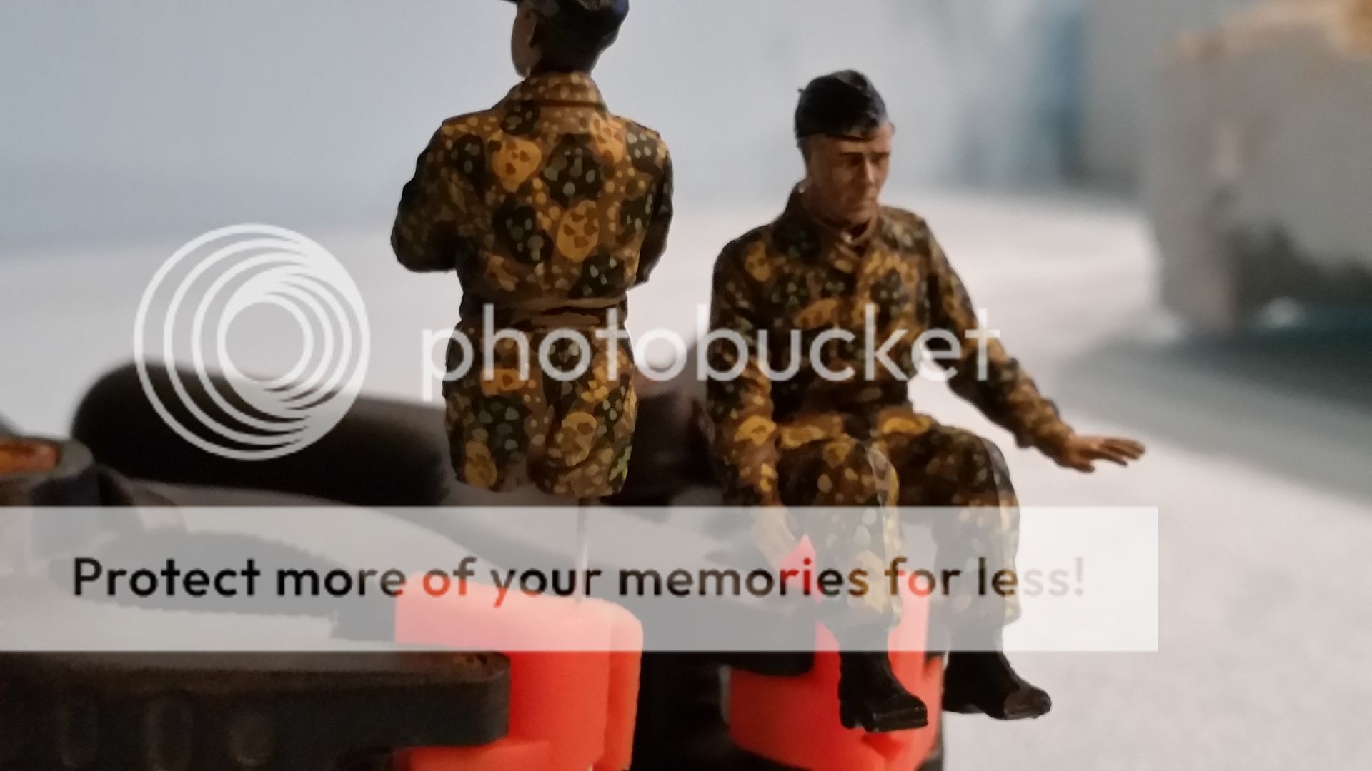

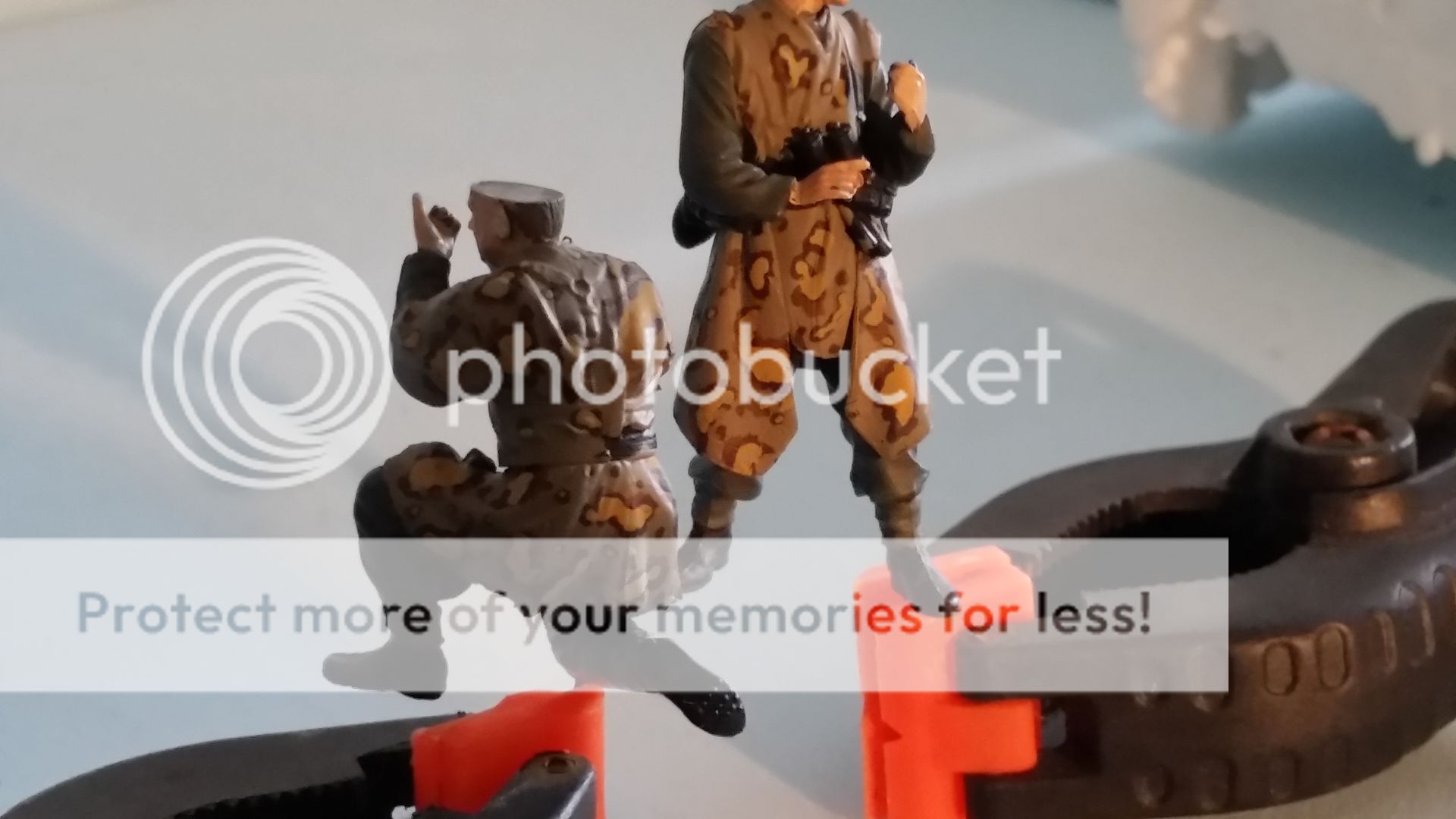

pea/dot pattern
paints
us field drab
english uniform
reflective green
sunny skin tone
military green
black
yellow ocre
according to the book you would also need to make the mix for the ocre/sand
this is made up from sunny skin tone , salmon rose and english uniform these are mixed in a 3:4:1 ratio
but after mixing it i found that it looks nowhere near the color in the book
so i picked yellow ocre to replace this mix
wich looks a lot better in my opinion
paint mixes
base color : us field drab , english uniform and german camo black brown in a 5:1:1 ratio
medium green : reflective green
light green : sunny skin tone , ss camo bright green and military green in a 3:5:1 ratio
sand: in this case yellow ocre
step 1
the base color is applied
step 2
the dark green patches are applied
there are only larger patches and no dots in this color
step 3
the ocre/sand patches are applied
they are mostly placed between 2 or 3 dark green patches
step 4
the ocre dots are applied
the are only placed on the areas with the base color
a bit closer up to show the placement of the dots
not all the room on the basecolor should be filled with the dots but some space should be reserved for the green dots later on
step 5
the ocre patches where given dots in the basecolor
step 6
the dark green patches received dots of the base color and the light green
the medium green is used on the basecolor where there is space left inbetween the ocre dots
and that concludes this scheme
this is used by SS tank crews for the most part
there are other units that received it though

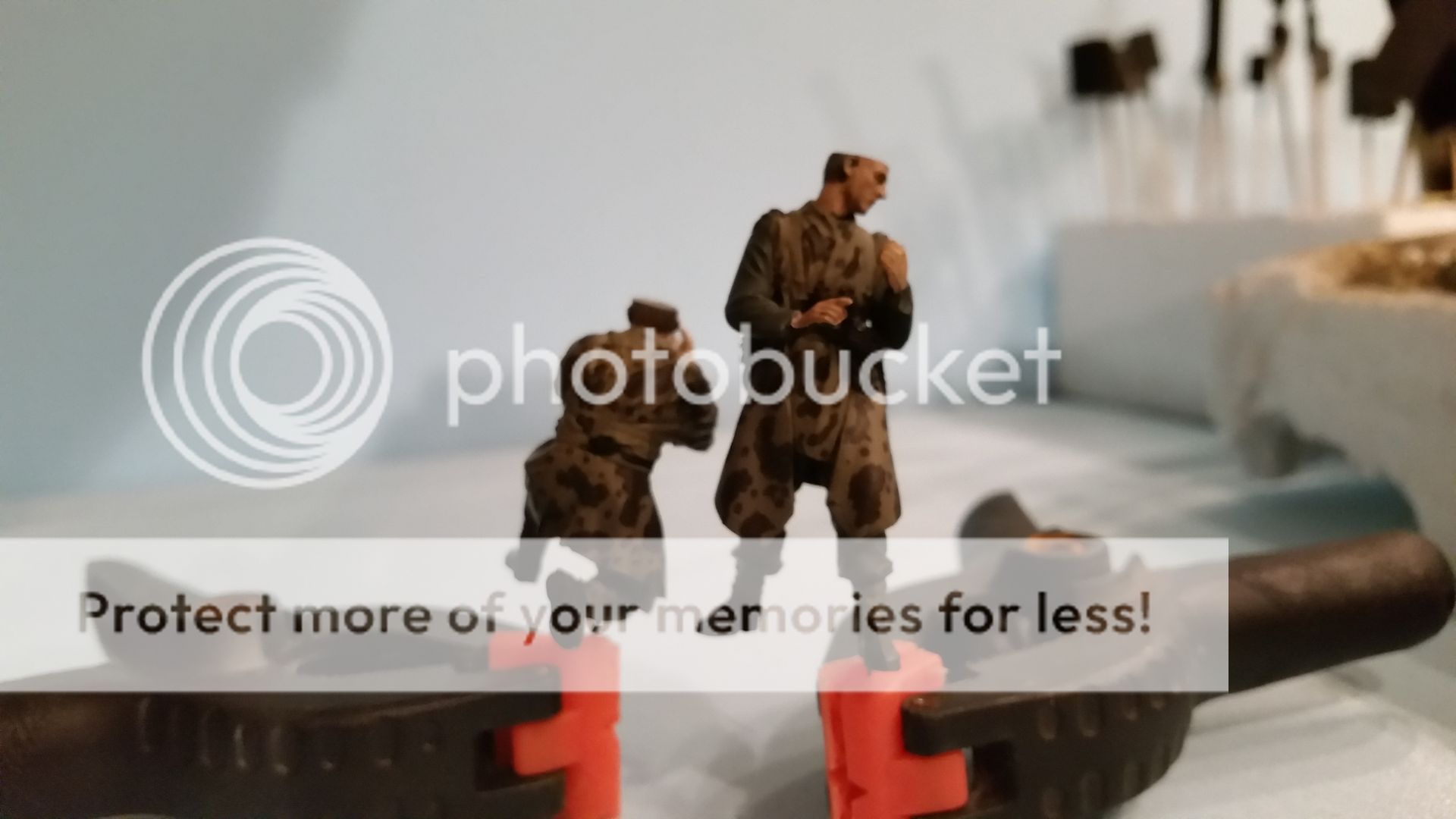

as you can see this is by far the most elaborate and intence scheme that was used during the war
it has taken a lot of time to get it done but all in all i'm happy with how all the uniforms turned out
the medic
this is a more simple figure
his pants are p[ainted just like the wehrmacht figures
the great coat is painted with english uniform and later dry brushed with us olive drab
the helmet is painted in german grey
this was dotted with a bit of maskol and then painted white along with the armband
and then the maskol was rubbed off
i still have to paint all the gear and do some details but the hardest part is done
so here are the painted figures
i hope you find these painting how to thingies useful and thanks for dropping by
so let me know what you think and untill next time
cheers Mark

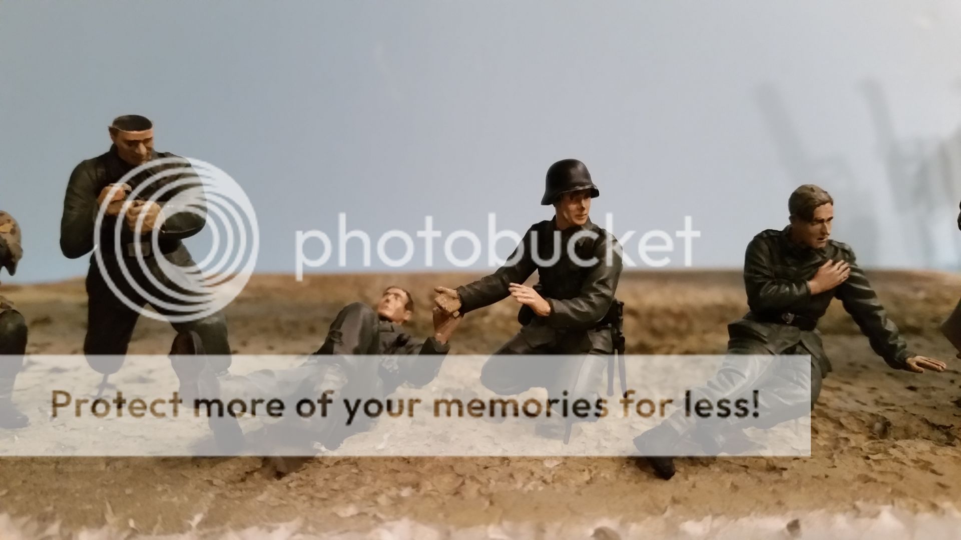

Thanks
I am pretty happy with the result
I had planned one more figure , a paratrooper but decided he would not add anything but a lot of work
And make the dio even more crowded so he was trown back in yhe figure box for now
Cheers Mark

Re: Cyber hobby 1:35 Panther ausfurung G late production
Wow! The camo on those figures is crazy! You must be using a strong magnifying glass for that? :thumb1: :thumb1:
martin57
Posts: 897
Post by martin57 »
:jd: i see what you mean about being time consuming , but well worth it great job :thumb1:
UKguyInUSA wrote:Wow! The camo on those figures is crazy! You must be using a strong magnifying glass for that? :thumb1: :thumb1:
Thank you
And i don't use any magnifying glass or the "geek goggles"
I do have a small magnifying glass but i only use that for photo etch work
My eyes are pretty good (i think as i don't need glasses) so i don't use help while painting
martin57 wrote::jd: i see what you mean about being time consuming , but well worth it great job :thumb1:
Thanks Martin
Yeah they took some time
The tank crew figures take up most of the time with all those dots
But the 1:35 are pretty fast comparred to the 120mm/1:16 crew i painted for the big tiger that i'm building in the buddy build
they have an estimated 350 to 400 dots on a full figure wich in hindsight is kind of outragous
but i'm glad you like them so far
As for now i am gathering and adding the equipment so thw figures can be finished
cheers Mark

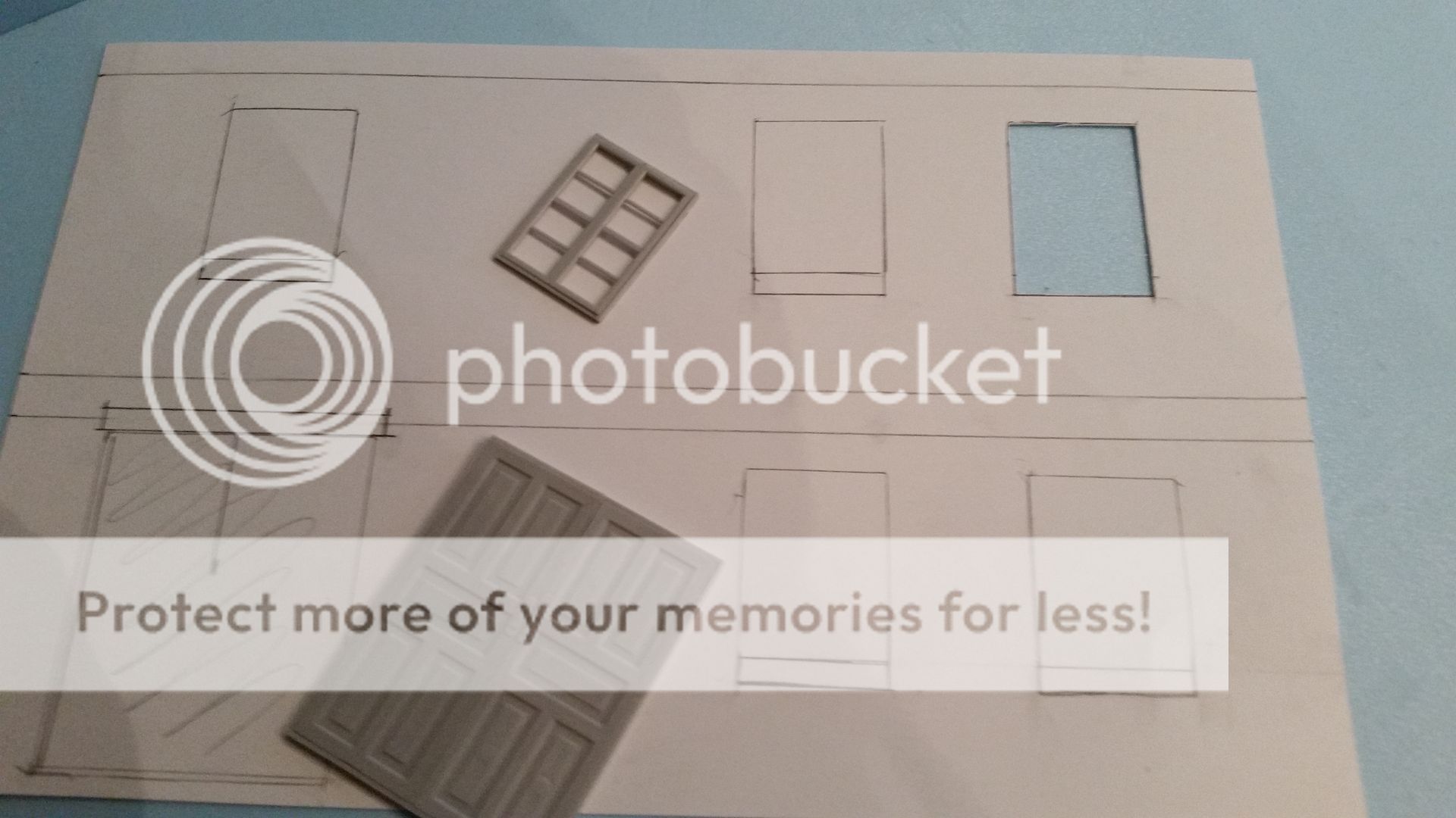

as i needed the messurement of things like doors and windows , i started with that

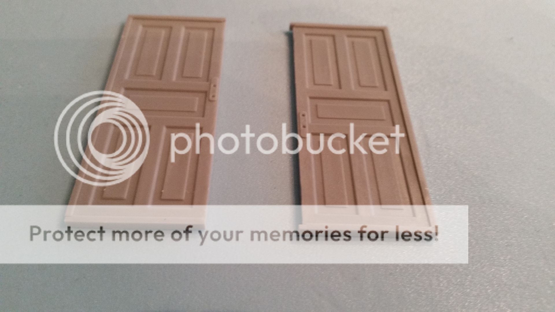

these doors are from various miniart kits but can be found in the house and street accesories kits wich are basicly the same sprues that come with their house kits
i decided i would glue 2 doors together for the main entrance of my appartment building
i started the construction with the foam base and a smaller base for the building
the big sheet is 12mm thick but that serves no real purpose
the smaller sheet is 5mm thick ,this will be the same as the sidewalk so later on everything will be level
after i made the doors and a window ,i started the drawing process
because the foam gets marks in it when i draw on it directly i used the construction paper
so all the main features are included
keep in mind that things like window sills have to be included but i will make these from pices of foam later

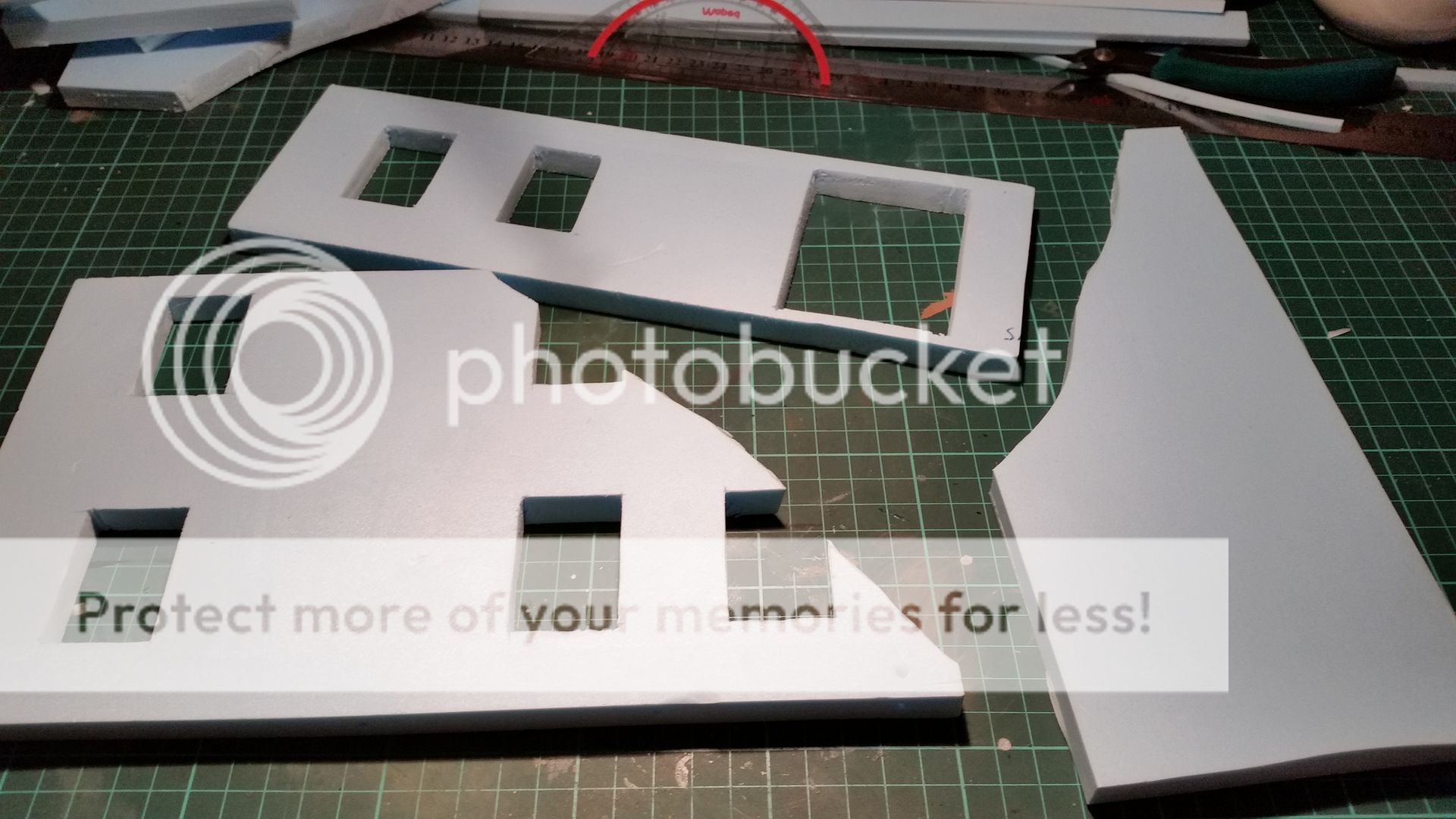

the straight edge was used as a guide during the cutting
also make sure that you don't cut the foam in 1 go but do this in 5 or 6 cuts
otherwise the blade could bend and you won't have a straight cut

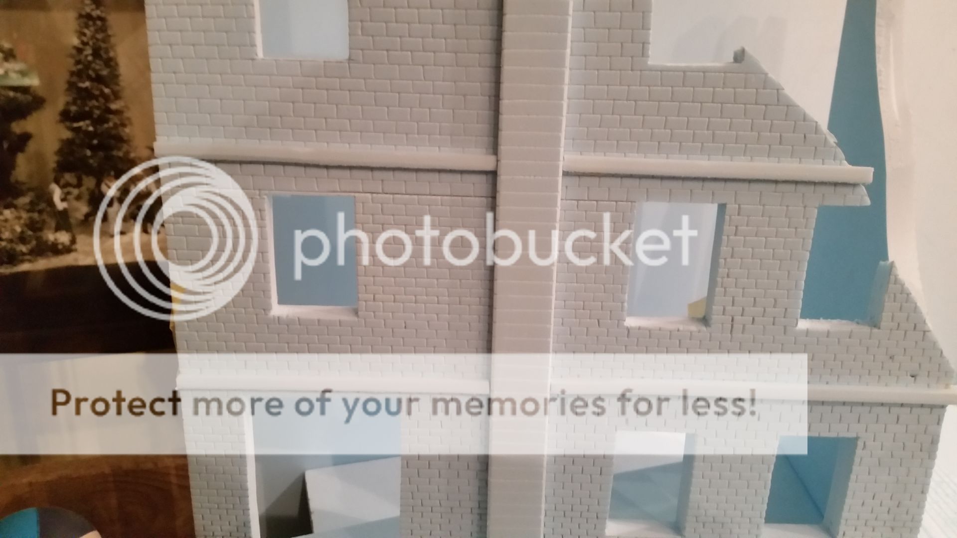

so here are the basic parts for the building
the front was going to be 1 big piece but i had to remove the second floor

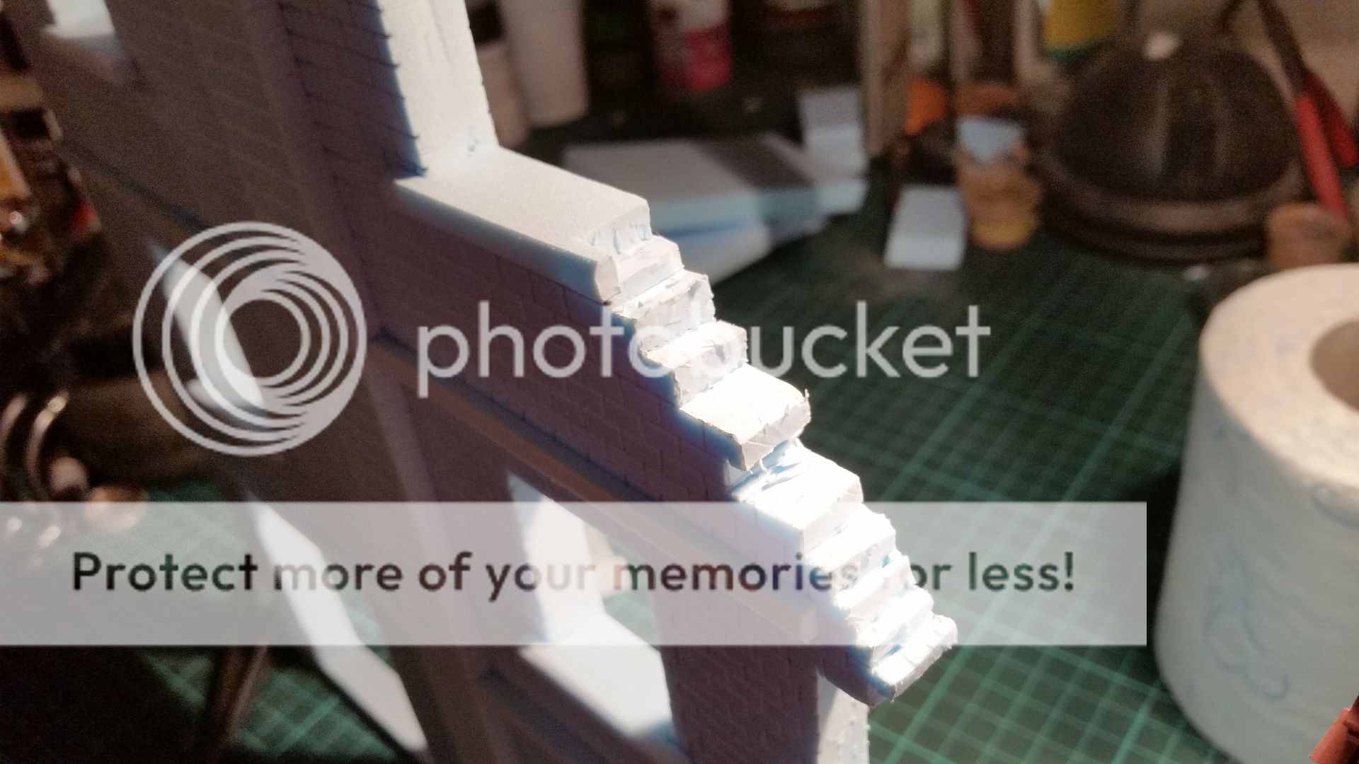

i then started to carve/scribe the bricks
according to my book a brick should messure about 7x2x3mm (lenghtxheightxwidth)
but i did most lines free hand so they are not all the right size :wall:
this shows how i build up the brick work
i start with the horizontal lines and the vertical lines will be scribed in after this

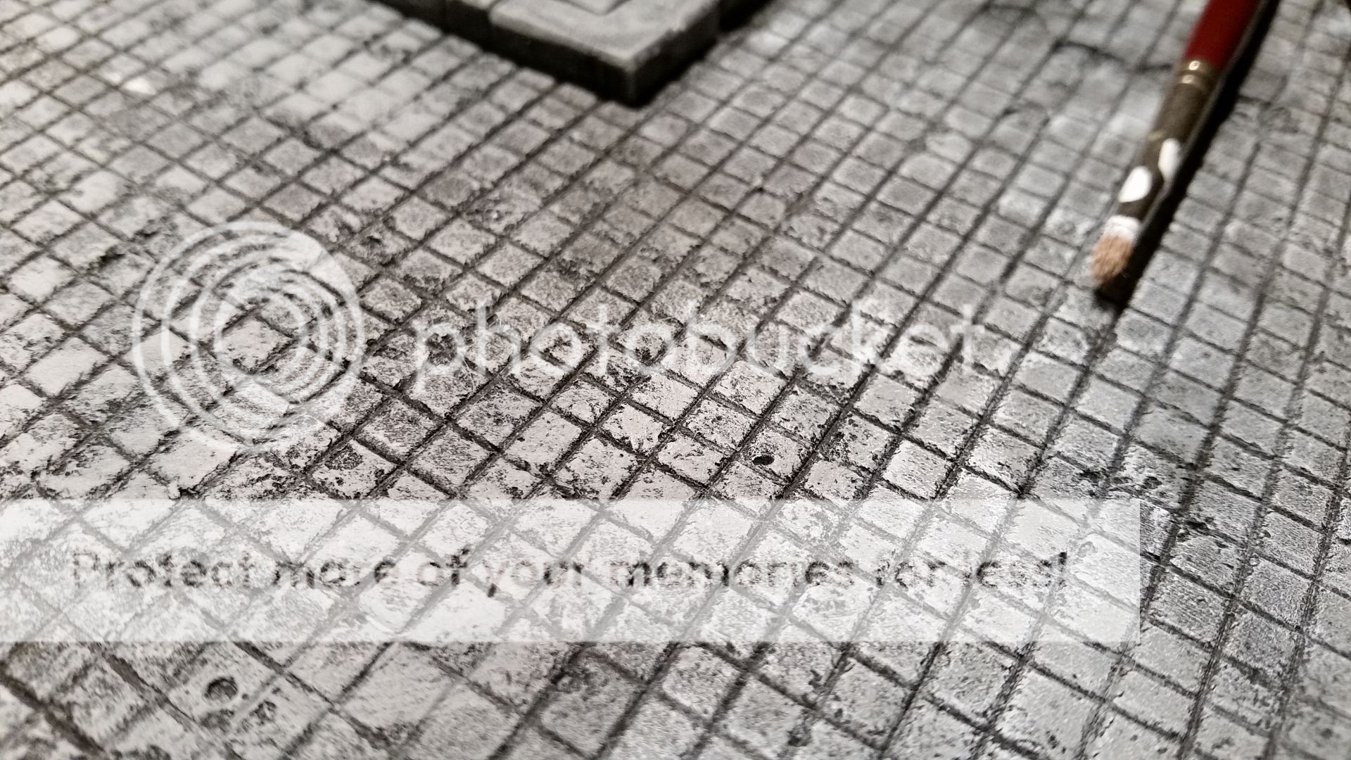

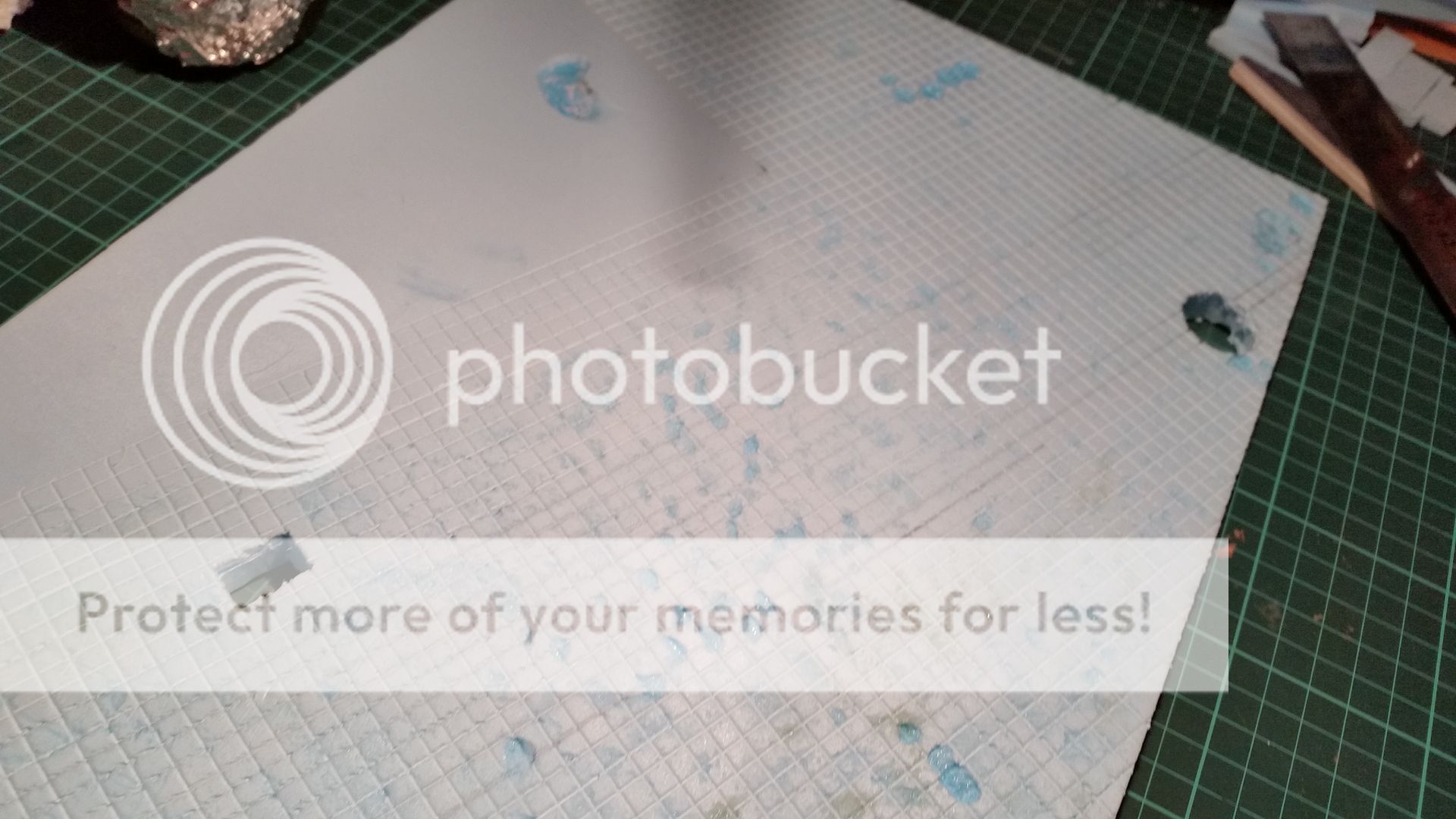

i then returned to the street to make the holes for the sewer lid and the drain
then the street received it's lines
and then i have a basic cobble stone outline
i then used thinner (diy store) to get a worn look
this is acheived because the thinner will disolve some of the foam
and ofcourse i had a few spots where i had too much thinner on the brush :wall: for the second time
but all is not lost as the building is a part destroyed on there will be rubble and dust so that can be used to cover up these boo boo's
this is how it should look

i added a big strip to the front
this was scribed to make it look like large stone blocks that would be used for decoration on the building
the same goes for the narrow strips that where place at the bottom of every floor

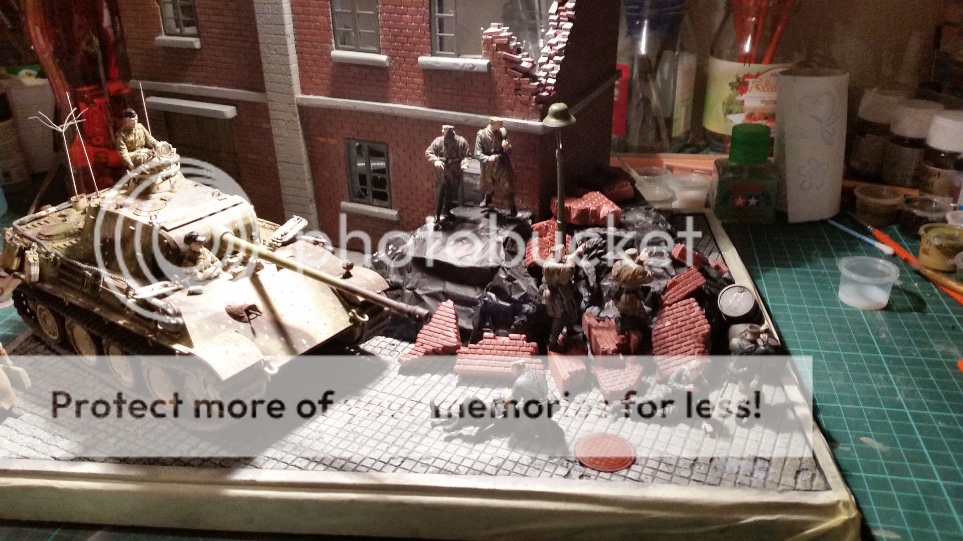

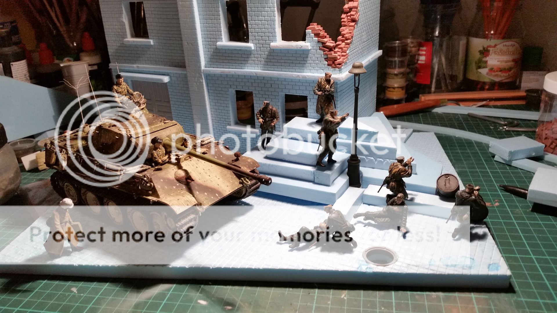

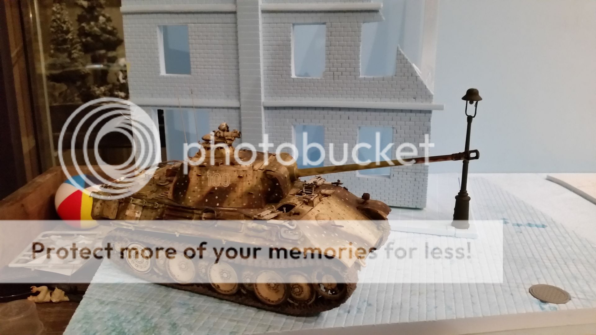

and now some sneak peaks
the street light comes from a plusmodel kit (streetlight set #1 or #2)
the drain and sewercap are from mini art's street assesories kit
a corner view
the building is not yet flush to the ground as there is tpe underneath the walls to keep them together
a look as how big the panther would lok in front of the building
it is on the same place it will go when all is finished

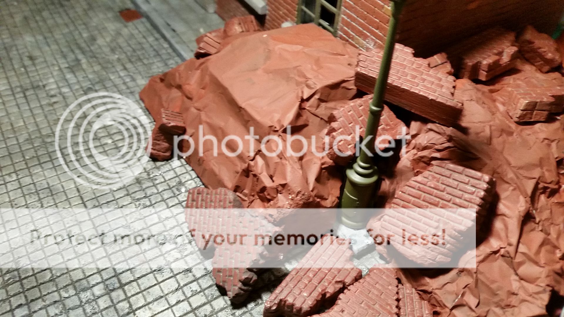

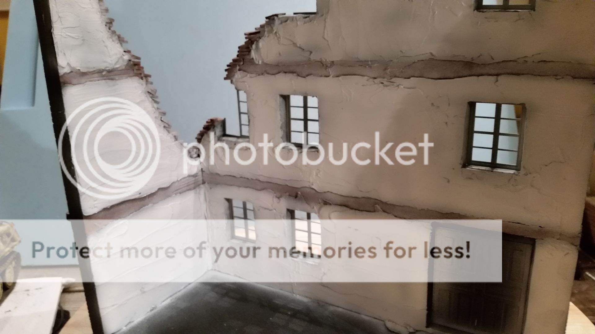

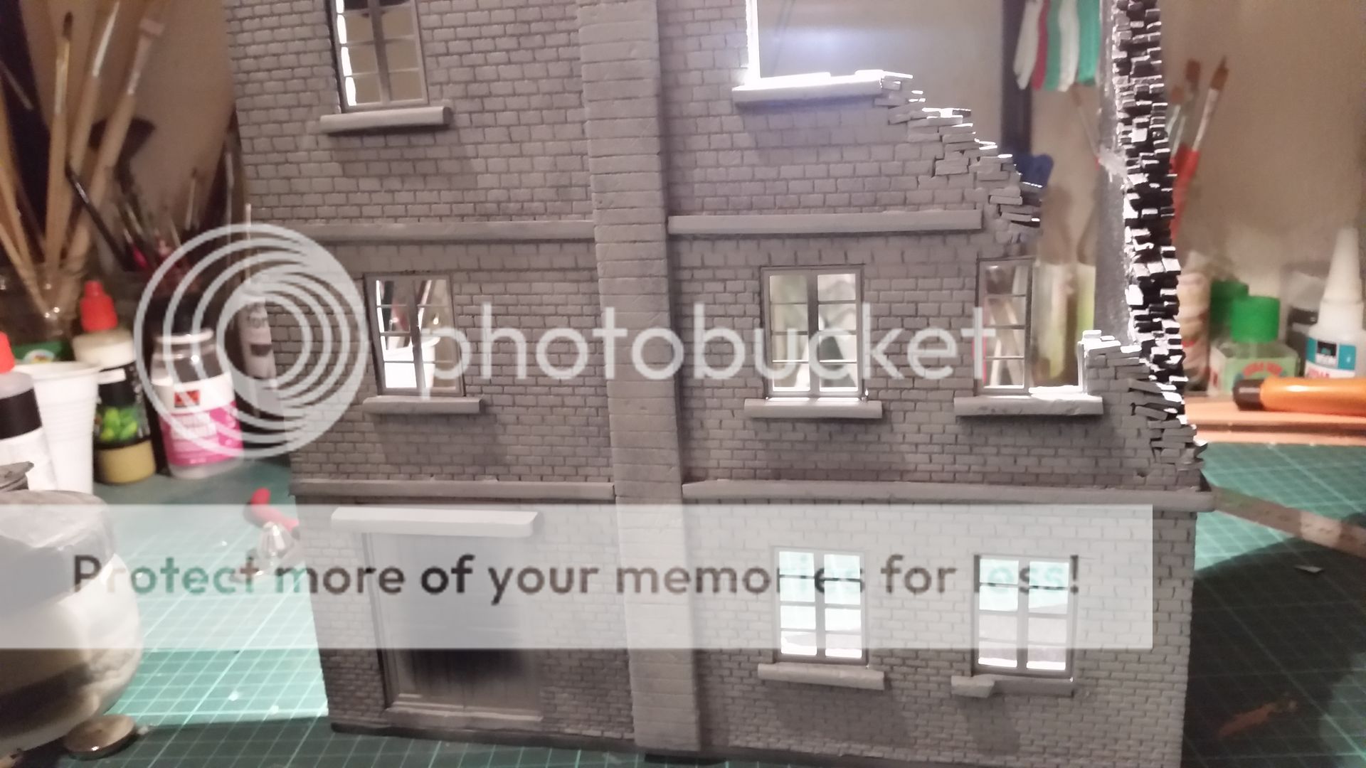

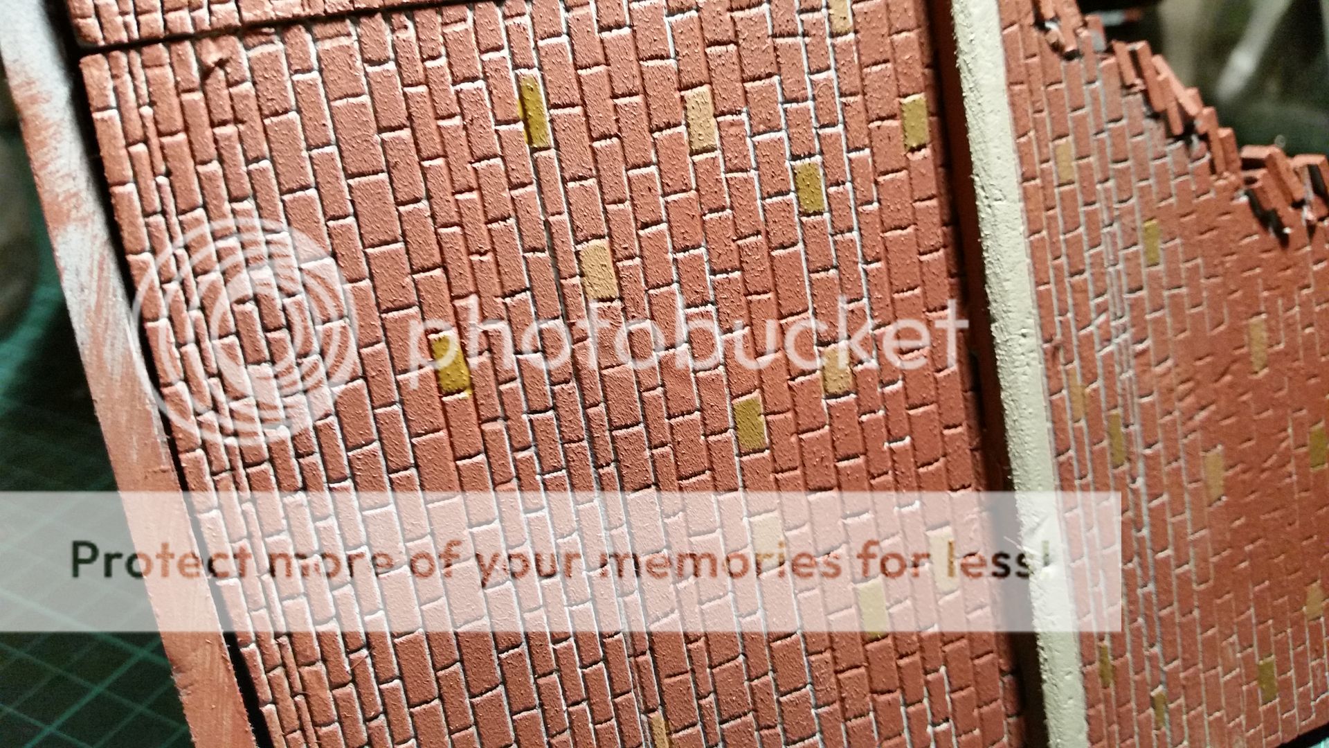

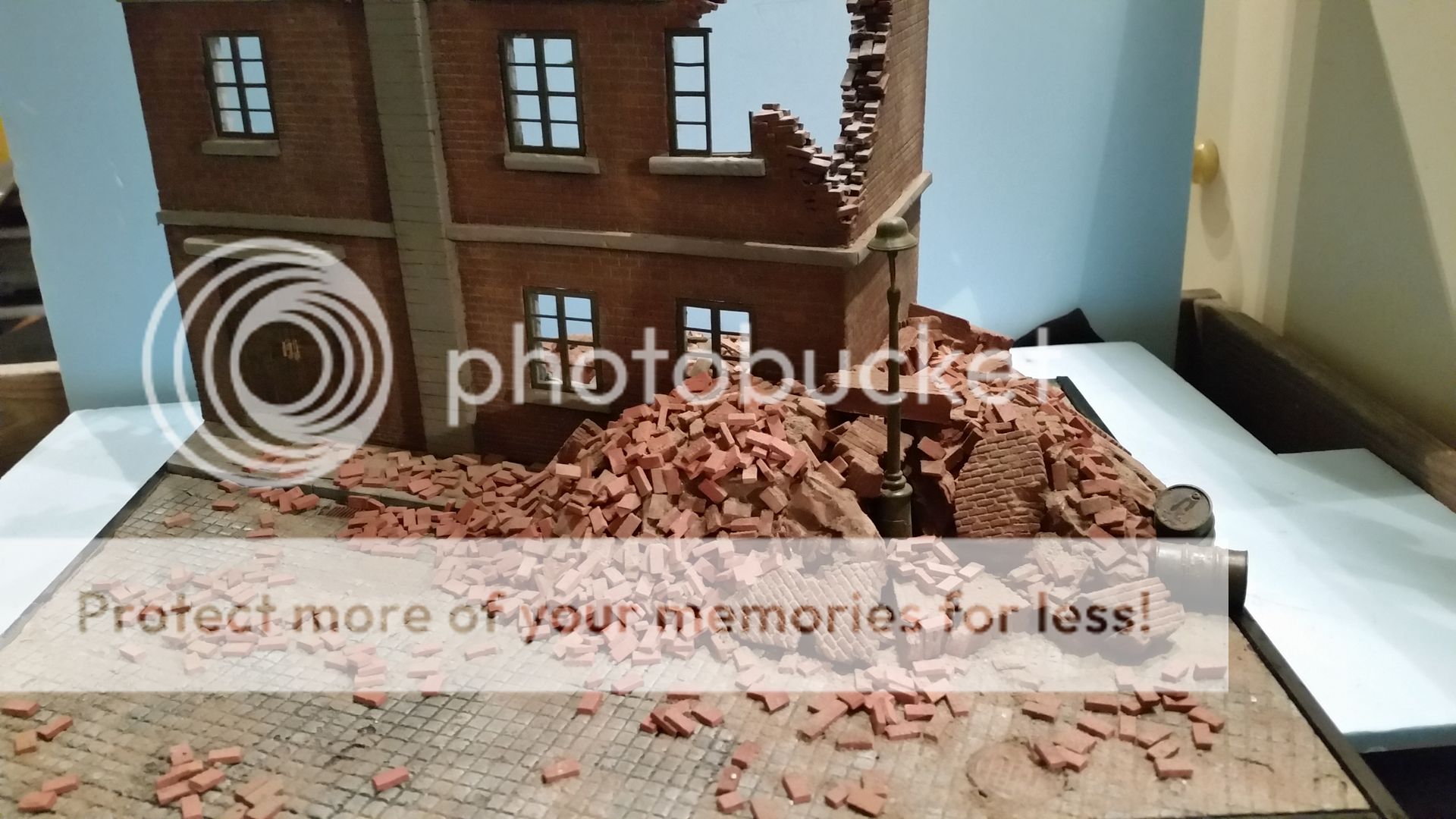

hi guys
so after i have been showing some process on fb here is the new update
the basic building stage is done at this point and painting is started
but i think i will start with this

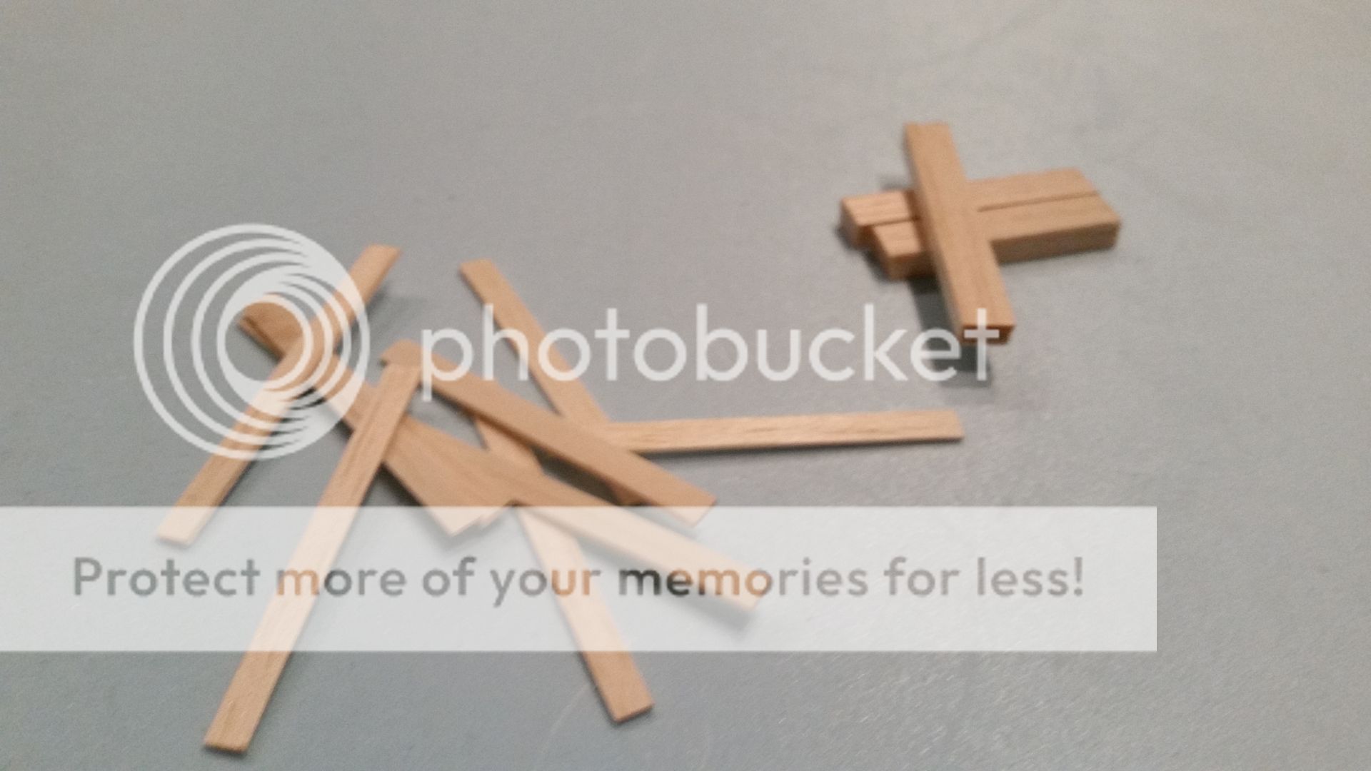

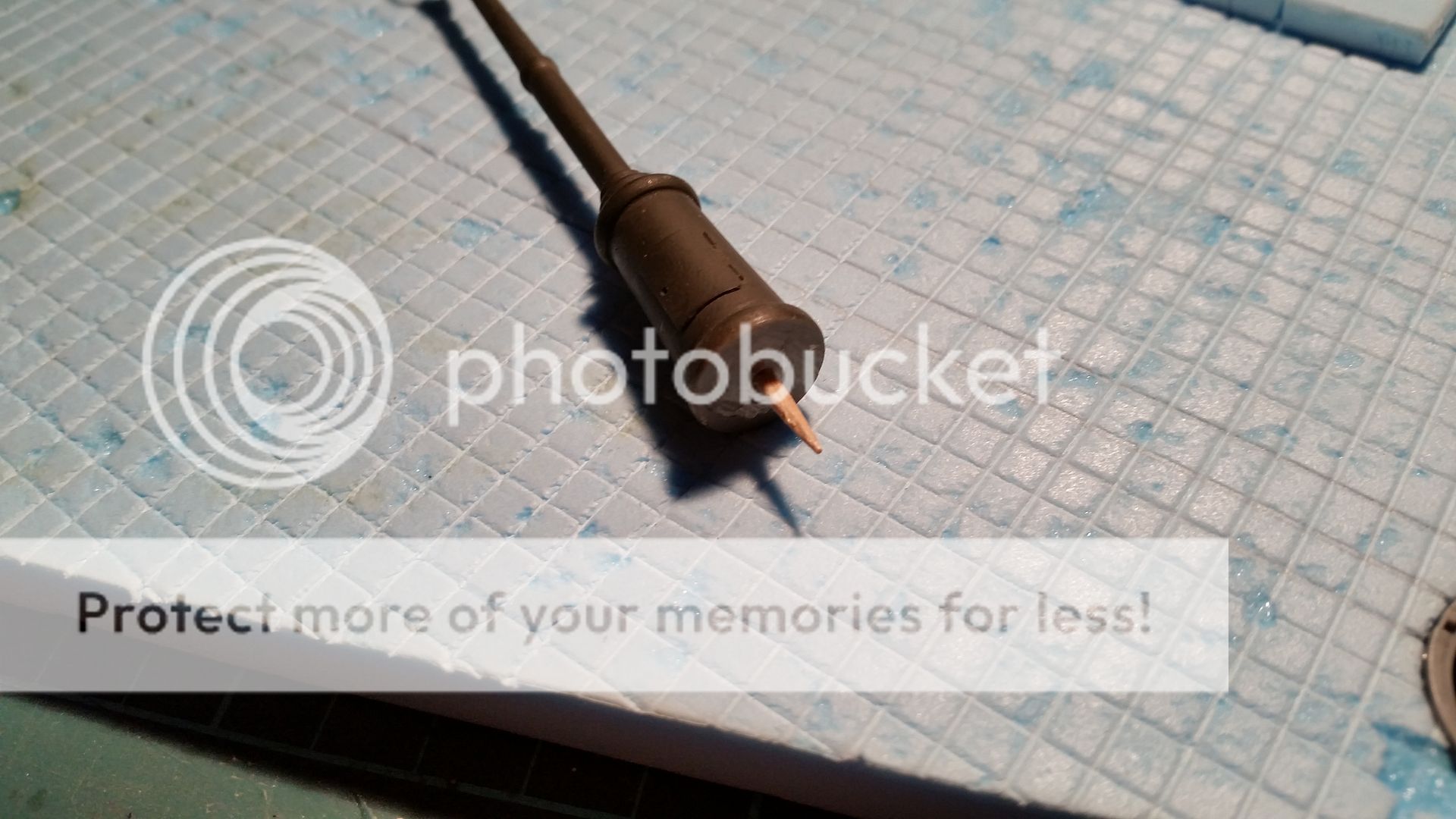

this is the "tool" i used for the enscribing of the walls
all you need is a pin vise and a toothpick
but now let's go to the build

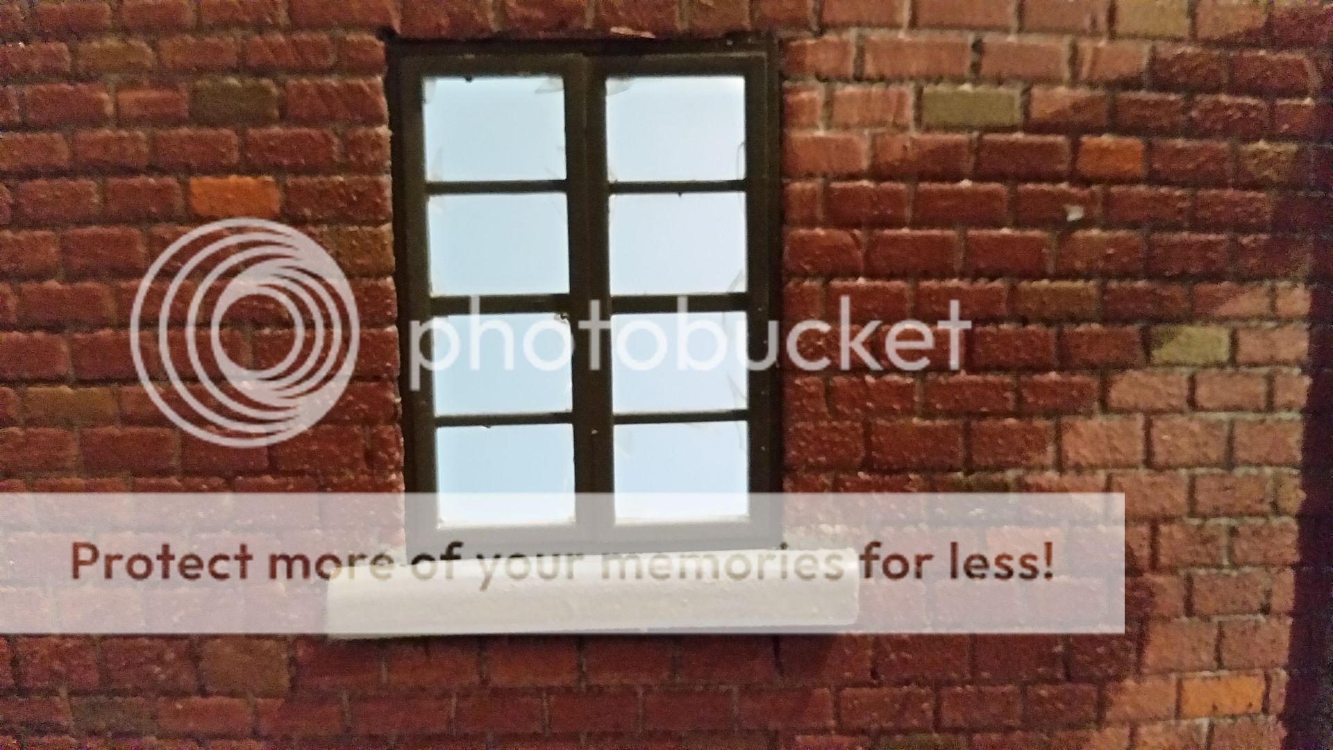

the windowsills are made from the same styrofoam as the building
the only change is that i sanded down the edges to make the front round
these are the side walks

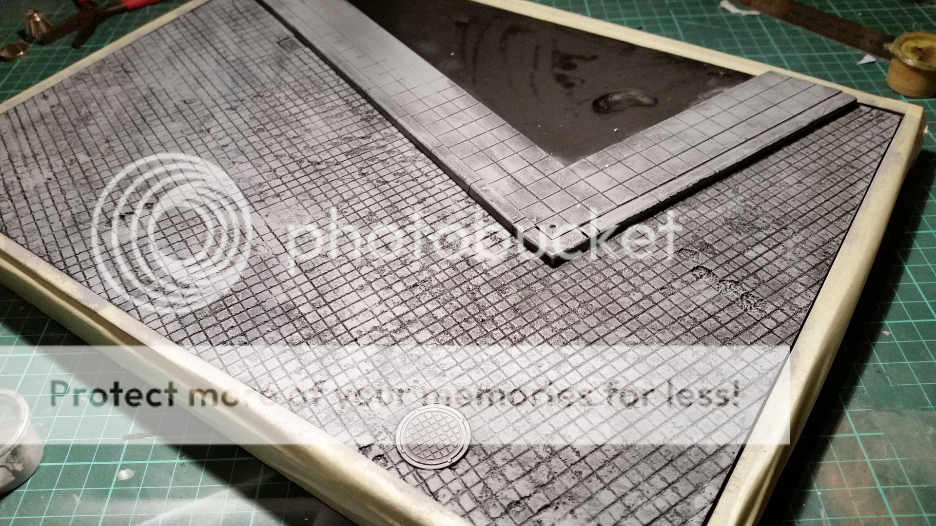

i planned to have a real life size of 35x35cm so this means a 1x1cm scale tile
whren doing this you should keep in mind that you need a grove inbetween the tiles
with the tool i used it was about 1 mm so with a 3 tile wide sidewalk i needed a 32mm wide strip of foam
i then scribed in the squares and cut the parts to size
the curbstones where made from 5mm wide strips of foam
the edges where sanded down and then i scribed in lines every 3 cm the corner piece is made from a square where i cut out a smaller square and the made it fit the rest of the side walk
then it was time for the broken walls
i started with the scribed pieces and simply cut off the edge along the lines of the bricks

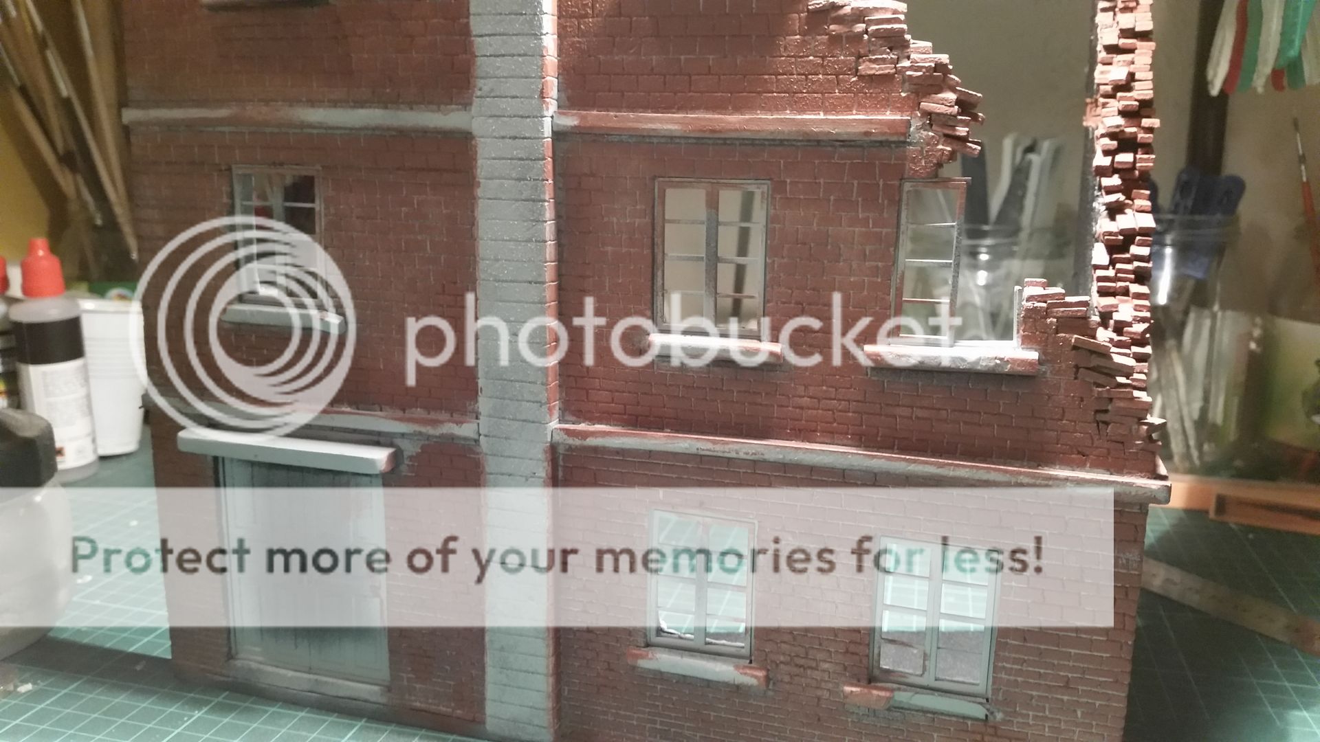

for the broken walls i used the bricks from plusmodel
i think they have several colors but i only have this basic red kind
some of the bricks where snapped in half to make the 3 layers of the wall where different from each other
then i glued on the bricks using 2 part epoxy glue
there are several kinds but i used the slower drying kind this is available in larger tubes but is also cheaper then the needle nodes kind wich blocks after every use anyway
the same glue was used to glue the pointy end of a toothpick into the lamp post
the window sills and the final layers of bricks where glued on
the 2 part epoxy glue was also used for the sidewalks and curbs

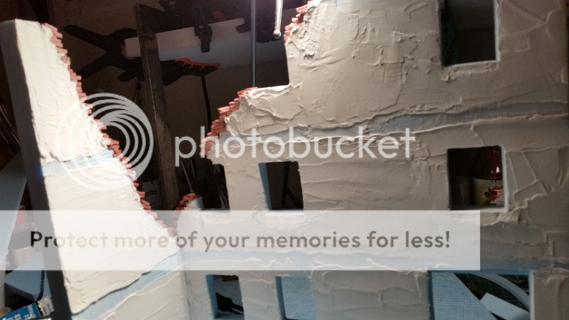

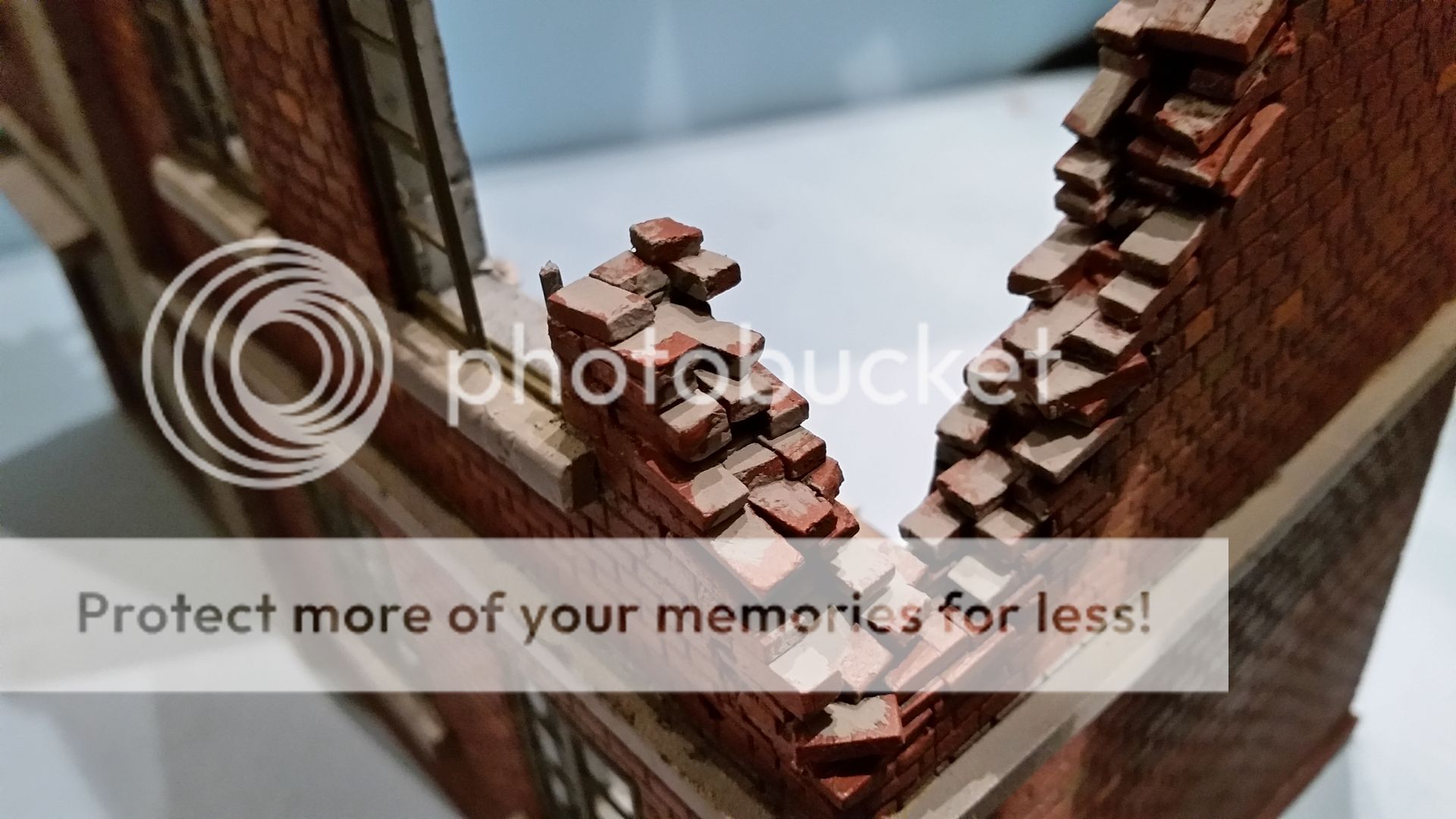

i used house hold filler to make a stucko effect on the inside walls
this looks a bit over done so it was sanded down a bit

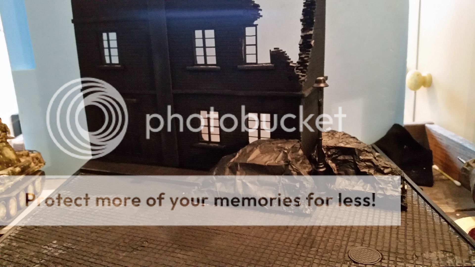

i then made this setup wich i also showed on fb
this is basicly the final setup for the dio

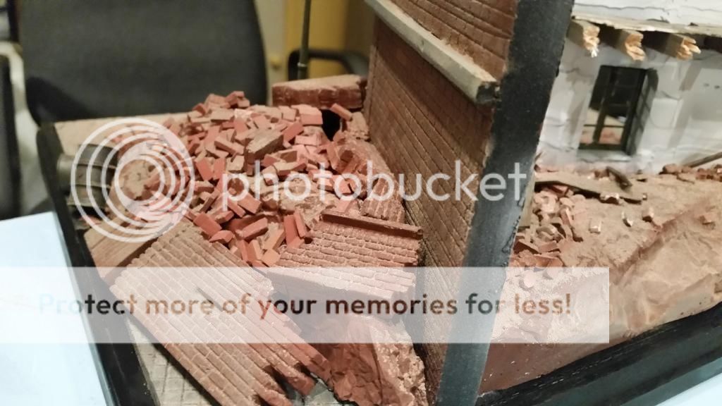

then i made some molds for the piles of debris

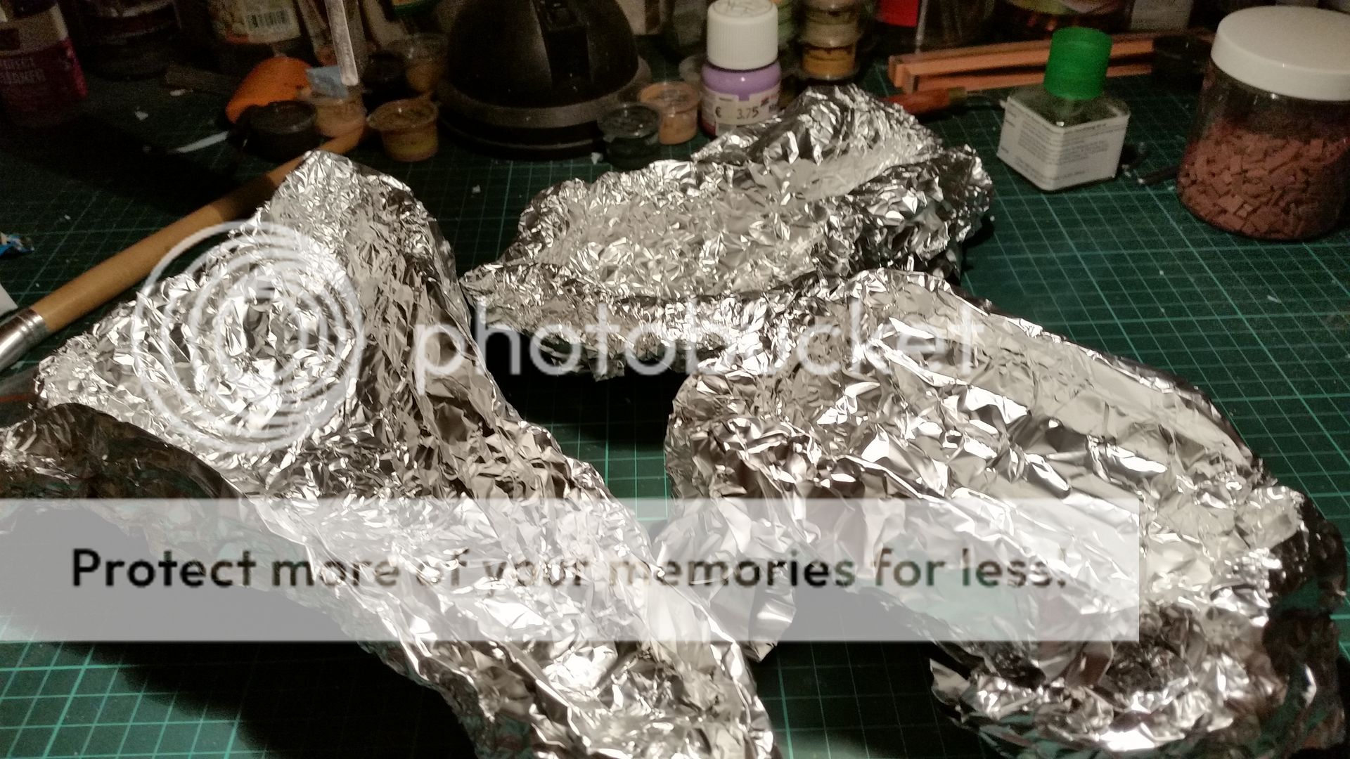

this is a long sheet of regular aluminium foil wich was crumpled up and folded out again
using scrap pieces of styrofoam as a start
the foil was pushed around the foam to make these molds

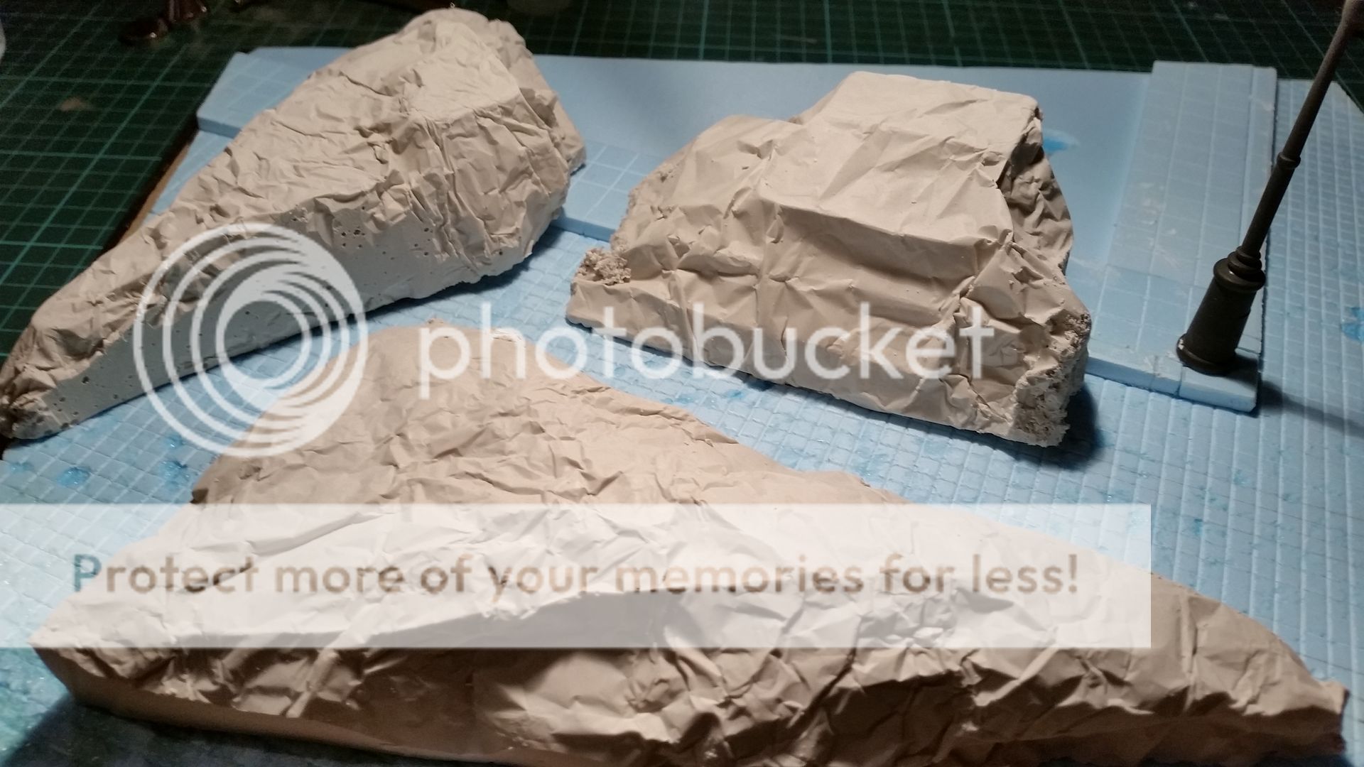

i then filled the molds with plaster to make these blocks
they will serve as a base for the lies of debris
this is done so i don't need huge amounts of wood and bricks to make the piles but only a rather thin layer to cover these blocks
then the entire thing was put together and primed with black primer
and that is about all for now
i hope you like it and untill next time
cheers Mark

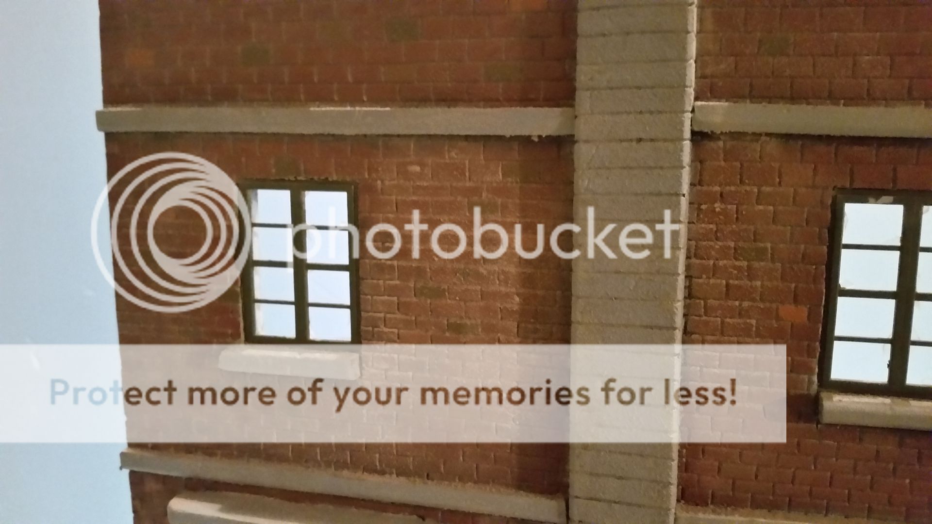

The paintwork is almost done and then i will need a few coats of varnish before i can start with washes so a update should be up soon
Cheers Mark

once the primer had dried i started with the color for the mortat in between the bricks
i used vallejo model air pale blue grey for this
it doesn't need to be very neat just cover the whole thing
then the base color for the bricks was applied ,the paint was dry brushed on the building
the color is vallejo model color mahogany brown wich in my opinion is a nice redish brown that is good for a brick color
then i used vallejo model color beige brown to randomly repaint some bricks
so in the end i will have a bit of color variation
this was repeated but this time with modelcolor English uniform
and finally i used vallejo modelcolor orange brown
when you use this color it looks very harsh comparred to the other colors but once you have used washes and pigments it should be blended a bit better for a nice end result
after the brick work was dry the concrete parts where painted with vallejo modelcolor stone grey
this will serve as a base color
the doors where painted with a 4:1 mix of English uniform and white ,this is also a base coat
then the concrete was dry brushed using vallejo modelcolor medium sea grey
this already gives a tonal variation but it will be finished with pigments later
as i was unable to choose a color for the interior i used white but in the end my focus will be on the exterior and the street so i didn't want to waste too much time on this part
i will be making some floor parts that will be hanging on the walls just to give the inside some intrest though but i will show that in the next update
as i didn't make them yet
the street and side walk where dry brushed using the medium sea grey
i don't plan on much color difference between the 2
i then lightly drybrushed some white (vallejo modelcolor) on the stones
most of the times white is a very strong color in modelling but for tasks like this it is an ideal highlight color

and here is the painted dio
the windows where painted with vallejo modelcolor dark green as i found a large number of photo's of that time where the windows where painted green so it must have been a common sight at the time
after this the entire dio was covered with vallejo satin varnish
this was repeated 2 times to get a decent layer of varnish
this is needed because the foam has a very course surface wich will absorb all the wash very easy but it will do it on places i don't want wash too
so to make life easier later on this coat of varnish was applied

some one made the observation that i have a lot of bricks on the dio , and i think he has a point
but because i made plaster blocks as a base for the rubble wich had to be covered it looks a bit much
and this is the first time i made such a diorama so i can call it a lack of experiance
i think it is pretty hard to get such a setting right and completely in balance but as for now i am happy with the results of my work :mrgreen:
so let's go to the build(ing)
as the basic building was finished last time i decided i could do a little bit of detail on the inside
so i used 5mm balsa wood wich was cut in 5x8mm beams
the thin strips are cut from 1mm thick balsa and are 80mm long to resemble the 210cm long floor boards
to get a sort of laquered look i used dark wash to paint these woden parts
the way i did this is to apply a god amount on the wood and after each stroke of the brush i whiped the excess off with a piece of toilet paper
this way the wash can't completely soak through the wood and leaves a thin coat wich is still showing the wood grain
the "beams"where snapped in two and glued on to the building walls using 2 part epoxy glue
after 2 hours (drying time) the floor boards where glued on using carpenters (wood) glue and again some where snapped before installing
i hope you can see it but i cut up a pice of clear styrene sheet to make glass shreds
these are glued into the corners of the windows
to make some mortar for the bricks i mixed up regular house hold filler and some medium sea grey paint by vallejo
this gives a thick paint wich holds some texture once dry
this was applied with an old brush to make an irregular coat
it was a test/new idea but i think it works

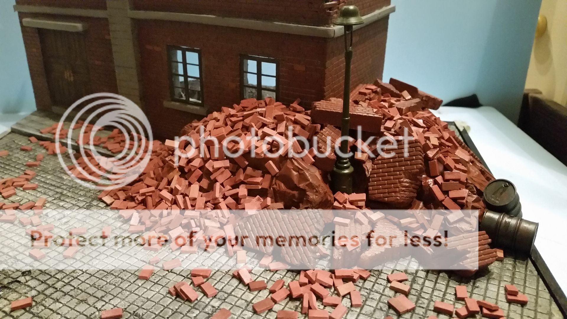

i decided i didn't have enough bricks in my modelling storage so i used some old rubble blocks by Helmuts strongholds to fill up the scene
the large plaster castings where painted with the same mahogany brown as the walls
more of the added debris blocks
most of the bricks where scattered around
then a very heavy application of brick dust and rubble dust pigments by mig productions
the walls also received a brushing with the brick dust pigments
and the window sills with concrete pigments by mig
some bricks that will be on the street
the pigments are very easy to see
they are not fixed on there so NO SNEEZING around this dio or you get dusty
the part of the dio where most of the figures will go
the rubble on the inside
the side of the buildingthe figures will have cover from this pile of rubble
just to see how the panther would look on there
it does not blend in what so ever but that was never my intension as tanks where for a battlefield and not for urban warfare

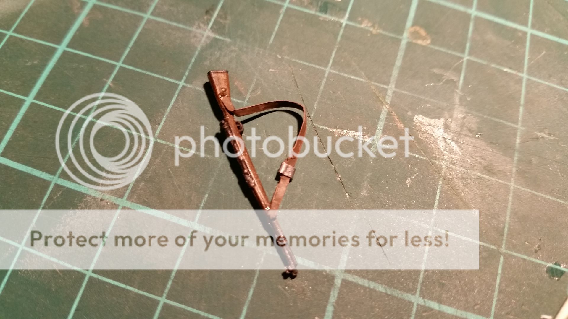

this was a new way to paint the weapons for me but here is how i painted them
i gave the G43 a ocre base and then dry brushed on the vallejo smoke for the effect og a clear laquer and the wood grain
altough not in this photo the same was done with the Kar98K rifles but these received a basecoat of 4:1 English uniform and white
i do want to mention that i prepainted my weapons a long time ago and i think i can do better now so that is why the metal is already painted
a close up of the wood surface
all the guns in with the wood repainted
the metal was repainted using mr metal dark iron and then a light buffing highlighted the details

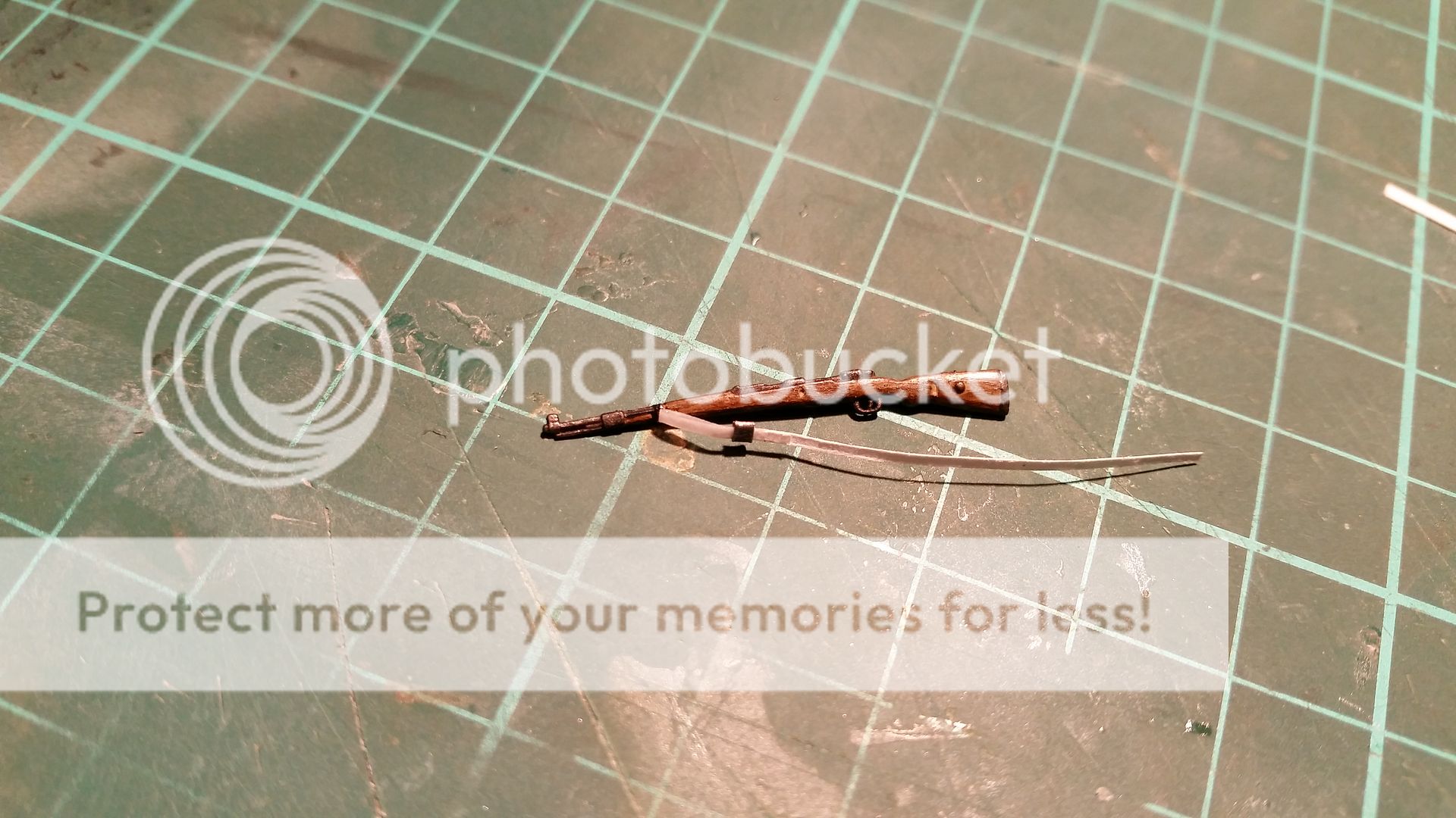

i then started on the gunslings
for this i use regular note paper and leadfoil
they can be made far more detailed or replaced with a high detail pe part but i just make a simple version
the paper is cut into thin strips and the lead is cut in the same manner
then i form a loop in the paper and fold a piece of the leadfoil around it
this is then glued onto the gun with the looped side on the front
i use thin ca glue
i then glue on the back of the sling after cutting the paper to the required lenght
then to make the sling stronger i apply some more ca glue onto the entire sling
once the glue is dry you can carefully shape the sling in every way you like
then i painted the slings using vallejo leather brown
the edges where painted with the same color but i mixed in a drop of white to make them brighter then the rest of the sling
i have 1 guy firing a panzerfaust so i thought that it could be the second he is holding
so i need a fired one aswell
i start by carefully cutting off the parts from the tube
the tube was then hollowed out on both ends
and the details where glued back on
the front part is the sight that needs to flipped up
the back is the trigger wich is squeezed down to fire so that needs to be placed with it's front down
i placed the guns on the figures and dusted the figures to tone down the camo
this was done with mig productions dry mud pigment
then it was time to place the little dudes on the diorama
i marked the places in advance with pieces of steel wire so it was easy to find their positions
the last thing i did was to give the panther some brick dust pigments on the tracks and a bit on the lower hull to blend it in the scene a bit more
and that was it ,i think it is done so it will go in the display cabinet
