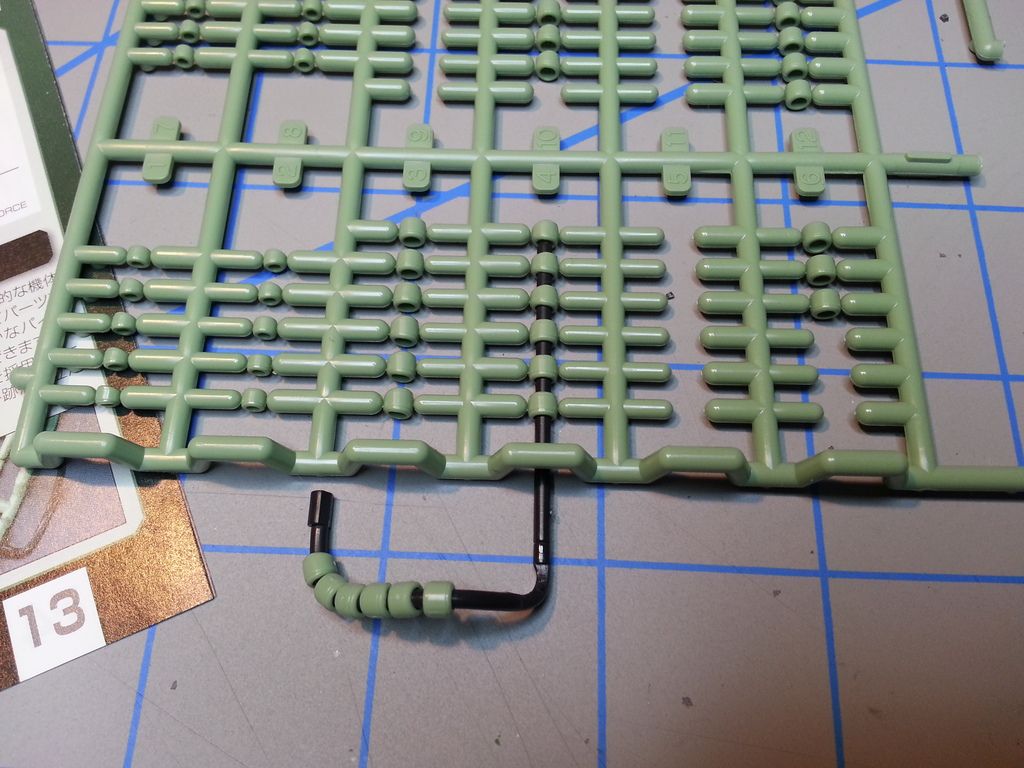

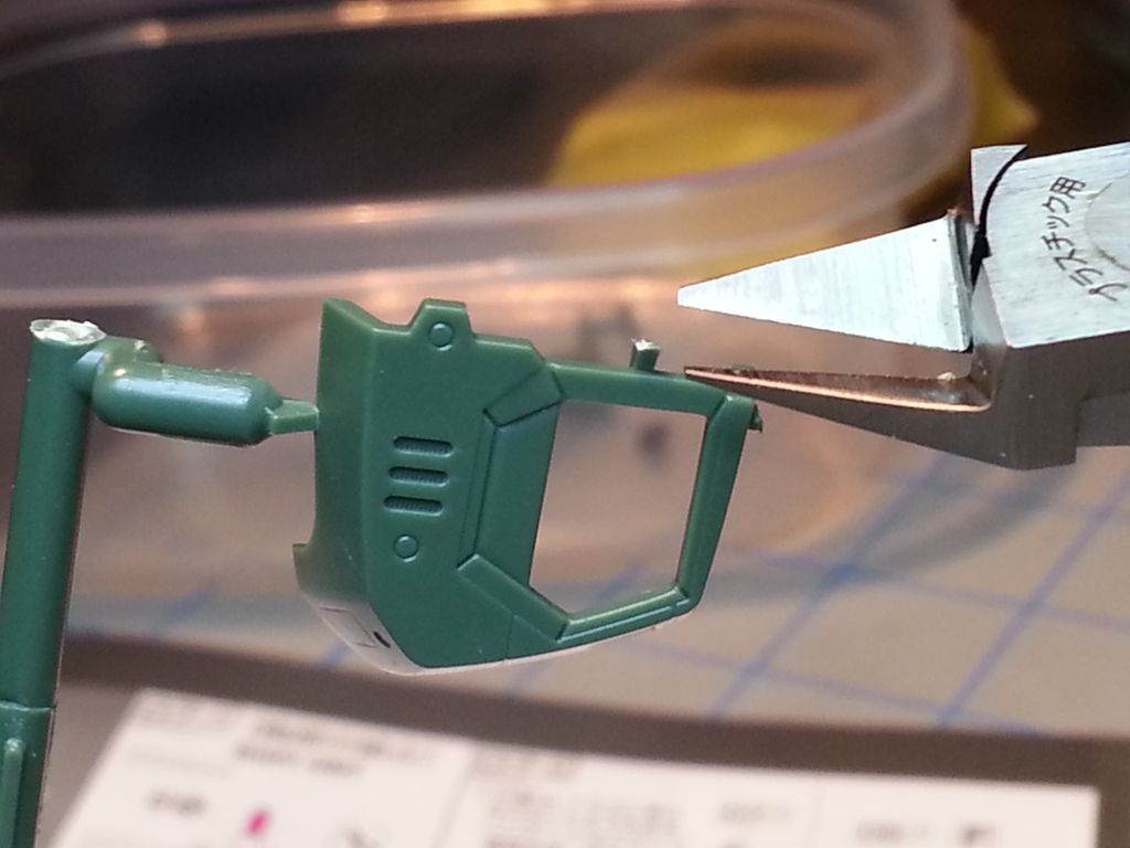

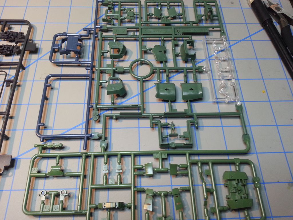

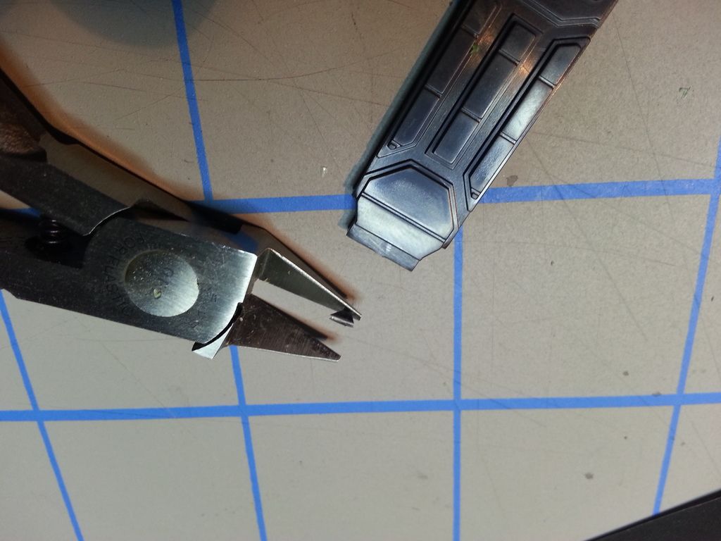

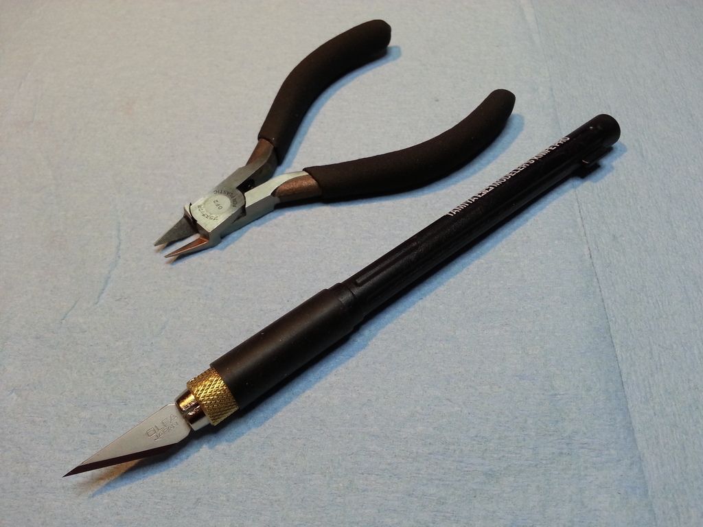

A cutting tool.
These can be a hobby knife or nippers, but I recommend both. While both, you know, cut plastic, they do it differently and it's important to use each according to their strengths. If you HAD to choose one over the other, I would say get the nippers first.
Why? Because though a hobby knife can be used to cut the parts free from the runners, the way they do it—with you putting downward pressure on the runner—can warp or damage the part. Nippers reach in and only apply pressure to the point of contact, reducing the stress on the plastic part nearby.
You can grab a generic X-acto hobby knife or cheap nippers for under $10 USD pretty easily, and in the case of the X-acto they'll last a long time with the occasional refreshing of blades. The nippers, though, I would say if you can, don't skimp. I don't mean break the bank and go buy God Hands, but $20-30 USD for some Tamiya side-cutters or Gundam Planet nippers isn't THAT much more in the grand scheme of things and the leap in quality is noticeable. (I've heard some Xurons are decent, but I've never used one—they seem to be priced between the cheap-os and the Tamiya/GP nippers).
After the nippers, get the hobby knife. They're still useful, especially for some of the nub removal and if you need to alter an ill-fitted piece. Like I said, the price on these doesn't really reflect how well they work, it's the blades that matter. The handle is just what you grip so go with the one that feels best in hand. Myself, I like my Tamiya hobby knife ($10-20 depending on where you get it), but I still have some old X-actos around since they were my first knives.

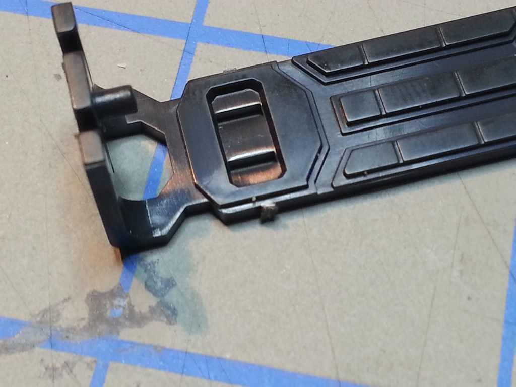

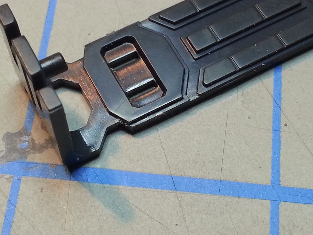

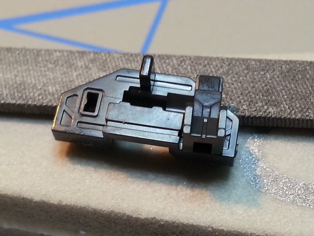

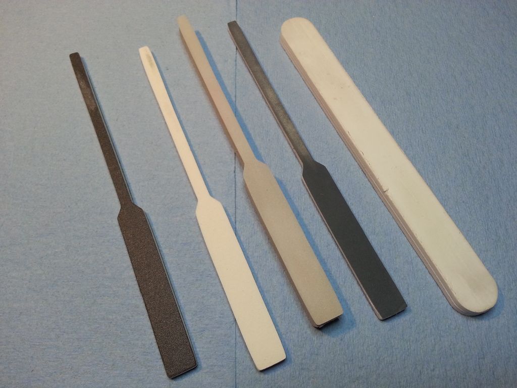

Sanders

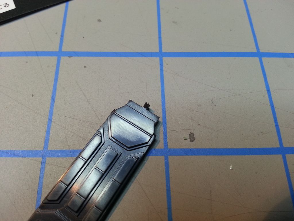

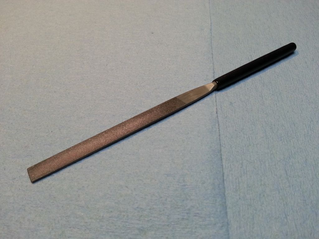

You can get away with no sanders at all if you're really handy with the hobby knife. And for those building their first ever model kit, or the younger crowd, it's entirely acceptable to do no sanding whatsoever. Bandai does a good job of hiding their nubs on the completed kits. But if you want to really make those nubs disappear, you'll need to sand. First, there's the trusty old file:
Seems harsh, or foolish, to take a metal file to a plastic kit, but once we get to the build you'll see why it's a handy tool. Two to four strokes of a metal file on a runner nub and it's gone. Tamiya sells a set for $8-9 that comes with three cross-cut files and they're all you'll ever need. Of course they sell progressively more expensive ones, but if you're just starting out don't break the bank to gain a 2% increase in efficacy (see God Hand nippers vs. Tamiya above).
Next you should get your hands on some sanding sticks. I've tried a few since coming back to the hobby and the Ultimate sanders are splendid:
If you're on a budget, grab at least a thinny stick pack for the white and black sanders. The thin bits are very handy for some of the small spaces you'll be sanding in. Next look for the grey thinny sponge for curved surfaces. Finally, get a hold of the buffer stick. Maybe you've got your own system, and that's cool, but at a minimum make sure you have some high grit (read: very fine) sanders or paper to remove blemishes and nubs.

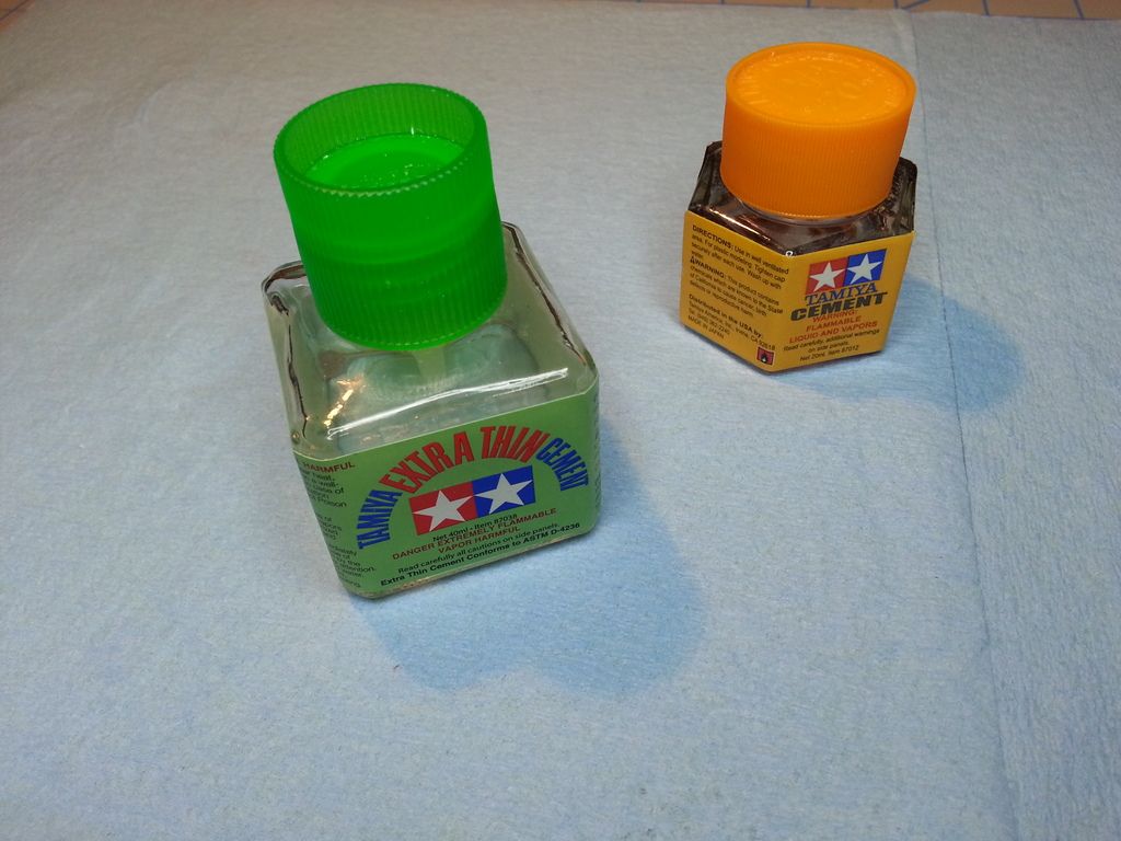

Glue
Yes, all Bandai kits are snap-tight. However, not all parts will snap tightly—especially on older kits—and if you're serious about seam removal before painting, it's good to seal up the gaps. Tamiya Extra Thin (TET) is really all you should need, thicker glues are almost never necessary. It's good to have thicker glue, but if you can only get one, get the TET. If you're never going to paint the kit, you might consider skipping glue, but you might run into a detail part that won't stay put sometimes, so it's good to have some nearby.

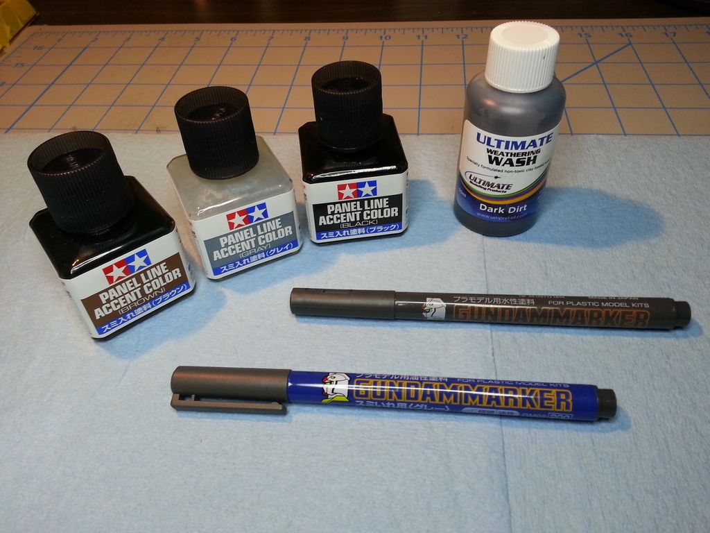

Panel Liners
These can be enamel liners like Tamiya's, clay washes like Ultimate, and Gundam markers. Gundam kits are loaded with details and lines, and making them pop helps complete the kit. If I had to choose only one, I would grab the Tamiya Panel Liners, one black, one grey. These can be used with or without painting and gloss coats, the bare plastic is perfectly suitable for them. An enamel thinner or mineral spirits (preferred option, in my opinion) can take off excess and slop. Don't use lighter fluid. Just…just don't.
I love the Ultimate washes, but the kits are not smooth surfaces like aircraft and it can be a bit hard to coat and remove the wash. That being said, there are times when they are absolutely useful, so if you don't have some already, make these your number two grab for weathering after painting and a gloss coat.
Gundam Markers, ehhh… Look, I'll be honest here. They're nice, sure, you draw along the panel line and hey presto, a line! However you can save some money by just going to an art supply store, grabbing a fine tip ink pen, and making an enamel wash of your own or using some ink. You can get some black, grey, or whatever color you like for pennies compared to the Gundam Marker sets. Nothing wrong with them, and it certainly saves you the hassle if your hobby shop just has a set there and you have the cash. I'm just saying these fall into the "luxury" category more than the other two.
Enamel washes can be removed with mineral spirits, ink with an eraser—you read that right. If you panel line a "naked" kit, that is, one that isn't painted, wait 10-20 minutes and then use an eraser to rub off the excess ink. This doesn't apply to painted kits with a gloss coat, it's just a funny thing that works ¯\_(ツ)_/¯

Sanders

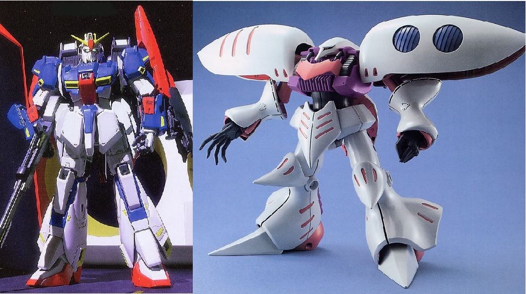

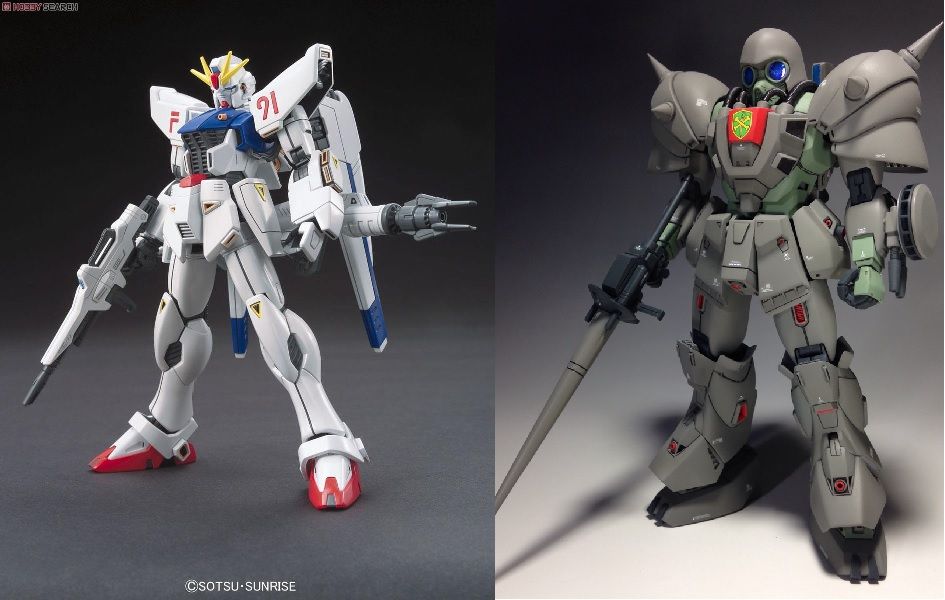

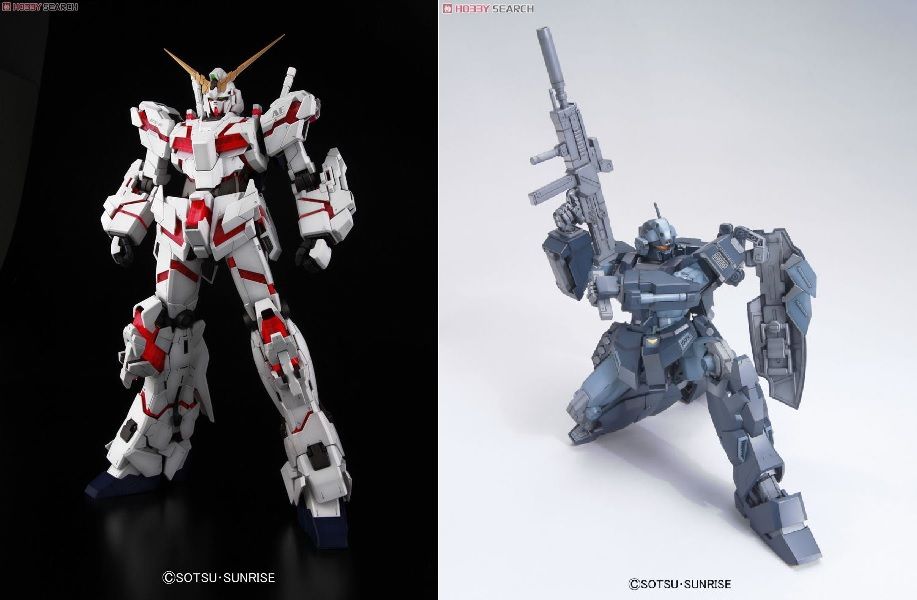

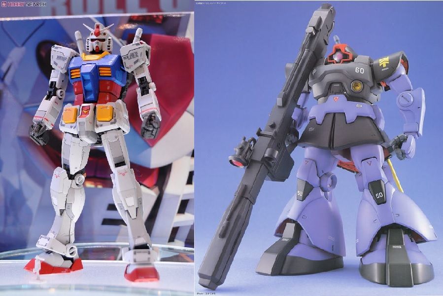

Since about 1999, Bandai has assigned a grade to their kits to signify the complexity level. If you're looking at two kits of the same mobile suit and wondering why one is $15 USD and the other is $75 USD, this is why. The higher the grade, the more parts, details, and points of articulation you'll get.
High Grade ($10-40)
High Grade kits (HG) are nicely detailed and articulated. These are always 1/144 scale and use a soft plastic polycap system of ball joints and peg joints for articulation. Note if you're planning on painting, these polycaps CANNOT be exposed to paints, especially lacquer, as they will become brittle and crack. If you've never built a Gundam kit, never built ANY kit, or just want to try one without sinking serious money into a build, these are a great choice. The part count is the lowest of all the grades. These kits were started in 1990 with a limited run, and again in 1999 as a new standard; new ones are still made today, so quality can vary widely. Since 1999 they are numbered 001 to 200 (so far) with a few kits getting "revive" releases with new toolings. Though there are a few kits that are huge (even at 1/144) and can be as much as $40 USD, most will be $10-25. These will always come packed with stickers and no decals. Builds are typically 5 inches (12cm) tall.
NOTE: There was an HG line released in 1990 that, while much better than the non-grades to that point, are not quite the same as the newer HG line. Also called "OG-HG." There were only 4 or so made and it's not likely you'll run into them.
Real Grade ($20-30)
Real Grade kits (RG) were introduced in 2010 and feature all new toolings and the latest in design techniques. Similar to the HG kits, these are all 1/144. Whereas the HG kits are an armor shell that clips together, the RG kits feature a solid inner frame (like an endoskeleton) that armor is snapped onto.
This means no polycaps and you can paint and weather the machine parts if you desire—it's not uncommon for RG kits to feature cut-outs in the armor to show off the mechanics. Similar to the HG kits, these are a great choice to start with. They are a bit more complex to build than the HG line, if this is going to be someone's first ever model kit I might suggest an HG instead, but it's not that big of a deal. There are so far only 21 RG kits in the line, so your choice of kit is far more limited than with the HG, but more are on the way. The articulation is much better than with the HG meaning you can get much better poses out of your mobile suit. These too will always come with stickers packed in. Builds are typically 5 inches (12cm) tall.
Master Grade ($25-110+)
Up from HG/RG is the Master Grade (MG). These kits will be 1/100 scale and feature many, many more parts. The details will be more intricate and numerous, and the articulation will be an improvement over the HG counterparts. There's over 200 MG kits to choose from, but as with the HG line there are older kits and newer kits with a difference in quality. However this also means that you can grab an older tooling kit for as little as $25 USD and compared to the HG kits it will still be pretty great. Joints will vary from the polycaps in the older kits to the inner frames of the newer RG kits. Your part count can double or even triple depending on the kit, but they will also be color molded so if you've had some experience or no experience and are a brave builder you can dive right in without investing in a lot of paint gear. Some of the older kits are getting revive versions, and these are fantastic to check out as they will have the latest tooling and technology included. These will always have stickers packed in, many will have dry transfers, and some will have water slide decals. Builds are typically 7+ inches (18cm) tall.
Perfect Grade ($100-250)
The top of the line, Perfect Grade (PG) kits are monstrous at 1/60 scale. In addition to the high part count, you will get a ton of options, the most screen-accurate and detailed kits, and the highest amount of articulation. All will feature armor that you can remove at will to display the inner frame, and if you're not into painting, they will come molded in correct colors—not just close to, but completely correct. These should not be attempted if you have never built a Gundam kit. Bandai sells LED lighting kits for many of these kits (though some can be very pricey, the LED for the PG Gundam Unicorn/Unicorn Banshee can be $80-100USD). These will have stickers, dry transfer, and sometimes water slide decals, though Bandai tends to sell the decals separately to pull a little more money from your wallet. Builds are typically 12+ inches (32cm) tall.

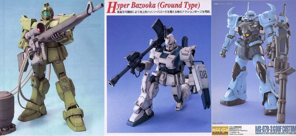

Non-grade
Prior to the start of the HG line at the turn of the Century, Bandai released kits for series with no real pattern. Some were 1/144, some were 1/100, and a few were 1/60. (2011 did see the release of a 1/48 Zaku II!) The earliest kits from 1980 to about '86 were very simple, stiff, and often required a lot of gluing and fitting. However, by '87 the kits took a leap in terms of quality and anything following that is quite good, if a bit simple or stiff, and can be had for very little money. Most of these will be from 0080, 0083, F-91, Zeta, ZZ, Wing, and Char's Counterattack.
As I said, they won't be up to the level of the post 2000 kits in terms of detail or articulation, but they're often dirt cheap and feature many great designs that have yet to get an HG or RG treatment. Anything from 1988 to 1998 will be decent to great.
Side note: this also includes the UC Hard Graph line, a short series of 1/35 scale kits featuring figures and unique builds like a blown up zaku head, Gundam arm, armored vehicles, and the amazing M61A5 MBT kit.

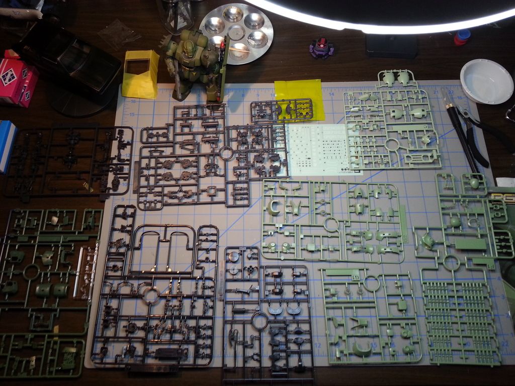

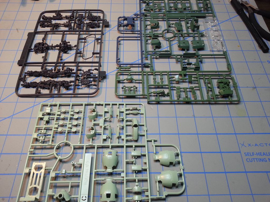

First up, inside the box:

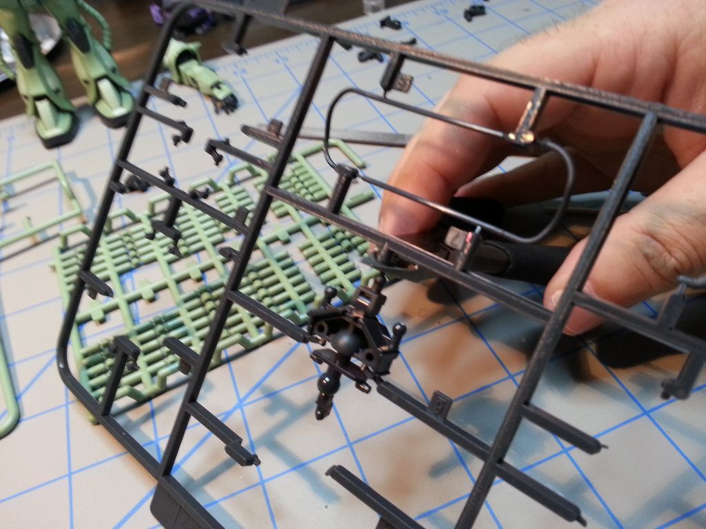

As you can see, there's quite a bit inside the RG kits. The A runner is almost always your multi-color injection runner:
Your other runners done in different colors:

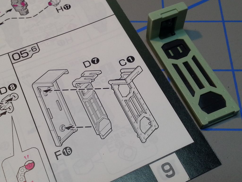

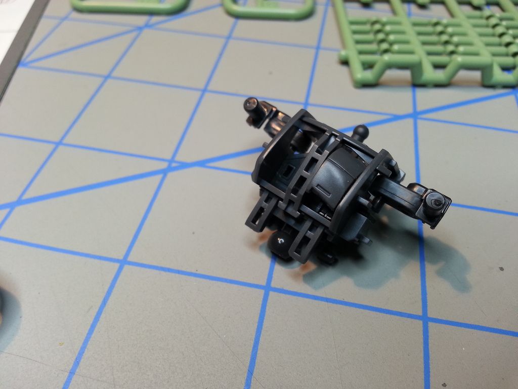

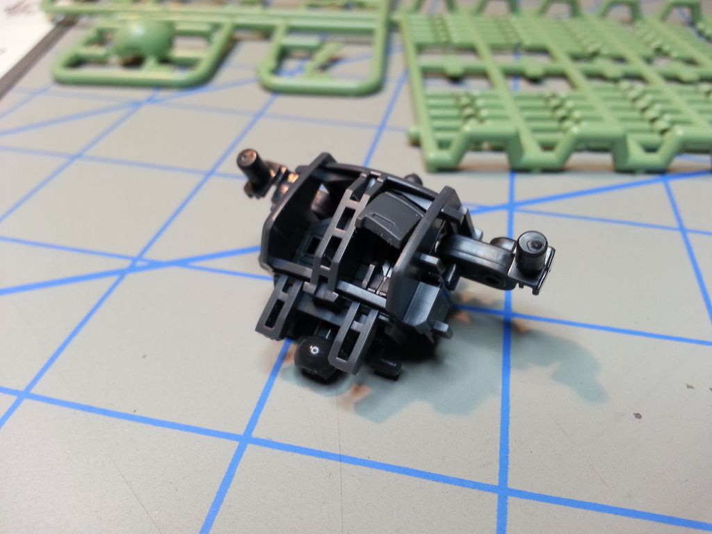

RG's, like most newer MG's, have an inner frame like a skeleton that the armor clips onto. This kit starts with the legs and feet:

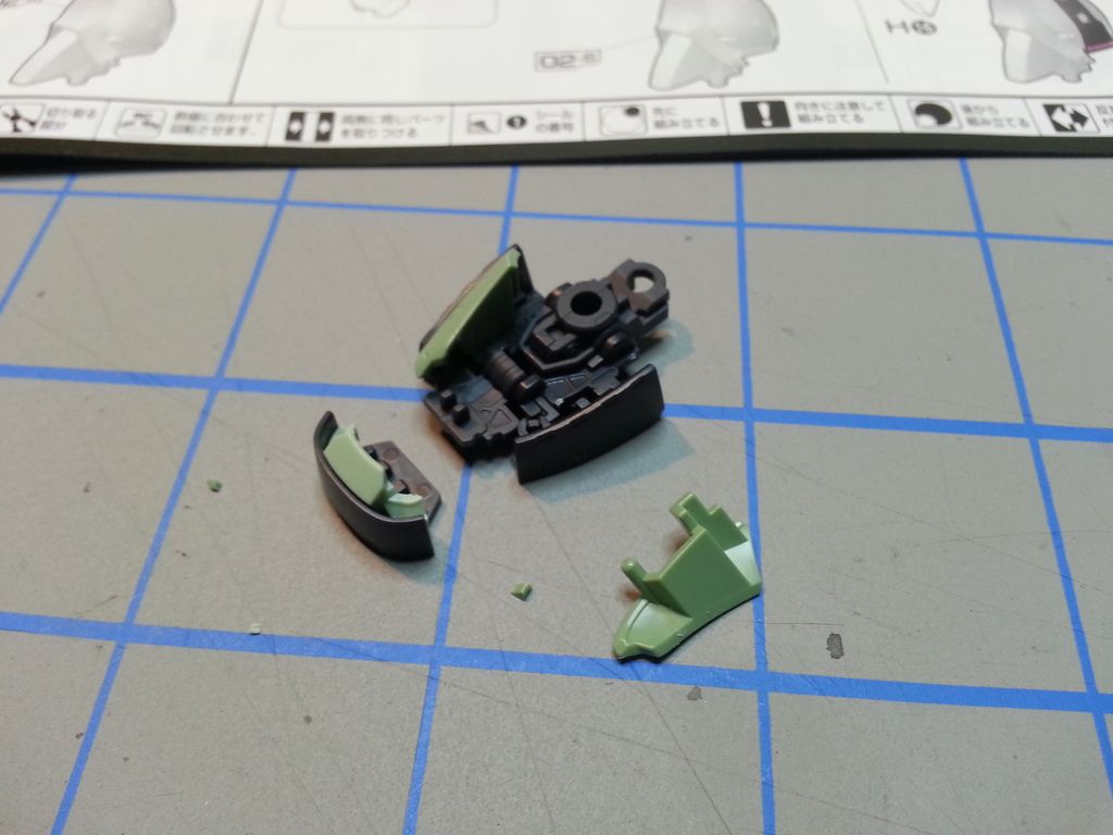

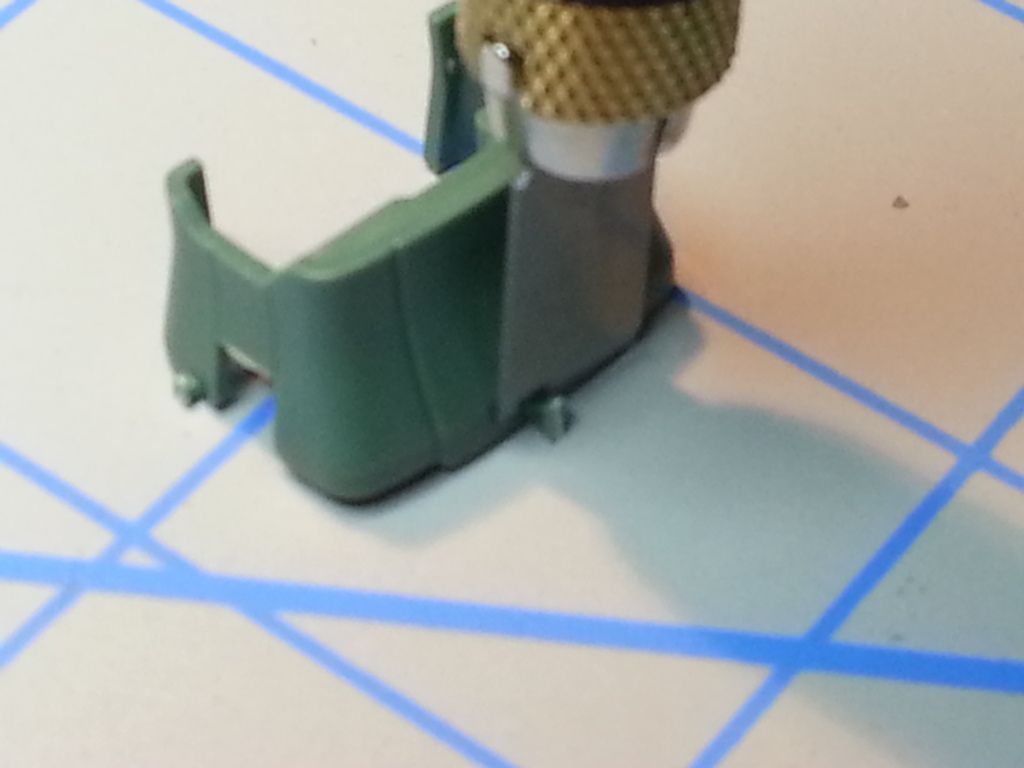

People can cut their parts free from the runners in any way they see fit, but for this example I'm following the standard Gunpla SOP. Cut the gates from below so you can see where you're cutting. Cut away from the piece leaving a bit of the gate behind on the part:
At this point you can cut the rest with a nipper or hobby knife:
Or, as I did, take it off with a file. The benefit of the file is that two to four strokes with the file and the nub is gone completely without stressing the plastic as you can do with a knife or nipper. The trick is to only apply the smallest amount of pressure and move the file only in one direction and NOT back and forth. File in one direction, stop, pick it up, start over:
One neat thing with the RG kits is how the dark inner frame gets dressed up with the color armor pieces:

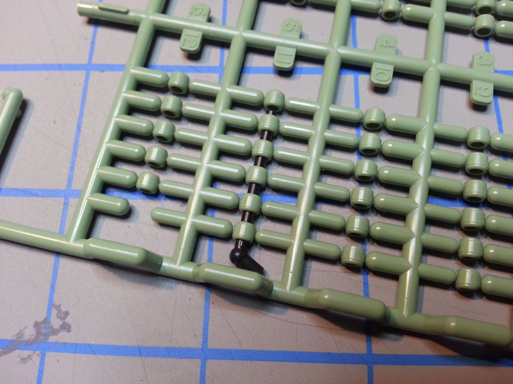

One particular detail I love/hate were the energy hoses. They're a staple of Gundam, but normally you get a rubber tube at best, but most often a solid molded plastic tube. For this kit, you get springs and dozens of plastic rings:
You feed the spring through the rings, then cut them free:
The part I didn't like about them is nub removal on tiny rings is a nightmare, and I can only imagine what a pain these would be if you wanted to paint them...

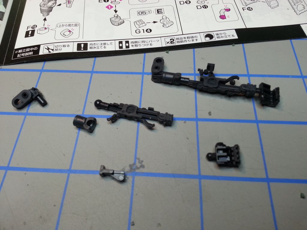

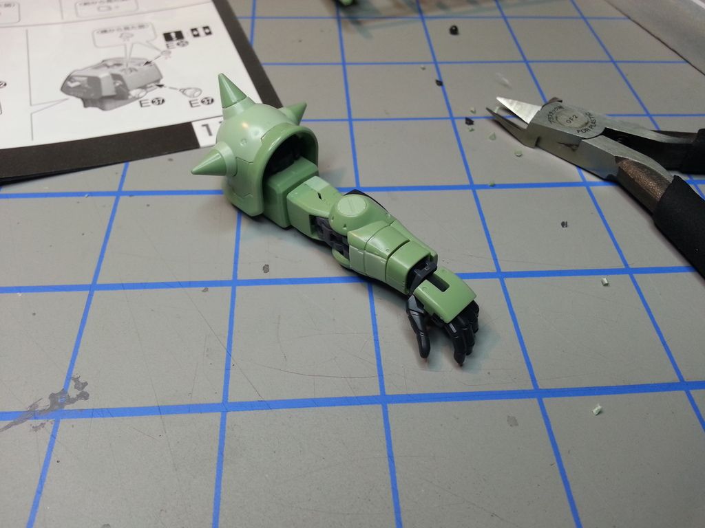

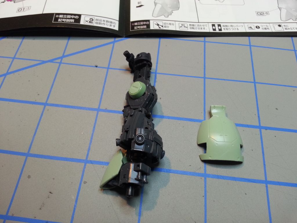

Inner frame for arms and chest:
Neat and unexpected gimmick, there's a cockpit seat and hatch that opens, though you can't seat the tiny pilot they pack in with the kit:
Armor shell on to the inner frame:

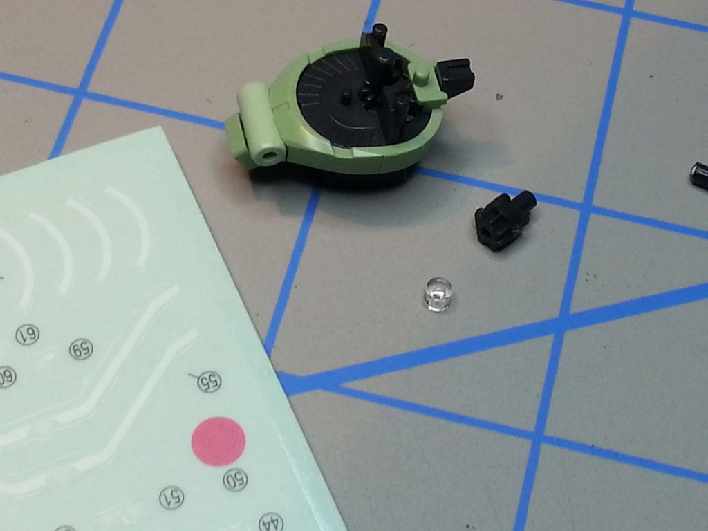

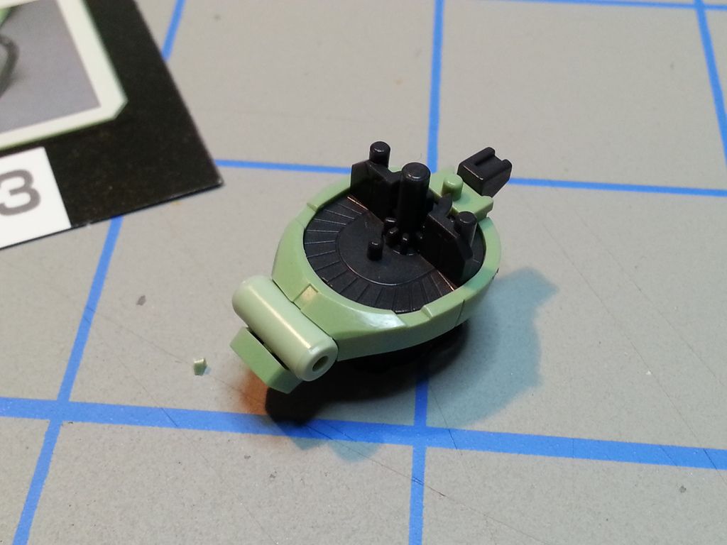

The head. The kit gives you three options for the head, a grunt with a smooth dome, a spike for the NCO, and a more ornate spike for the high ranking officer. I went with the NCO spike.
The head itself has a gimmick; the mono-eye is on a geared track and when you turn the head it also causes the eye to traverse giving the kit a more lifelike feel. All of this is behind a clear plastic shield, much more detailed and better than the HG method os a sticker on a black flat plastic:
Note that there's a pink sticker for the mono-eye, if you want to paint it, it could be trickier and must be done before you build the head unless you want to take it all apart again. Nothing wrong with that, just be warned.

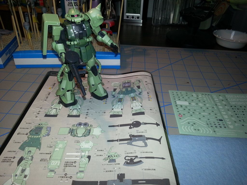

Once all that is done, the Zaku is put together! Now the process of stickers begins. The HG kits might have a few foil stickers, or maybe 20 stickers on a sheet, the RG has well over a hundred. Some metallic, some tiny detail stickers, and a few larger accent colors that you'd paint if you painted the kit. Interestingly the kit gives you options for rank insignia ranging from the lowest private to Captains. Pretty great.
Coming Soon, the finished kit
